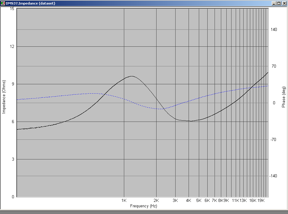

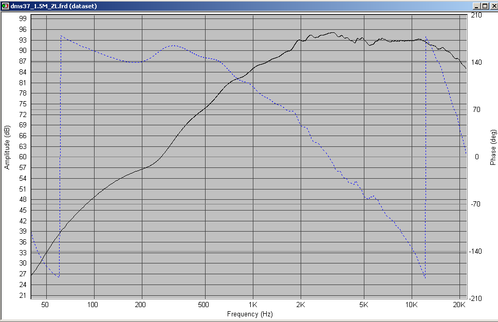

dantheman- Would you have a simple soft dome tweeter with no lens you could test?
Hi Sum, attached is a 1.5M on axis measurement of a morel DMS-37, I don't have the original measurement on my laptop so this is what I imported as an FRD into speakerworkshop.
There is a glitch around 5.5Khz but my feeling is that it is baffle related rather than inherent in the tweeter. The phase shows a bit of a glitch here as well, but nothing like the flip you are talking about, so I don't think this one is going to help.
The impedance plot has been 1/64th Octave smoothed, otherwise it looks rather "hairy" Interestingly it shows no sign of any glitch in the range I would have expected it.
I don't have any unbaffled measurements of this tweeter.
Also not sure what you mean by "no lens" The DMS is semi horn loaded, so may not be what you are looking for anyway.
Tony.
