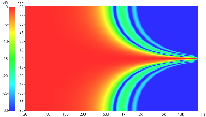

Thats simple polar response. The null move location with frequency. see why polar aspects of a loudspeaker design can get complicated.
Right. Here's an LspCAD polar map of a perfect 300mm piston with no baffle effects. The peaks and nulls move lower in frequency as you move farther off axis.
Edit: oops that's a 300mm radius or 600mm diameter.

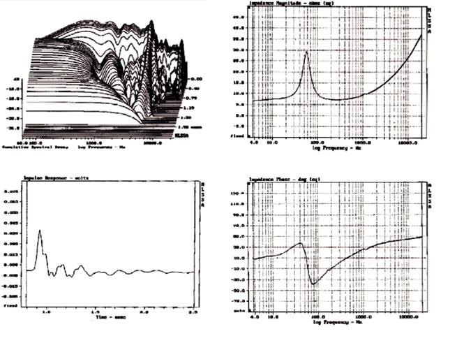

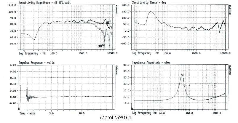

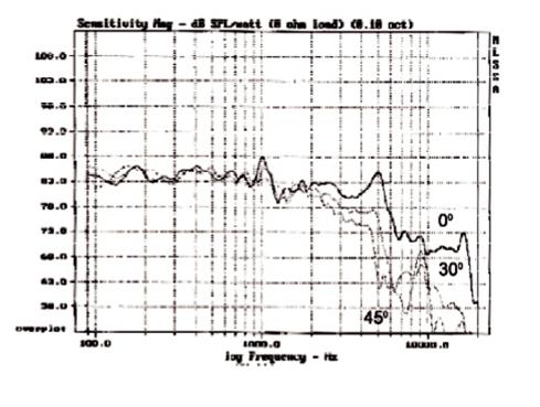

The charts below are from a Morel MW164, as provided in their literature. First one is from the Parts-Express PDF, the other 2 are from Morels website (PDF) The phase and impulse data differences look bizarre to me. Other then that, the 5k response peak and the resonant frequency look close.
Sorry for the lousy resolution
Any feedback on this data? Another thing that is odd to me is the "blip" around 1k in the phase and impedance data.
