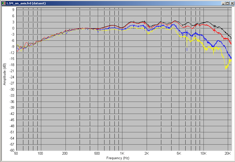

The thing that stick out to me in this graph is that you're top octave is down approx 10 dB at 45 degrees while 1-4 k is down only 3 dB and it doesn't drop at a consistent rate. It would be nice to have measurements that go even further off axis as they may explain the harsh sound you heard. My experience has had a correlation even if it may not completely explain the causation. The crossover looks fine as best I can tell from those.
Soongsc might be able to tell you how to treat the room to get a better perceived balance of power even though you may not think it's a problem. I'd bet it actually is. Further off axis may reveal more. It seems daunting and pricey if possible.

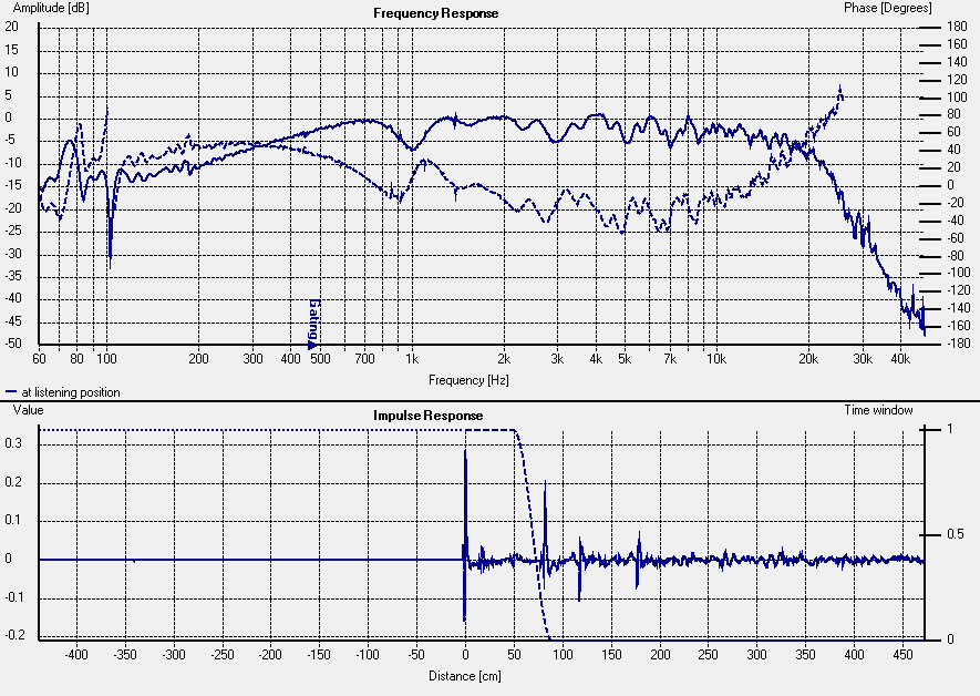

Hi Dan, I did try taking measurements at bigger angles off axis but was getting nonsense results. It was a bit odd as the first time I tried (but wasn't measuring the angles) I was able to get a good measurement even at 90 degrees, but the second time I tried I was getting horrid results that were completely unusable (basically looked like + or - 20db at very close intervals across the freq range. I couldn't get any gating that worked and I would probably need to do the measurements outside on the balcony with the woofer facing out into the open to get some meaningful results. I think that the woofers are actually quite non directional up to the point (4K where they start running out of steam). The tweeter is semi horn loaded which might explain it's tendency to become rapidly more directional at higher frequencies.

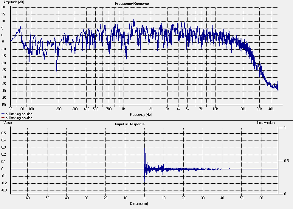

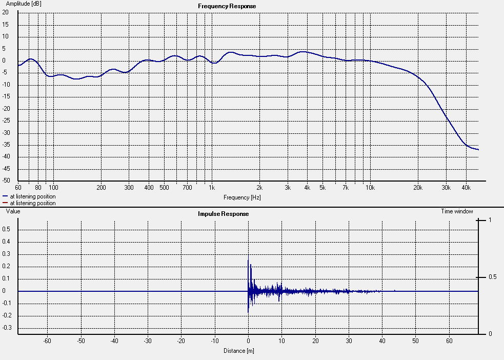

Oh ok maybe my room isn't so bad afterall!! I thought it was odd that there were peaks 2k 4k 6k 8k and corresponding dips at 1k 3k 5k 7k... Is your graph a raw response or is that with gating?? from memory, without the gating mine looked even more scary than yours! 🙂
No gating. Just five sine wave sweeps from across my couch 1/12 octave smoothing laid overtop of one another. Check out the link in my signature for more info on what we hear. I don't know if you're up on that or not, but don't pay too much attention to the room response above the modal region though I believe it does have some degree of usefulness.

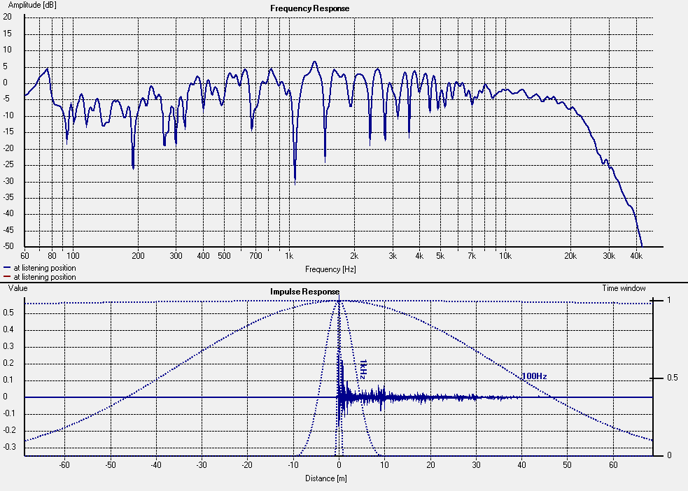

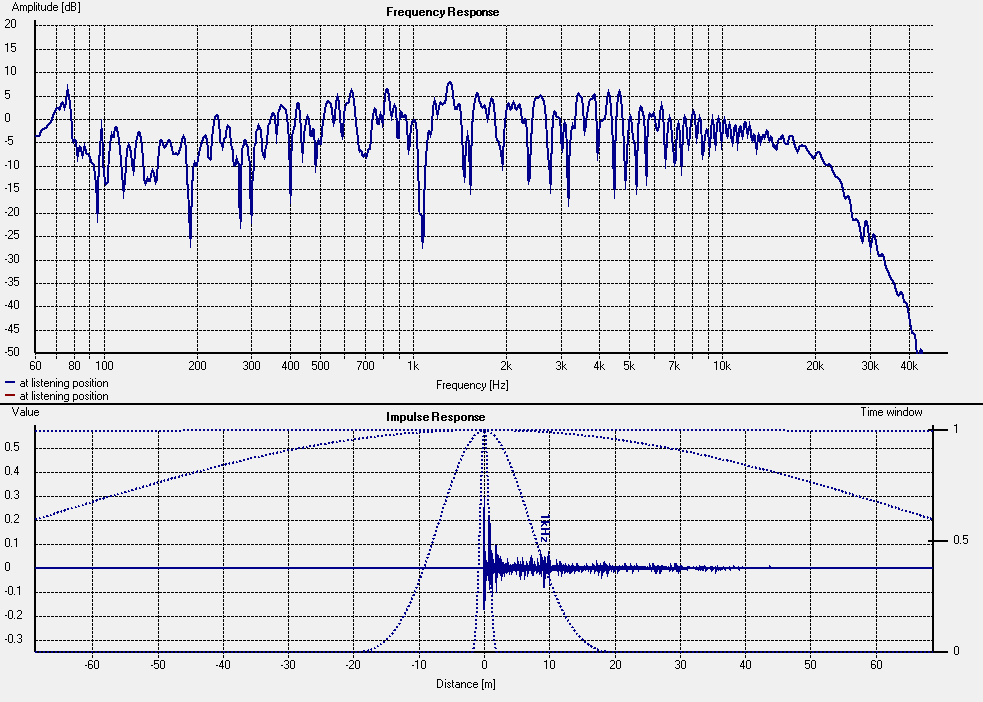

OK Well here is the completely raw response roughly at my listening position on my lounge. It is roughly because I had trouble getting my mike to sit properly so it is a little bit lower than it should be, probably about 15cm lower.
Also attached for comparison is 1/32 octave smoothed (using holm impulses complex smoothing as it shows the dips much better) and 1/16 octave smoothed. and just for the fun of it a 1/3rd octave smoothed (normal amplitude smoothing) curve. You can see why manufacturers show graphs with 1/3rd octave smoothing!! The hump at 60Hz I suspect was a car driving into the garage downstairs as I was taking the measurement. The woofers should be down about 10db at that point. Resonant freq of the box is around 82Hz, the intention is to cross to the subs at 200Hz.
Oh and I forgot to answer your query as to what my woofers are. The are Morel MW144's. If you saw the near field response earlier in the thread, then you will be able to tell that pretty much all of the response irregularity up to 2Khz is either baffle diffraction or room interaction.
Tony.

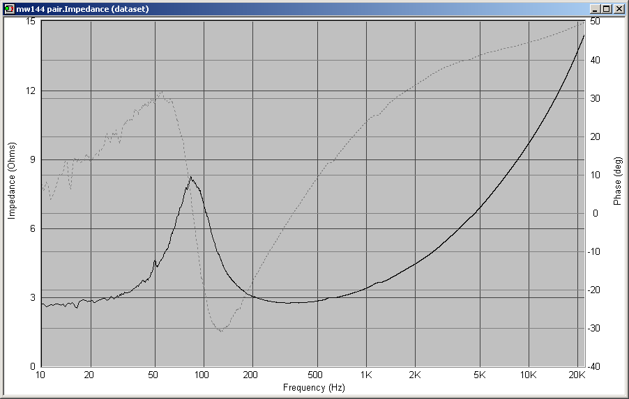

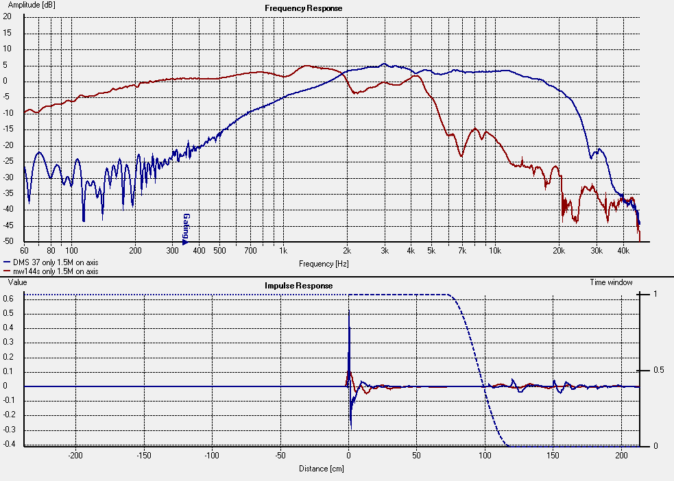

First of all, I would seriously try to get the minimum impedance above 6Ohm unless the amp really can double the output power when you half the load impedance. Second, I would try to get the speaker impedance as constant as possible. Normally I try to get as close to 2Ohm diff between min and max with the least components possible.
During SPL measurement, if you have the ref input connected to the input of the amp instead of output of the amp, then the amp is part of the DUT.
Hi soongsc, unless I run only one woofer, then getting the impedance up to 6 ohms is going to be next to impossible. I'm currently running an LM3886 chipamp, and it is not even getting warm. Also I'm planning on running with a 2nd order active cross to my subs at 200Hz so the amp won't be struggling so much.
I had considered putting a zoble on the tweeter to flatten it's resonant peak. The impedance peak between 3 and 4k is the notch filter, and the tweeters impedance rises naturally as well, flattening it would I would think cause the high freq to rollof to be much higher than it already is.
Impedance curves of the woofers in box and the tweeter (in box) are attached. I think you will see from them that I will really struggle to flatten the impedance without totally destroying the sound 🙂 The tweeter is supposed to have a resonant freq of 700Hz so it is quite a way off that!
edit: since I hadn't posted individual responses before I've added the woofer and tweeter measurements at 1.5M on axis Mic level with the tweeter and 1.36M off the ground, 1.2M from the ceiling and around 1.3M to the nearest furniture either side. These measurements combined with the impedance measurements are what I've been using in speaker workshop for my sims.
