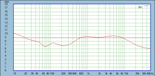

I had considered putting a zoble on the tweeter to flatten it's resonant peak. The impedance peak between 3 and 4k is the notch filter, and the tweeters impedance rises naturally as well, flattening it would I would think cause the high freq to rollof to be much higher than it already is.
Impedance curves of the woofers in box and the tweeter (in box) are attached. I think you will see from them that I will really struggle to flatten the impedance without totally destroying the sound 🙂 The tweeter is supposed to have a resonant freq of 700Hz so it is quite a way off that!

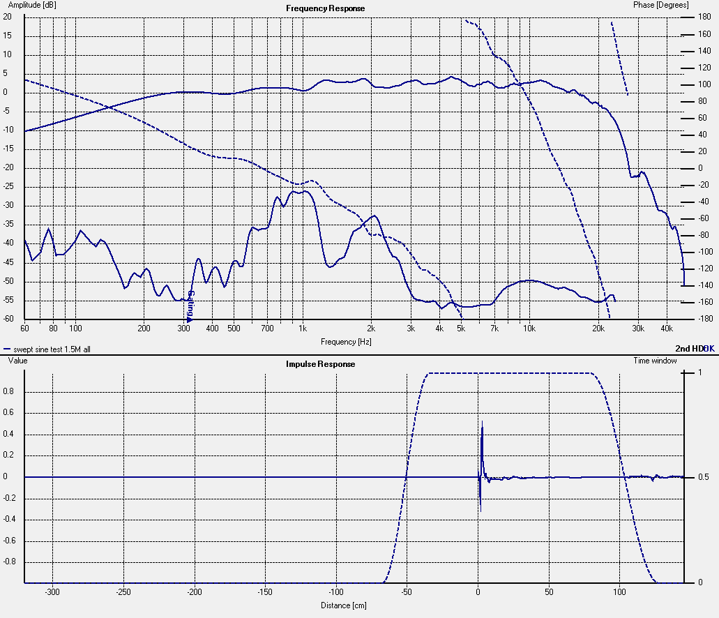

edit: since I hadn't posted individual responses before I've added the woofer and tweeter measurements at 1.5M on axis Mic level with the tweeter and 1.36M off the ground, 1.2M from the ceiling and around 1.3M to the nearest furniture either side. These measurements combined with the impedance measurements are what I've been using in speaker workshop for my sims.

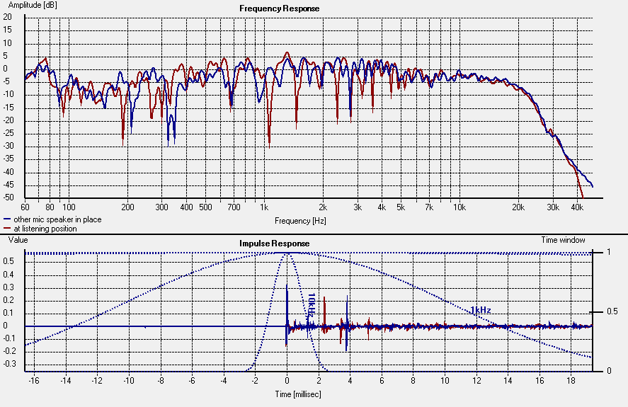

Thanks Tony!OK Well here is the completely raw response roughly at my listening position on my lounge. It is roughly because I had trouble getting my mike to sit properly so it is a little bit lower than it should be, probably about 15cm lower.
Also attached for comparison is 1/32 octave smoothed (using holm impulses complex smoothing as it shows the dips much better) and 1/16 octave smoothed. and just for the fun of it a 1/3rd octave smoothed (normal amplitude smoothing) curve. You can see why manufacturers show graphs with 1/3rd octave smoothing!! The hump at 60Hz I suspect was a car driving into the garage downstairs as I was taking the measurement. The woofers should be down about 10db at that point. Resonant freq of the box is around 82Hz, the intention is to cross to the subs at 200Hz.

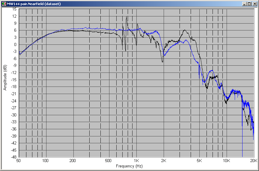

Oh and I forgot to answer your query as to what my woofers are. The are Morel MW144's. If you saw the near field response earlier in the thread, then you will be able to tell that pretty much all of the response irregularity up to 2Khz is either baffle diffraction or room interaction.
Tony.
I used to own some 164s many moons ago, and I'll look for that near field response.
That 60Hz bump could well be a room mode. Off a single point it's really hard for me to tell where your room is going modal. Can you post more graphs overlaid from points around your listening position? This helps the modal region stand out in my room and I suspect yours will be the same. Another thing that's interesting is how little comb filtering you are getting where your directivity is narrow. Is that graph just one speaker? It looks like one speaker from what I've done. FWIW, I don't think comb filtering is as bad of a deal as many people believe. The ability to hear through the room has been demonstrated. In any case, if you believe Dr. Olives research, we should eq above the modal region in pseudo anechoic conditions, and eq the modal region from the in room response. My personal problem with that is that I cannot get the resolution I would like from my pseudo anechoic measuring position in the 200Hz - 800Hz for a good EQ setting. I think I need to do that region near field for best results. That's what I believe my room response graphs are telling me and thus the reason why I think the room response from multiple positions in the listening area past the modal region is somewhat useful.
Another thing that's interesting to me is that my 600Hz(ish) bump isn't obvious when listening. It might be for Harman's trained listeners however. The same size bump, but narrower band, off axis at 2 kHz seems completely obvious and painful to even me.
I should do some more measurements today. It will either refute or support my current belief(s).

I had another at listening position measurement, this one with a different mic (not on the wand) which was able to be better positioned. I've attached. blue trace is the newer measurement, both 1/16th octave smoothed. and it would appear that the 60Hz bump is real, might explain why I thought the bass was better than I expected it should be without the subs. Oh and yes you are right that is with only one speaker. It was when I had the two notches and didn't have enough components for two crossovers! I could do a stereo measurement now if I can keep my 2yo out of the room long enough 😉

Note that this is a raw response graph. there is NO smoothing at all, what you see is what you get. measurement taken about 5mm from one woofer only. I don't think it would be possible to get a reliable nearfield measurement of the two woofers running together due to the interference that would occur when too close. I also did a groundplane measurement which I have at home.
