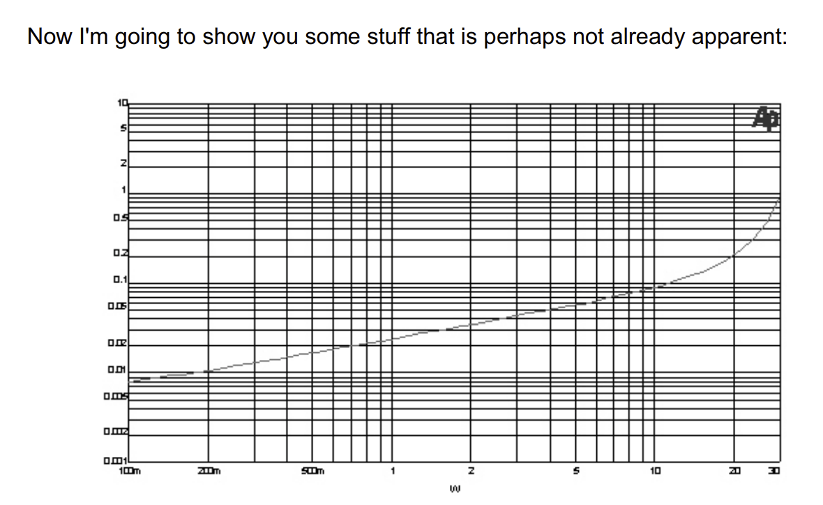

Ok, I was comparing with your curves in SE amp specs like this:You are looking at noise at low levels. The analyzer makes no distinction.
https://www.firstwatt.com/pdf/prod_j2_man.pdf
Here the distortion seems just to drop with output level.
Does the analyzer here make a distinction?
It doesn’t drop with output level. It increases steadily and then rapidly towards the 1% level @ full output.Ok, I was comparing with your curves in SE amp specs like this:
One graph however shows a drop in distortion between 200hz and 2khz.
The J2 amps distortion drops with output level?
I was looking at graphs like this (0.007% at 100 mW or so (without any global NFB?)):
How low would this be at 1 mW? 🙂
Maybe, 100 mW is quite loud in a sensitive speaker so maybe 1 mW is audible.
Should be easy to make an experiment......
Are you referring to the figure in Waynes post? If so, I don't think the higher values at lower power really indicate higher distortion. With such measurements, the readings at lower power are usually swamped by the residual noise in the system (amp + test equipment), which then shows up as a signal relative to the fundamental test signal. The "straight line" decrease up to about 10 Watt is most likely just this noise effect and has nothing to do with non-linear distortion.It is interesting to see that at very low output levels the distortion goes up.
As is said, analyzer can't distinguish noise from the distortion. Both are deviation from the original signal. Visual difference between J2 and X600 distortion graphs comes from distortion difference at higher powers. J2 has high distortion and X600, actually has less than 0.001% up to 30W. Almost all measured below that level is noise. How so?
Let’s check what would be AP measured distortion of a zero distortion amplifier that has 100 uV output noise. As that noise level is constant, we have just to calculate simple ratios of output voltage at some power level and that 0.0001 V noise/distortion.
100 mW/8Ohm = 0.894 V -> 0.894/0.0001 = 8944
Now just calculating what percentage of our 100% signal is that 100 uV deviation 100% / 8944 = 0.011%
Using the same procedure, 100 uV noise contributes as 0.0035 at 1W and 0.0011 at 10W.
Comparing calculated points with the actual measured “distortion”, conclusion is clear. X600 behemoth has distortion less than 0.001 at any power level below 30W. 😀
