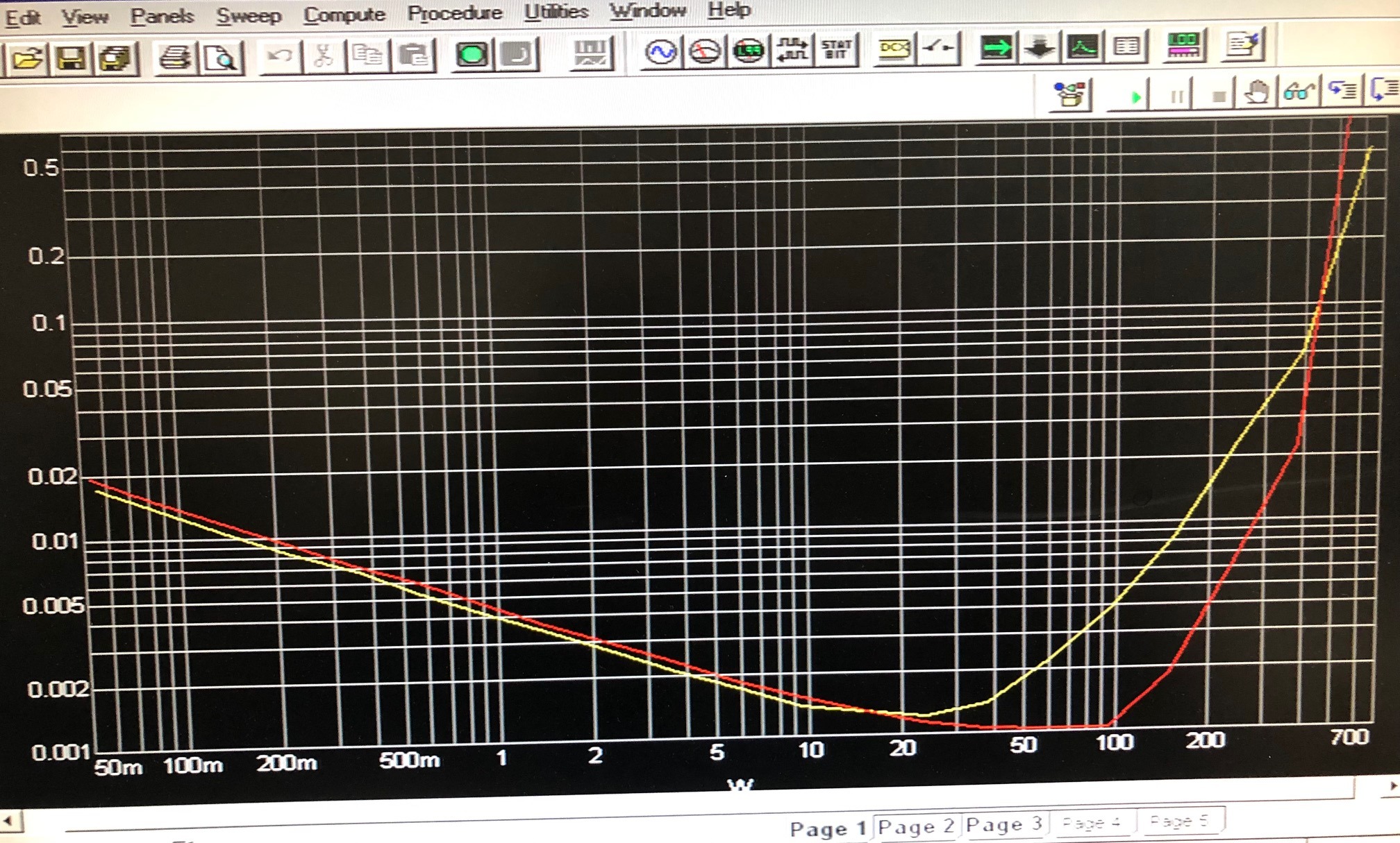

Sorry for delay. Was travelling.I would like to know your informed guesses.
Seems a bit late now since you may already know the answers from more knowledgeable people. Still haven't had time to read your report, but I'll still guess even at the risk of being wrong.
- Lower mains voltage - seems likely. Provided some suggested calcs for demonstration in another post. Nelson further offered direct confirmation re: what might be expected with a 10% reduction in mains voltage.
- Altered bias settings - definitely
- Different methodology for measuring 1% distortion
- Different 1% distortion spec perhaps (THD / THD +N)?
- Variance 'stacking' -- This one is 5% 'high', this one is 5% 'low' => 10% deviation. We do repetitions in my field to help eliminate.
Again... all guesses, and as previously stated, I'm often wrong. Sadly, this seems to have devolved a bit more. I hope I didn't contribute to that. Again, I hope you determine what you're looking for re: the differences in measurement technique and results. If anything, many people may learn just how 'easy' it can be to have such vast differences in reported performance with just a few 'seemingly minor' changes to operating conditions and measurement techniques.
I'll be watching from the bleachers now. I type too much anyway.

At 8 Ohms I pressume? What's the issue then? Is that the red curve doesn't reach the 600 Watts and the reference does.Here is a 600.5 graph on my computer. 600 Watts @ .5%
A comparison of one with an issue and the reference.
- Measured vs Specified power ratings of Pass X600.5
