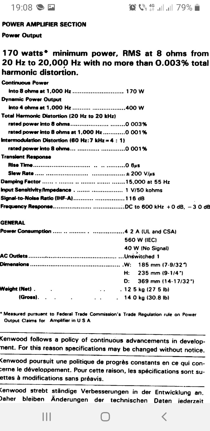

I attached some specs of a Kenwood amplifier made in 1980 to make a clear statement of what I consider real value high end specification in contrast with today's mambo jambo
