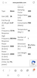

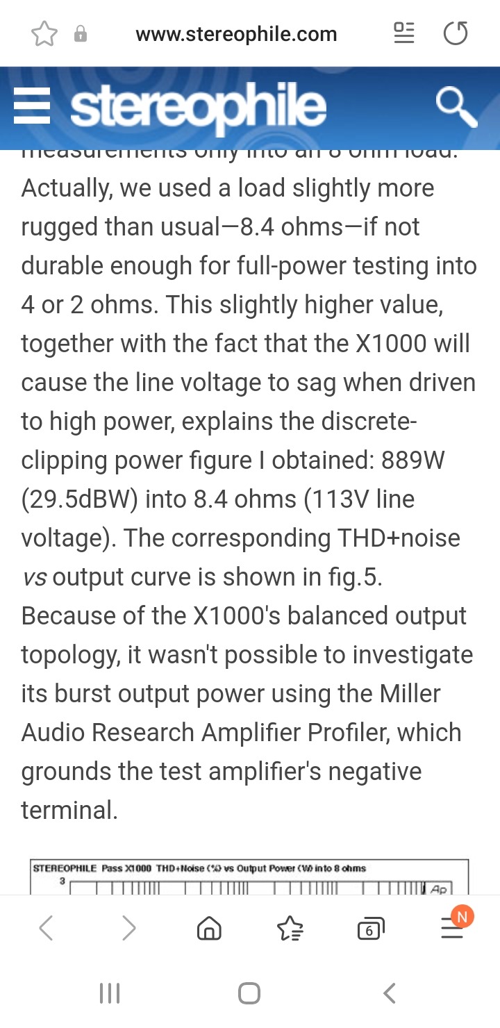

So Stereophile, which is a professional reviewing publication for decades say they can't afford a power line that wouldn't sag at least 1000 watts.
I live in a 50 years old comunist block having its mains powered by the worst aluminium wires ever made by the romanian communist industry and my power line inside the apartment is at least 6 meters long to the first mains socket yet if I put a 2500 watts heater in the voltage goes from 230V to 210V ac ...
Now I want to understand what line sag are they talking about at 113V...I thought
the american standard was 110V... They did continuous power tests, they complain of not being able to do burst power tests.You are able to measure the line voltage sag with a 10 bucks multimeter in a continuous test...
So who's sagging here: the mains or the amplifier?
Why this fuzziness? Because they are talking about NP and they can't allow telling strong words...
Then SNR at 82.5db A weighted...really? I won't comment on distortions, Pass amps are known for their distortion signature , but my phono preamps have better SNR than this power amp...
All sorts of excuses not to measure max power into 4ohms. Or into 8ohms 🙂
Did they wait for Atkinson to go on leave?

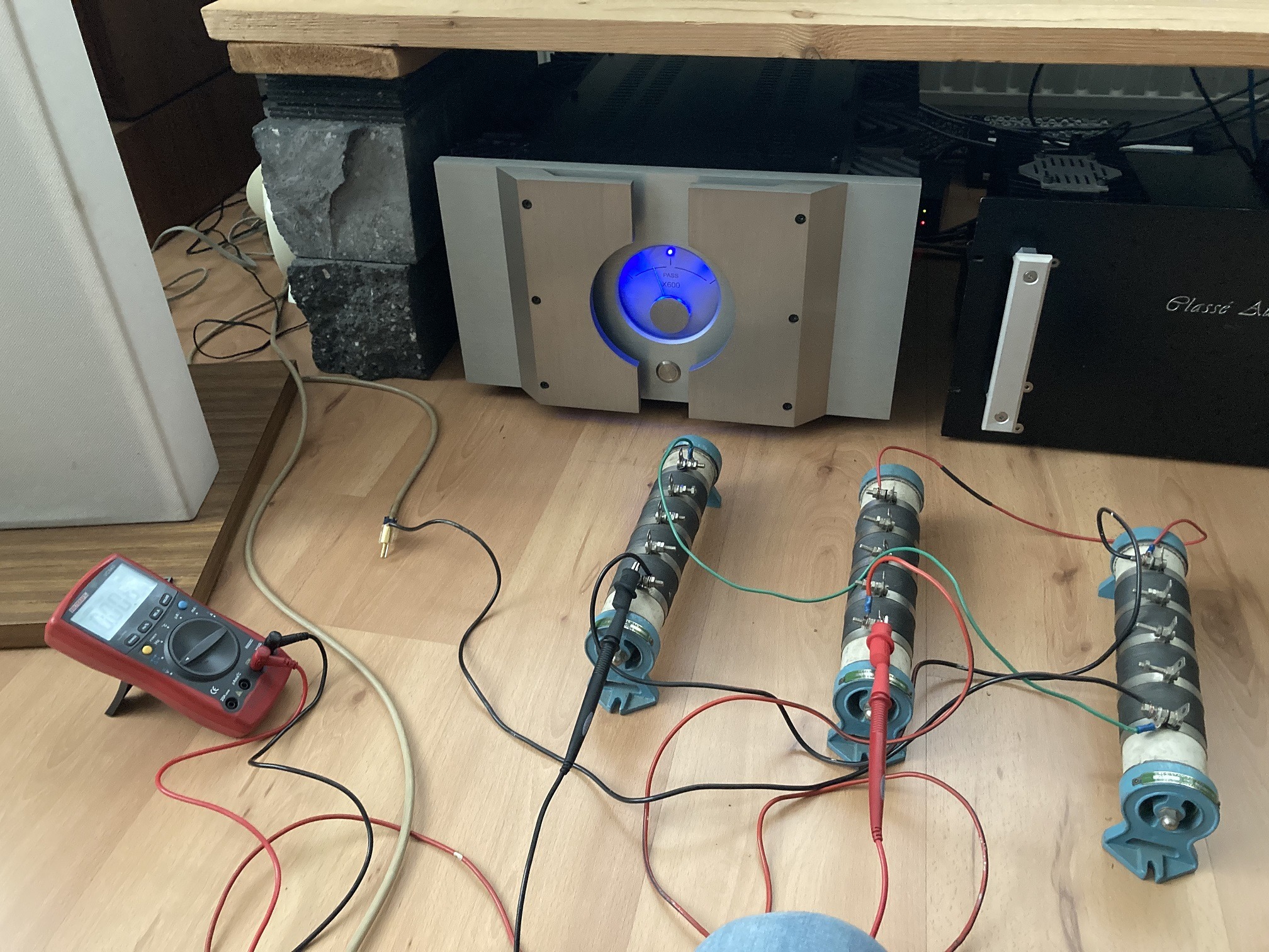

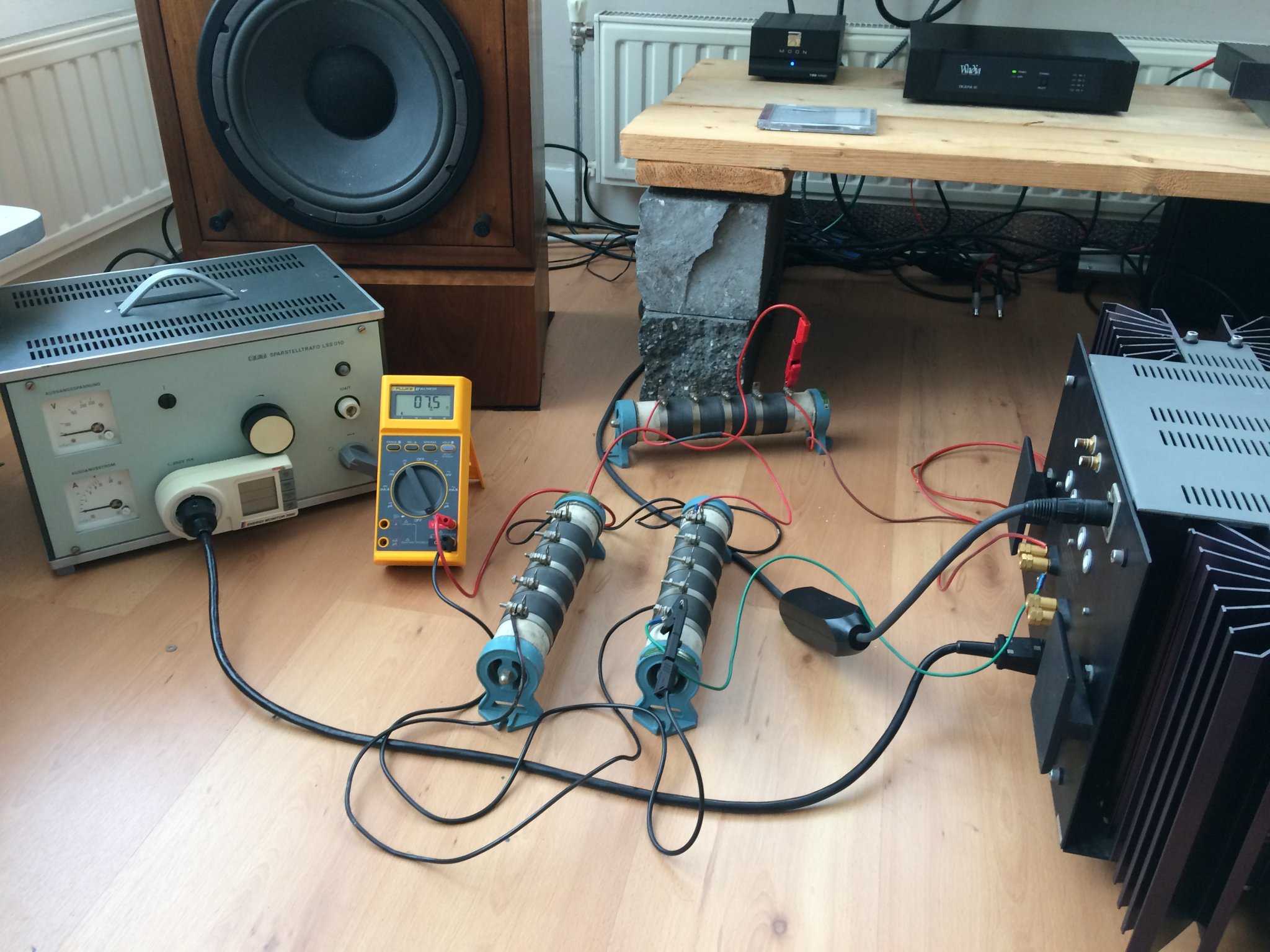

As said I have 30 Amp Powerstat from Superior Electric or a Philips 23 Amp Variac to keep to AC Voltage to 240 Volts.
I've a scope (not very familiar with it but when the perfect sinusoidal starts getting flattened it is probably distorting) and a MM and some poweresistors, 5 of 3,7 Ohms 40 Watts which I can arrange in a 4 Ohm fashion maybe although the powerratings are not sufficient for 600 to 1200 Watts.
This is a setup I once used:

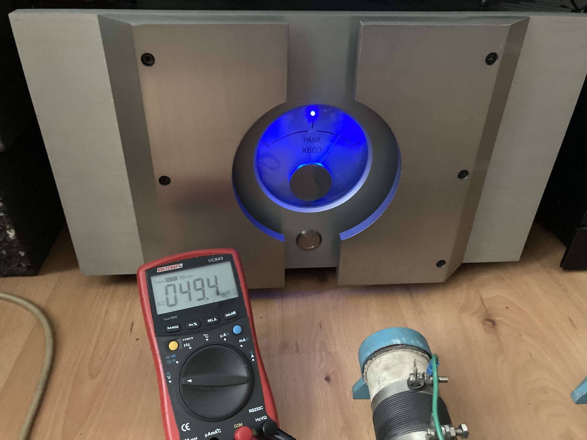

With the Pass X600 I didn't dare to go any further than 300 watts (almost 50 Volts output) because the powerresistors were already singing with the 1 kHZ tone I fed them with.
Right (third) picture I tried in a crude way of course to measure the Class A output of a Krell KRS100 mono amplifier at 8 Ohms (actually 7.5 Ohms) which was 177 Watts RMS if I remember correctly.
Well ...then raise up the ante and buy a proper load resistor if you really wanna know the truth! If, after all that hurdle , the measurement will be low you have one more step to follow: measure all the filtering capacitors according to their datasheet.If everything is right and the measurements are still wrong , then you have a case.
