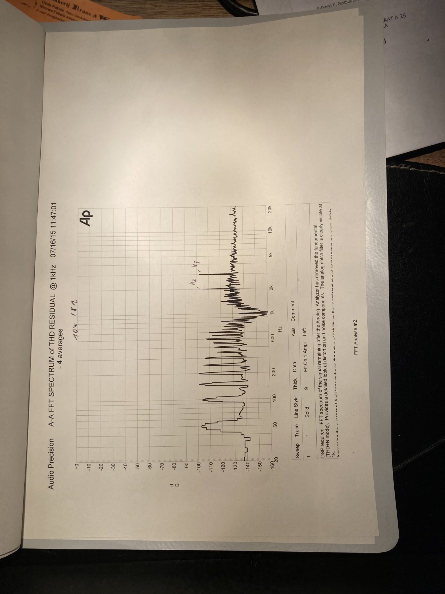

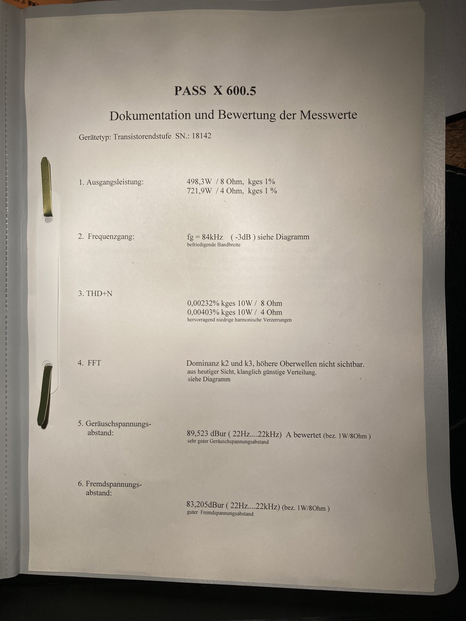

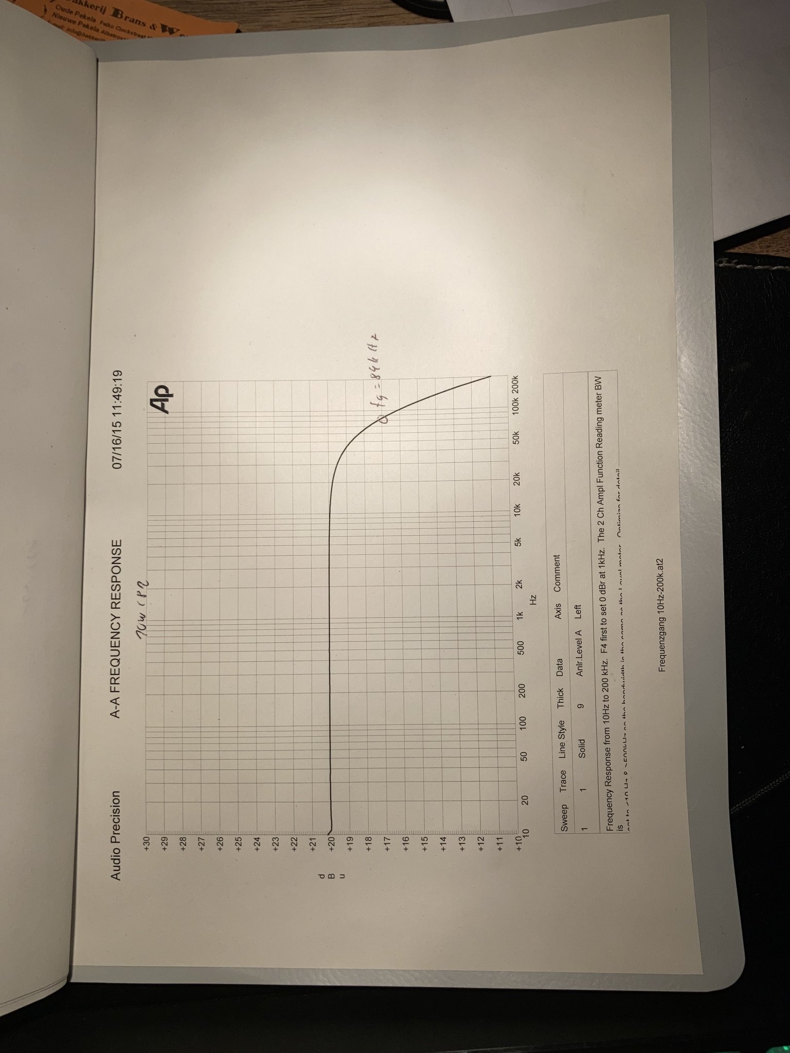

Please share them with me then...You're asking fairly pointed and bordering on accusatory questions re: PL, but you haven't posted the report from which you back your premise for contention. However, with Wayne's and Nelson's posts, I now fully understand the generalities around PL's specs., and I can make some informed guesses re: why the engineer's report and PL's measurements differ.
I will make photographs of every page of that report the engineer made if that will suit your needs. You won't find the parameters you want to know about the power ratings though and that's why I asked the engineer if he can stipulate how he made those measurements.
Well Root Mean Square doesn't mean peak, dynamic or music power as someone stated as a possibility for the discrepancies.It's also important to note that just saying "RMS" does mean a sustained measurement for a short period of time. Unless you site a particular standard / test process, equating RMS with a sustained measurement is not very meaningful (to me).
Let's wait for the engineer to answer how his proceedings led to the especially low rating for 4 Ohms.

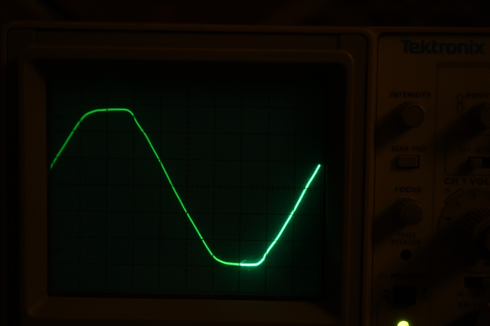

This is how my 230VAC often looks like.
The top of the sinus if often cut because a lot of electrical equipment uses SMPS which drains the energy at the top of the sinus.
This was the explanation from the energy company. I think they know that they are not "compliant".

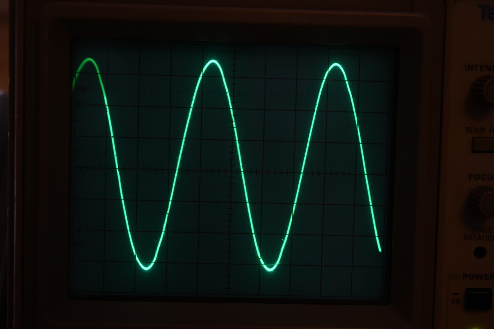

This is how it looks at output out of a PS Audio power plant.

Thanks and very insight-full those sinus waves.This is how my 230VAC often looks like.
You need at large one for the 600.5. I have a small one which is fine for many of the smaller amps we build in this forum.
To test max. power you need a powerful load resistor or build an array of many smaller e.g. 20 - 50 W resistors.
If you to start at the top one you depict then your already in a disadvantage to reach the max powerratings as I deduce from NP's statements.
Yes, my AC from the wall could not be used for a max. power test of the 600.5 if spec. results are expected.
If the AC showed was the starting point it would just be worse during the test.
The PS-audio power plants have very little distorsion and are rated like < 8 mohm output impedance.
They have a funny feature so you can change the shape of the sinus, so it is wider at top in order to deliver more energy.
I think the RMS voltage is constant so the peak will drop af bit. I have not experimented a lot with this. But a funny feature.

His conclusion on page 3 is:Thanks. My German isn't great,
"This Pass X-600.5 shows after service in general good results.
Especially the very low THD and the signal purity based on the spread of second- and third order harmonics.
The bandwidth is something special because it's confined like with many Pass amplifiers."
So he's praising them and he has experience with more Pass amplifiers so it seems.

Was just reading through this thread for good entertainment, but feel I have to point out one little thing which seems overlooked.
In the report from the German engineer it says "stromaufhname 405W". Now my German really isn't all that great, but I guess this would be something like "Strømforbruk" in Norwegian or power consumption in English. I can of course be wrong, but from a quick search it seems this is about 150w short from rated specs, which to me sounds like the amp is 1: running on lower mains voltage than intended or 2: has been serviced by environmental activist at one point in life
