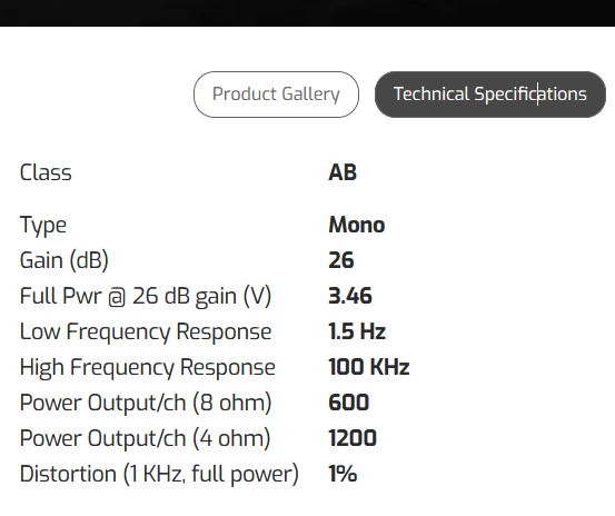

I just wondered why the specified values especially in the 4 Ohm region are so far of the measured ratings which were made by an engineer that repairs highend audio for a living for more then 20 years. Of course he cab be wrong but the values that were given by Pass Labs regarding the powerratings are not clear regarding the circumstances:
Wayne Colburn says they were made through a 1 KHz sweep and not to be taken as continuous values and now Nelson Pass says these are RMS ratings across the full audio band and with a proper AC of 240 Volts they will even exceed the Pass Labs specified ratings.
So what is it? Or can't I ask these questions without starting a panic and having a Krell in mind supposedly?
As far as I'm concerned this is BS. Those are rms ratings, and if the amplifier in question is given an undistorted 240 volt ac line it will exceed its ratings across the audio band.
Haha, that's a clear statement from the man himself. So I see this as an addendum to the PL specified ratings and not in accordance with this statement from Wayne Colburn:

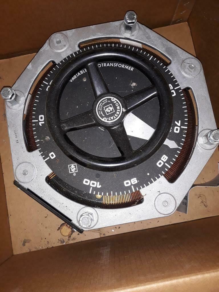

A Variac is not required. I use a 3 KVA Powerstat from Superior Electric, but a stiff AC line
source can give you some good estimates.

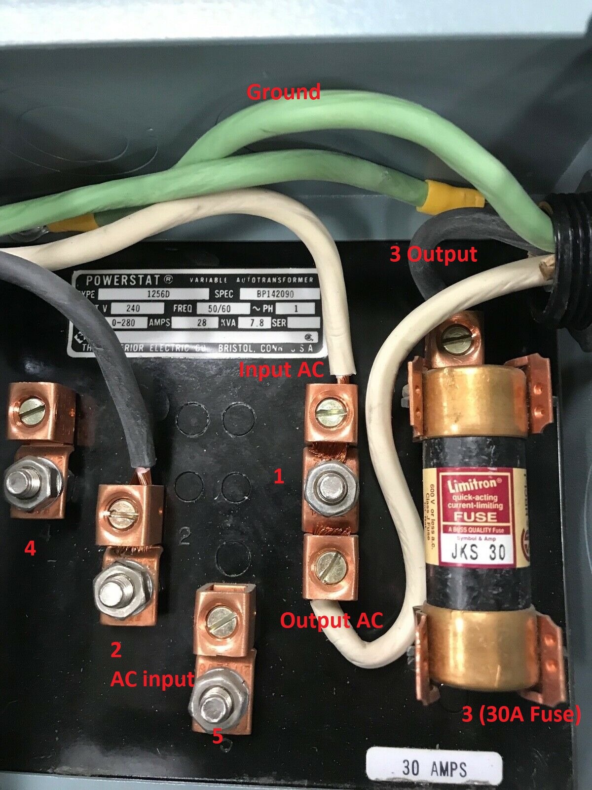

I'm reading them all but maybe I have a hard time understanding them properly. Yes I know how to measure the rails but apart from a 28A Superior Electric 1256DU Powerstat, five 60 Watts 3,7 Ohm powerresistors and a Fluke 27, I have no system to measure those huge wattage's as (german) Audio magazines have and professional repairfacilities. So tell me what to do Zen Mod.

Powerstat 1256DU top in box.JPGI've this from Superior Electric,

And I agree a 20% drop in the AC value will explain the 500 Watts reading at 8 Ohms. So something is wrong with the 4 Ohm reading and I hope the engineer can shed some light on it.
