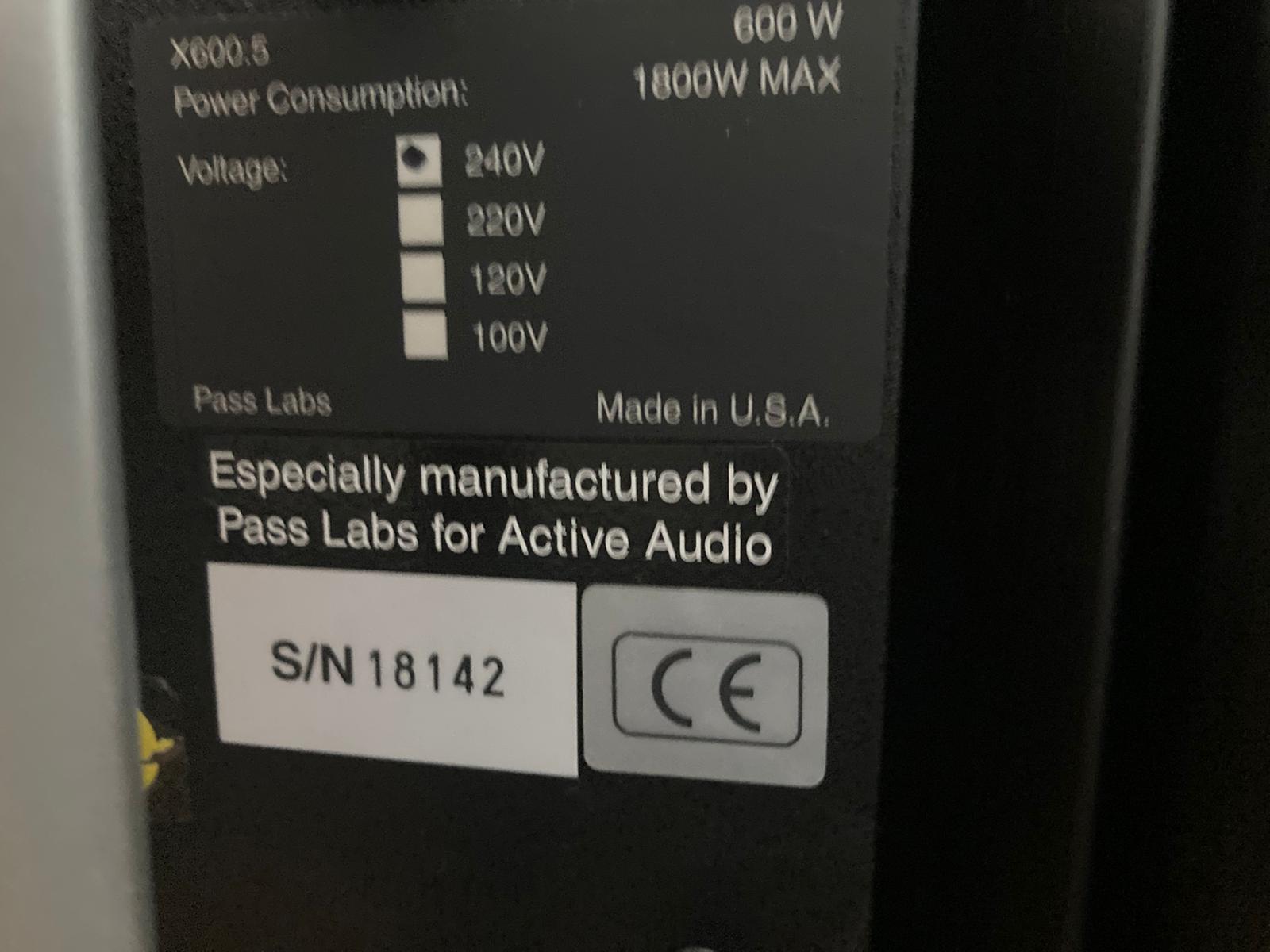

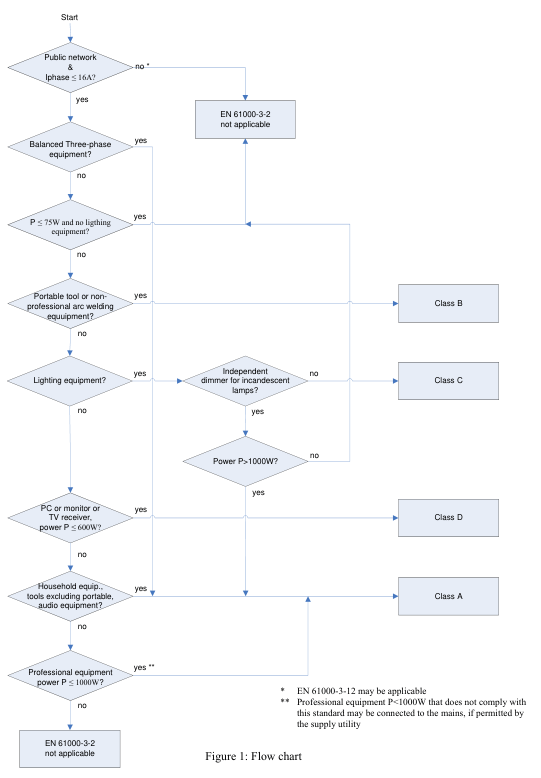

Anyway, that is interesting, because that's fundamentally different than EN61000-3-2
Meaning that Pass Labs is not compliant with EN61000-3-2.
I gather that the given specifications by Pass as provided and available on their website, do not comply with those rules because the context is not given properly?
But before jumping to conclusions I can contact the engineer that made those measurements next week due to illness on his side.
I don't need measurements, but EN61000-3-2 very clearly states that any PFC testing is mandatory for audio devices with a power over 75W (Class A, as in Class A of the guideline, not amplifier Class). From experience I can tell that in general a linear power supply above 75W is not gonna comply with this these days.Sorry, should have provided the link instead.
Meaning that Pass Labs is compliant with US, 16 CFR Part 432 but NOT with EN61000-3-2.
In simple terms that means they can't be sold to consumers in EU.
Oh btw, if I am not mistaken (but correct me if I am wrong), a standard breaker in the US is 13A ?
Meaning any amplifier can't go over 1495W continues anyway.
But that's without any (additional) safety margin.
Okay clear, but they have the CE compliant sticker on it:I don't need measurements, but EN61000-3-2 very clearly states that any PFC testing is mandatory for audio devices with a power over 75W (Class A, as in Class A of the guideline, not amplifier Class). From experience I can tell that in general a linear power supply above 75W is not gonna comply with this these days.
That's is VERY interesting to say the least 🙄Okay clear, but they have the CE compliant sticker on it:
Again, as far as I know from following EN61000-3-2 and assuming that this device has a linear power supply, I don't think this product is compliant to be sold and imported within Europe.
Fact is that CE is within the responsibility of the company itself.
CE also holds al lot more than just this, like safety standards etc (which is a different thing)
But since EN61000-3-2 is mandatory, they must be able (and have the obligation) to provide their test results from the notified body (aka "lab") they went with.
As far as I understand, the X600.5 was produced in 2016?
That would mean it also had to comply with EN61000-3-2.
Assuming ONLY for sales within EU, for US there are other regulations.
