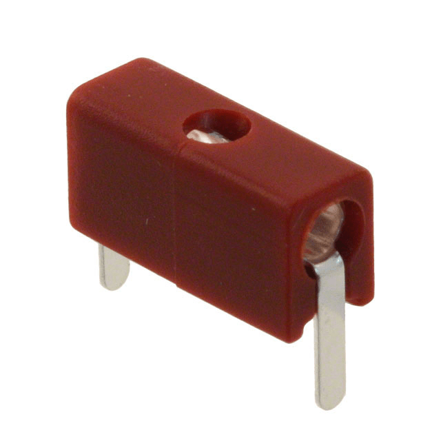

For the collector test points, something that will stick up less than mini-grabbers, there are these cool multimeter probe-tip jacks from Cinch Connectivity.
105-0752-001 Red
105-0753-001 Black
There are more colors.

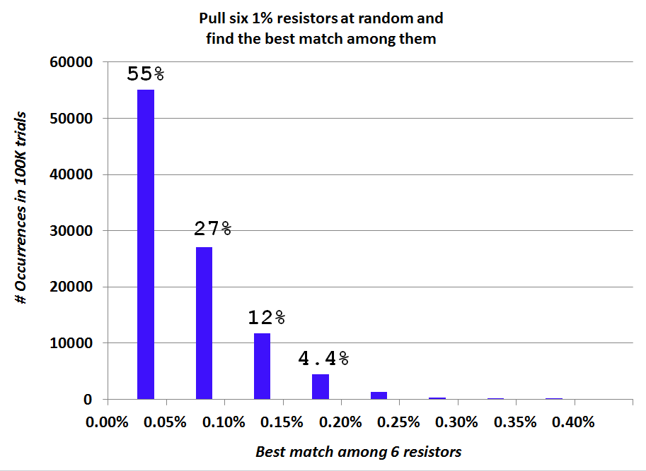

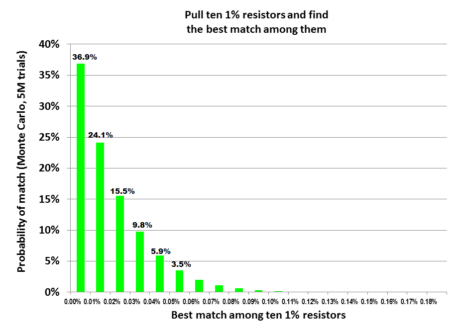

Maybe this older thread might be useful: Resistor matching error starting with six 1% resistors
The somewhat surprising result from Monte Carlo analysis (100,000 trials) was that 55% of all trials found a resistor pair whose mismatch is less than 0.05% {blue histogram} . And that's from testing only six 1% resistors. If instead you purchase and test ten 1% resistors, >76% of the time you get a match better than 0.03% {green histogram}.
Assuming of course that your measuring instrument(s) are up to the task.
