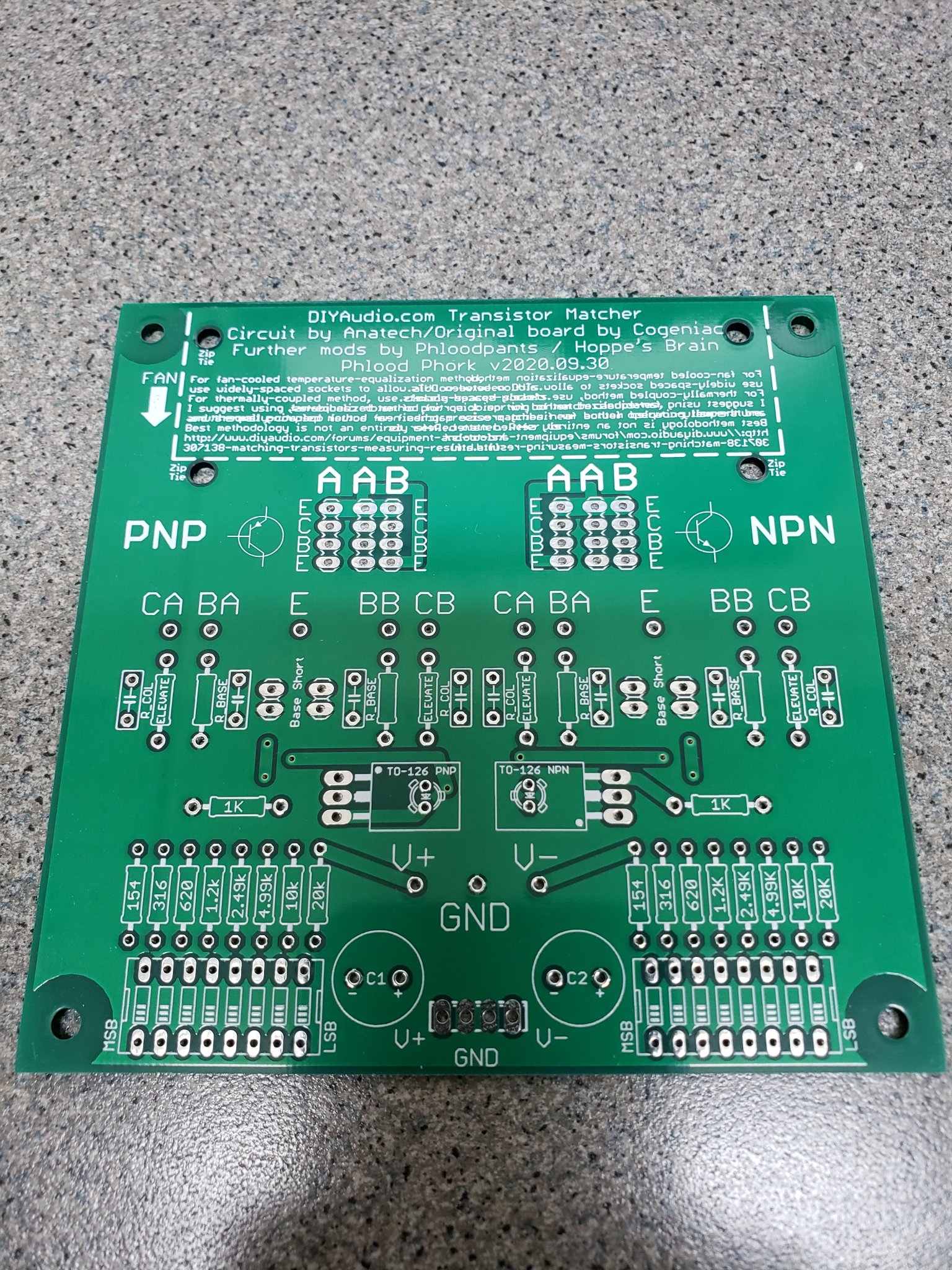

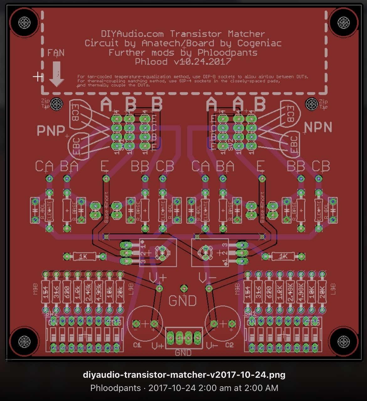

I had 5 boards made using a slightly modified version of of Phloodpants' Eagle files found on post #259 (removed the fan footprint and text Credit text) I have 4 extra boards. PM me, if anyone wants them for the cost of shipping. (I got a discount deal for my first order from JLCPCB) I figure that's the least I can do to give a little back to the community that has taught me so much.

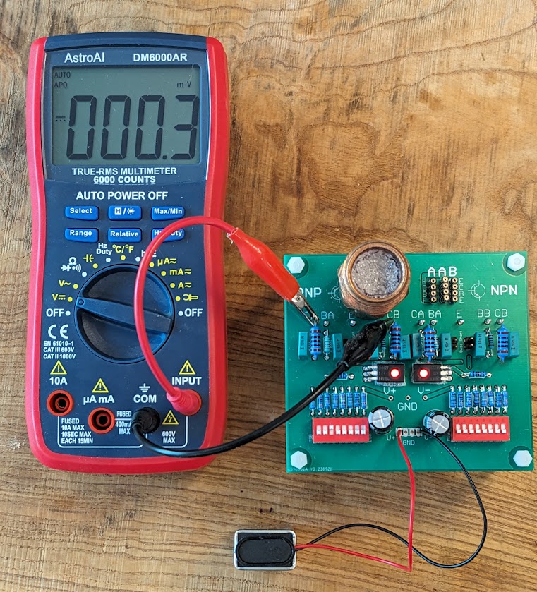

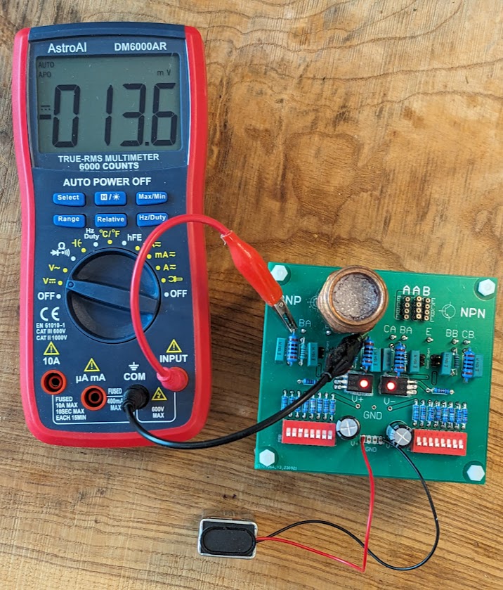

All the photos below show measurements across the collector voltage difference between transistors A and B (2N5401 PNP's) at 1.9 mA measured base current in both A and B transistors (jumper 3 on the PNP DIP swich resistor selector at bottom left of the photos). I like the ability to check the base currents using the jumpers provided on this version of the board! Resistors used at the DIP switches are (L to R) 154r, 316r, 620r, 1.24K, 2.49K, 4.99K, 10K and 20K. I can tell this is a sensitive jig, all I have to do to change readings is touch one of the transistors, and the voltage difference either increases or decreases rapidly, only to settle back once the DUT temps have stabilized. So far so good!
- The first photo (below left) shows the difference in collector voltages between one pair of transistors that was preselected with the same HFE (158, using this meter's HFE function) after sitting for over 5 minutes, while the voltage settled. I switched the transistors from A-to-B and the voltage difference was the same but negative.
- The second photo (below center) shows that adding an insulated copper shroud (a plumbing fitting with foam around the inside and top) after the voltage settled shows a minor difference in voltage from the unshrouded measurement, I believe it mostly ensures the air currents are not having an adverse impact.
- The third photo (below right) shows the voltage difference between one of the initial transistors and another with an HFE of 176. This proves to me that pre-sorting according to HFE saves time and gives me a better starting point for finding matching transistors.
- Is it a problem that I don't have a Zero volt supply? I did move a battery lead from the negative supply to the neutral, and the difference in voltage dropped significantly in all cases, even though when that happens, the right side LED turns off (I would have thought that by powering only one side, the voltage and current would be higher, not lower - but maybe that's what's causing the collector voltages to get closer to each other?)
- I understand that by comparing collector voltages between transistors A and B I'm looking for zero volt differences. Is the difference in voltage I see at a steady room temperature of 20c or 68F (with or without shroud) a close-enough indicator of the true collector voltage match between the two transistors, or is it worth trying to get the transistors to a more realistic (higher) steady operating temperature around 40c or 104F?
- Once I had a pair close enough (.3mV collector voltage difference @ 1.9 mA base current) I tested various jumpers at the resistor selector to see what happened when Base current increased or decreased). When I reduced resistance by one jumper position (#3 to #2) the difference from A to B collector voltages almost doubled. When I increased resistance by (#3 to #4) the the difference from A to B collector voltages almost halved. Is this what others have experienced?

1. Yes, you really need a bipolar supply. Two 9V batteries are needed, connect the common to the common on the board. I use a bipolar power supply set around 11 VDC, but bipolar 9V is perfectly fine.
2. Yes it is. You may see some shift as you move on the curves, but no matter how you match them, this will occur. I designed it with selectable tail currents so you could test them at the current they will be running at. You should have the transistors in direct contact with each other and shielded from the air, then shield the entire jig from air currents.
3. Of course, makes sense. You are changing the collector currents, so your measured values will change for sure. The percentage match should remain close.

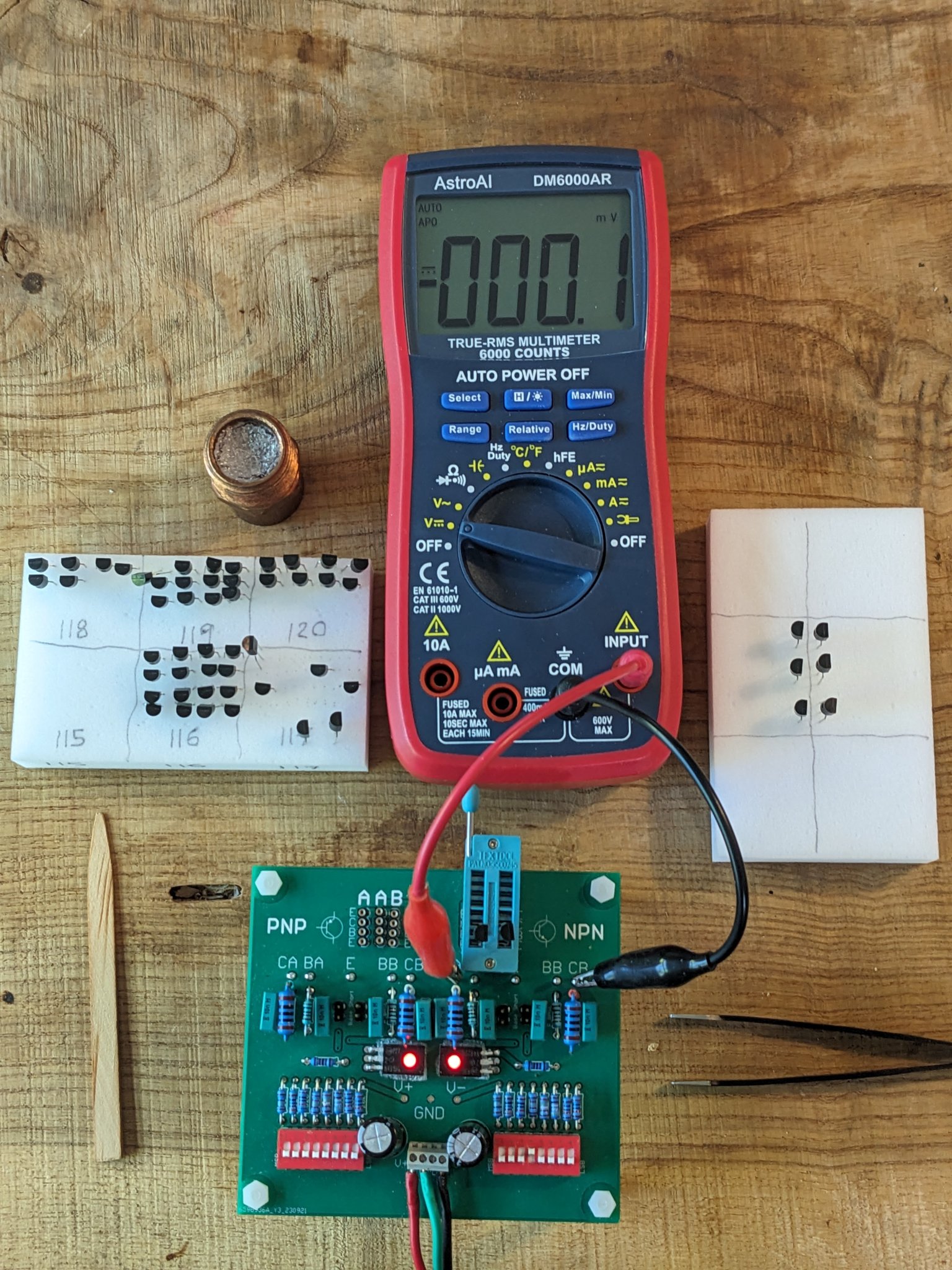

In the meantime, I hacked a temporary fix with a spare ZIF I had in my parts bin... cut off 4 pairs of legs I didn't need, to make it fit on the board. Bent and filed the remaining 4 pairs of legs, and it's a nice push-fit. There is room to get the transistors to touch, or keep them separate.
I was able to get 4 matched pairs from the preselected 117 HFE group on the left of the photo in less than 10 minutes. All 4 pairs have the collector voltages within +/- .1 mV which given the error potential of my DMM that's probably as close as I can get at this current level. I'm now using a 10V bipolar supply and the DIP switch set at 1.2k, and 620r (same readings reinforce my opinion of the accuracy of my relatively cheap DMM)
At higher currents, The 316r resistor gives a collector voltages difference of .4mV, and the 154r resistor makes the collector voltage difference 1.4 mV, but these are way higher currents than the actual circuit the transistors will be used for... any point in using these DIP settings to find closer matches?

I was going to ask ... what are all the capacitors for? Can you share the schematic? You only need to bypass the power supplies.
The nicer finish socket will allow the pins to be inserted much easier than the cheap one you have. I tried the cheap ones, threw them all out and bought good ones. This makes all the difference in the world!
Your meter is only used as a null device in this application. That relaxes accuracy concerns unless you want to figure things out. What I would highly recommend is a used HP meter, like a 34401A (I used those before the new ones), a 3457A would be excellent (make sure the internal battery is good and it is calibrated). A 3456A is good. All those meters are top of the line and you'll learn to love them! I have every meter I suggested, and most still on the bench. I've had other meters also, but if you're going top spend some money, get one of these I listed. Not unless you can afford the new current meters. Then get one of those (they have additional useful features), the trend function being valuable.
Just test at currents similar to what they will be used at. 1 and 2 mA is very common for tail current.
