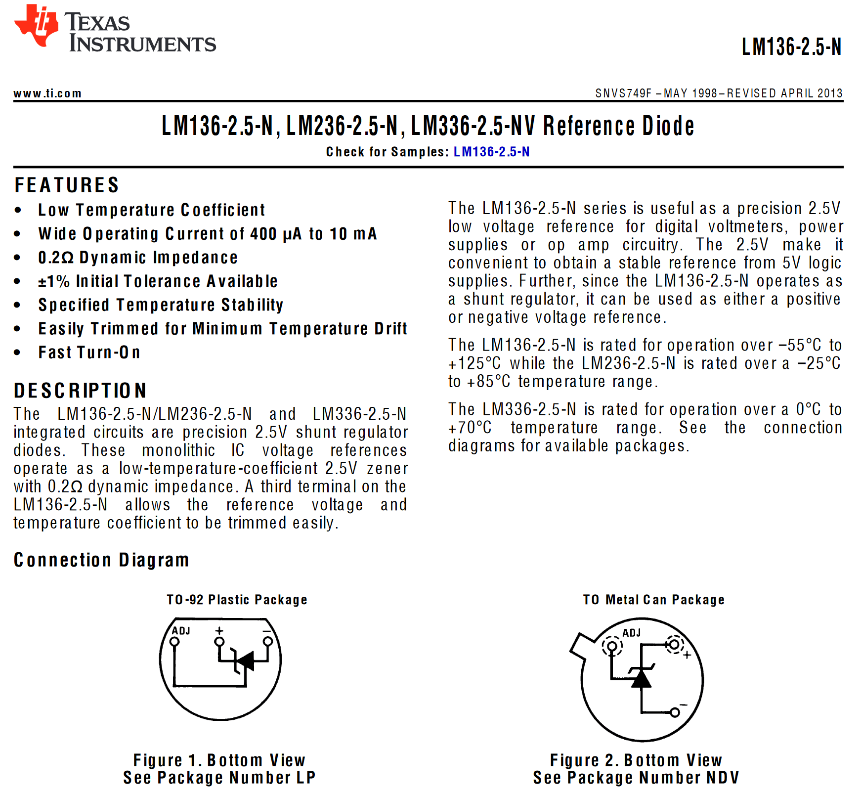

Hot tip: I've replaced the LED in my transistor matching rig with an LM336 and I'm getting much more stable and reproducible results!
Reactions: knarfor
Yes, that would be a great deal more stable for tail current. The most important concern is short term stability and the LED was chosen to compensate for temperature of the transistor. Because the comparison is made as a balance, the value of current over time isn't important really. I did consider being able to hammer the tail current to known values, but this won't affect the match. Part of designing this wasn't to make a perfect instrument but rather to make a testing device that would give very accurate results while being cost effective. The CCS for tail current was important to increase CMRR to make imbalances show up more. I could have used a resistor but it wouldn't be as sensitive then. So the impedance of the tail current source is more important than the actual value (within reason) at any given time.

I had a quick look. The resistors below the 1K1 values (and it isn't critical) are to set the tail current. They will differ depending on the transistor E-B drop and the voltage reference used. Speaking of the voltage reference, A red LED (low efficiency) was chosen to partially compensate for the temperature coefficient of the E-B junction on the pass transistors. A voltage reference IC will not do that. Also, the 3mm LED originally used does fit in the mounting hole for a TO-126 transistor and we want to keep them at the same temperature so they compensate for each other. This combination may well be more stable than using a voltage reference, but it is up to you.
The original design was to pass a relatively constant current through the pair of test transistors. This current only needs to remain in the ballpark of the intended current but remain stable over the time you are testing. A slow drift really won't affect things when checking for balance (or match). The red, low efficiency LED was picked because at a range of current, the temperature coefficient is similar to the pass transistor, which means a low rate of current drift for the combination. It does so at low cost and easy availability for the future for new builds or repair. This design is well over 20 years old, and I have made several as I wore them out through heavy use. Specialty parts would have been discontinued, so going this route was a good plan in hindsight.

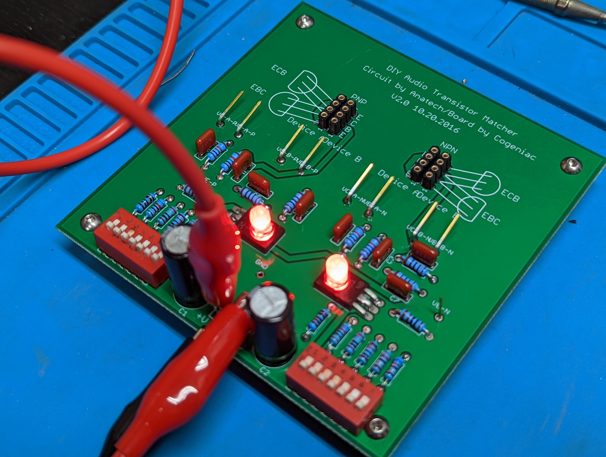

I just built the original ver2.0 board, and have a couple questions regarding my match accuracy %. I read earlier in the thread +-1mV is a good match but depends on the current, but I cannot find the equations to check.
My resistor matches; matched 4 wire with HP34401A
100R - 99.923/99.918 - 99.913/99.910
10K - 9.99599K/9.99583K - 9.99257K/9.99181K
Q1/Q2 - 2SA1381E / 2SC3503E

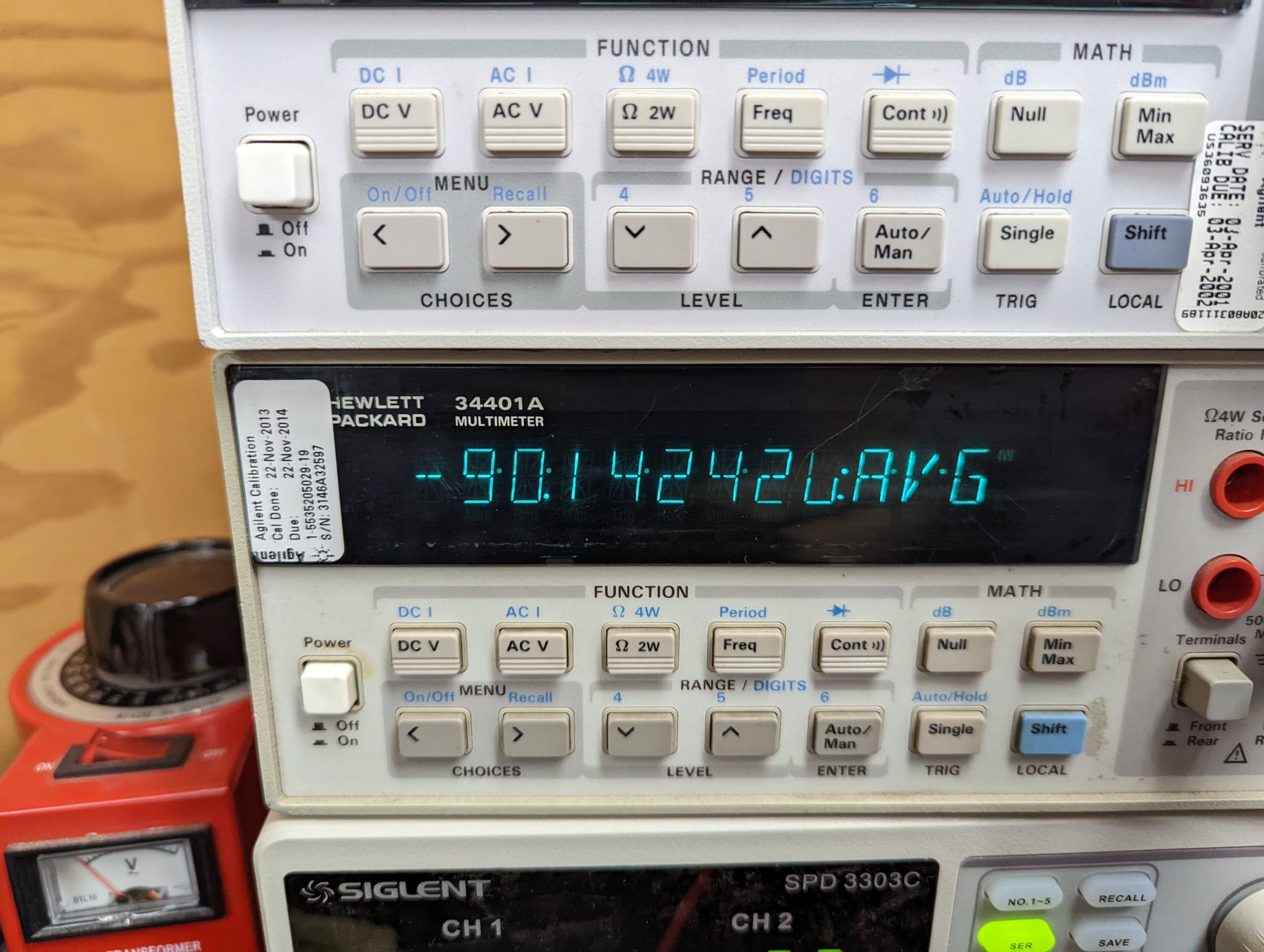

Example match on a pair of BC560C's with 5 minute timed Min/Max/Avg measurements after settling
-166.295 uV Min
-39.855 uV Max
-90.142 uV AVG

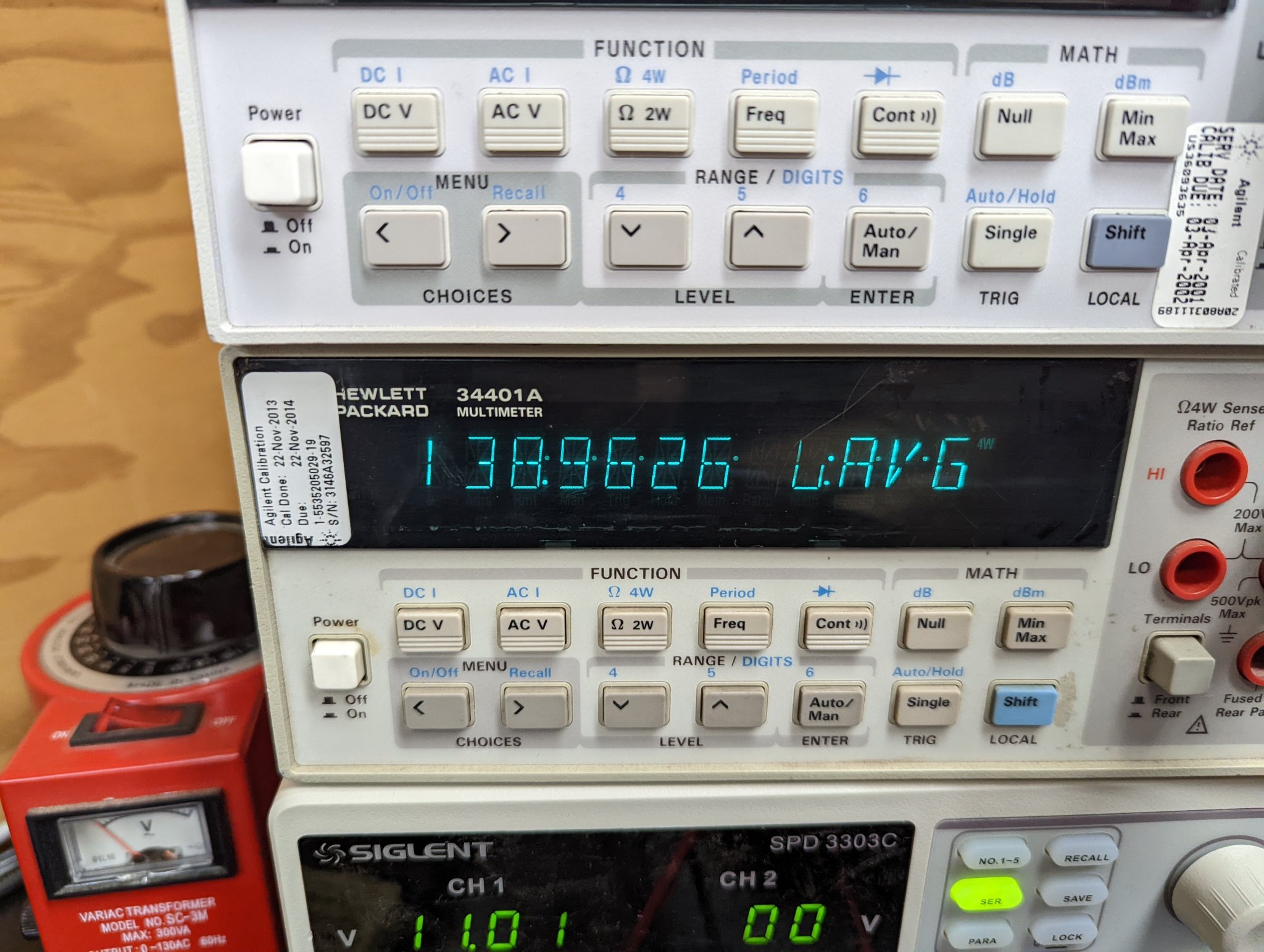

I switched the transistors around to check the balance
+69.626 uV min
+243.529 uV Max
+138.9626 uV AVG
I had dip switches 1 and 2 on which are 1k and 620R, and running +-11 vdc supply voltages.

I did use the 10uF caps, it is working perfectly. I found by leaving one transistor in and exchanging just one that you will get a feel for which transistors will match and which won't by where they start out and how quickly the readings change. My first actual match was 30 uV. I got about 5 before that match that were at about 1.5mV. I decided that was close enough and removed both and soldered them in, LOL.

Going off previous posts, 100mv over the Collector resistors 1mv would be 1%, 200mv over the resistors 2mv would be 2% and so on, I could stand to be corrected but this is how I understand it
That one works.
To figure out percentage match, simply read the current from the voltage drops across each 100R0 resistor and determine the current ratio. But basically the closer teh match is, the better. Better than 1 mV is pretty darned good and my matches are around or below that figure as acceptable. I use a 3 mA tail current as a good compromise between speed of settling and current level. Actual circuits are typically 0.5 to 1.5 mA per transistor.
