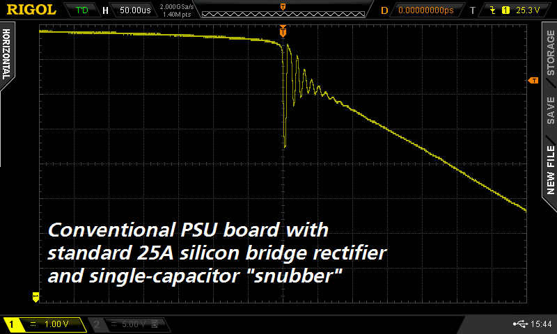

Pretty easy to see ringing -- if and when it exists. The most pernicious arises in switch-mode power supplies where di/dt is very vast.
With a torroid trafo and low cap diodes it doesn't appear to be a problem. With an EI core transformer that has high leakage inductance, and 1N4007's you can see the issue.

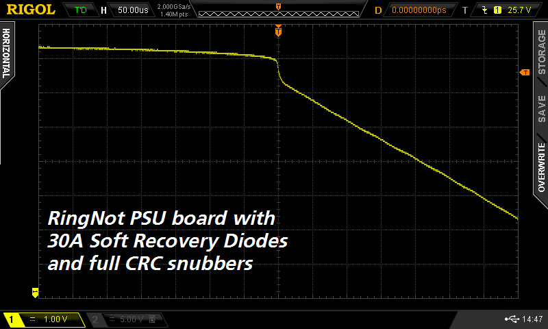

The ring me not version of transformer/diode snubber is designed, built and tested for a particular transformer / diode combination. The Quasimodo will select a snubber for a wide range of transformer / diode combinations.
Morgan Jones wrote an article, for Linear Audio, that took a close look at PS transformer / diode ringing and concluded that snubbers to damp transformer / diode ringing are largely a solution looking for a problem, ringing is the exception not the rule. (My words here).
The snubber can add noise that otherwise would not be there.

The article I wrote appeared in Linear Audio volume 10 (Sept 2015), pp.97-110. They charge €2,99 to download that one article from their website, or €19,90 plus shipping for the entire hardcopy volume, about 200 pages long.
Abstract
Power transformer secondary ringing was measured with 48 different semiconductor diodes; ringing amplitude was 10-20X lower with the best diodes than with the worst. They all rang, including Schottkys and HEXFREDs. A 1R + 2C snubber directly across the secondary completely eliminated ringing in every case.

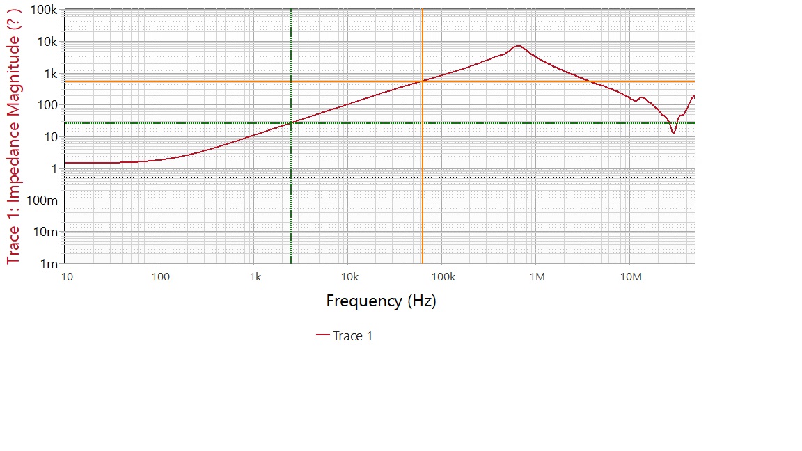

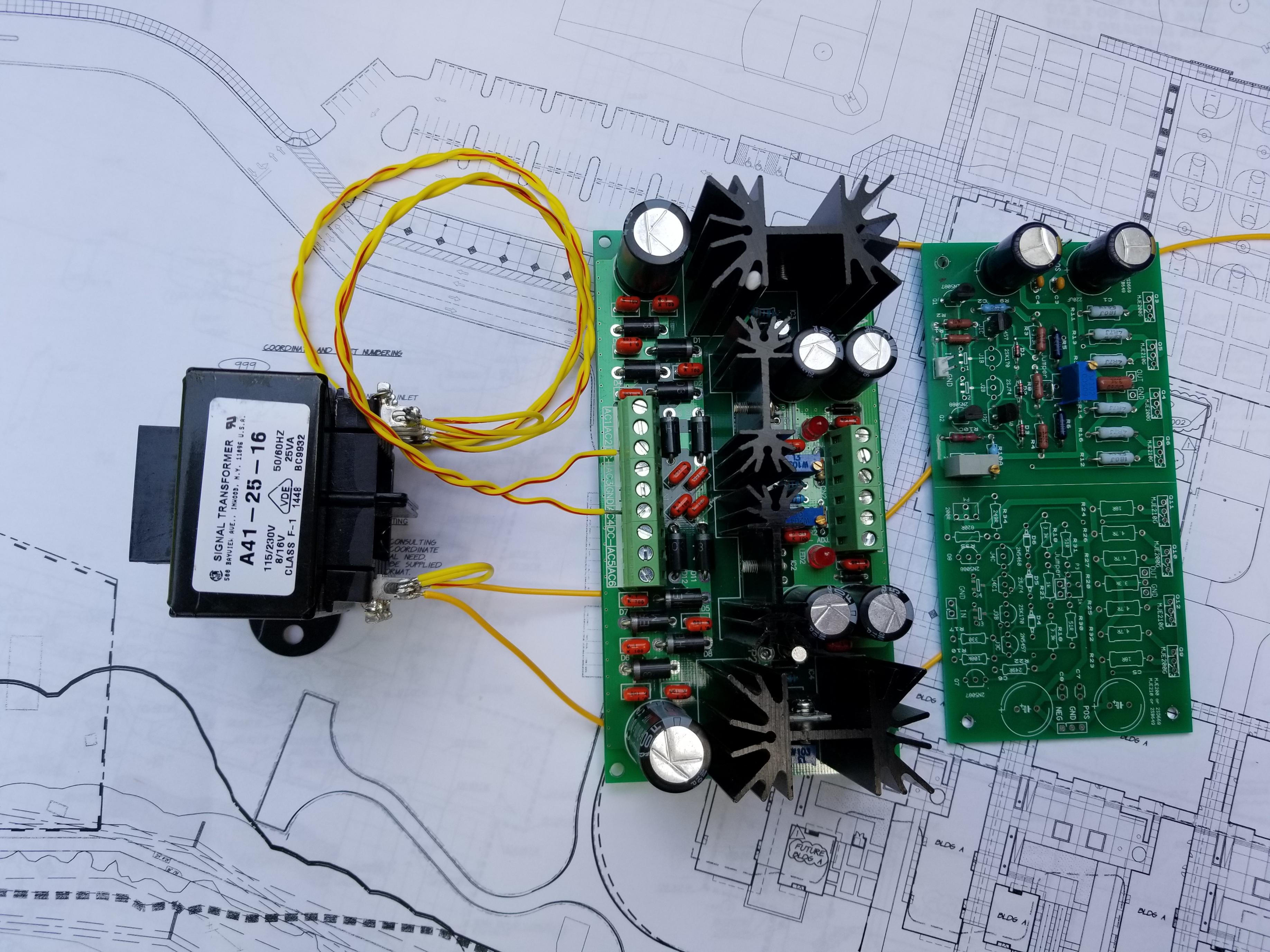

I have a couple of Signal A41-25-16 power transformers on the shelf, rectified they will put out about 24VDC. I will use these power transformers with the AudioWind regulators linked in a previous post. I am skipping using the Quasimodo snubber/zobel and come back if there is an issue.
There is an impedance plot for the Signal A41-25-16 posted below.
Also on the shelf are a couple of Silent Switchers, they will do 150ma at +- 15 VDC, that will drive a single side of the Marsh HPA.
