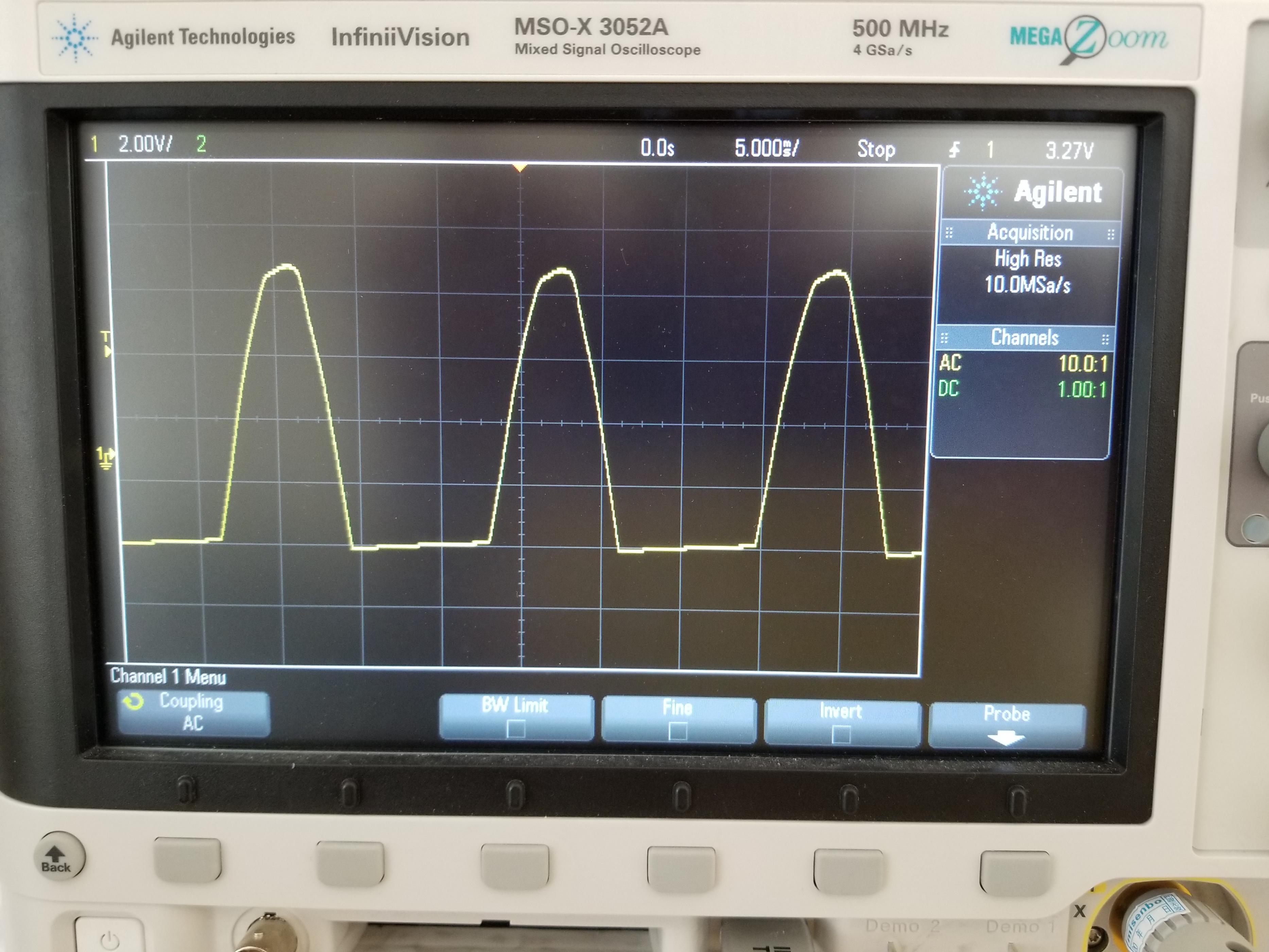

I tried, started out with a Stancor P-8715 filament transformer, 120V’s in nominal 6.3V’s out. I attached a basic 1N4004 rectifier and a 10R resistor in series, no capacitor. See the oscilloscope plot (photo) attached.
This thing is drawing over 1 amp. The top of the wave is squashed and distorted. I do not see a spike or ringing. I zoomed in to see the top of the Plot, no spike.

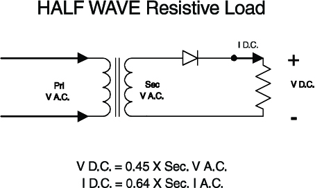

Hello Mark Johnson,
I went to the Hammond site and selected to wire up what they call “Half Wave Resistive load”; a transformer a diode and a resistor load. There was no intention to call this a linear power supply; add a couple of capacitors and maybe a inductor and we may call it a half wave rectifier with a Pi pre-filter.
I am a table top maker. I wanted to see real transformer / diode ringing on my bench. If anything should ring a “Half Wave Resistive load” should be it, especially using a 1N404 rectifier.

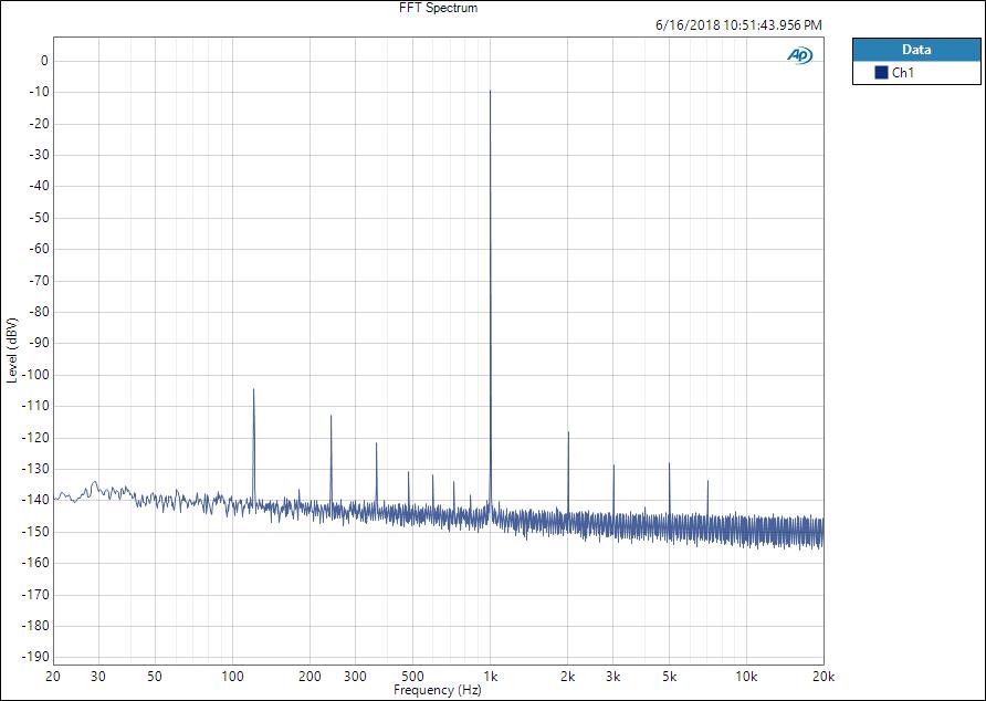

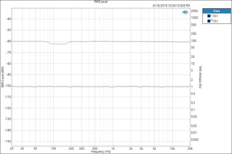

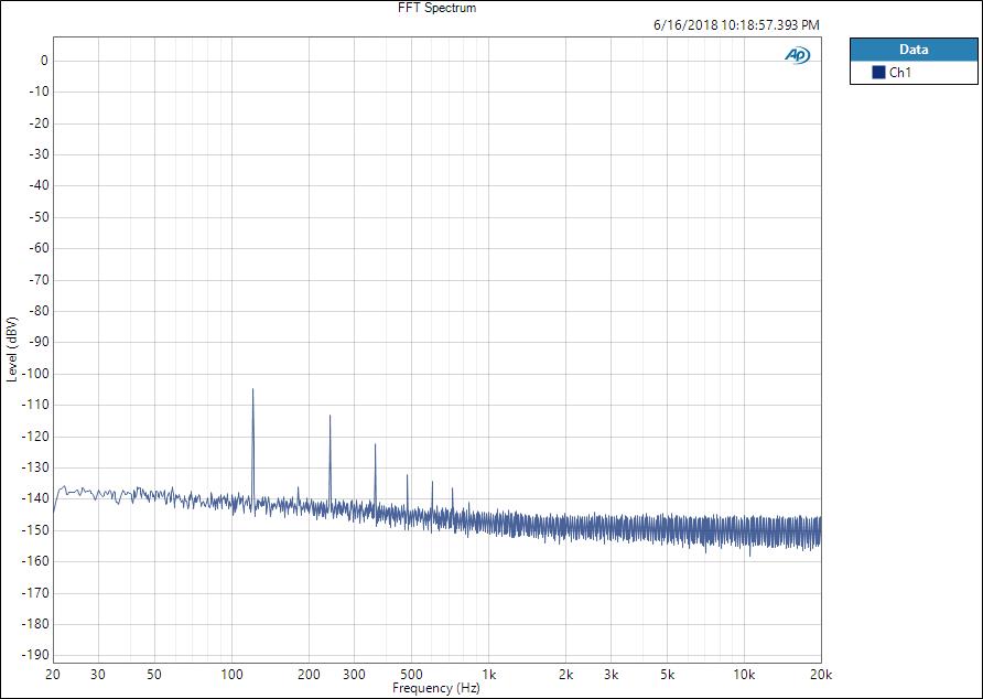

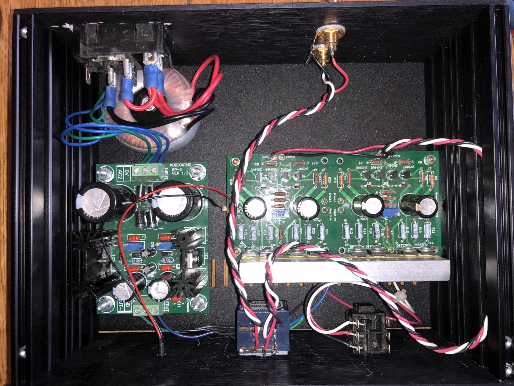

Hello,
I stopped playing around with the PS on the oscilloscope for now. I put a temporary heat sink on the M HPA and connected everything to the audio analyzer. The plots below are done with stuff sitting on the bench.
With the input shorted.
Noise 20 to 20k was 9.1uVrms.
See FFT plot below.
See THD+N and RMS level plot below. (there was no input, this is only noise)

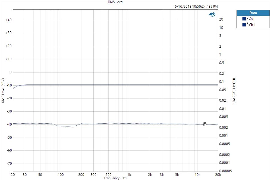

With 80mVrms input:
See FFT plot below.
Dead flat frequency response 25 to 20k
THD+N, 20 to 20k is 0.003% or better.
With 80mVrms input the output equals ~ 110dB’s at the output of my LCD2 headphones. The resistor at the amp output was 73R which matches the LCD2 headphones.
So far I am liking the M HPA results.

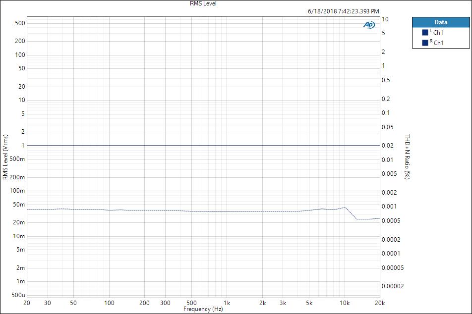

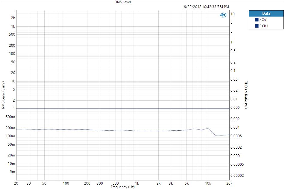

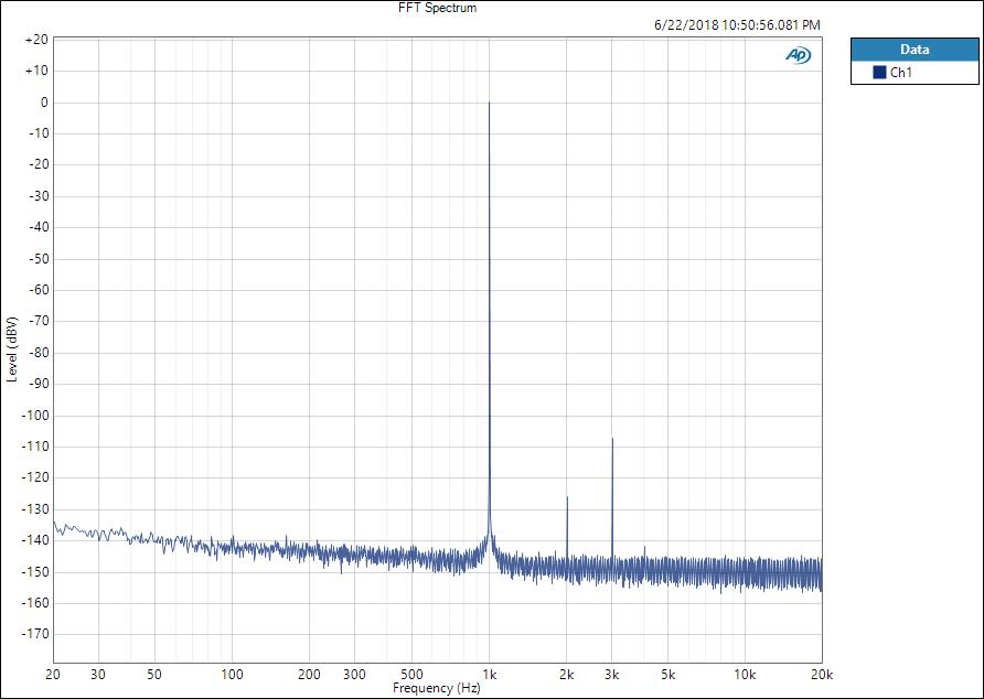

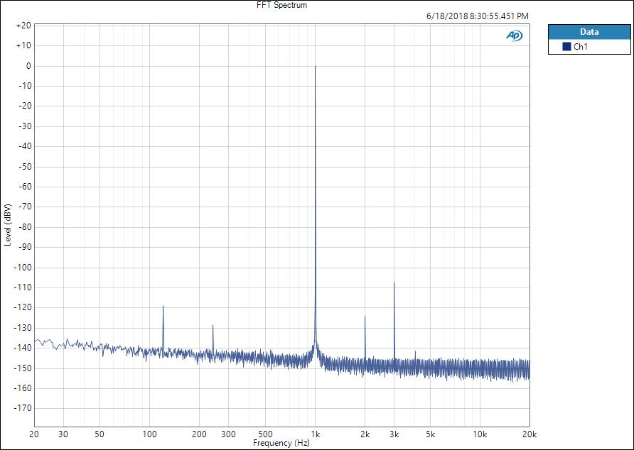

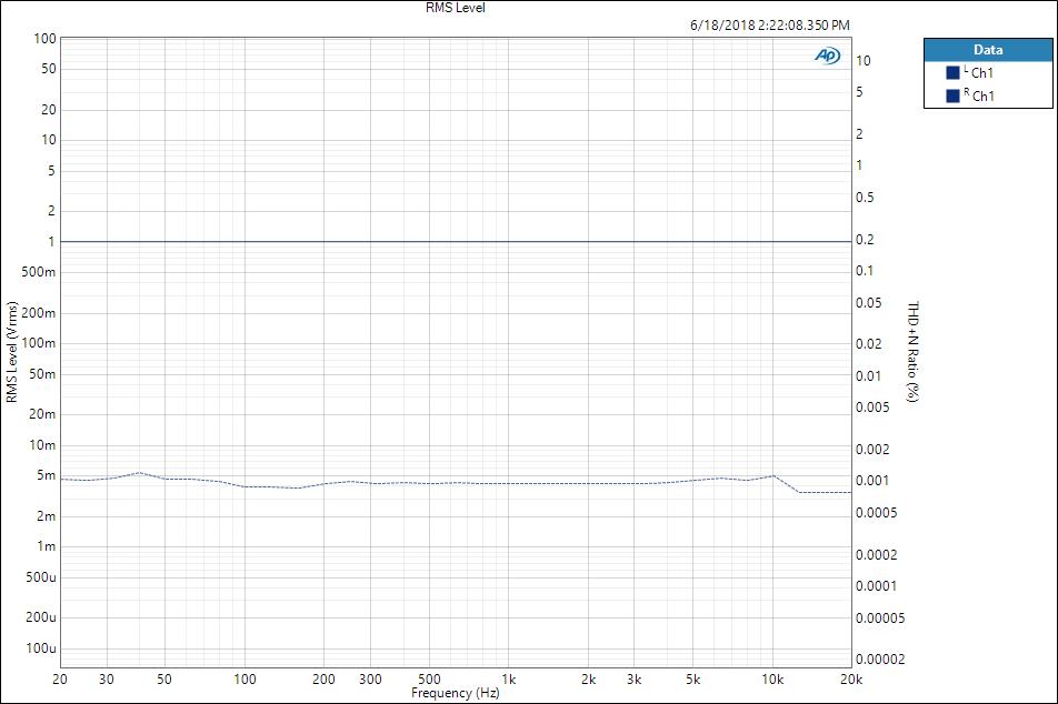

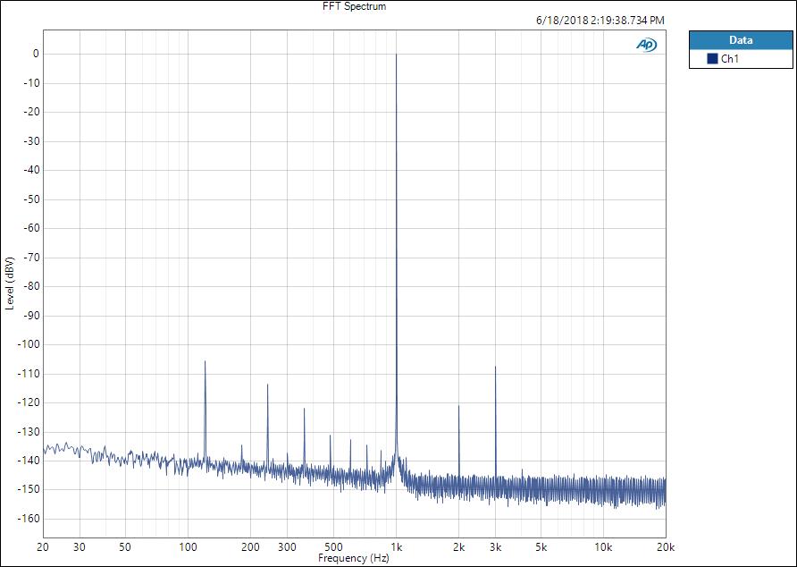

Hello,
This afternoon I took another look at this M HPA.
I adjusted the output to 1Vrms, that seems to be the standard here.
I adjusted the potentiometer on the PCB while watching the analyzer THD+N meter. The THD+N went down to 0.000954%. The Noise meter (20 to 20k, no weighting filter) went down to 7.6uVrms.
With the adjusted pot there are new FFT and sweep plots posted below. The 2nd harmonic fell to -122dBV, the 3rd Harmonic went up to ~107dBV. THD+N went down.
The power line harmonics 120hZ, 240hZ …. are curious to me. The transformer output center tap connects to the regulator board ground. The negative and positive outputs of the regulator are likely pretty close to clean. The ground connecting to the transformer output center tap is as likely as dirty as the dirt under my finger nails. (Next session I will look at this.)
DT

Big improvement to the PS harmonics
Hello,
This is the last of today's fun.
The last post I neglected to mention that the 5th and 7th harmonics disappeared.
I have rewired the power supply.
The PS now has two separate 14Vac windings supplying two separate full wave rectifiers; one each for the positive and negative voltage regulators.
The 20 to 20k noise has improved to 6.5uVrms.
The THD+N has improved to 0.00077%
There is a big improvement to the PS harmonics with the transformer secondary center tap removed from the ground.

Hello,
A little less noise with Gell Cell batteries supplying the regulator board.
The power line harmonics are gone.
Any comments to add?
DT

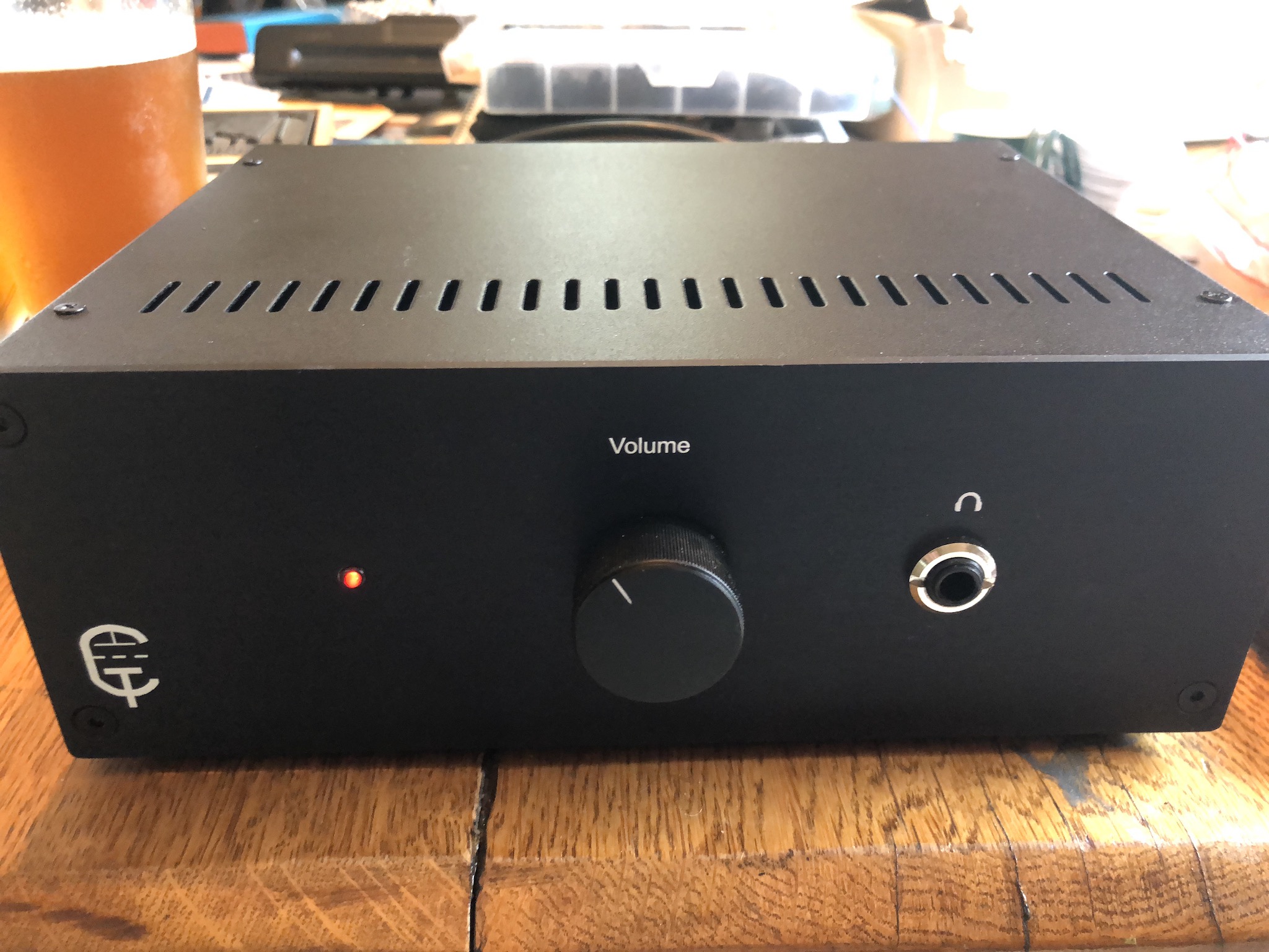

Very nice results.
Don't let the simple circuit fool you. This is a very sophisticated design. I think I spent about $2000 on just the transistors to find the right combination of characteristics for this CFA topology. A topology I developed something like 45 years ago and it is still hard to beat.
Enjoy the music... tell us how it sounds, pls.
Nice work. Have you had time yet to listen to it? Can you describe the audible performance, please?

Well, another once again showed the THD is extremely low even when loaded with low Z phones. And, it was done without cascoding the jFET's and with minimal number of transistors and not using ultra high neg over-all feedback.
But how do you like an accurate amplifier? How does it sound with your headphones?
