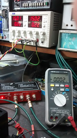

Switched to the bench psu, both amps pulling a steady 220mA and meter shows typical dialled in long term dc offset value exhibited by both amplifiers.

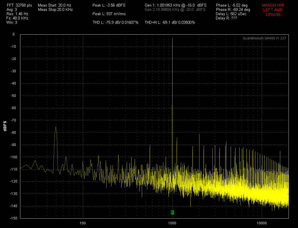

Zero balance trim pot settings are fine and hold beautifully, issue is with secondary pots.It looks like you did not match all the devices. Notable is that the zero balance trim pot is all the way to one side. With matched pairs/compliments, the trim pot should be near centered.

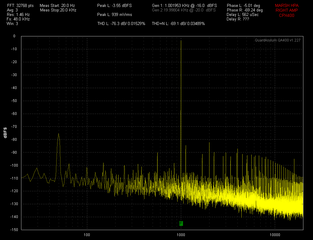

Please see the QA400 screens in my reply to Jack.FFT should add to this info....
Secondary pots? where are those placed? And values?
Looks like -82 and -90db are the 2H and 3H levels shown.
Proably all working but needs matching of all devices.... not only input stage. This is because the circuit does Not depend on a lot of negative feedback to lower THD.
Also, depends on the symmetry and ac and dc balance of the circuit.

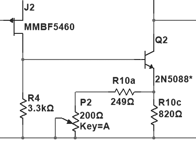

I've pm'd you a link to a set of pcb scans so you can see what's going on with the mentioned secondary pots.

With the addition of the trimpot P2, and 820R (R10C) the value of R10 in the original schematic, Figure 8 of the Linear Audio article, swings from 190R to 290R affording some flexibility.
Mark, you've also got power supply issues witnessed on the FFT -- don't use a lab supply, just a simple bipolar supply with CRC filter, no regulator...and your testing setup looks, well, just a bit "un-tidy".

Because there is significant noise pickup shown ... that reminded me that grounding will affect thd readings also. Be sure it is all star grounded and grounded in proper order.... signal and power.
and eliminate ground loops via test equipment and computer and pwr supplies and gen. to get lowest readings.
What is the THD of the generator you are using?
I assume that therefore is what you're using, perhaps it would make sense for me to use same?
Point taken about the grounding.
The Lindos signal generator THD spec is <=0.005% @ 1kHz.
THx-RNMarsh

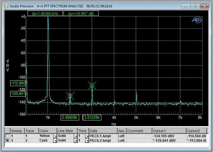

I'm using the AP SYS2722 which is down near 0.00022% for one channel and 0.00020% for the other.

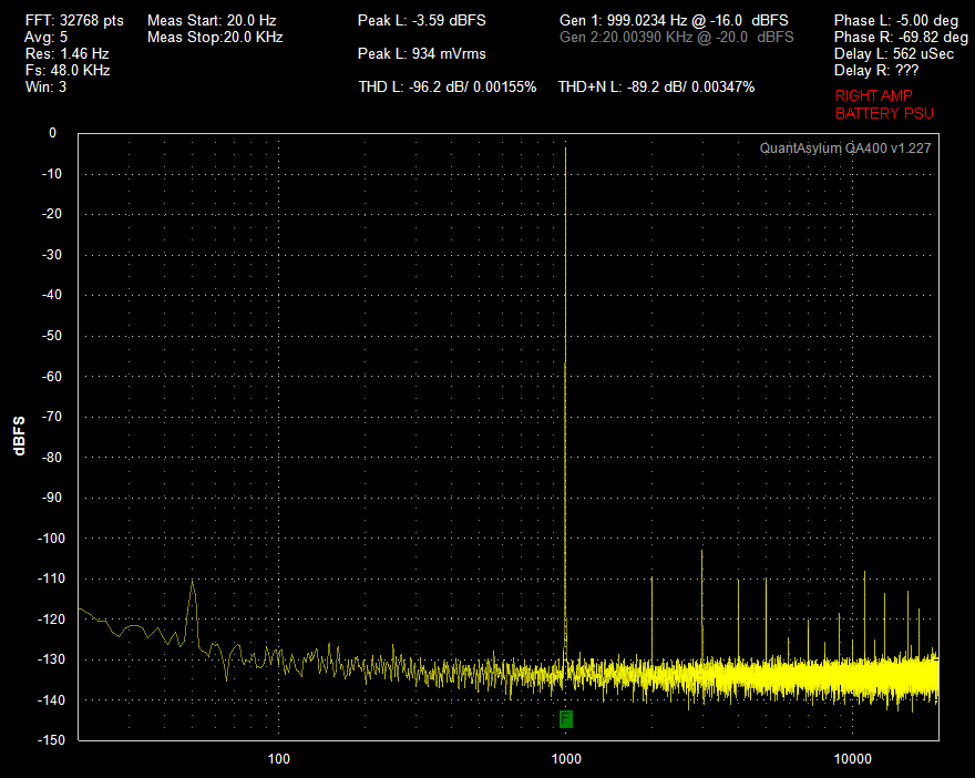

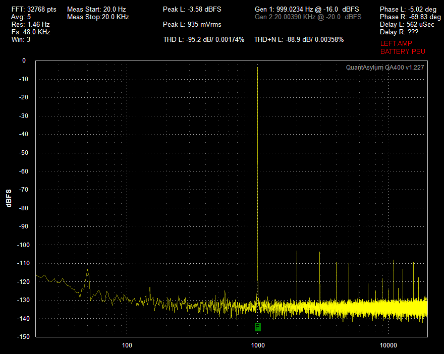

Out of curiosity ran the hp amps off a pair of Yuasa 12v lead acid batteries and hooked the QA400 up to a laptop running on batteries.
Most def need to better match T1 & T2 on the left amp to get some usable track back on the second pot. Right amp second pot on sweet spot for minimum distortion via T1 & T2.

I experience much the same thing when using my Tek PS5010 lab supply. It's great for initial testing but not for tweaking.

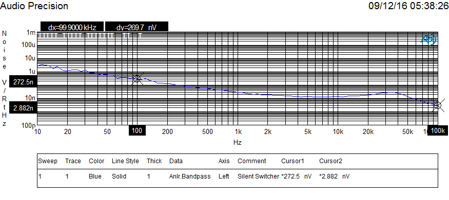

If you are referring to the Silent Switcher and a wall wart, some wall wart switching hash can make it though the SS to the output.
Even running on a clean 5v linear PS there is still something not quite up to very clean linear PS HF noise performance from SS, at least in my experience.
The maximum current by the SS depends on output voltage and is limited by the chip set used to generate the bipolar voltages.
To go higher on current means a completely new design with another chipset.
Sorry, there's no switching noise on the Silent Switcher bleeding through from a wall wart.

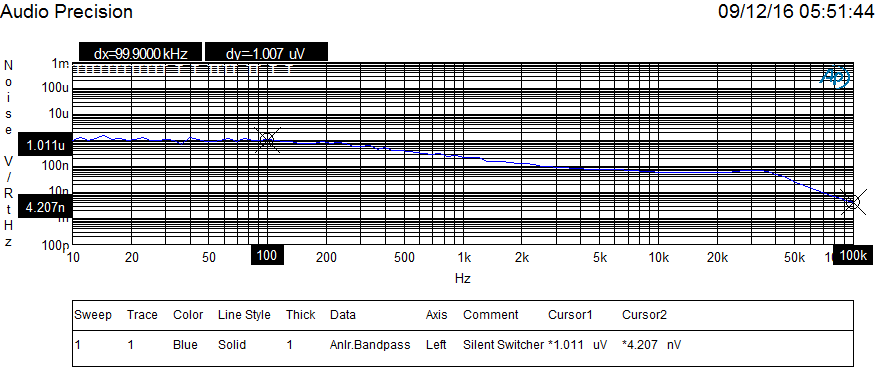

Varies somewhat with the particular wall wart but yes there is, or can be. Affects the sound of an ES9038Q2M DAC. Accidentally plugging the SS into a USB hub resulted in clicking and beeping noises coming out of the DAC. Some of it may be up at a few MHz, but there is something there.
just looked it on my HP3577a 10kHz to 100MHz-- the only thing I see is a 10MHz signal -92dBm, and this may be environmental, it's ~6uV into a 50 Ohm load.
