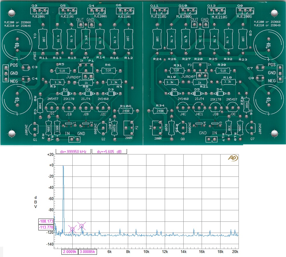

A couple of folks have asked about boards. Restating, they are $3 and have two amplifiers. Shipping varies all over the world. Here is a picture of what they look like:
You can charge what ever you wish to cover your time and costs etc. Also, don't you do transistor matching as well and/or sell package of parts??
Which devices were used for your FFT data? Same as in article or different?
THx-Richard

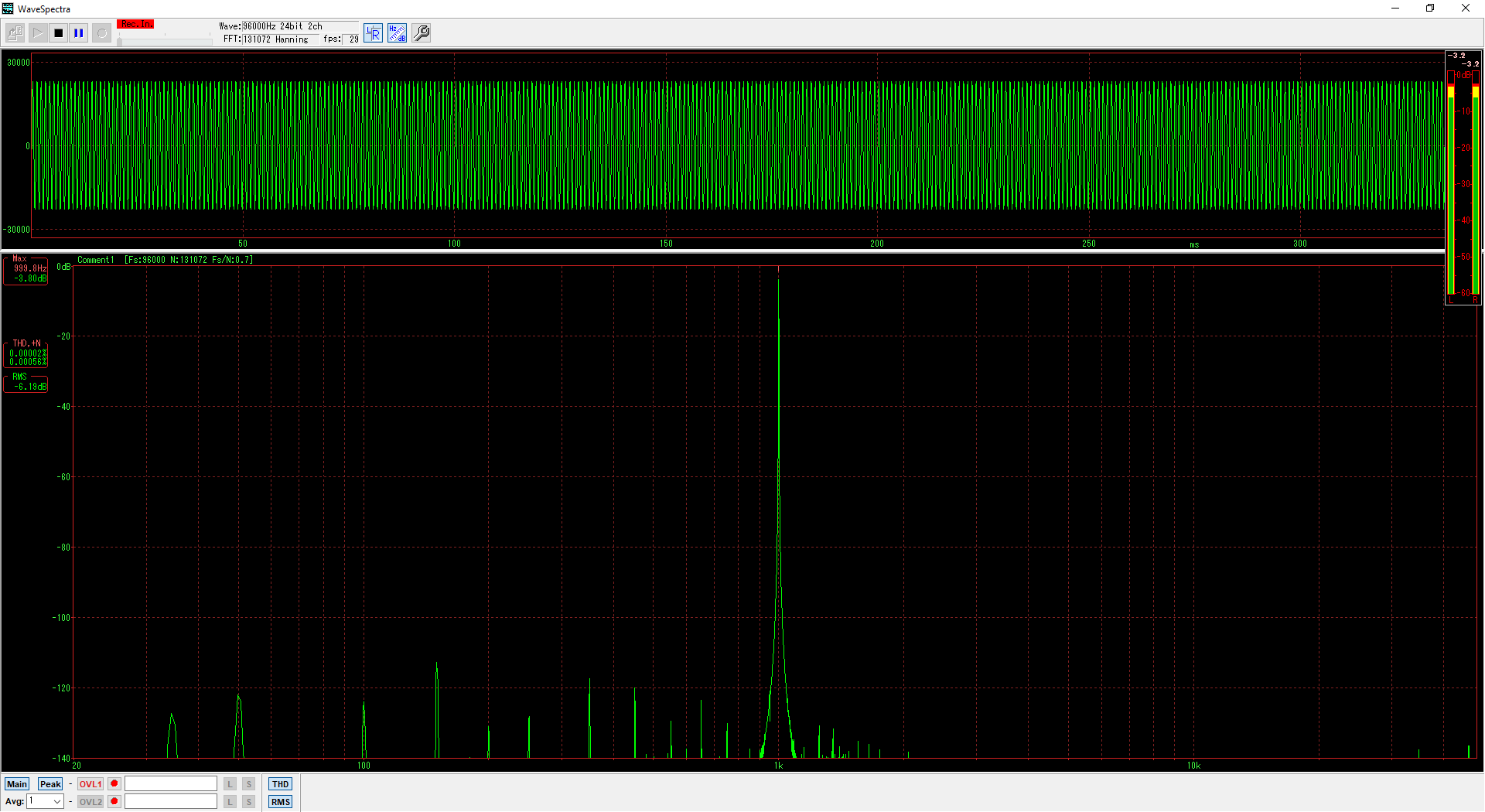

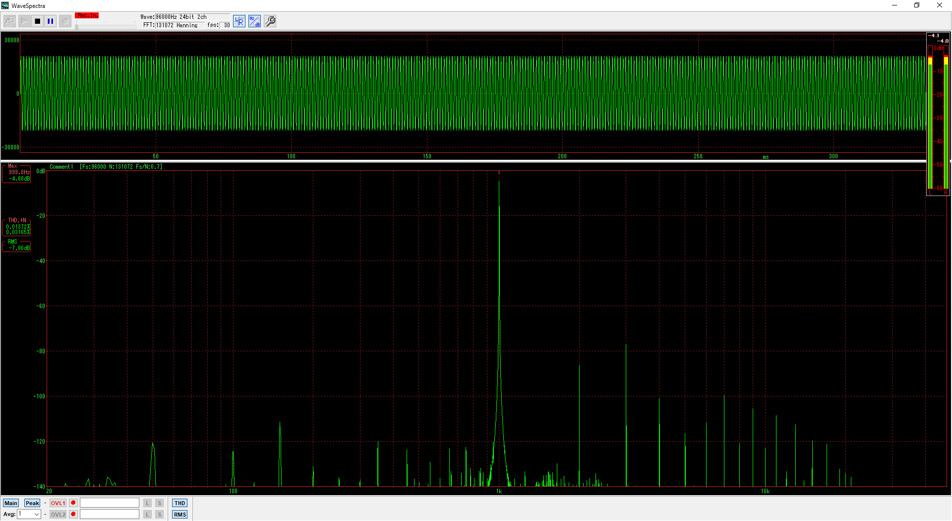

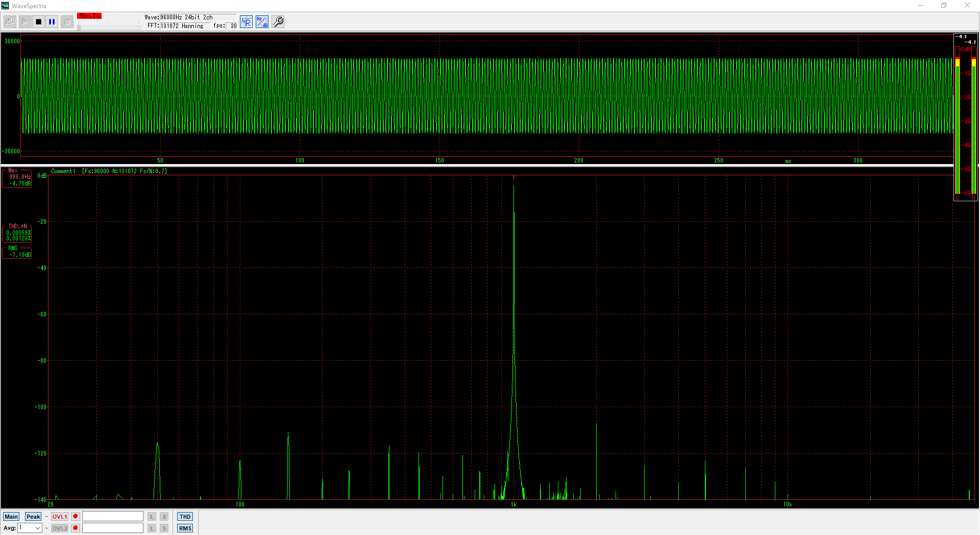

Some measurements of my amp after a bit playing with trimpots.
1kHz -3dB sine from WaveGene, WaveSpectra 13k FFT Hanning both at 24/96 with ASIO using Creative X-Fi Titanium HD soundcard line out and line in.
First pictrue - 1V RMS, 32R resistive load
Second - 1V RMS, 274R resistive load
Third - 200mV RMS, 274R resistive load
To be honest results looks too good to be real, especially considering my pretty cheap testing gear.
Looks about right --- with your test equipment, you can finely trim values for absolute lowest distortion.
Also, what are your PS voltage used for your results?
THx-Richard
TL1963A PSU is configured for about ±15V. My main headphones are 250 ohms Beyerdynamic DT990 Pro so trimming was done at similar load. DC offset is less than 2mV at both channels. I'm using transistors matched by Jack so output devices are Hitachi rather On Semi.
OK Thx... helps others to know how you got to the results you have....
BTW -- how does it sound?
-Richard
