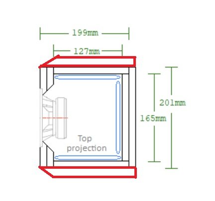

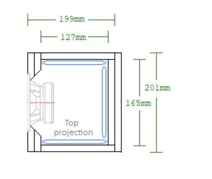

Hi Scottmoose, no bracing will be added in the Lhotse cabinets here.
Cabinets will be fabricated with heavy materials as mentioned before.
As I said:
Bracing in such a small internal section (165x127mm) will bring nothing more than overkill with the materials I use.
You only will disturbing the working conditions for the MAOP in the design such as standing wave.
My advice not to do it.

Hi Scottmoose,
Another advice to your design; double also the side panels and add on each front side panel a facet of (for example) 18 x 40 mm to keep the original designed baffle wideness of 201 mm.
Do what you want with it.

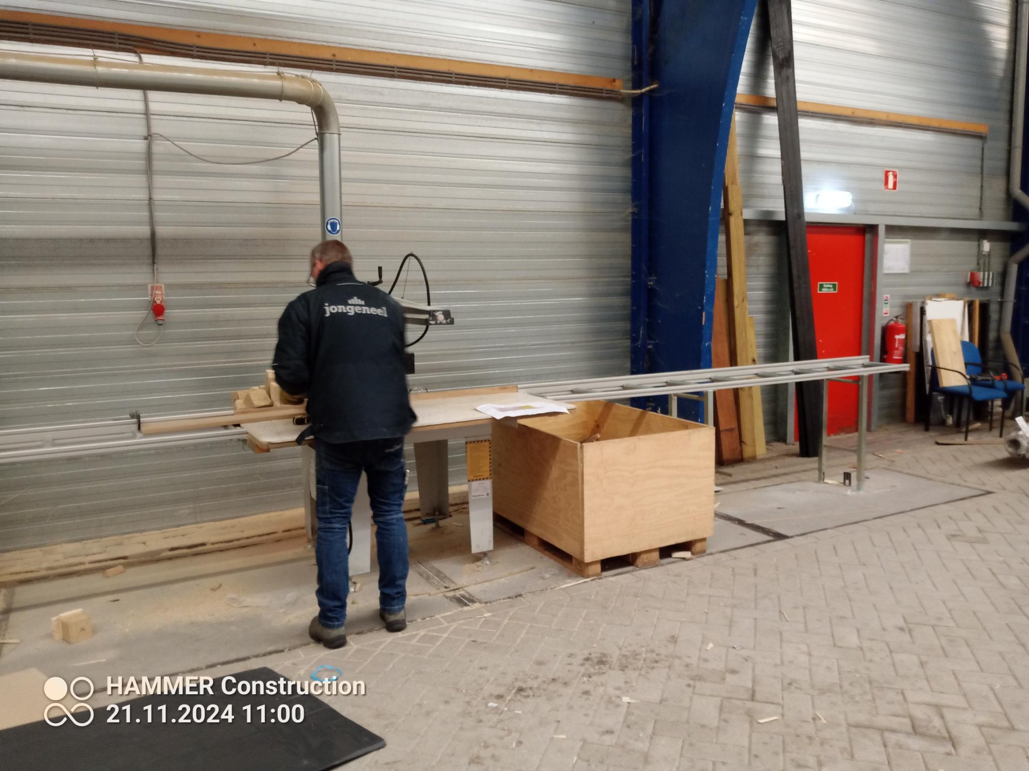

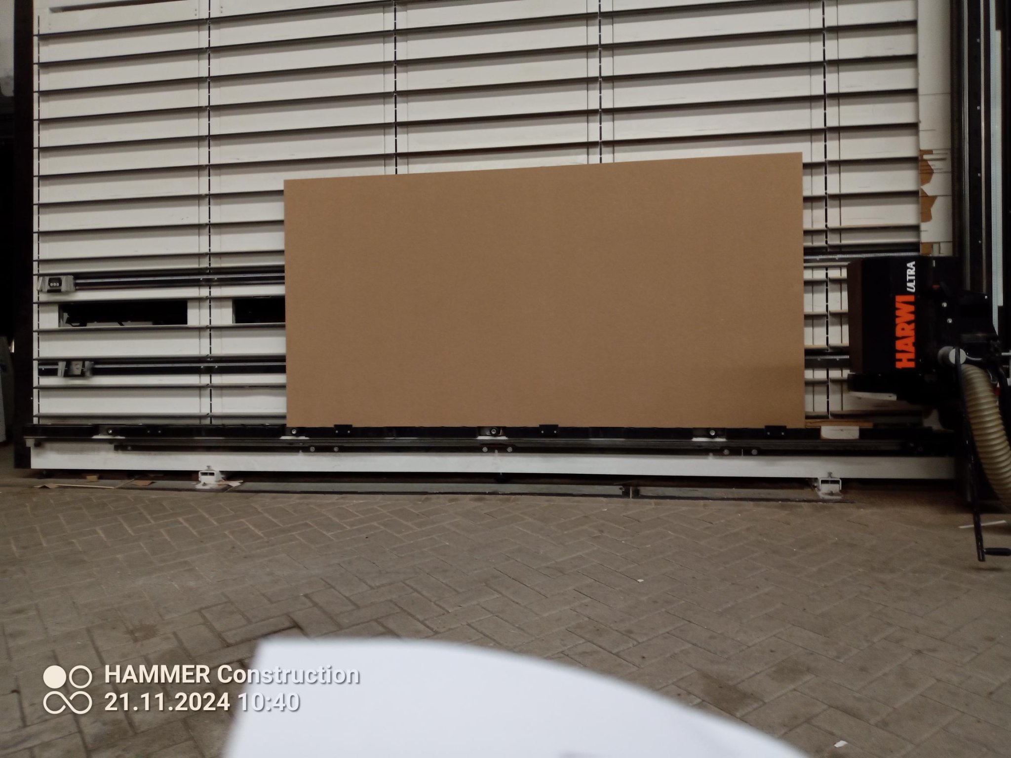

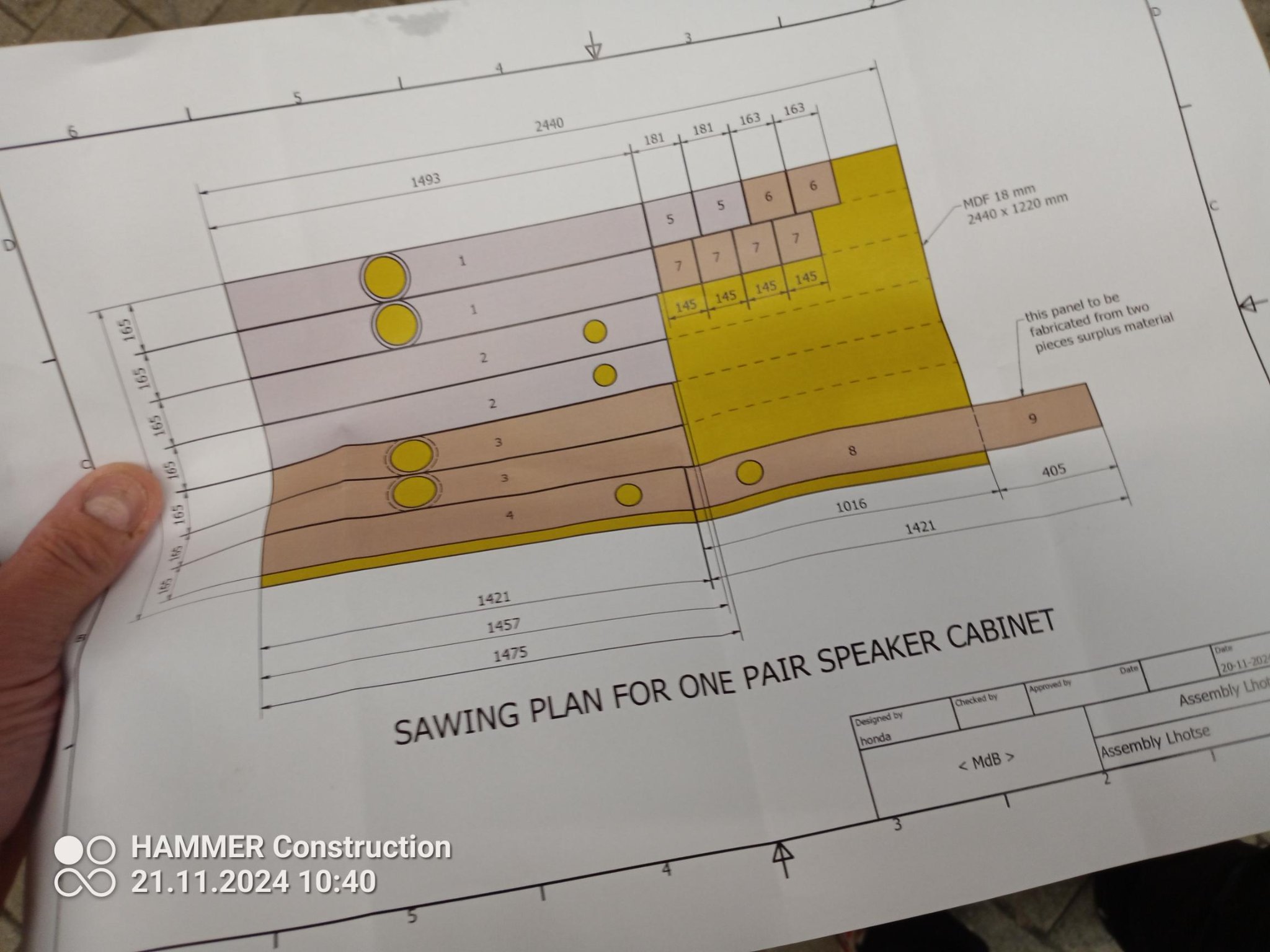

The party can begin 😀 🥳🥳 🙂.

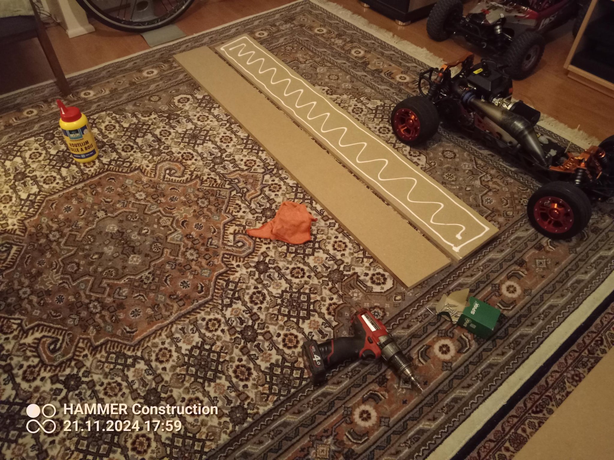

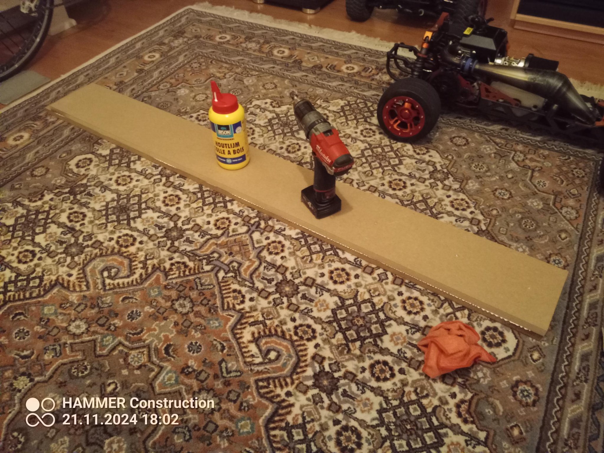

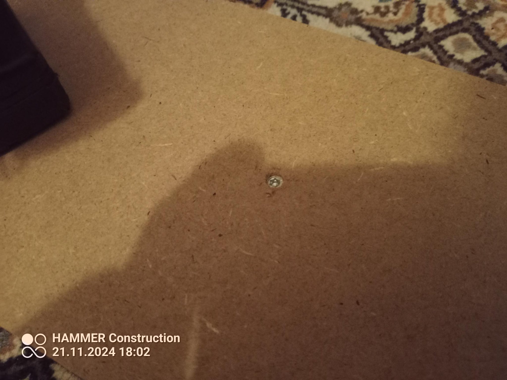

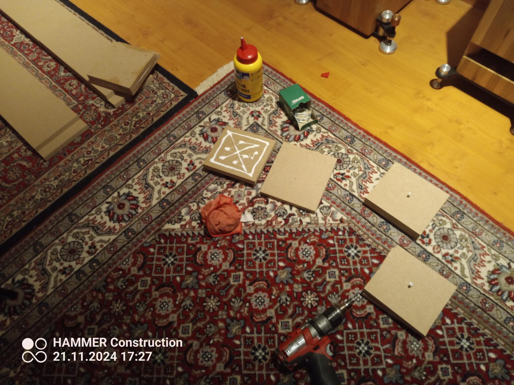

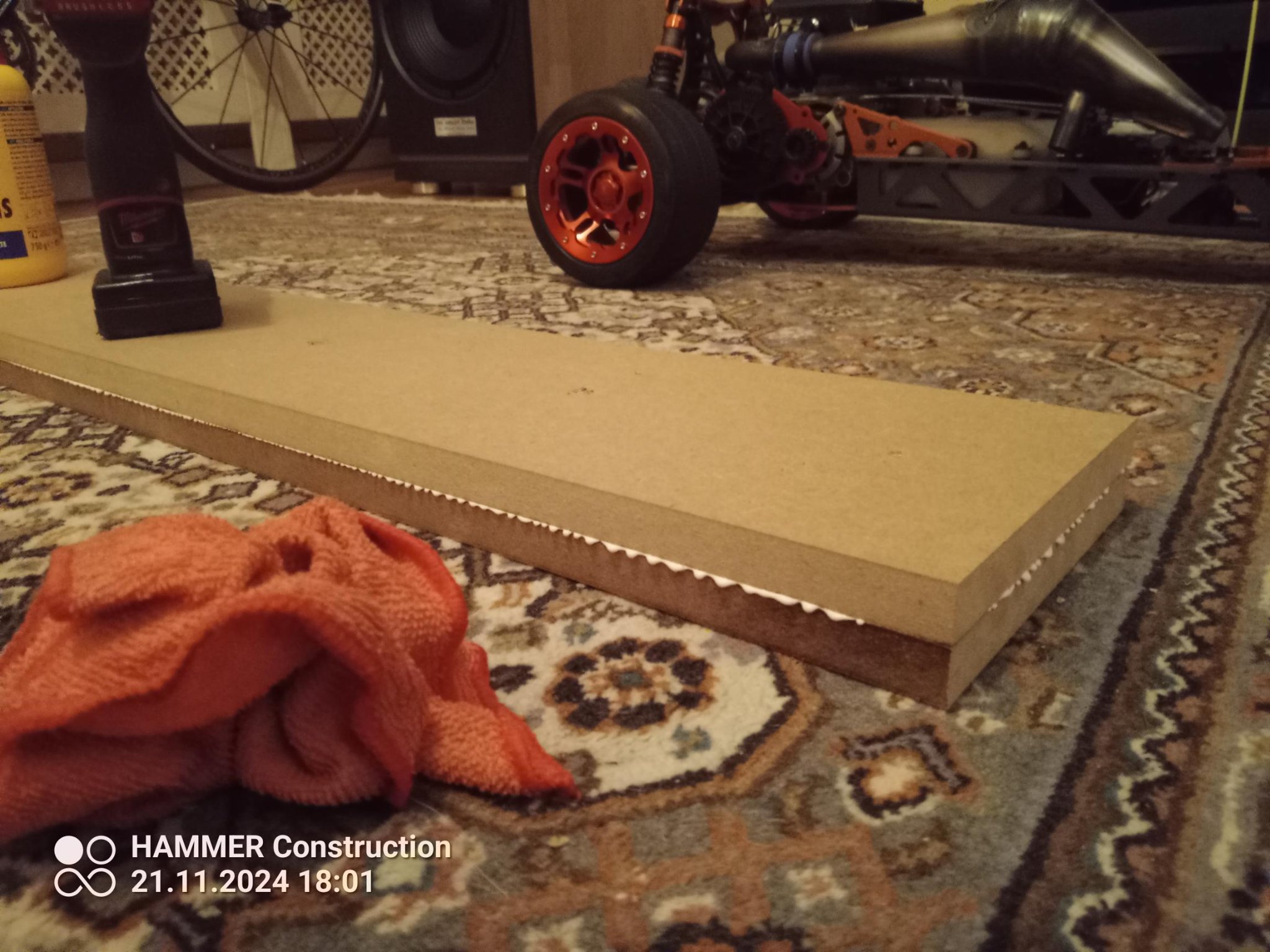

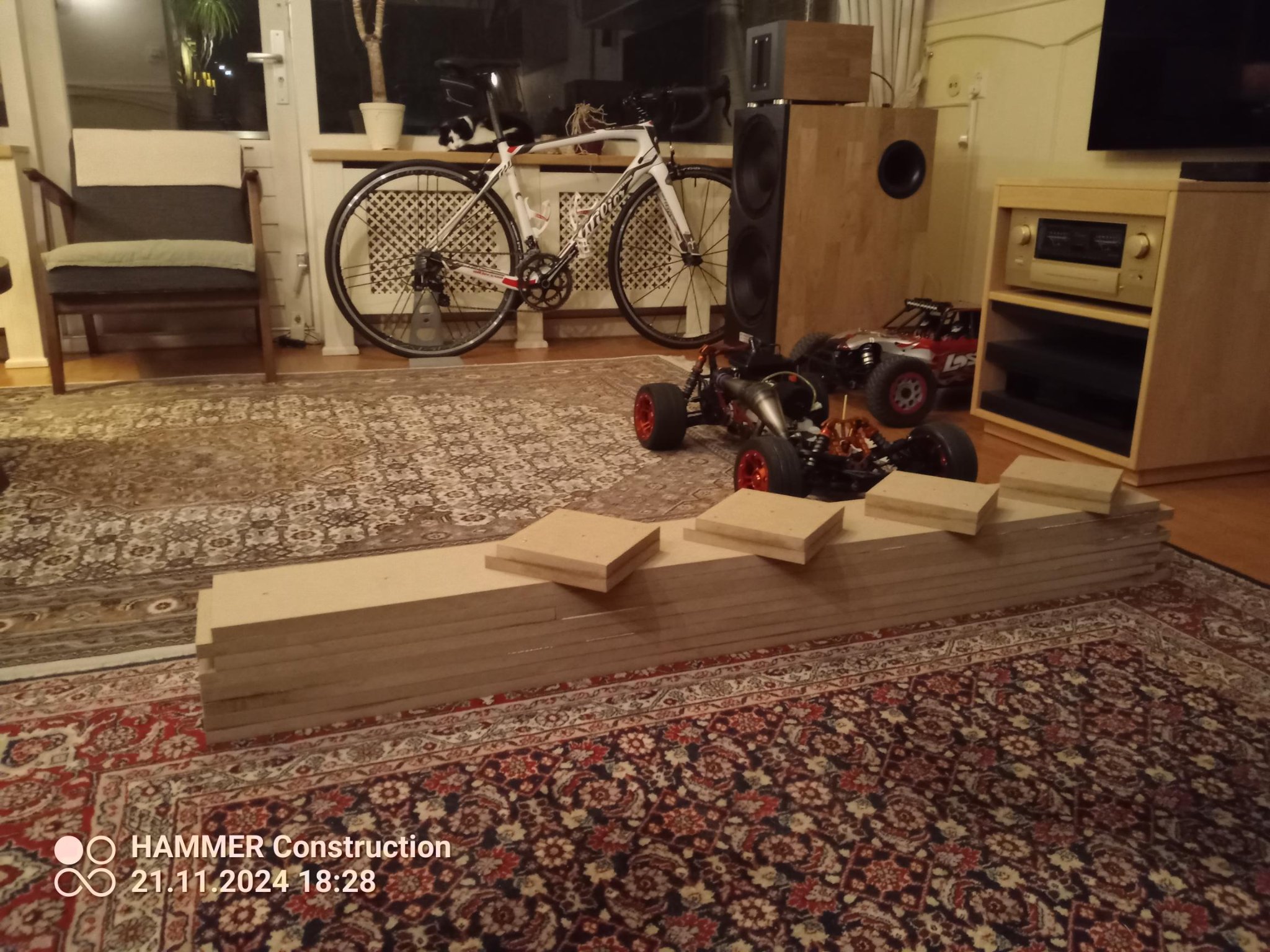

All double MDF panels are glued and screwed together.
First screw the two panels together with at least 2 screws without using glue.
This for easy aligning the two panels with glue on it.
Remove surplus glue with a wet cloth.

Not required, but you're absolutely free to do it; the chamfer will be cosmetic only with minimal impact on step & diffraction; structurally the doubled side baffles will increase the structural rigidity further, which is never a bad thing, but with the single-skinned panels keyed into & agaist the existing doubled front, rear and tops the panel modes are already below the audibility threshold. As noted, this was designed and tested -I'm not guessing here. 😉Hi Scottmoose,
