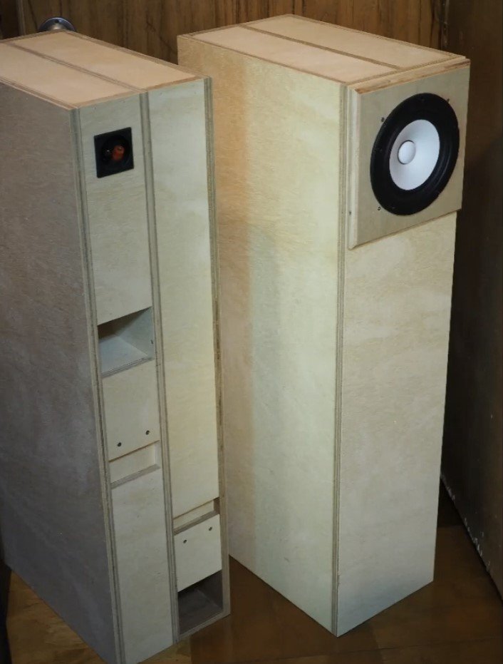

Depends what you're aiming to achieve; they have different alignments. The EBS is fairly self-explanatory & is aimed either at high output impedance amplifiers (for modest levels) and / or fairly near-boundary positioning -front wall or corners. Lhotse is a low-forced MLTL that's a bit more flexible in terms of positioning & amplifier load requirements. By design, it's got more output as-is.I like to built the Lhotse with these beauties.
Or EBS?

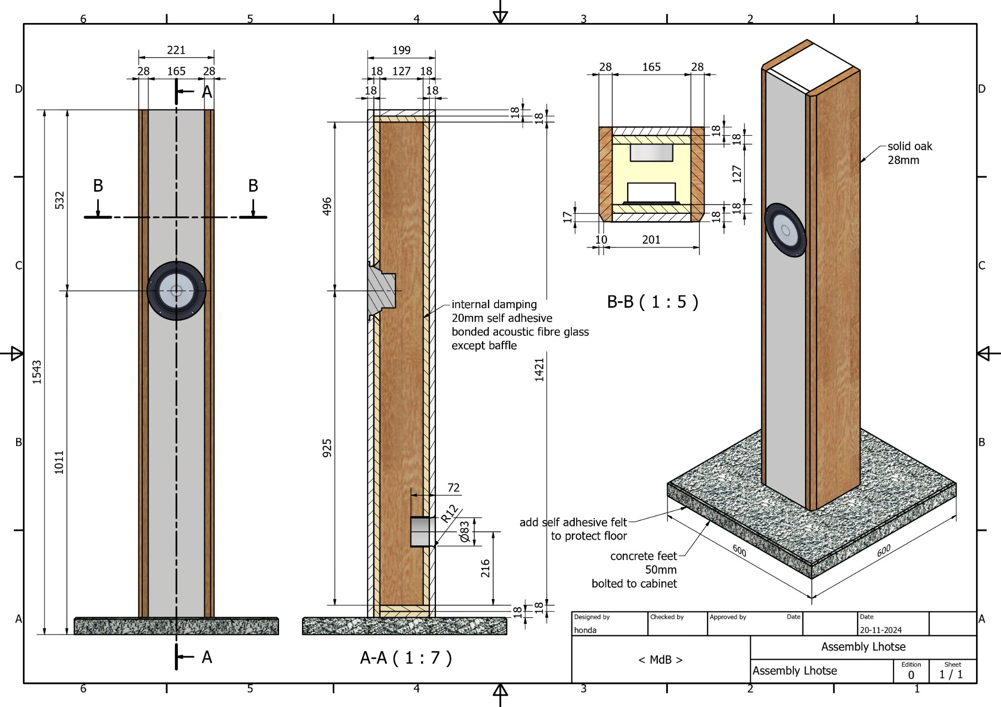

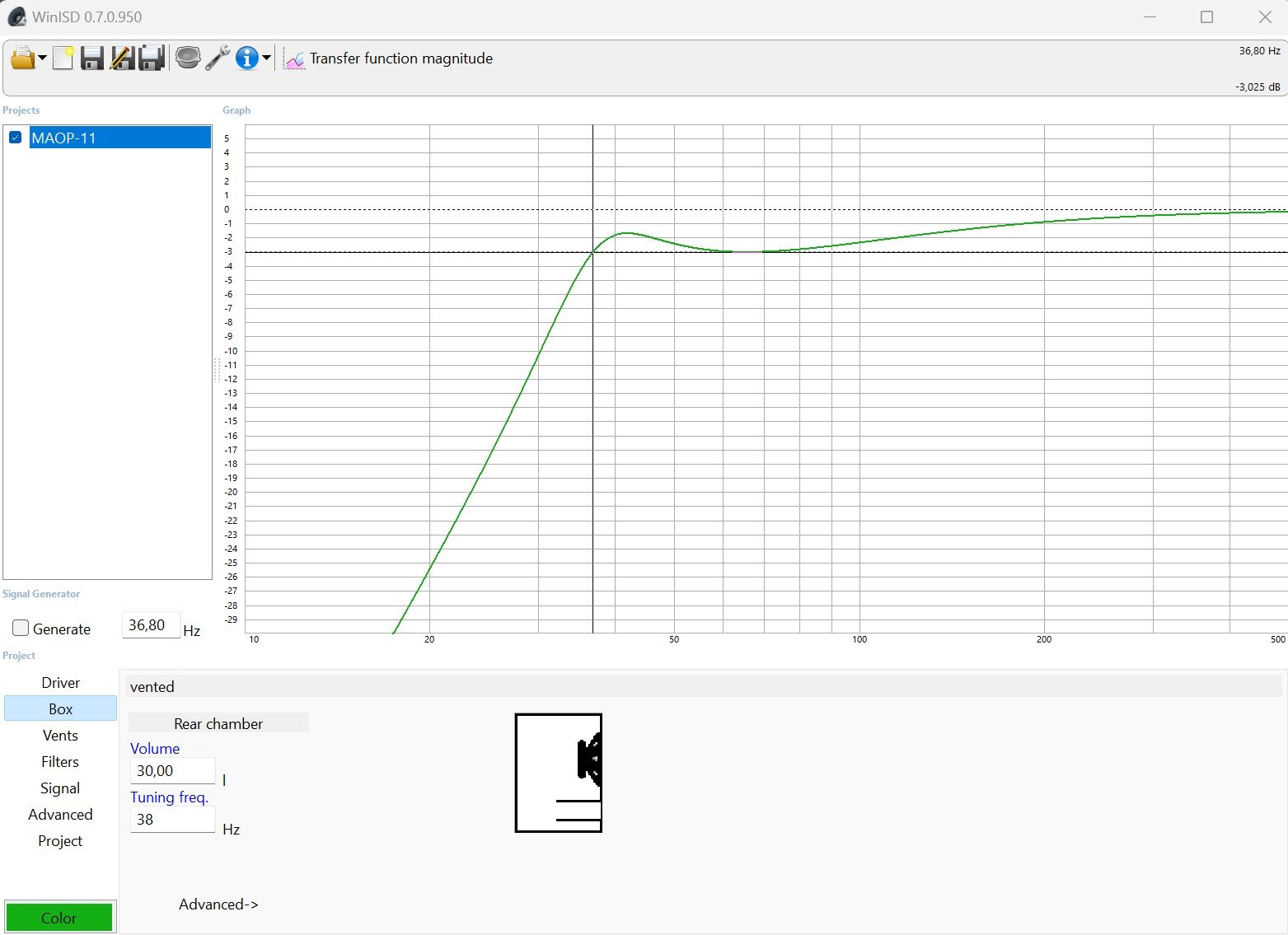

When we say 'as low as possible' does that mean 'whatever the sacrifice'? Or does it mean 'as low as possible while maintaining a linear response and not relying on amplifier output impedance / equivalent compensation & boundary gain to provide significant help'?As low as possible.
The best cabinet for deepest lows using maop drivers. I think Lhotse? goes to 48Hz.
Should internal bracing be sufficient?
The inner section is very narrow and I use 28mm solid side panels and 2x 18mm MDF baffle and back panel.
The inner dimensions and baffle wideness are according original design.
I don't want to disturb the standing wave.
To be honest, it should be quiet enough without; it's quite a rigid box & certainly will be with 28mm solid oak side-baffles, providing they're tight-grained. If you want to add some though, a few longitudinal strips will do the job ~'well enough' without going to a full holey brace.
