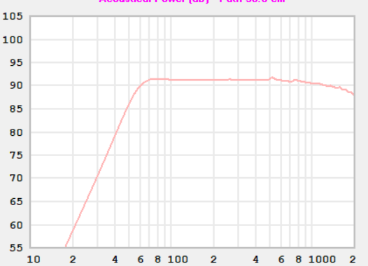

Could some explain why Mark audio advise following plan https://www.markaudio.com/wp-content/uploads/2025/04/MAOP11MS-MLTL31.png
Is it any reason for that plan?
Well, for a start, it's not advised -simply published without commentary, same as all the others.
Secondly, the response above is incorrect; it's actually a maximally flat MLTL alignment to Fb, not an overdamped alignment. I know this simply because I designed it.
The 'reason' for the plan is that some people wanted a compact max-flat MLTL for MAOP11MS -there's nothing more profound than that.

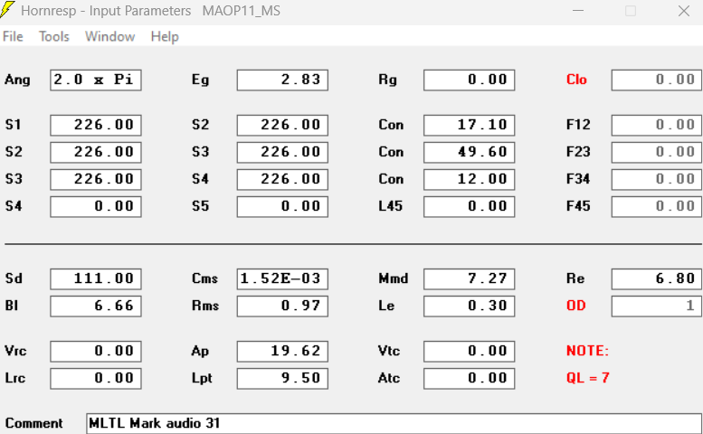

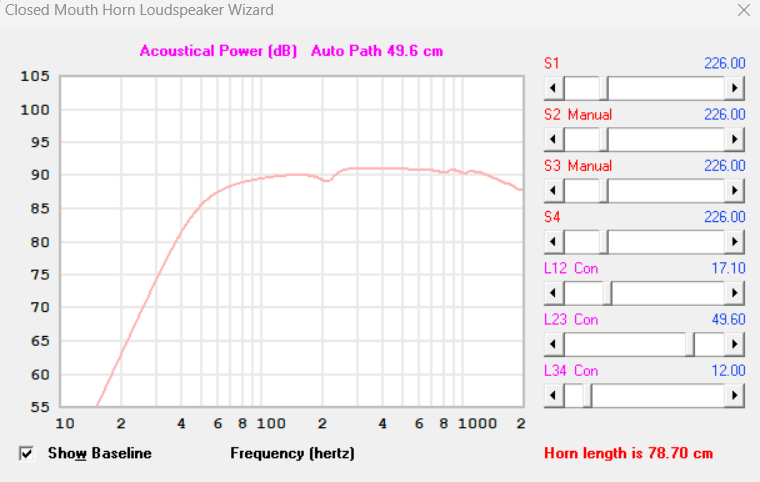

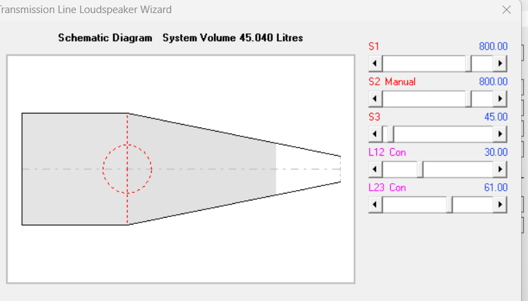

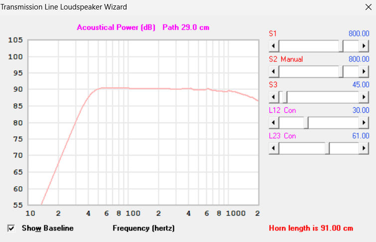

I just put original data from plan in hornresp and above is result.
My flat design is 16.5 liter and look
Then you've modelled it incorrectly in some way. Sorry. I suggest you double-check that you have factored in the same level of series R accounting for typical wire loop & connection resistances, then confirm that your duct dimensions [total length & CSA] are as-specified, and also that your damping model is equivalent to 1/2in - 3/4in [12mm - 20mm] thick rigid fibreglass board rated to 3lbs/ft^3 [or a close equivalent] lagging non-opposing faces of the enclosure. Hornresp should then provide you with the correct results.
Length & CSA are as you can see above 19.62 cm2 (r=5cm in plan) and length 9.5 cm. Already my friend made box for 12PW https://www.markaudio.com/wp-content/uploads/2022/08/Neptune-Alpair-12PW-RTL.png and that was horrible sound.
Then you either haven't entered the correct amount of series R for typical wire loop & connection losses as-included in the alignment, and / or not entered the correct quantity of damping, per above. The response you show is overdamped, so it seems likely this is the source of your problems.

It was muddy midrange compare to classic BR with 32 liter.

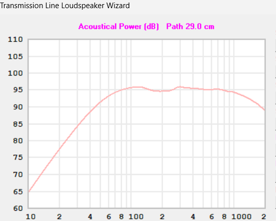

Neptune simulation
Compare to my simulation
Neptune simulation
Good, that one is approximately correct -Netpune tracks a classical TL style alignment with a damped LF response characteristic. I don't know how you're defining a 'muddy' midrange, but it suggests you need to adjust the damping quantities to suit requirements -this is where the 'Y' in 'DIY' comes in of course. 😉

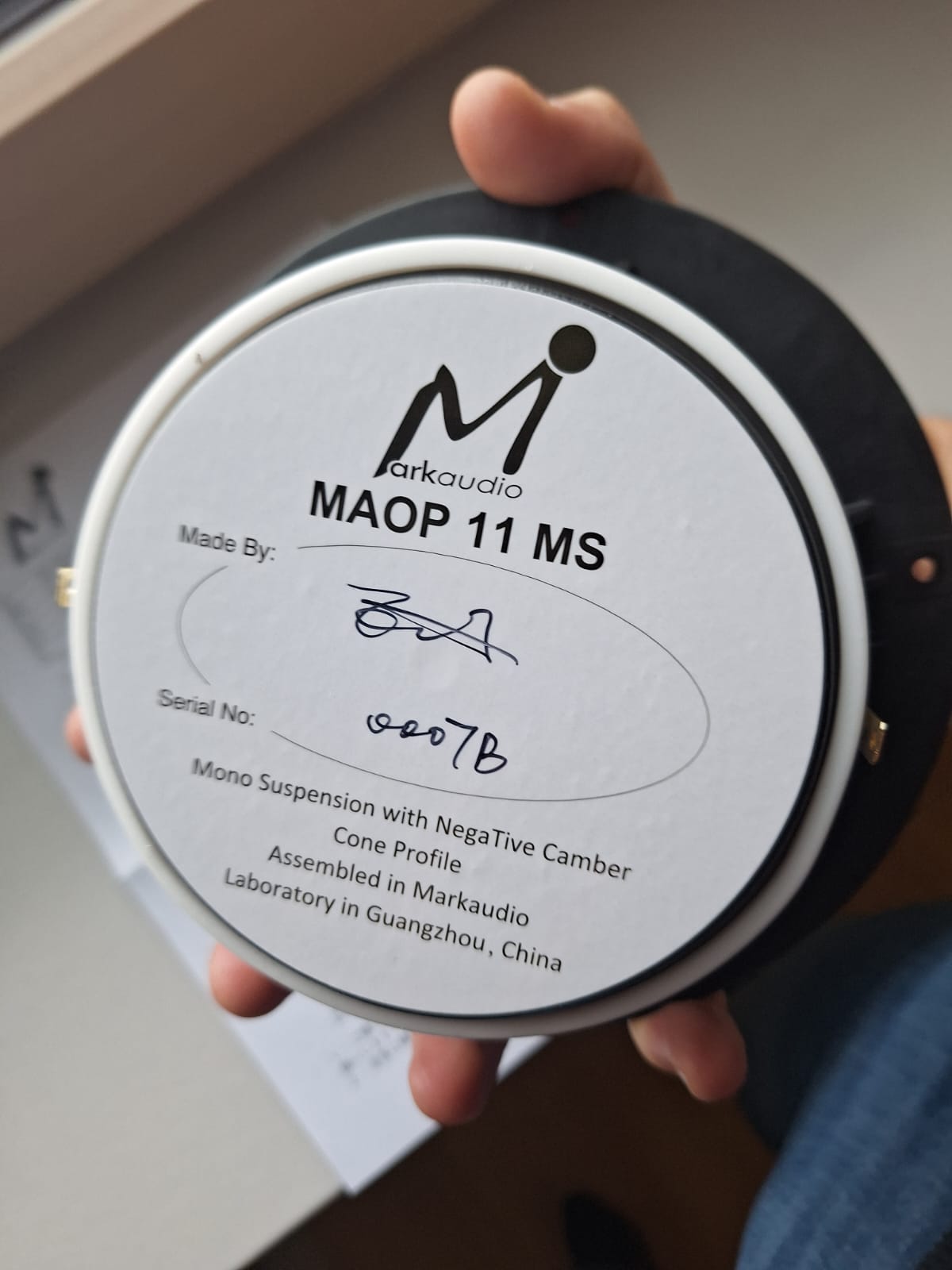

To the best of my knowledge, yes. As stated on their product page, all the MAOP series are matched by the factory and should be supplied to buyers in those numbered pairs. If a dealer isn't, or claims 'they don't offer that service' they're a/ not doing their job, and b/ being disingenuous since there is no work required on their part other than reading the numbers clearly written or labelled on the boxes, for what is supposed to be a premium product in the MA range.

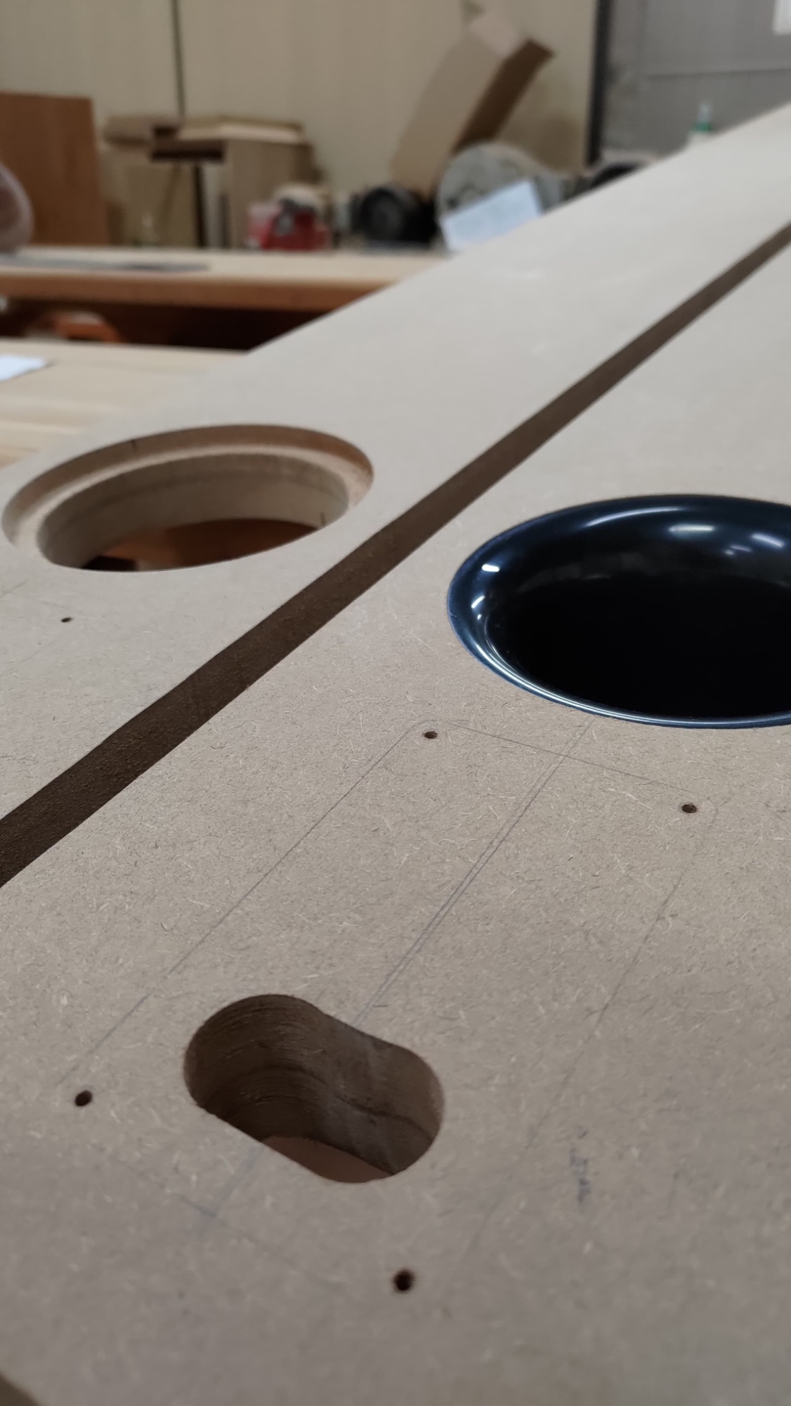

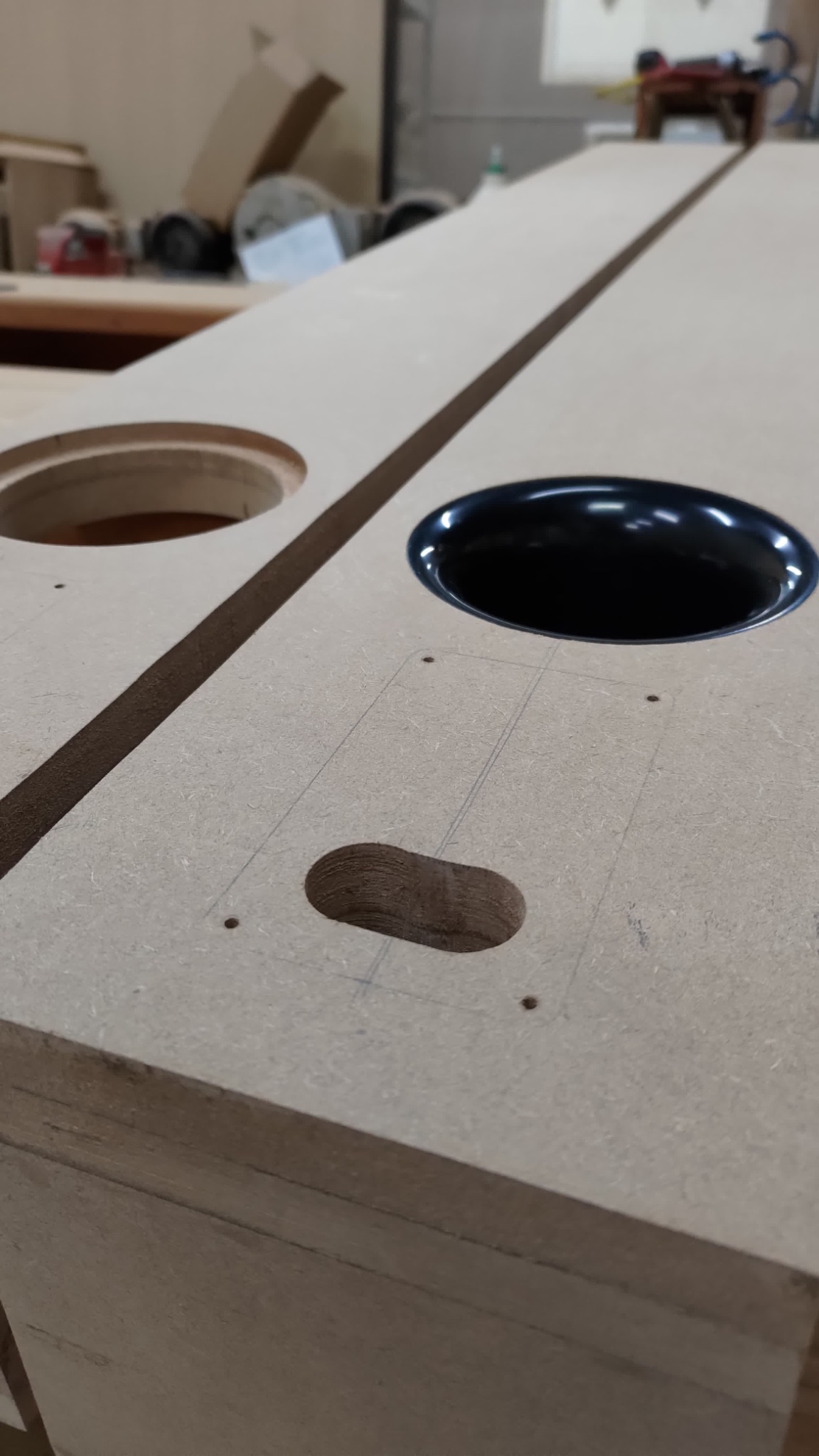

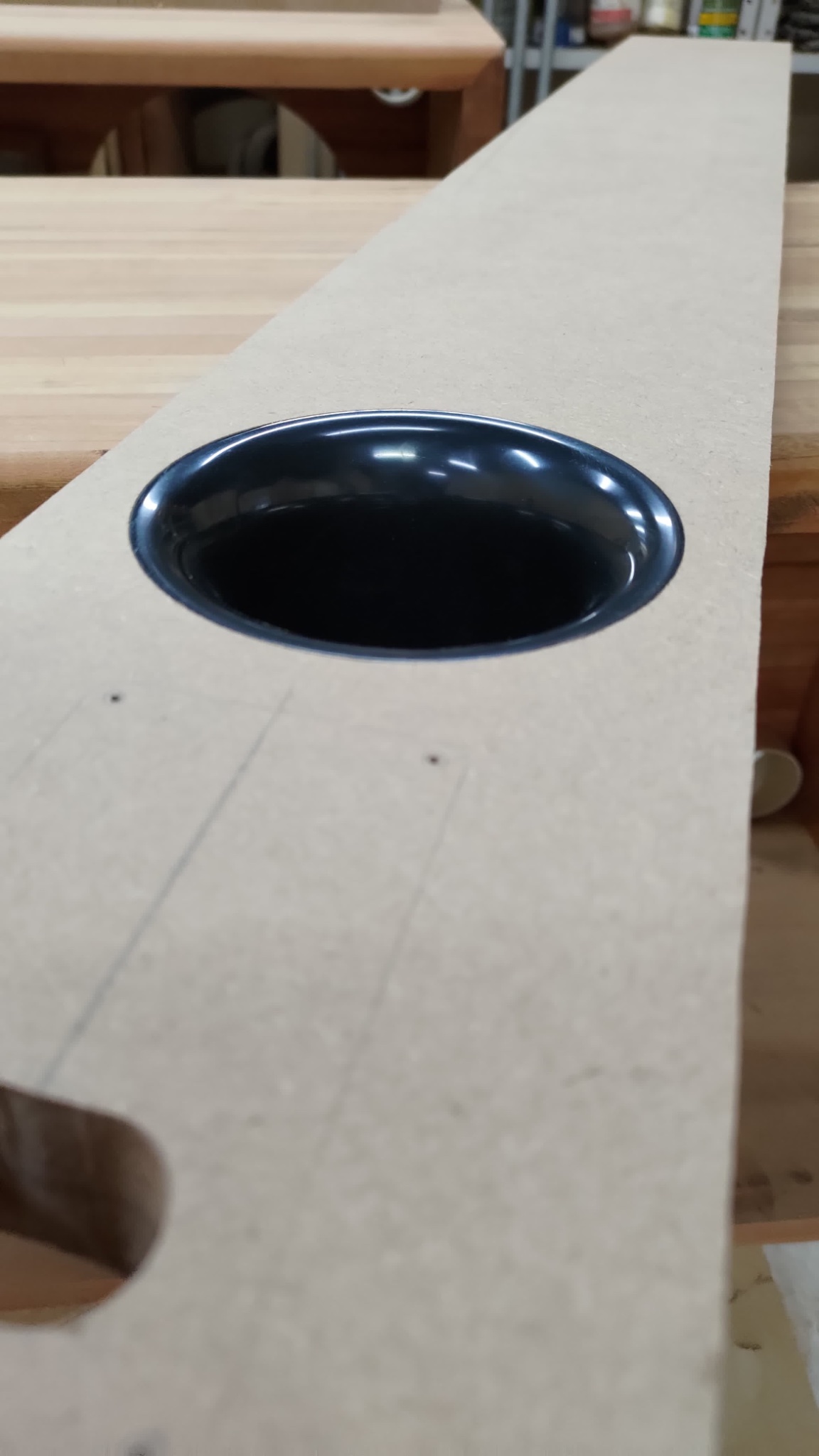

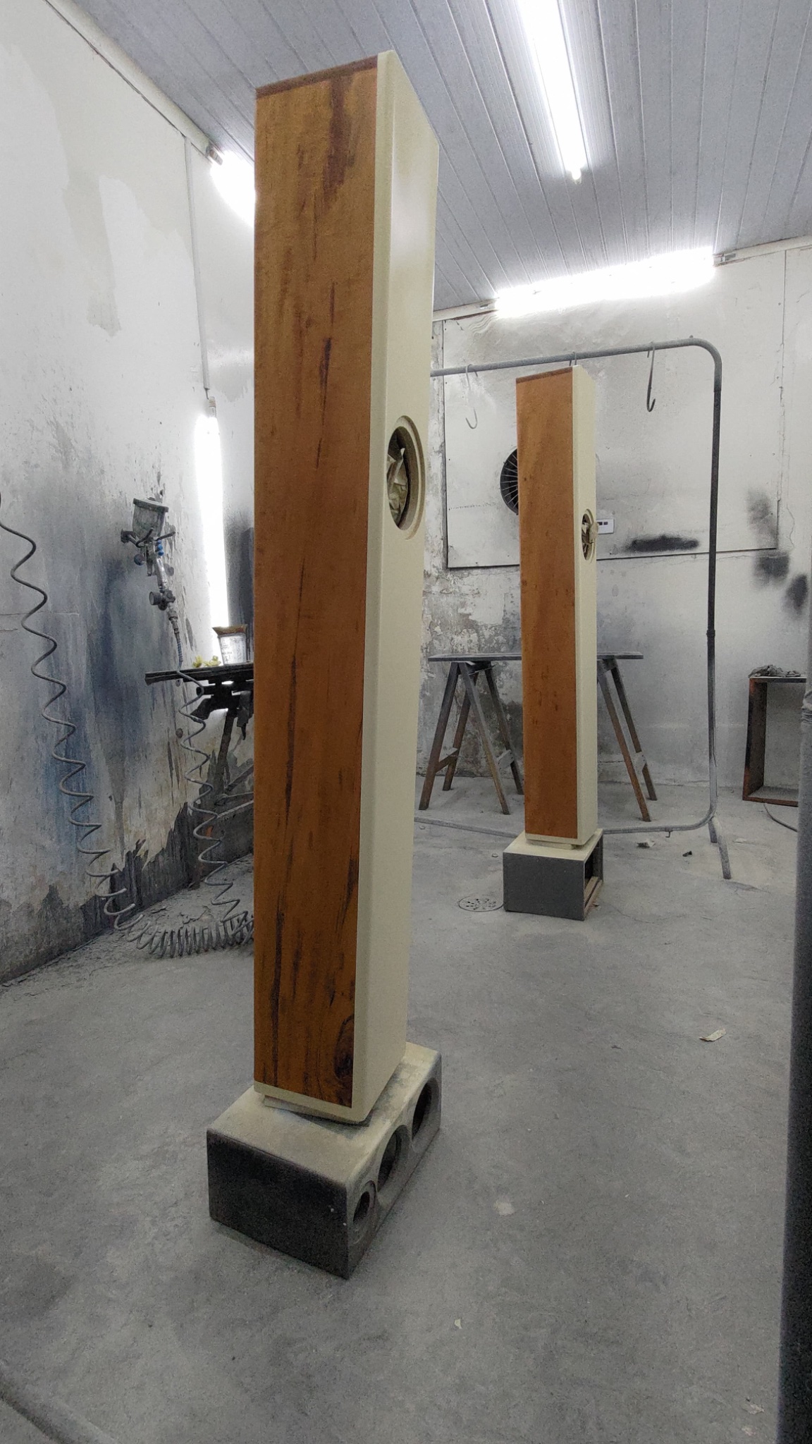

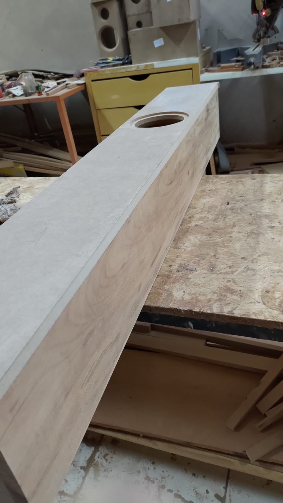

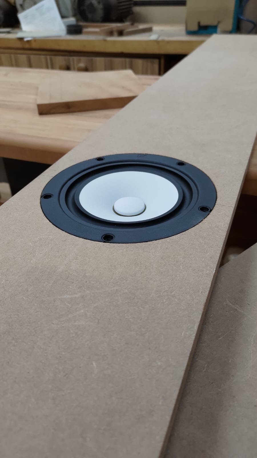

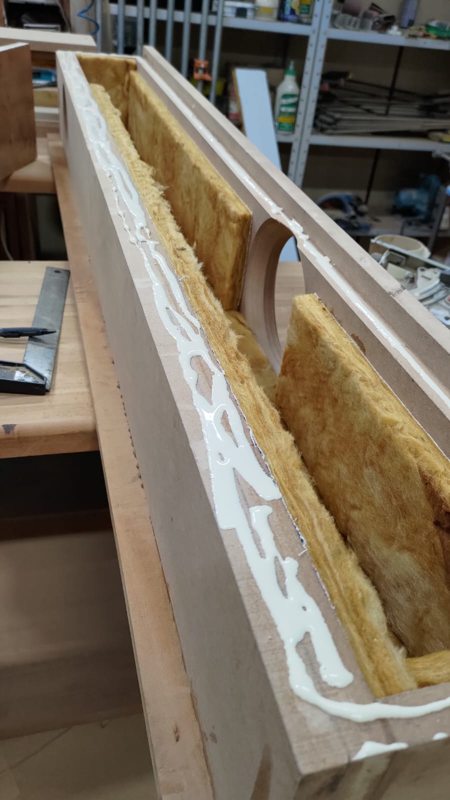

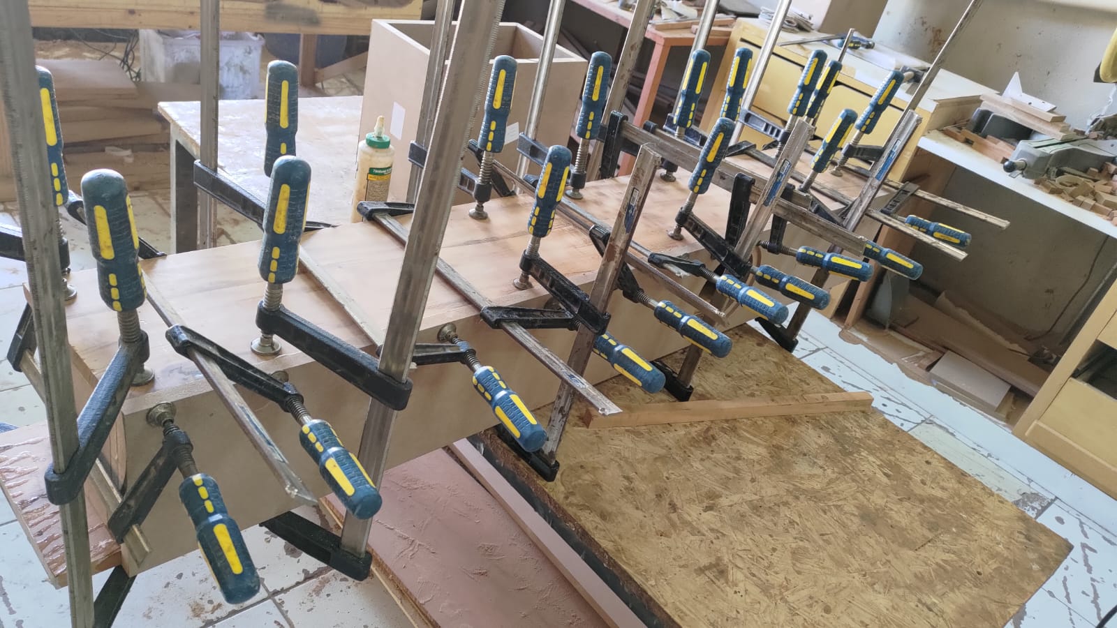

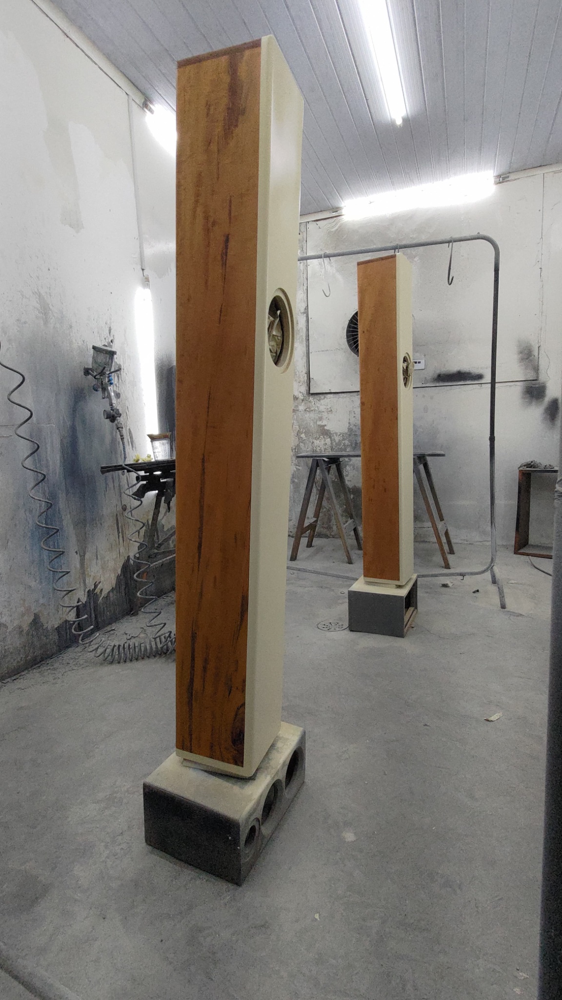

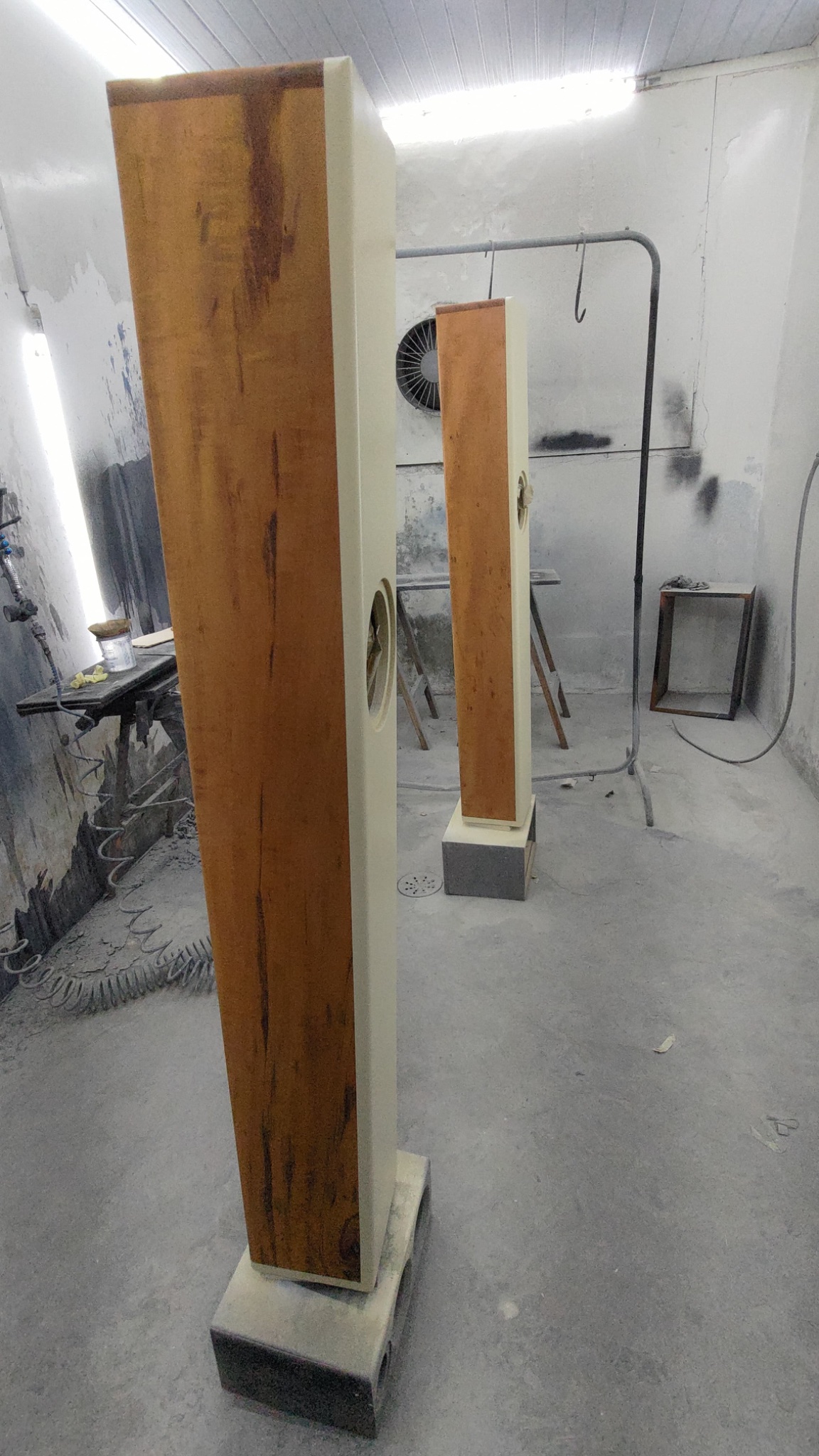

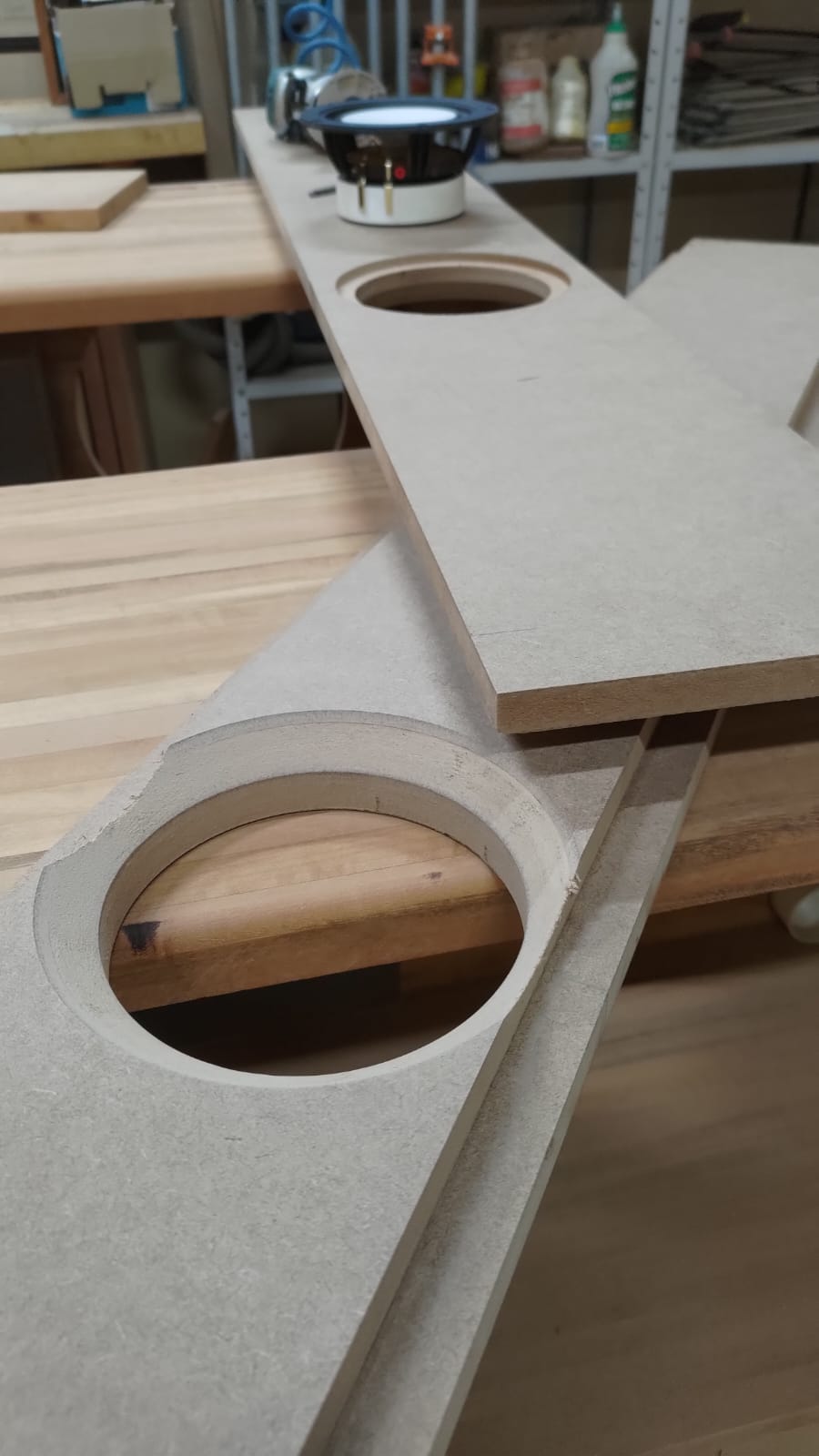

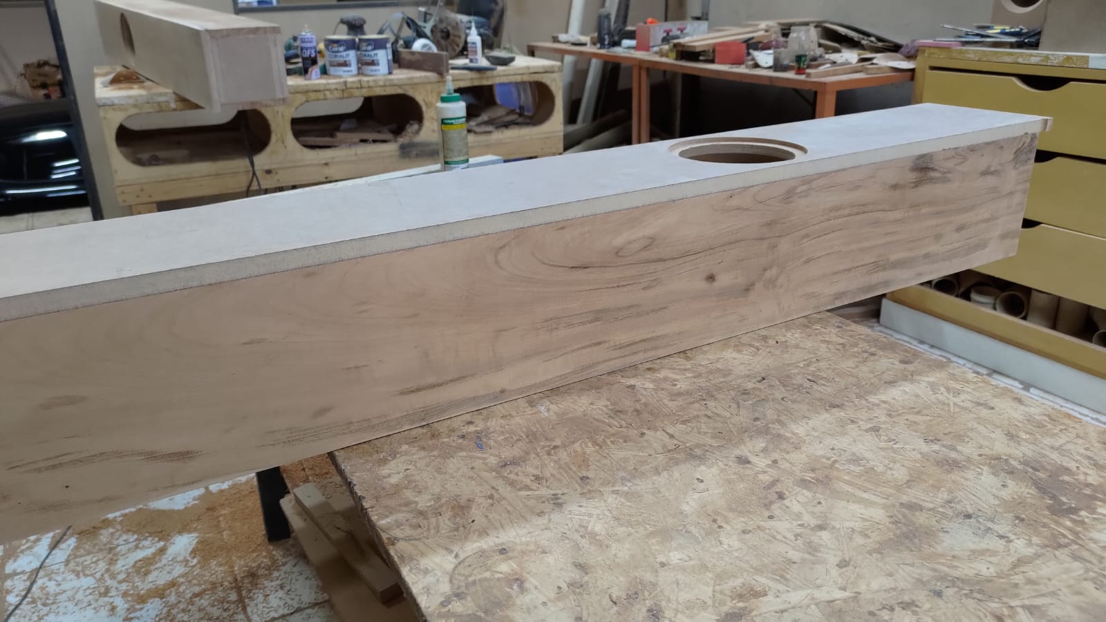

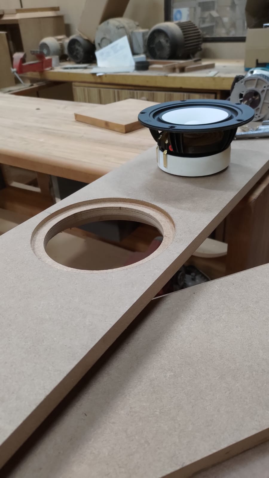

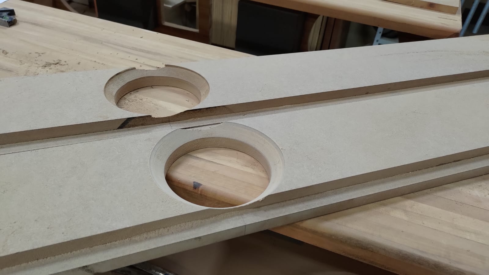

This is My Lhotse loud speaker
