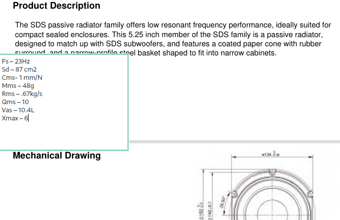

A capture of my screen with some important details for the passive (I can't recall where I found)
In Fs the phase is -180 to the active driver. If CHP goes down to 48Hz I expect to give me some +dB.

OK Elias I see! Didn't know..."Theoretically" passive woofers doesn't need any kind of cross-over BUT they need tuning by adding weight in small increments to find the right tuning for the volume of the enclosure in conjunction with the room resonance + your "taste".

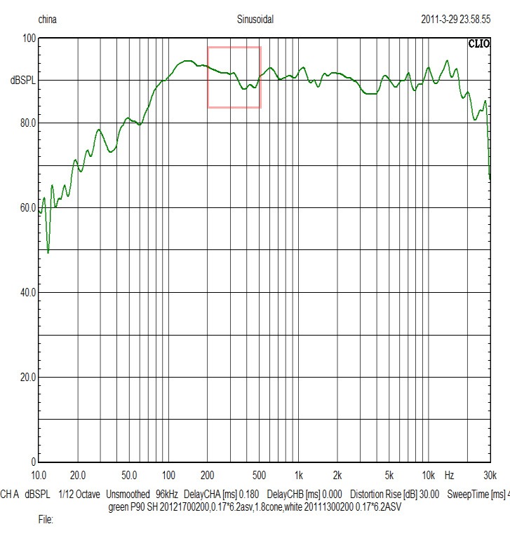

Checking the Frequency Response graph of both RS100-4 and CHP-90 it looks like I'm prob suffering from what is visible that happens btw 200 and 500hz! so the lower midrange!!! and not the real bass itself! In that zone the RS100 seems to have a bit more flat response in that range that prob I like more...
I'll try play a bit with APO to see if I manage to find what's the problem!

From the published frequency plot I see now that at 40Hz the output is JUST 74dB or so !

But on the measured frequency curve it looked promising. There really isn't that much difference between the RS100 and the CHP-90 between 200-500hz.
What you described originally 'sounds' like bass to me and to do it with this driver is to either EQ it with loss of efficiency, sealed + sub system or proper BLH to fill in below ~150 Hz.
