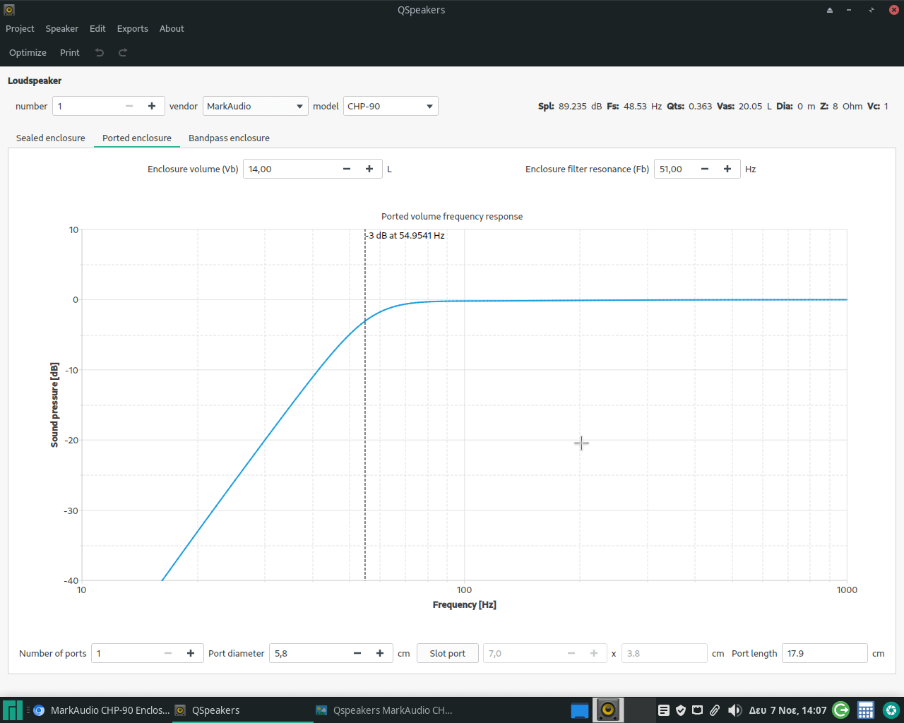

With the numbers you gave in the simulator program I use (Qspeakers) I have the curve I attach.The bass reflex tube should preferably be no more than half as long as the depth of the box.
Port "SD" = 26,42 cm2 and "port volume" = 473ml . (calculated from the numbers at the bottom of the att. picture)

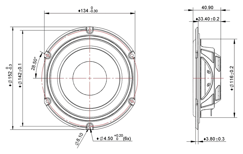

markaudio site have that.Thanks! Specs? Got nothing in a quick search.
CHP-90
FS48.53 Hz
VAS20.05 Ltr
RE6.2 Ohm
QMS2.2008
QES0.4354
QTS0.3635
Bxl4.8444 Txm
SPL89.2353
SD0.0085 m²
CMS1.9898 mm/N
MMS5.5051g
RMS0.7489 WM
MMD4.9619g
L1kHz0.2642 mH
L10kHz0.0880 mH
PWR40 Watts (Nom)
X MAX (Mech)+/- 7mm (One way)

14 litre give me 39cm x 24 cm x 15 cm
Internal measurements. BR.
