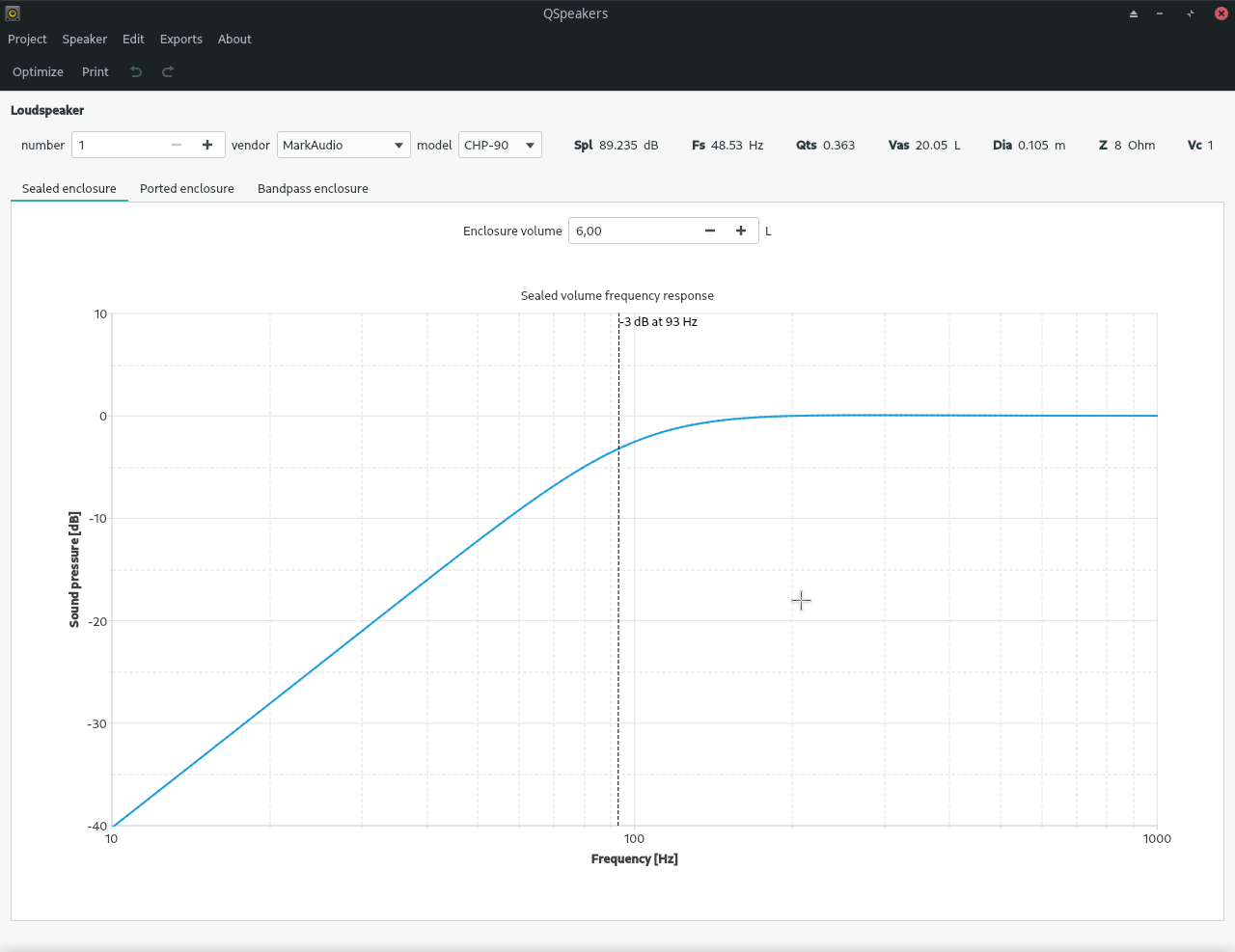

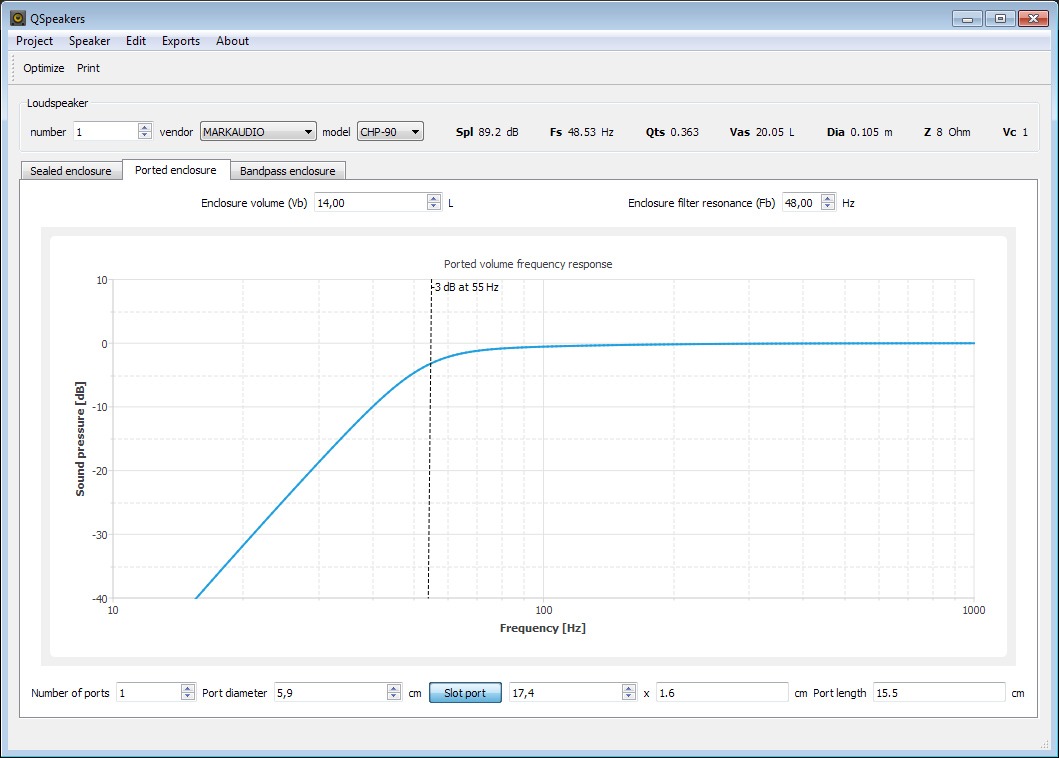

well... I have start playing with my new (for me) game. The Qspeakers (simulator written in Qt6 language) and got some "boxes". Inspect carefully the screenshotsI'll try both the Psamathe and also the miniOnken custom calculated😉 and let's see if it'll come out something good!!! 🙂
OK Elias thanks!well... I have start playing with my new (for me) game. The Qspeakers (simulator written in Qt6 language) and got some "boxes". Inspect carefully the screenshots
I didn't know it but in fact it seems a great program!
Playing around me too... and when you click "optimize" it gives 14L as all the other programs so that should be the right size and nice the feature to have the BR rounded vent or slotted.
14L (17,4 x 42 x 19,5 cm) - slot 17,4 x 1,6 x 15,5 cm seems to be my next step for a basic BR!!!OK Elias thanks!

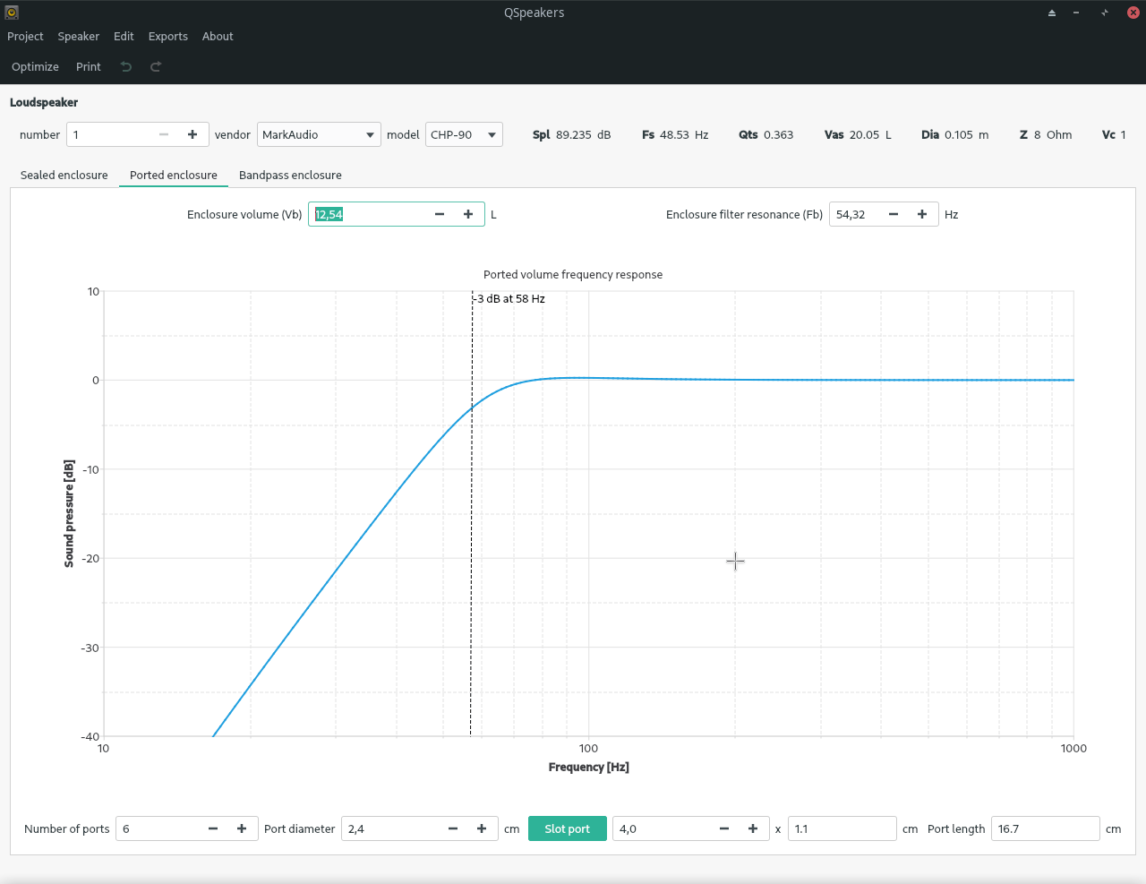

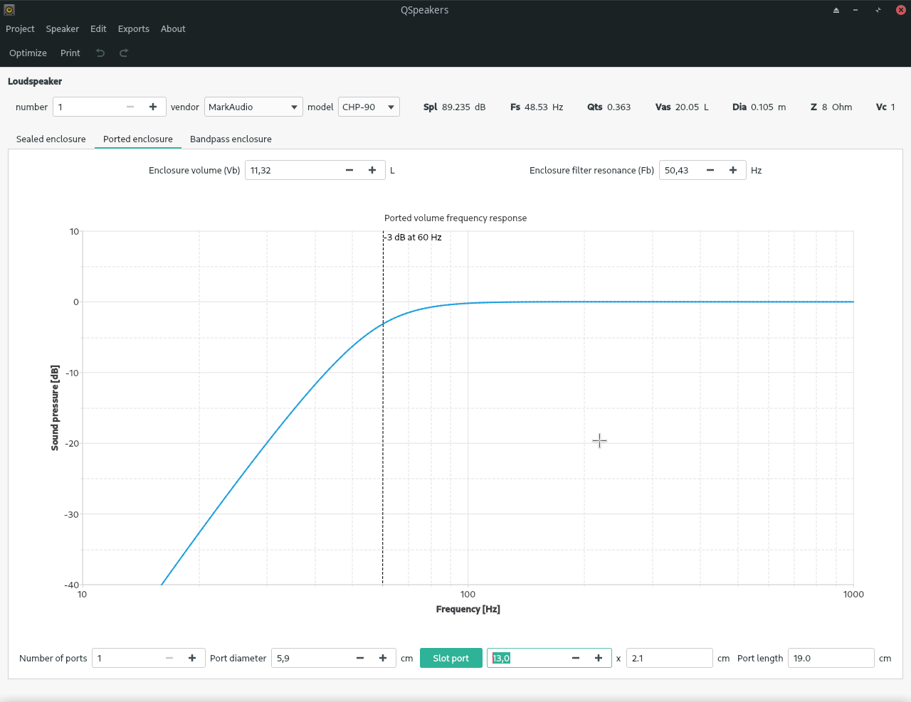

After "optimize" you can further "teasing" it a little more for deeper bass. Also under the header "edit" you can choose the "type" of the port but I'm not yet familiar enough to tell you more.14L (17,4 x 42 x 19,5 cm) - slot 17,4 x 1,6 x 15,5 cm seems to be my next step for a basic BR!!!
We don't know the volume (magnet + basket) of the driver + the volume of sound absorbing material + the volume of the "bass-reflex tube" (plastic, wood, I have seen making tube/port wrapping twine / string on a thin former) and seems to me very sensitive to port dimensions. It is a mater of cut and try and correction to fine-tune. In a closed box I had made some years ago I fine-tuned it using sheets of cardboard to reduce the volume internally (still they are inside 🤔 )
Elias
In the simulation how many mm excursion (Xmax) did you declare ? I declare Xmax = 7mm . Not 14mm (+/- 7mm)
Elias
Elias
For the magnet+basket I would say around 1L , prob less! and I think you'll NOT have to consider the tube and the damping material in the total volume...After "optimize" you can further "teasing" it a little more for deeper bass. Also under the header "edit" you can choose the "type" of the port but I'm not yet familiar enough to tell you more.
Elias
About the Xmax, yes, 7mm

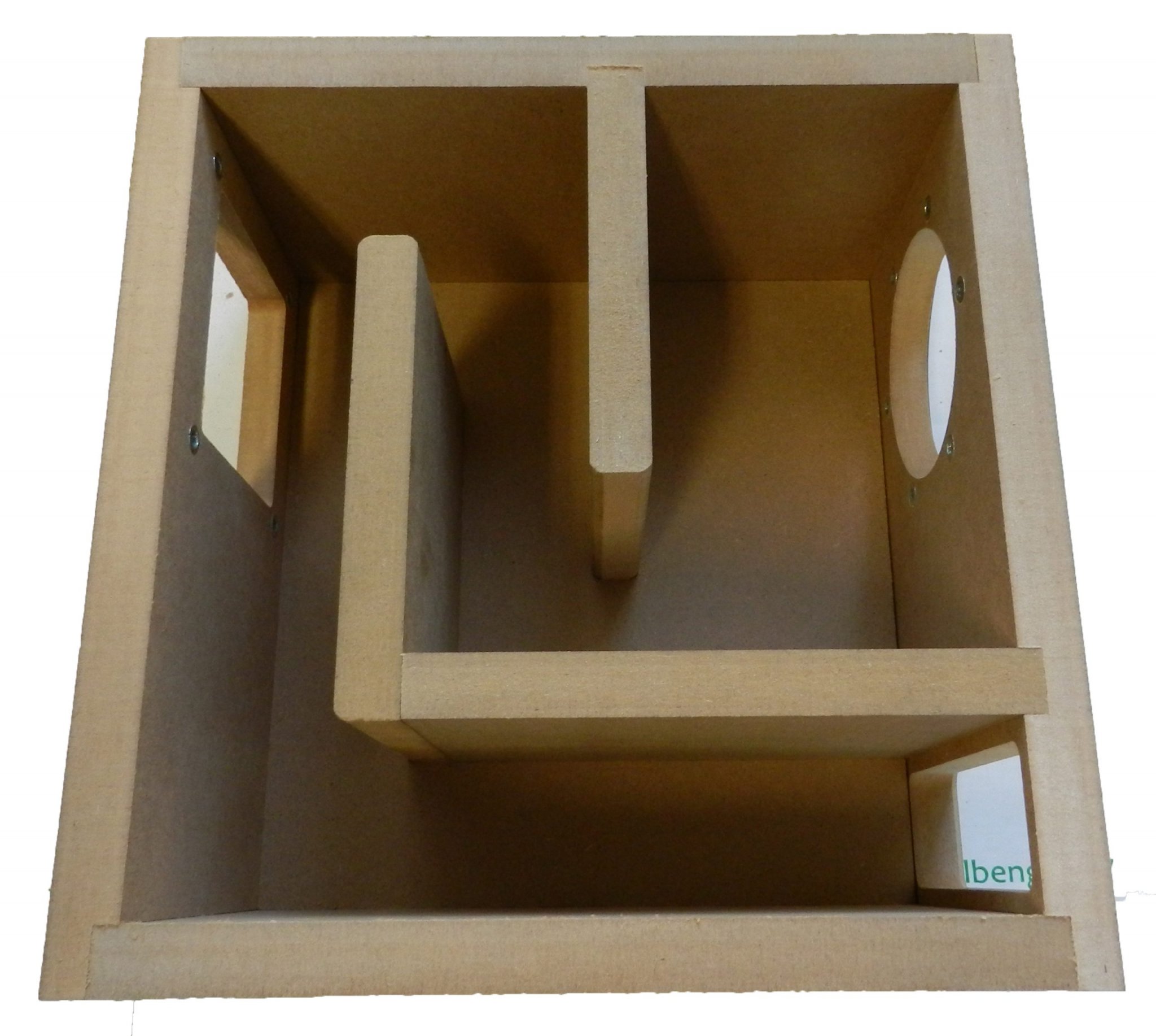

If there is any expert around that can help getting the right size of a "simple" MLTL would be great!!!
What I'm looking for is smthg like that one in the pic... comes from the HADO speaker
The bass that I hear and really like! is some kind of "resonance" in some moment/some note/HZ that is the soft gentle "physical" effect on the ear drum I said before.
The Pensil is for damping high Qt drivers, so no 'wow' factor, just smooth response.
The HADO appears to be a small box with a large, long vent, ergo has a large/long air mass 'plug' resonating around tuning, so definitely 'physical'.
A MLTL with a large vent will be similar with how much depending on how much you damp it.

In a 14 liter box, 30mm or 35mm bass reflex tubes are recommended for Alpair CHP-90. ~1/3 of diameter of cone.
The larger the diameter, the longer it must be at a certain frequency to which the box is tuned.
Alpair CHP-90 should be tuned at about 50hz in a 14 liter box. It is the optimal volume as the box affects the element minimally and in order to get such an even frequency curve over all frequencies. You can increase or decrease the volume slightly. +- 2 liters does not affect much.
If you tune the box with a bass reflex tube that is too small, the air velocity increases. Unfortunately, this can cause distortion from the bass reflex tube.
Skilled designers place the tube on the back of the box so that the air does not disturb and affect the experience and the sound image. If you find bass reflex tubes that have a radius at one or both ends, they partially reduce blow noise.
The bass reflex tube should preferably be no more than half as long as the depth of the box.
