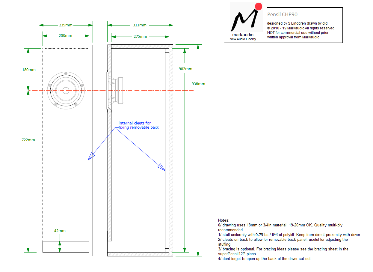

I think the CHP-90 mica's specially designed "Pensil CHP90" is the more better choice?
I've never listened to Pencil. But it is a similar construction close to your own.SDDBH and DDVP are not designed specifically for this project.

Thank you nandappe for suggestions on 14L Japanese distributor and also for the Pencil!14L bass-reflex kit for the CHP-90 is available from a Japanese distributor.
I would like to try the Pencil but not the right size for my desktop! 😉)
I'll probably make a test box for Pensils just because really too curious about how they'll sound!

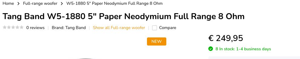

Interesting also the similarity in parameters with the MAOP!
I did also found a nearly identical values btw the CHP-90 and the Tang Band W5-1880, so thought that some enclosure made for the TB would fit also the CHP-90!
Let's see...

Too expensive for me. For this reason I buy CHP-90Thank you nandappe for suggestions on 14L Japanese distributor and also for the Pencil!
Let's see...

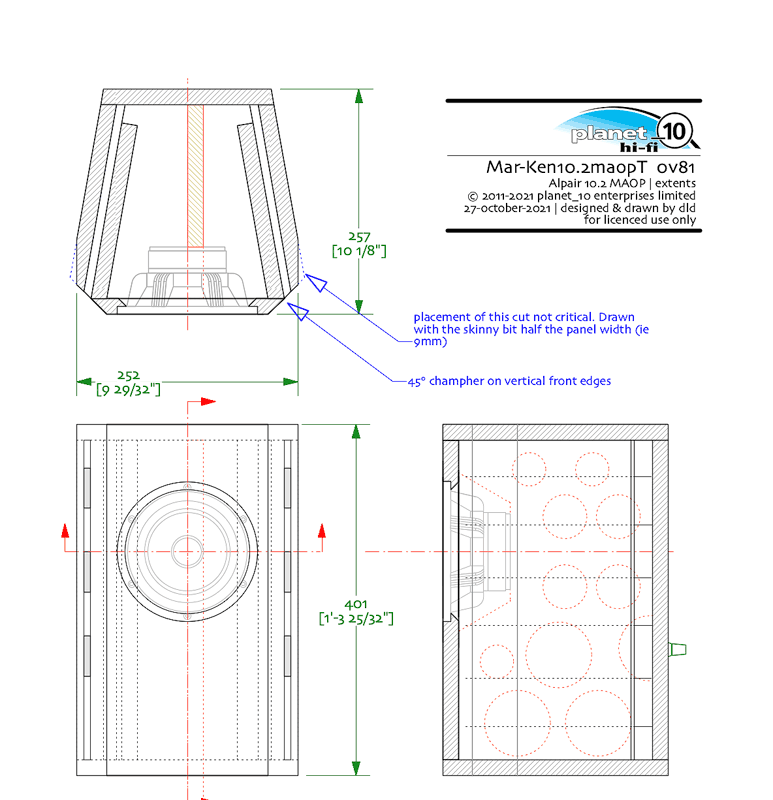

And, just out of curiosity... what about this Planet10 MarKen??? Your 10P MiniOnken is really different??? A custom build?
That picture is the one that most resembles my MiniOnken. 6 ports to be calculated for different drivers. The volume is also important. There you see the conical shape in the depth which helps to reduce resonances.Oh yes, you will have to tell us how they compare!
A little more difficult to build with these angles. But believe me, it's worth it.
If I decide to build them with miniOnken, I have to ask planet10 to do plans for them. Which of course takes longer time.

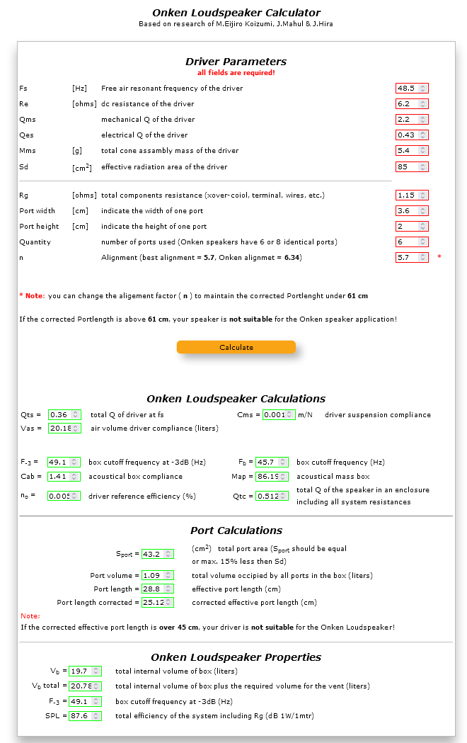

I think at the moment I'll be testing a 20L Onken with 3 small ports in the upper and lower side!
Here a calculation I've made...
Who knows! Maybe they'll sound great!
Edit PS: but woodworking not today! because there is the AudioVideoShow in Warsaw where I'm now 😉 so I'll not miss it!!! 🙂
Me, I think I prefer leaving the fullrange alone, if the box is well done I can certainly be satisfied by the bass and I don't need a PR.
