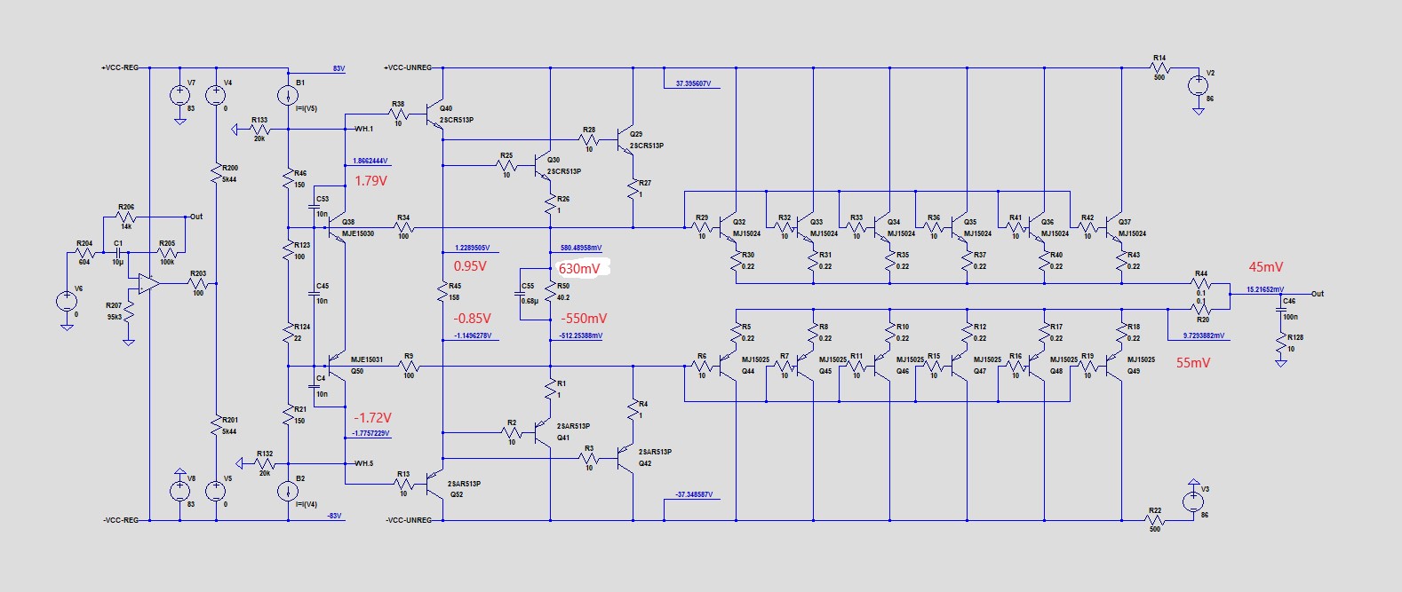

I have again the problem that I cannot adjust the voltage drop over the lamps. Now the pot is in the safest position(fully open) and the voltage drop is already 85V.
As far as I know voltage drop should be now close to zero and by turning the pot it should increase. Right?
Attached are some important measurements.

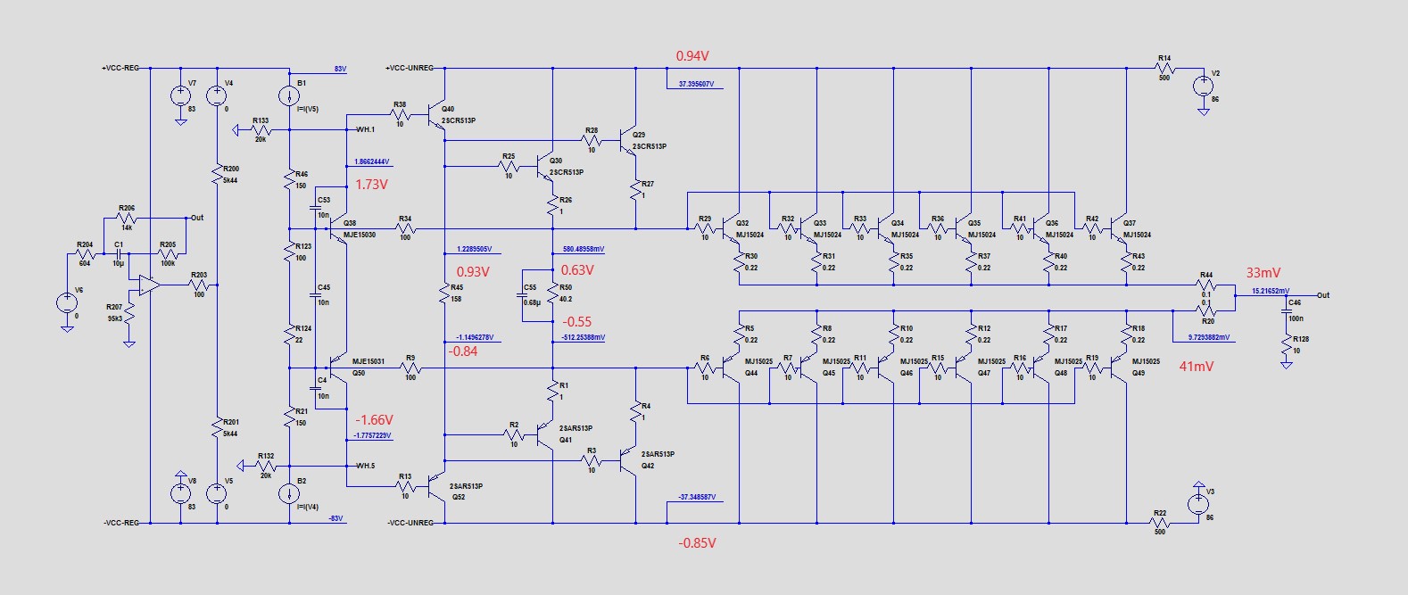

I think I have found the problem. I have measured voltages over all the 0.22R resistors and here are the results:
mV mV
3.42 3.29
3.08 3.83
3.58 3.51
3.76 3.45
0 0.2
3.58 3.82
The collector voltages are 0.95/-0.85 respectively.

You may have have found a problem, but I'm not sure if this is "the" problem.
When dividing all voltages through 0.22 and adding them, the positive side gives 79mA and the negative side 82mA, roughly the same.
The voltage over R20 is 10mV, so divided by 0.1 Ohm is 100mA.
So I still miss some 20mA, exactly what one complementary pair should have added.
Are you sure about the 0mV and the 0.2mV.
Bet even when there is 0mV on a 0.22Ohm resistor, it only means that this transistor is not conducting because the 0.22Ohm resistor in disconnected or the 10Ohm Base resistor is not connected.
You could check this with the power off.
But I see no cause of the problem real problem in this.
Now I would like you to ask you to do the following:
Make 2 pictures exactly as you did with the voltages in red but now
1) with the pot in the minimum position , and
2) with the pot in the max position.

What you have is very strange.
Is it possible to take out one side of R45, 158Ohm.
This resistor momentarily prevents Q29,30,41 and 42 from conducting.
Again all voltages like in the last posting.

I may have found the cause of your problem.
You were right after all with the 0.22Ohm resistors having no current.
These particular power transistors must have a Collector-Base short, while the emitters are not conducting.
Either this is a short circuit on your PCB, the most likely cause because the problem is intermittent, or the transistors are broken.
To get this confirmed, take out the 10 Ohm base resistor of these transistors.
If you haven't taken our R45, just leave it in place.

It is probably simply possible to find those Base Collector short circuits with the power switched off by measuring with your mulltimeter.
Hans
Hans
I have found the shorts and I will desolder those two transistors tomorrow at my work. I hope it is only short and the transistors are ok. Thank you so much again.
I desoldered the shorted transistors and found them broken.😡
