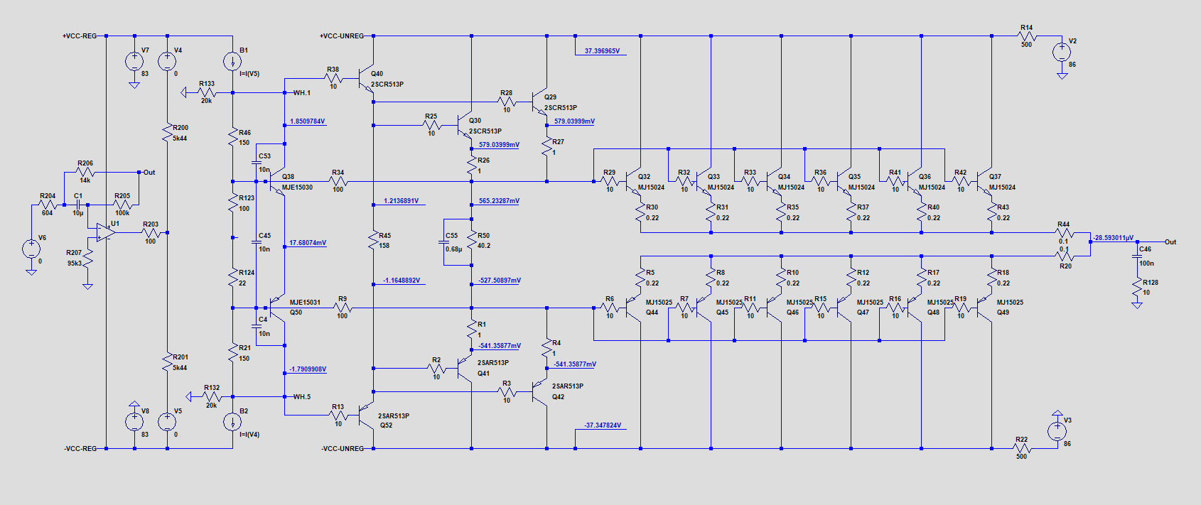

I'm just wondering that how can it still generate the 12V for the balanced circuits...
R113 is probably mounted on a heatsink, but is has to dissipate 2.3 Watt now instead of 1.2 Watt at 83 Volt +Vcc Reg.
So don't expose this to long to 111 Volt.
Hans

4) I have made a new simulation with the lamps in the lines, here visible as R14 and R22, both having 50V voltage drop.
Plse make a copy of this circuit diagram, and use it to report the voltages to me on those places where voltages are shown (14 different values) after you have repaired the Vcc Reg.
That will save you and me a lot of time.

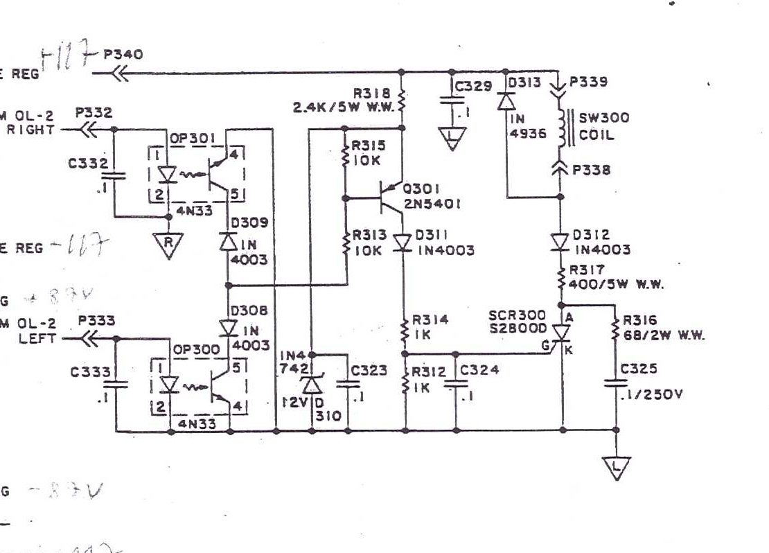

That's O.k. because I gave you the wrong number, P332 belongs to the right channel 😀 I thought your right channel was defective.
Take off P333, that's the left channel.
Hans
Now I'm really confused.
Taking off P332 or P333 should never result in switching off the Amp no matter right or left channel.
If it does, the circuit diagram you gave me does not match your amp.
See image below.
A current has to flow through the diode of the 4N33 opto coupler to activate the triac that energises shut off relay SW300.
No connection, means no current can flow.
So with both P332 and P333 detached from this circuit, you completely disable the protection circuit on OL-2 for both amps.
But only when you have this circuit diagram.
Hans
See image below.
Hans
You are right Hans. If I take P332 or P333 cable off the amp will turn and stay on. If both are connected I cannot turn the amp on.
I was mixing the channels again. So Left channel is luckily still fully functional and connected. Right is at the moment not connected.
Yesterday I did not have the temperature sensors soldered in the main board. Now OL-2 board is connected + the P332 and P333 connected the amp turns and stays on. Left channel connected, right disconnected. So temperature sensors need to be soldered otherways the amp will not turn on. By default temperature sensors are shorted and when the heatsinks get too warm sensors disconnect the line and amp will be turned off.

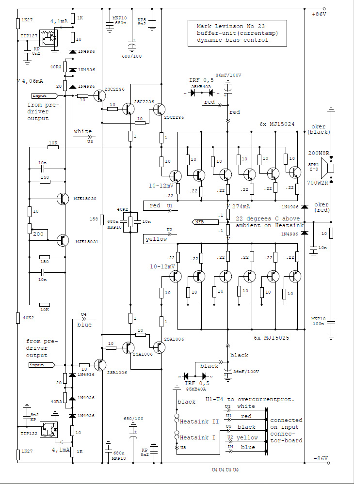

Yesterday I biased the left amp to 27.5mV over R20 after fully warmed. Now when I turn the amp on it will start from 50mV and will go slowly low towards 27.5mV. I quess that is OK?
The OL-2 Board needs a VCC supply to function, but the schematic doesn't tell which Vcc, probably +Vcc unreg ?Yesterday I did not have the temperature sensors soldered in the main board. Now OL-2 board is connected + the P332 and P333 connected the amp turns and stays on.

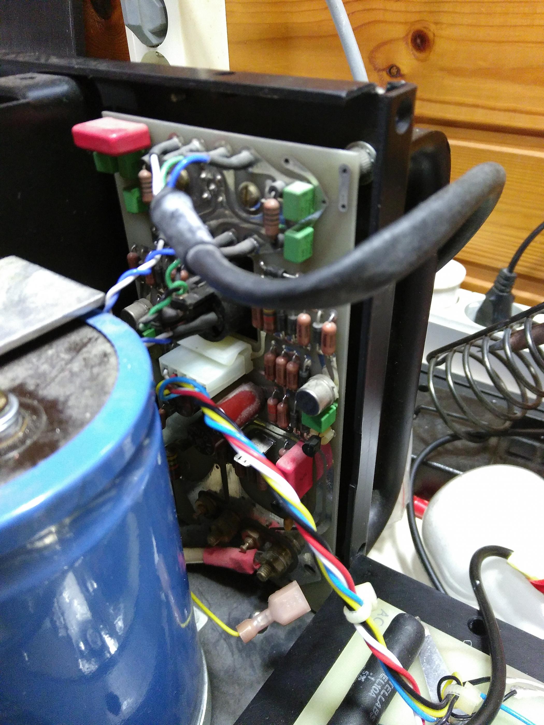

Maybe you can send a picture of this OL-2 board.
CorrectLeft channel connected, right disconnected. So temperature sensors need to be soldered otherways the amp will not turn on. By default temperature sensors are shorted and when the heatsinks get too warm sensors disconnect the line and amp will be turned off.
There is no other way so this is it.Yesterday I biased the left amp to 27.5mV over R20 after fully warmed. Now when I turn the amp on it will start from 50mV and will go slowly low towards 27.5mV. I quess that is OK?
When driving a 2 Ohm speaker at 700Watt, peak current is 26.5 Amp.
So the 0.5Amp at start up seems completely harmless to me.
You could check the ripple on both left amp's Vcc's.
Using again the formula C=I*dt/dV gives the the momentary value of the 36.000 uF capacitors C300 and C303.
After warming up I = 0.32Amp, dt = 0.01sec, so with 36,000uF, dV should be ca 90mV.
Hans
This is where I found the 275mA idle current.
Hans
Oh. I was wondering where did you get that number but I have had it all the time too.
The disconnected yellow cable is the P210 to opto coupler. Black thick cable is the input cable to the main board. Not sure why it starts with four wires and ends with three(+ and -balanced and ground)
I’m almost horrified by the huge cable mess.
That must have been a very expensive production process and a complication when trying to repair.
But at the end, the ML23 is praised in many test as a super sounding amp,
Hans
