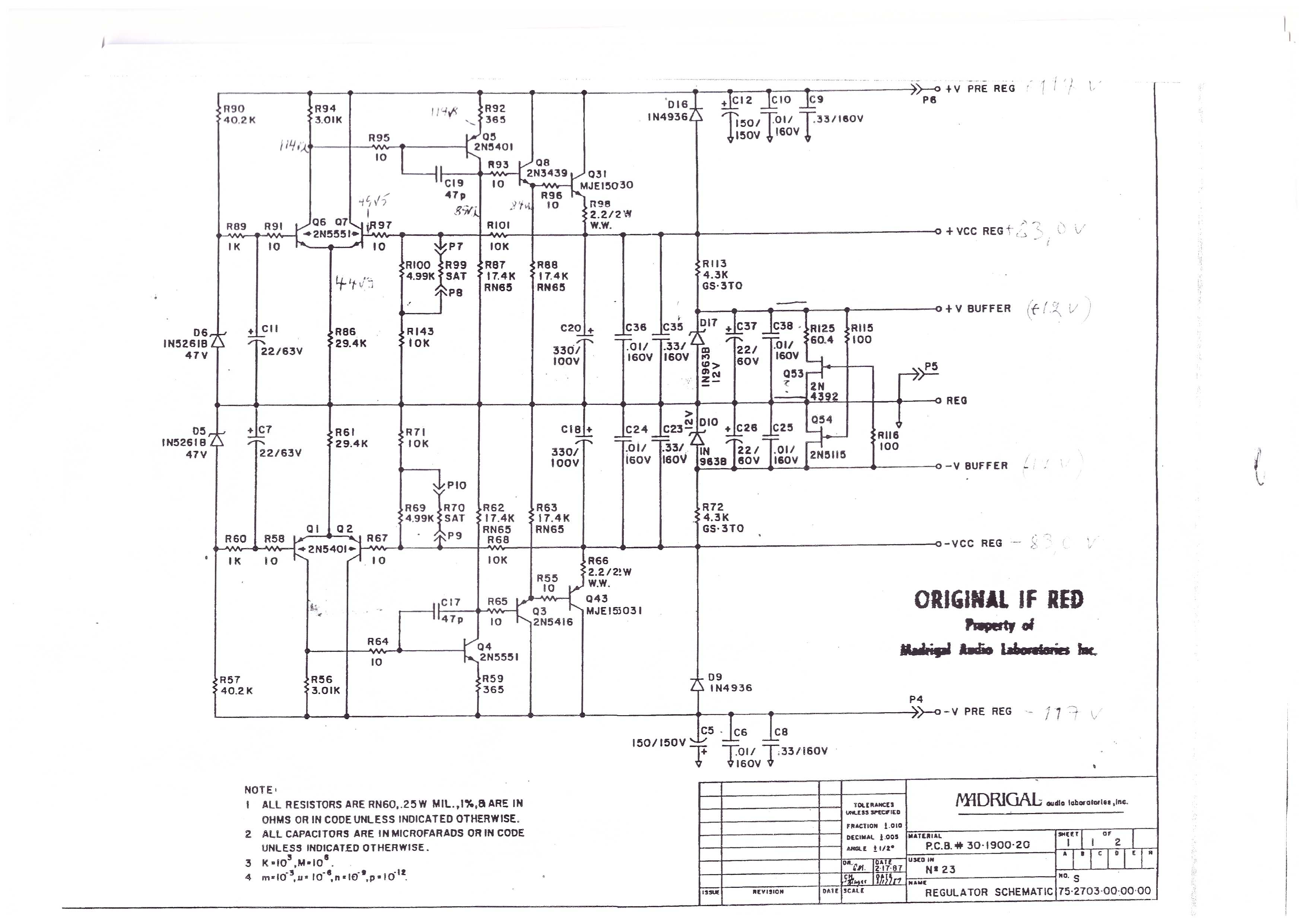

Hans,
I think I have found new problem which is causing this. I have attached the last part of the schematics. It is the voltage regulator. The problem is that in +VCC Reg I have now 109V insted of 83V. All the rest seems to be ok.
Wow, that is alarming.
I see two strange resistor called R99 Sat and R70 Sat.
This component can influence the output voltage to a large degree.
Could you try to find out what component this is.
Without this component, output voltage will be D6*(R101+R100+R143)/(R100+R143)=47V*(25k/15K)= 78 Volt.
So if you can't find this R99 Sat and R70 Sat, just pull out their connectors from this board, and we'll search for it later.
Working with +/- 78 Volt is no problem.
Let's first try to find the problem with your amp.
Hans

Can you measure with resp to gnd the voltages on R93, R96 and R98.

All these voltages are completely crazy.
Is it possible to disconnect +Vcc reg and -Vcc reg and measure these voltages again.
And also +V Pre Reg
Hans

I remeasured the VCC reg to ground. It shows 3 kohm. I need to disconnect always the VCC pre regs before the amp off measurements because there is always something like 3V coming from the VCC pre reg power supply caps C301, C302, C305, C306.
Just forget the Ohm measurements, your meter is giving confusing results.
Let's concentrate on voltages.
My guess is that Q8 and Q31 are both broken down because of some accidental short circuit.
Hans
Hans
Diode D16 is passing in both directions. That seems to be broken. Need to desolder and verify. Q8 is ok. Q31 is also passing every direction with diode test. Need to desolder that too.
I'm just wondering that how can it still generate the 12V for the balanced circuits...
I do not understand how D16 can break down, but it explains at least a bit of the 111 volt.
A 1N4936 is supposed to be able to handle 400V DC, 1 Amp continous and 30 Amp peak ??
Q31 if broken can be easy replaced, it's still a current transistor only costing a few Euro's.
Hans
