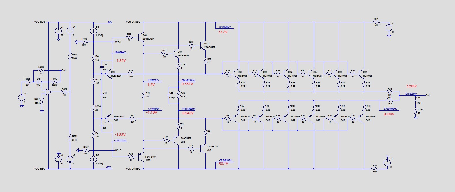

Here are the voltages of current situation. I let the amp cool down and there was right values in the VCCs right from the start. No evidence of shortages anymore.
Everything looking fine in your image, except the output voltages.
Probably the output must be 15.5mV instead of 5.5mV, but it can never have a lower voltage as the other side of R20 with 8.4mV.
What you experienced is exactly what I was afraid of, you still don't seem to have solved the intermittent problem.
Without lamps you would probably have killed the amp.
So first of all, was your OL-2 board connected ?
Second question, what lamps are you using, still the 40W 220V ?
The reason I ask is because when you use 110V lamps you have an immediate optical feedback with a sudden 85 Volt on them, I think you will desperately need them now.
So you will have to find the cause of your problem. Obviously there is nothing broken, so it must be a bad contact or a hair crack in a trace.

I made a mistake in the output voltages. Values were right but vice versa; 8.4mV in the output side and 5.5mV on the transistors side.

Yes, I could set the bias to around 275mA!😎
But I still have concerns about the new positive side transistor. All the 0.22R resistors should have around 10mV drop as I compared to left channel. This new transistor has around 40mV drop in that specific resistor and the rest around 3mV so it seems that this transistor is not very good match for the old ones.
The transistor in the negative side is much better match.
You are right, this is too much, I'm surprised by this large difference.
You have two options,
1) try another transistor with a higher Vbe, or
2) disable both new transistors by removing their 10R base resistor.
Removing the 10R resistors may sound weird, but as long as you don't need 700Watt into 2 Ohm, you can still safely drive 700*(5/6) = 580 Watt.
So for normal use this is more than adequate.
Now reduce the idle current to 275*(5/6) = 230mA to keep the current per transistor the same 45mA as before.

I changed the problematic transistor and quess what, now they match nicely!
Here are voltages over 0.22 resistors(mV):
positive side:
10,9.6, 11.3, 11.6, 9.4 10.5
negative side:
8.3, 11.4, 9, 8.8, 13.3, 9.7
output dc voltage 4.8mV.
