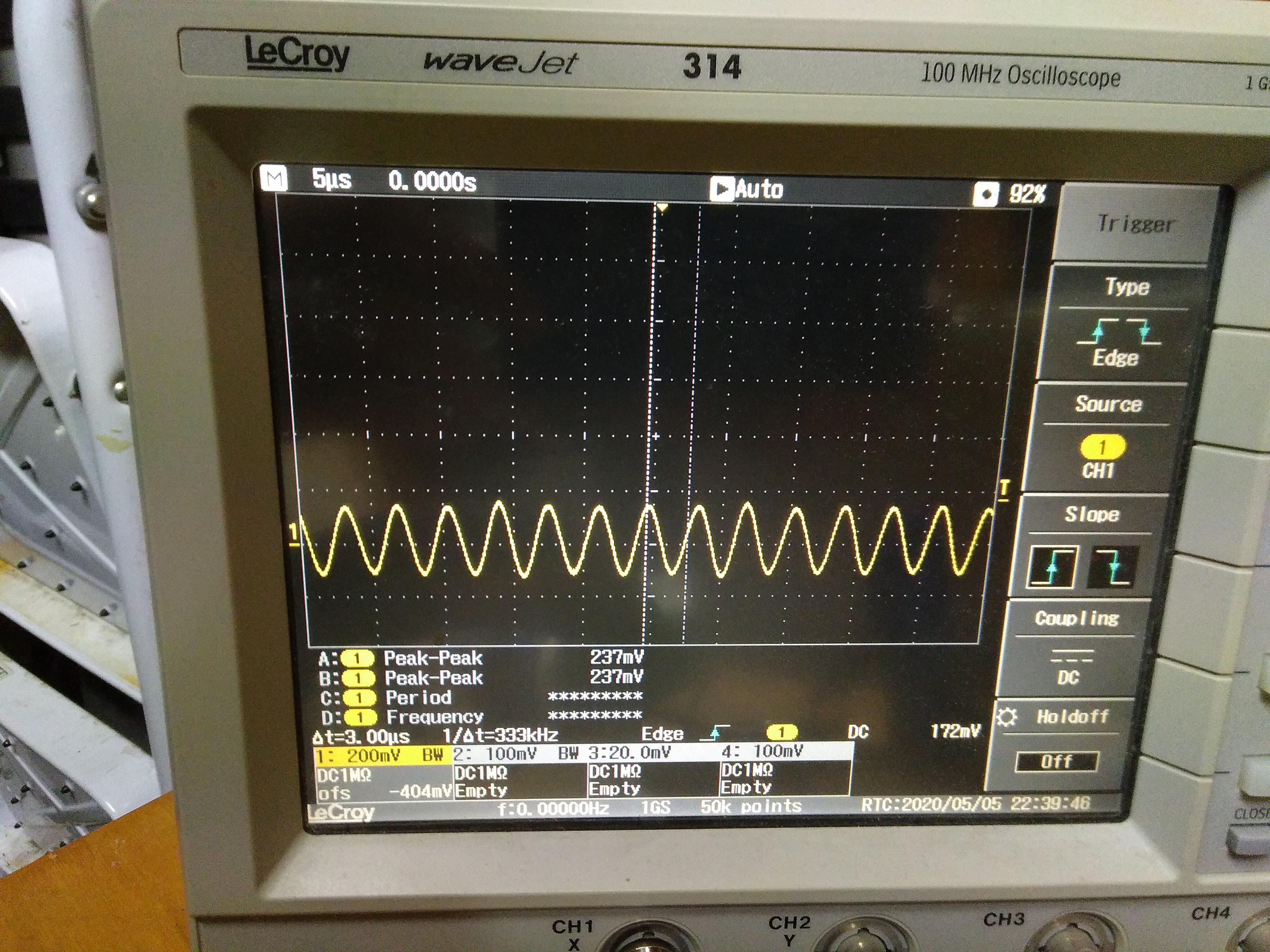

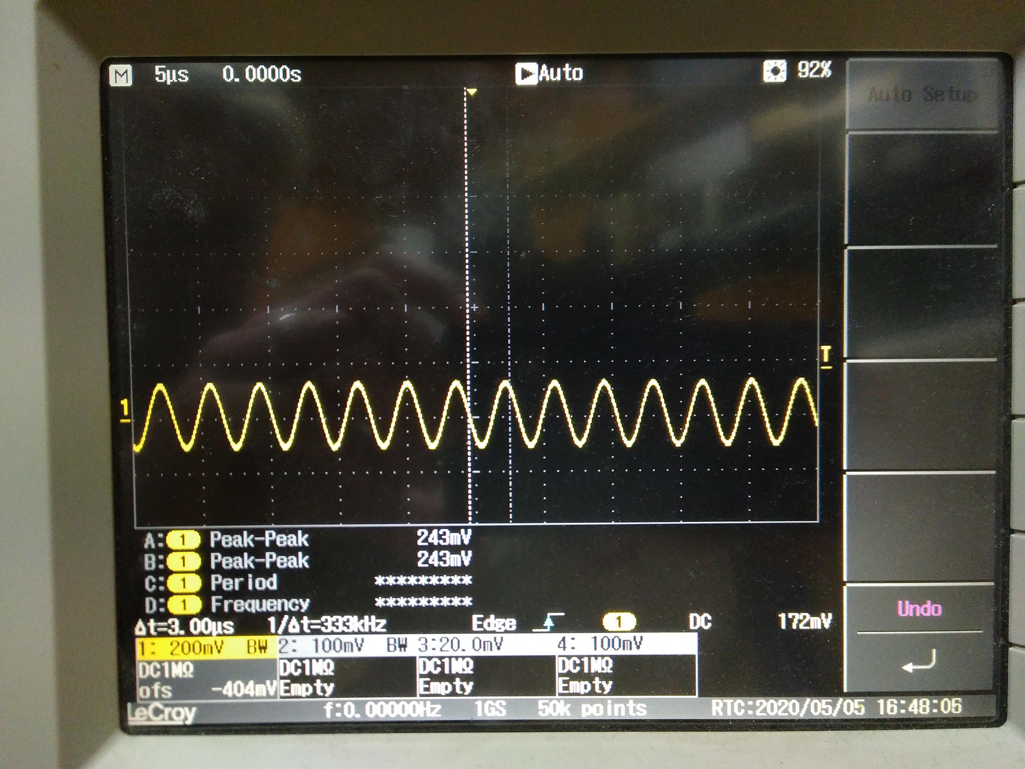

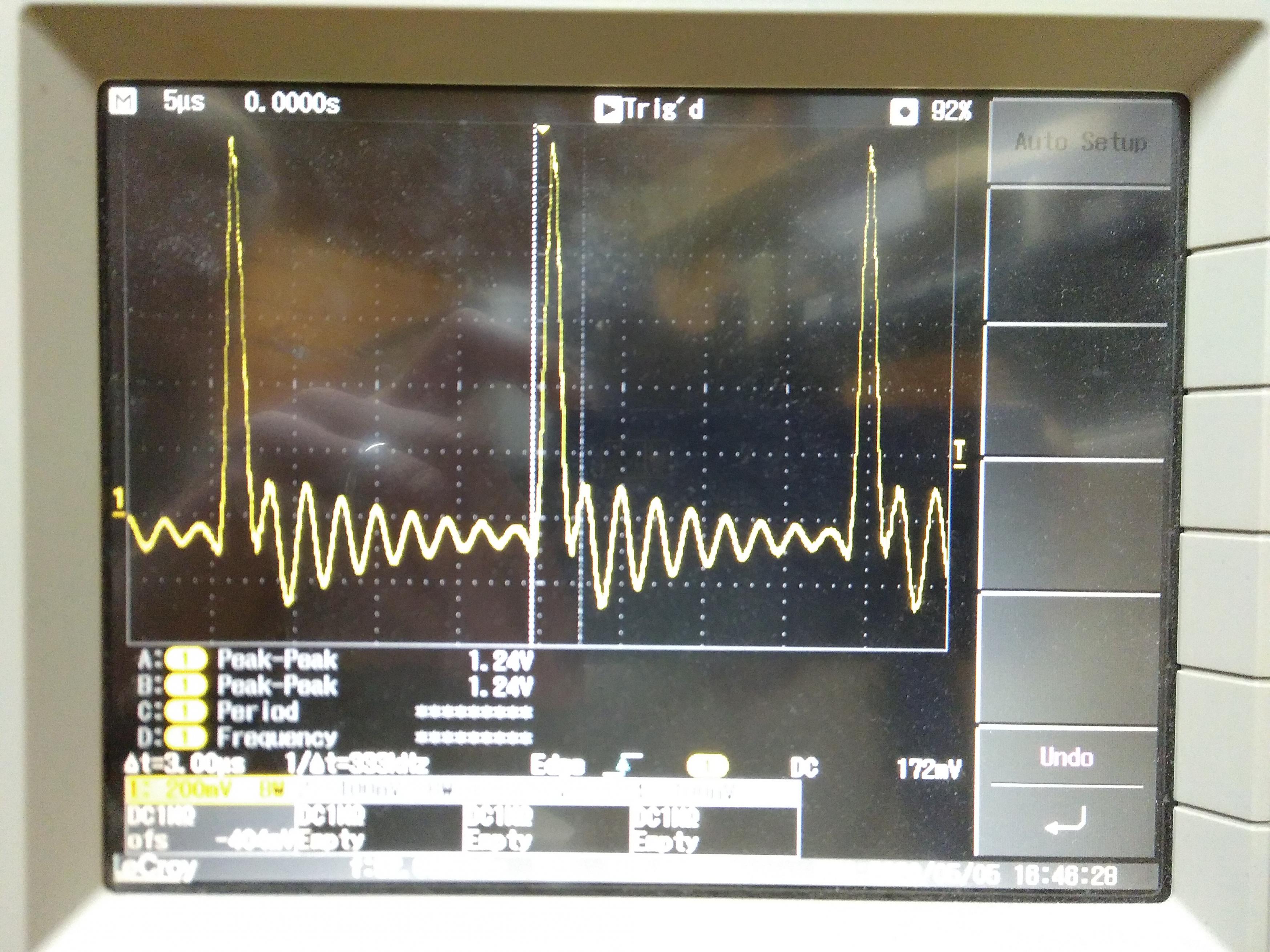

I think I still have issue with my right channel. Take a look at these scope views from speaker terminals.
No input signal and just open connection, I also tried to short the inputs and the result was same.
Here are the same measurements with WH.1 and WH.5 shorted.
First of all: What is in detail the left and resp. the right image ?
1) Now disconnect the four connections of the OL-2 board and make the same recording again with WH.1 and WH.5 still shorted.
2) and with the above situation, connect the shorted WH.1/WH.5 connection to the speaker output to completely disable the output stage.
Now do the measurement again.
Hans

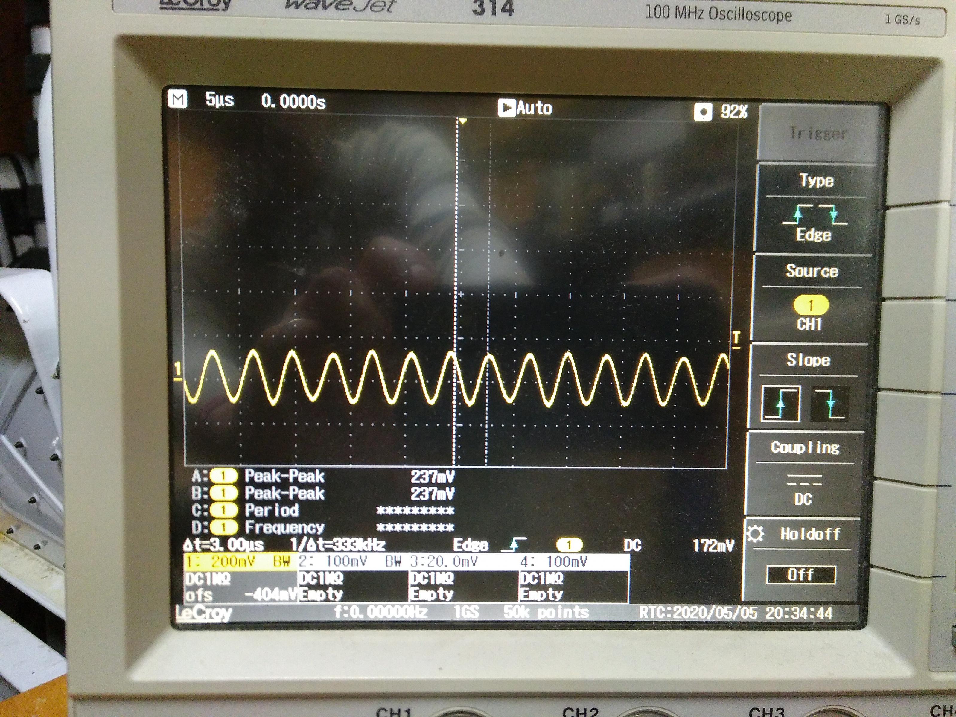

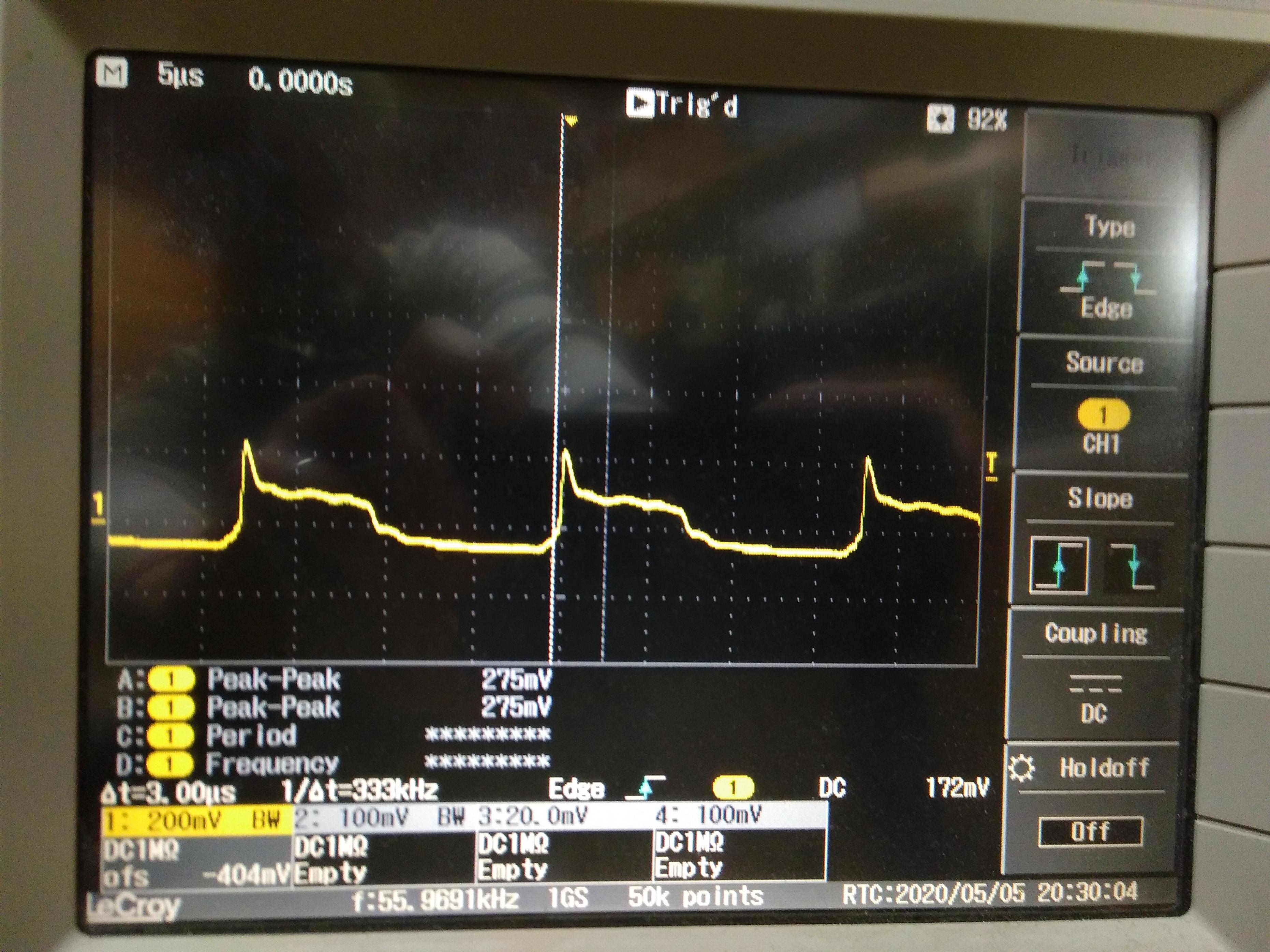

Sorry Hans, I was not clear enough. The pictures are left and right channel.
When I measured WH.1 and WH.5 shorted it was number 1 case.
Here is the number 2 case. WH.1 and WH.5 shorted and connected to output.
You see sinus on the left channel because by my mistake I made the measurement to left channel also even if I did not do the short in the WHs, so that is why left channel have been all the time same.
Do you need same measurements from the left channel also or is it enough to concentrate to right channel?
Another question; do I need to use 8ohm resistor between the speaker terminals when doing these measurements?
In all these measurements 200mV/div and 5us/div
I have sent you a PM where I suggest to shorten the line and communicate per email.
I still don't understand what you are saying, why do I see a sinus from the left channel when no signal is applied ??
This channel should show noise at a very low level, in the uV range.
Hans

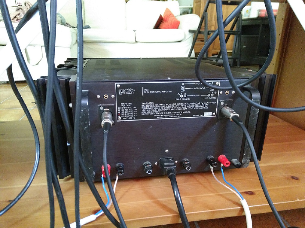

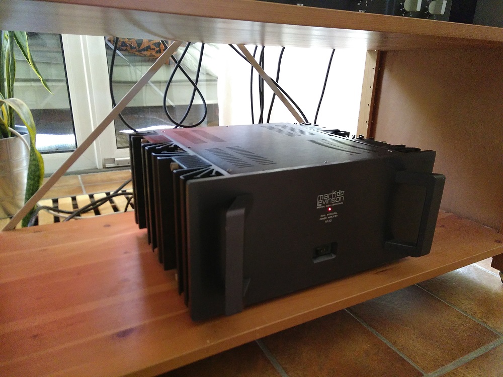

I am happy to inform that after countless hours hard work and email exchange, Mark Levinson No.23 is back in life again.:)
Without help from Hans I could never ever have done it. Thank you diyAudio and Hans Polak. Attached a few photos from the amplifier in action.
