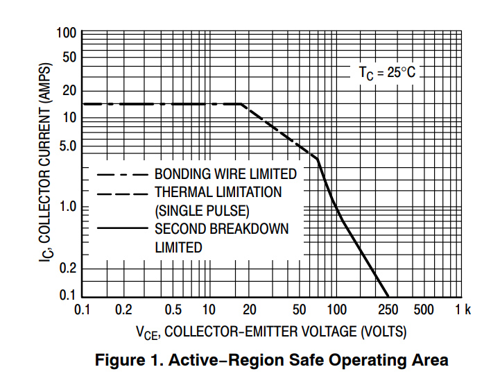

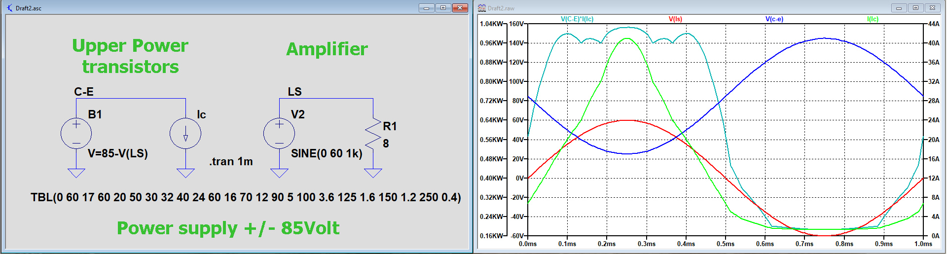

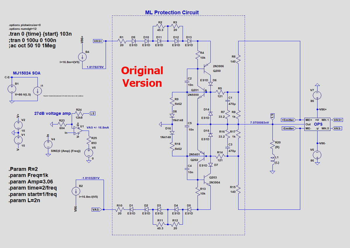

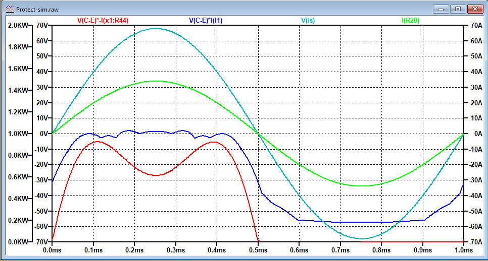

Simulation setup:
I started to construct a simple reference circuit in LTSice with a conditional voltage source that replicates the voltage on the Power transistors (Supply voltage minus LS voltage), connected to a current source loaded with a table replicating the exact SOA.
The ML23 has 6 output transistors, but to keep some safety margin I multiplied the single SOA current values with a factor 4 to account for individual differences between the transistors.
With the help of this simple add-on I had a direct reference of what was allowed versus the real load.
See first image below showing what is to be expected in current and power limits versus applied voltage.
The exact ML23 current OPS, replicated in a subckt, worked on the encircled Mark Levinson current protection circuit in the second image below, enabling to simulate all possible conditions.

Since I wanted to know the effects of phase shift between voltage and current on the effectiveness of the OPS protection, but also the protection during a short circuit, I planned to use various resistive loads from 0.1R (Short circuit) to 8R at frequencies from 50Hz to 10Khz and inductances from zero to 200uH to find eventual weak spots in the protection circuitry.

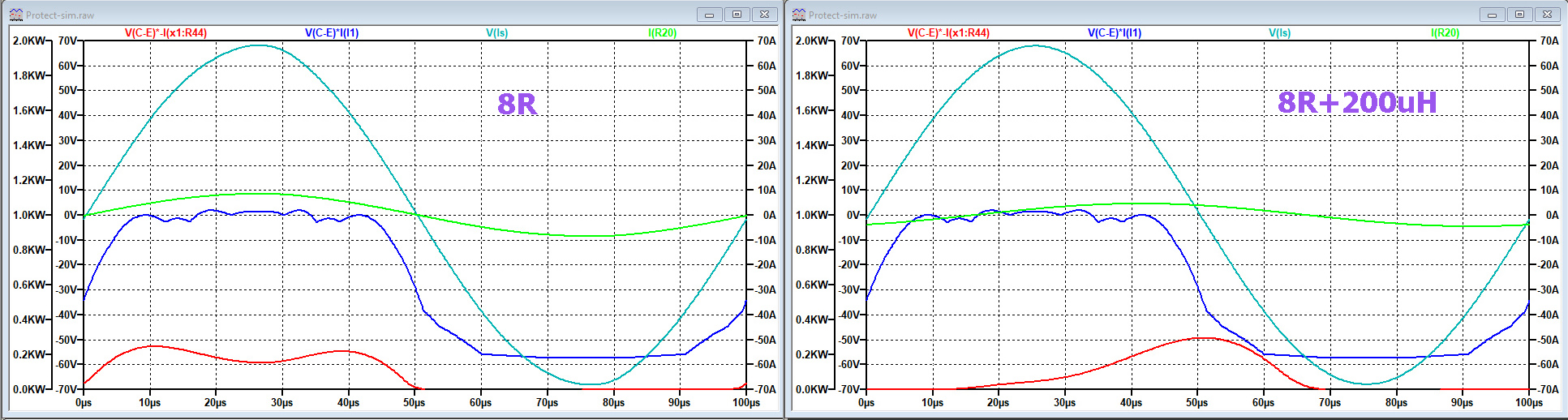

Mark Levinson (ML23.5) OPS correction, part two
8R load:
The first image below shows the response for an output voltage of 70Volt-pk with resp. 2nH and 200uH load in series with the 8R load.
What you see are: Output Voltage at the LS (Cyan), Current through the LS (green), Consumed Power in the upper halve of the OPS (red) and Allowed Power consumption according to 4 x SOA (blue).
The lower halve will consume exactly the same amount of power and is not shown for that reason.
With 2nH, the red curve is way below the blue curve, so nothing to fear and also in case of the added 200uH inductance, the red curve comes close to the blue curve but is still O.K.

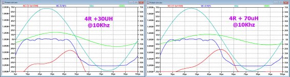

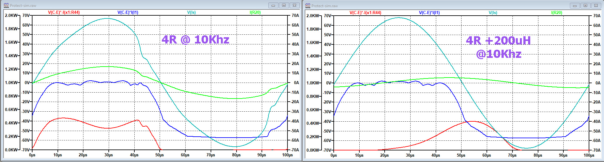

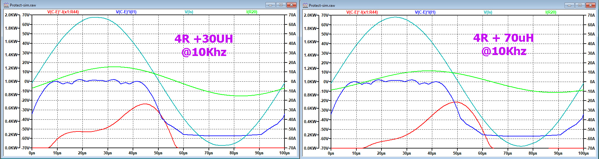

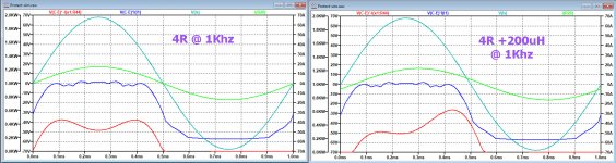

4R load:
Second image below shows the same conditions as above but now for 4R @ 10Khz.
With 2nH, the crowbar is on the brink of coming into action, but this action is aborted resulting nevertheless in a rather distorted signal. But consumed power is well within the allowed curve.
With 200uH, because of the phase shift, less current is now flowing, resulting in no crowbar coming into action.
However, where power consumption with the 8R load was still within the SOA, this is no longer the case and the power consumption exceeds shortly the SOA at this frequency of 10 KHz.
Going down in frequency, the situation relaxes as from 1 KHz and below.
With 2nH the crowbar doesn’t try come into action anymore and with 200uH the consumed power is now within the allowed curve. See third image taken at 1Khz.

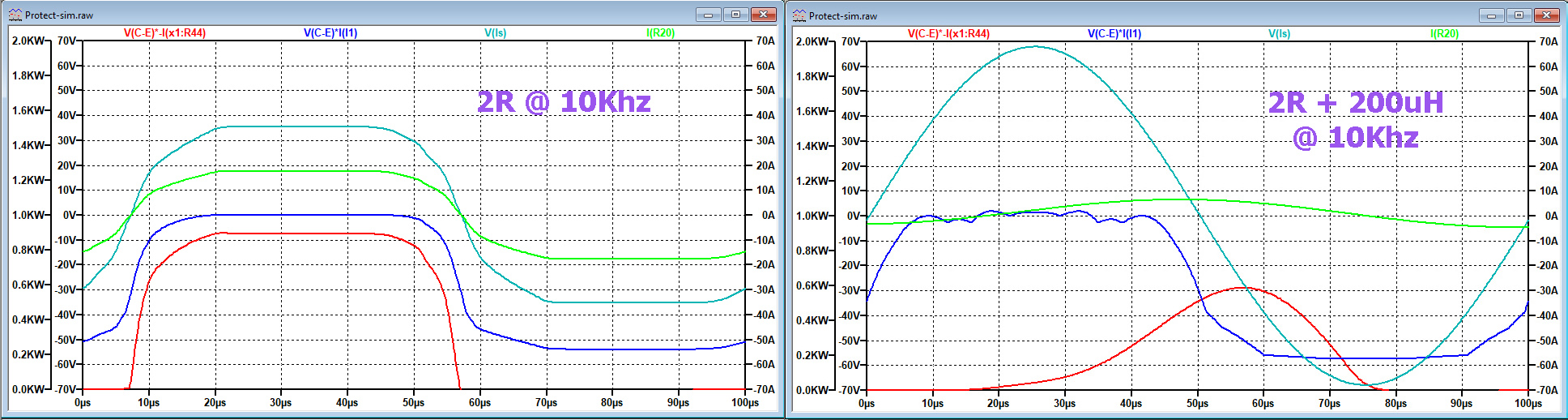

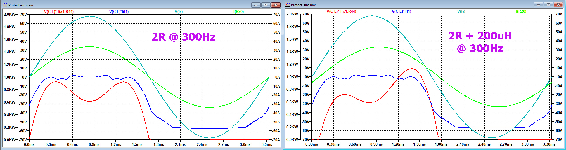

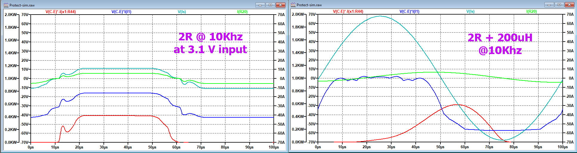

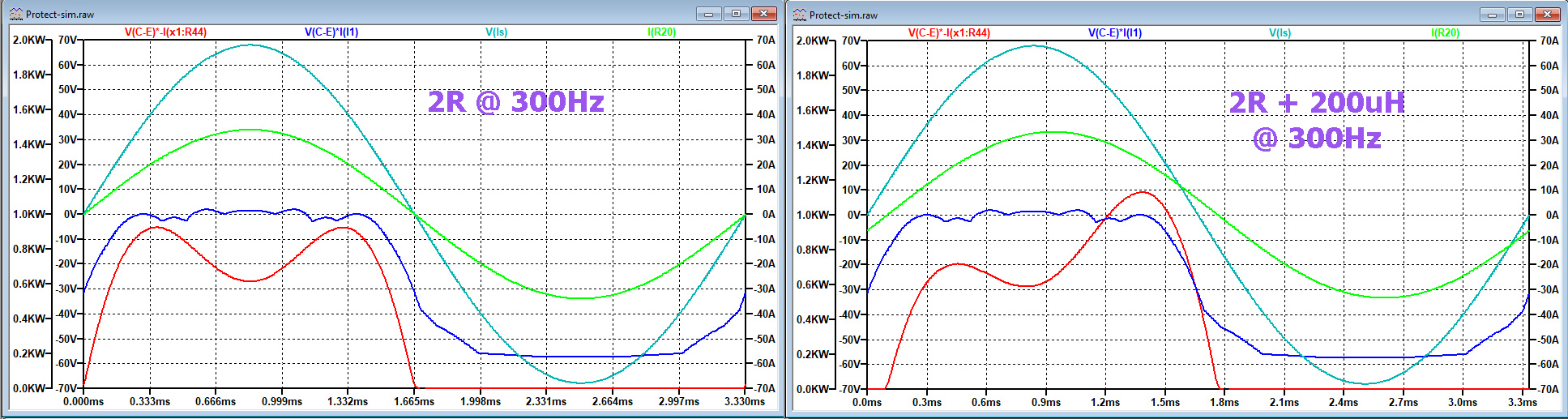

2R load:
As expected the situation with 2R becomes even worse, see 4th image.
With 2nH, the crowbar comes into action, restricting the current to 20Amp. However the red curve lays way above the allowed blue curve, so the amp will definitely die!!
With 200uH in series with 2R, the crowbar is not activated, but the red curve goes shortly beyond the blue line, probably still acceptable because of the short duration.

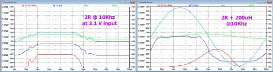

Going down to 300Hz results in the 5th image, where everything now seems fine.

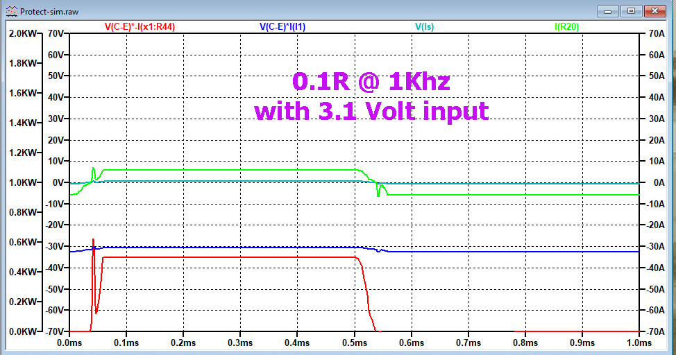

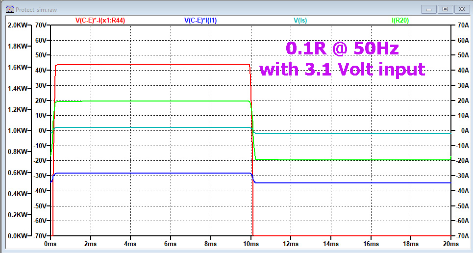

Shortened with 0.1R:
When short circuiting the amp, the resulting effect is visible in the 6th image below.
And although the crow bar has been triggered, it’s obvious that the red curve still lays way above the allowed blue curve and the amp will certainly go down.
So maybe I’m a bit too conservative in multiplying the individual SOA by 4 with six power transistors, but even then the discrepancy between consumed and allowed power consumption would be rather exceeded.

8R load:
4R load:

2R load:

Mark Levinson (ML23.5) OPS correction, part three

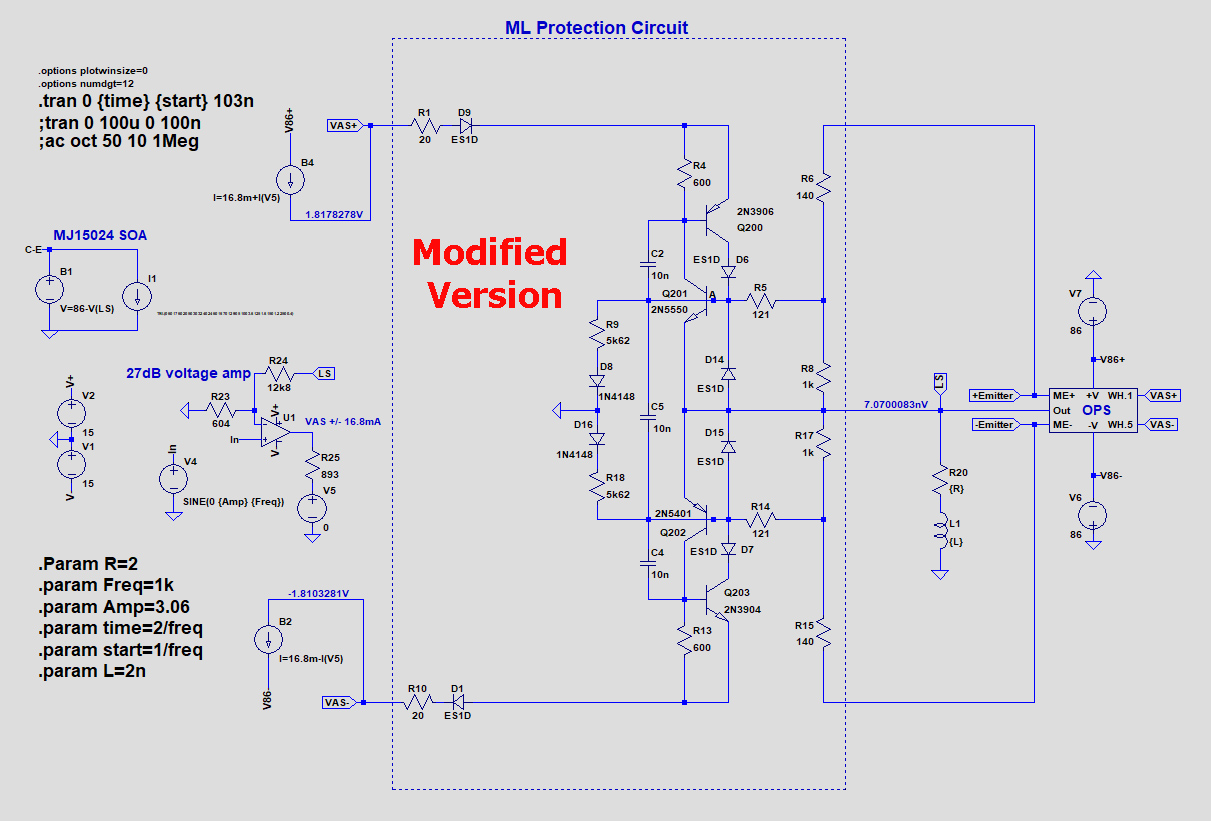

Armed with the above results, the next step was trying to find possible ways of improving the protection circuit’s effectiveness.
When shortening the amp, the crow bar limits the current to 20 Amps which is way too much.
This current is caused by 20R + the six diodes in series with the crowbar. The crowbar is constructed with two transistors, acting as a thyristor.
The activated “thyristor” in series with these 6 diodes + 20R measures when activated a total voltage drop of 4.75 Volt between VAS and Emitter.
This results independently from the LS load in 20 Amp through the OPS of which 20A*0.22R/6= 0.73 Volt is taken by the six 0.22R emitter resistors and the 20A*0.1R= 2 Volt by the following 0.1 R resistor.
So it’s quite easy to bring this down to within SOA levels by taking out 4 of the six diodes. This results in a current limit of 6A, now well within the SOA.
That was easy to achieve, but what effect does this have on the other properties ?
I won’t go into details, but also changing the trigger point to a lower level, made the 470uF + 33.2R obsolete, and restricting the distortion of signals at higher frequencies could be cured by reducing the 10K thyristor trigger resistor to 600R.
Circuit with all the changes is now in the first figure below together with the original version to compare as the second image.
Doing all the same test as before with the original circuit, results in the rest of the images.

4R load:
At 10Khz, performance is now completely unaffected by the crowbar, leaving the signal perfectly intact, where before a strong distortion was noticeable.
With 200uH, the consumed power is still shortly beyond the SOA as before, see the third image.
One might think that 200uF is a bit over the top, but with 70uH the exceedance over the SOA line is even larger and only below 30uH is everything within boundaries, see image no. 4.
With the available protection circuit, it was not possible to restrict this without hurting other areas, but hopefully it won’t result in a problem because duration of this anomaly is a very short 10 usec and with lower frequencies it rapidly comes within safe area.
And as from 1 Khz and below all power curves with 200uH are well within the SOA.
2R Load:
As before, with a pure resistive load, at 10Khz the crowbar comes into action but while limiting the current now to 6A instead of the previous 20A, everything seems well under control to prevent any damage.
With 200uH, because of the lower current drawn, results in a perfect signal reproduction, see image no.5.
At this 10Khz, output signal has to be reduced from 49 Vrms to 30 Vrms to prevent the crowbar coming into action.
However as from 3.5 Khz and below, full power can be applied.
With 300Hz without and with 200uH, everything is within safe margins, see image 6.
0.1R Load:
Crowbar is triggered but unlike before, power consumption is now perfectly under the SOA . Image 7.

Hans
8R Load:
This version works just perfectly safe as before and won’t be shown again.
4R load:
2R Load:
0.1R Load:

The SOA graph shown in part one applies for a temp of 200 C max, so there is probably some margin available for shortly exceeding the SOA at 10Khz.

4R load:
2R Load:
0.1R Load:

The current limit depends on the voltage on the OPS, thereby following the manufacturers SOA (Safe Operating Area)
With zero volt at the output, there is 86Volt on the OPS transistors and only 6 Amps are allowed, generating 6A x 86V= 516Watt in your OPS while supplying 6A x zero Ohm = zero watt to the load !
See the first image below where the red line, the real consumed power, does not exceed the blue line which is the maximum allowable power according to the SOA with a current limited to 6 Amp.
The higher the output voltage, the lower the voltage on your OPS and the higher the current limit becomes.
With 600Watt into a 2R load, current is 17.3Amp rms or 24.5Amp peak at 49Volt peak.
At that moment the voltage on the OPS is much lower at 86-49=37Volt.
Now look at the second image below that is for 800Watt into 2R and you will see that even 35Amps current (green line) will be supplied without any problem.
Again the red line never exceeds the blue line, so everything is well under control.
So the specified figures by ML of 200Watt into 8R up to 800Watt into 2R are fully supported by the output protection as shown in all the supplied images in the previous postings..
But added to that is now a short circuit protection that is within the SOA and the prevention of signal distortion at high level high frequencies that happens with the ML protection.
And to your last question: yes the amp only switches off 1) when getting overheated OR 2) when DC offset more than +/-0.6Volt is detected at the LS output.
Hans
