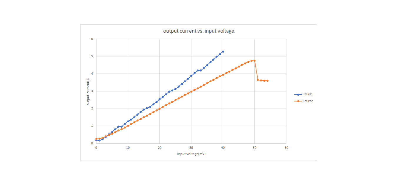

Hello Hans,
I made the multimeter measurement. I added 800Hz sine signal to the input of the amp and measured with multimeter with 10A range at the speaker terminals. When there was 20mV at the input and 2.5A at the multimeter I stopped because I think the transformer started to hum and I did not want to continue. Am I right that when multimeter is measuring 2.5A, my amp is consuming 2,5A X 86V = 215W? Is it normal that in such high power levels the transformer starts to hum?
The situation got much better when I shorted the xlr input pins 1 and 3. Then I could go higher levels without huge hum. Attached is my measurement. First by accident I used square wave signal(blue curve). I could go up to 5.3A when the heat became too high and the amp turned itself off. After cooling I used sine wave(red curve) and I could go up to 4.7A when the protection circuit came into play and reduced the current to around 3.6A. 4.7A is slightly lower than your 6A simulation.
Br,
Hannu
Br,
Hannu

Hi Hannu,
Yes, 2.5A on the meter is 215Watt under the condition that your meter measures RMS and that your meter is still accurate at 800Hz.
And no, it is absolutely not normal that your transformer starts humming at that power level, so I'm a bit suspicious to what was really happening.
Without a scope it will be hard to know what is going on.
Hans
Thx for the measurement.The situation got much better when I shorted the xlr input pins 1 and 3. Then I could go higher levels without huge hum. Attached is my measurement. First by accident I used square wave signal(blue curve). I could go up to 5.3A when the heat became too high and the amp turned itself off. After cooling I used sine wave(red curve) and I could go up to 4.7A when the protection circuit came into play and reduced the current to around 3.6A. 4.7A is slightly lower than your 6A simulation.
Br,
Hannu
I don't understand why shortening pin 1 to 3 improves things.
That points in the direction of some oscillation taking place with pin 3 open, which would explain the humming of your transformer.
So what you measured was obviously just a fraction of what really happened.
But nevertheless, there is nothing wrong with shorting pin 3 to gnd.
Looking at your graph, the first time you tried, you could not only achieve a higher current as the second attempt, but also under a different slope and that's very weird.
Slope should be exactly the same in both cases.
That brings me back to the question: how accurate is your multimeter at 800Hz and what is measured, RMS or average value.
The other question is the value of the internal resistance.
The slope of your orange line suggests 50mV*Gain/4.8Amp = 0,05*21.3/4.8 =0,22R, so lets say 0.2R and not 100mV/10A=0,01R that was expected.
That corresponds quite well with your measurement, assuming your meter measures rms, because 4.8A rms corresponds to 4.8*sqrt(2)=6.8A peak.
Hans

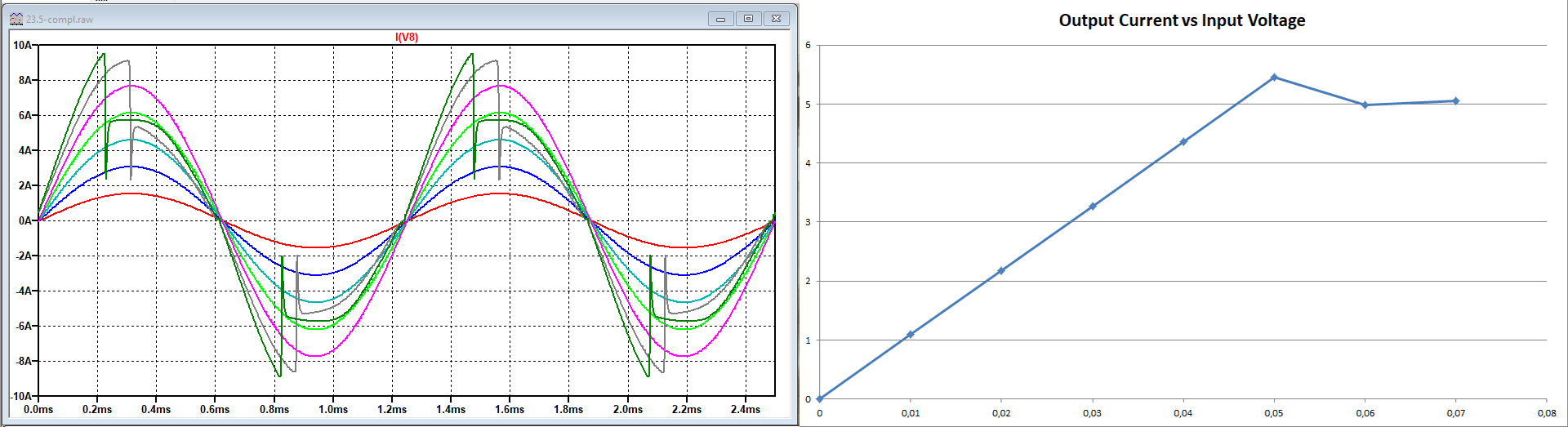

Hannu,
I have repeated your measurements in my sim model assuming a 0.2R multi-meters resistance.
Simulated are 7 amplitude steps at 800Hz from 10mVrms to 70mVrms input voltage.
The left part of the image below showing the output current for these resp. 7 steps.
As can be seen, from 60mVrms and higher the current limiter comes into action.
In the right part of the image, the rms current is shown as a function of the rms input voltage.
This is what you have supposedly measured and have shown in your graph.

Nice to see that the simulations and measurements are matching almost. That current waveform really shows how fast the protection circuit comes to play. I am wondering what happens in higher frequencies? Can the protection circuit drop the current as fast as here if the frequency is like 10kHz?
How about in real life if listening music, which frequencies will hit to the protection circuit first? I have understood that low frequencies require more power in delivering music. I know it is not very obvious when listening to music because these levels are so high but just curious...
Down to 2R load, protection will never come into action at any audio frequency while playing music, which is a big improvement over the original version.How about in real life if listening music, which frequencies will hit to the protection circuit first? I have understood that low frequencies require more power in delivering music. I know it is not very obvious when listening to music because these levels are so high but just curious...
Hans
Ok. There the current does not drop immediately when hitting to the protection like at low frequency but stays at the same level the whole positive (or negative ) side. Different behavior.
Yes it does behave the same, see the short spike at the left.
Current goes up, gets interrupted by the protection and goes down.
It goes up again to a stable level when input voltage rises to 3.1V.
The difference with the 800Hz image is that the used input voltage went up to only 70mV.
Hans
