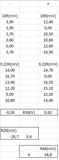

So before jumping to conclusions, could you specify the following voltages.
1) NPN: All six individual voltage drops on the 10R base resistors plus the corresponding voltage drop on their 0.22R emitter resistors.
2) PNP: All five individual voltage drops on the 10R base resistors plus the corresponding voltage drop on their 0.22R emitter resistors.
3) The absolute voltages on both sides of R44 and R20
4) The absolute voltage on both sides of R50
Hans

Thx for measuring all these data.
I'm still puzzled by the base resistor voltages that were yesterday resp 3mV and 7mV, and are now more like 4mV and 11mV, so I do suspect that touching these resistors induces some unwanted effects. To be sure you could connect a Scope to the LS output and see what happens while measuring.
It makes sense anyway to look with a scope how the LS output signal looks like.
But the emitter voltages are roughly o.k.
Adding the current from the positive side results in 346mA instead of the 270mA in R44, but this must could have to with tolerance in the 0.22R resistors, but ... ?
Seemingly the PNP's have very much higher Hfe as the NPN's, 159 versus 61, but I'm still skeptical because this 159 is almost unprecedented.
But the question is, suppose it is true, does it matter ?
In some way this asymmetry is not ideal, but will most likely not result in any noticeable effect.
Hans
