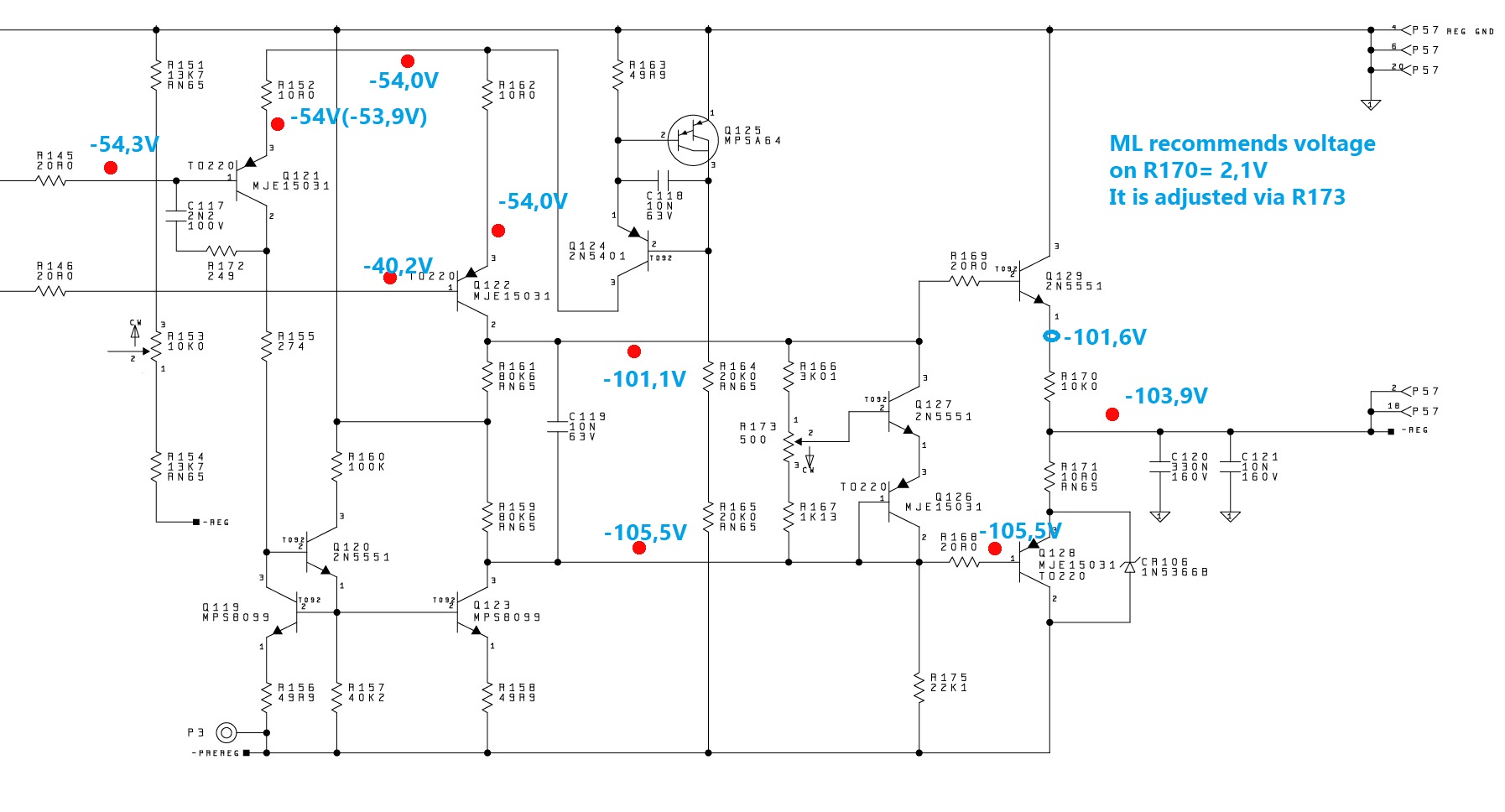

So I agree with Mooly that ik makes sense to measure the voltage on both sides of R147 with reference to gnd, while you turn the pot R153 to confirm that this voltage stays at a stable -60 Volt.
When that's O.K., concentrate on the right half, see image below what I mean with that.
Try to measure the voltages at the red dots.
When reporting this back, we will try to help you finding the problem.

Hi Hans,So I agree with Mooly that ik makes sense to measure the voltage on both sides of R147 with reference to gnd, while you turn the pot R153 to confirm that this voltage stays at a stable -60 Volt.
the voltage on both ends of R147 is not stable.
It goes at max. 61V (i guess the reference voltage from zener).
It goes lower as i turn the R153.
When i have the max. -Vreg (~103,8V) the voltage on R147 (both ends) is -57,7V.
It decreases when i turn the R153 in one way, it does not increase over -61V when i turn the R153 on the other way.
Attached the diagram with the voltages. pls notice that the amplifier was cold (just start up). after a while voltages changed.
Theo

Lets go back to absolute basics... please measure these points and record what you actually have. The resistors are all low value and you can measure on either end.
1/ You have -60v applied to the base of Q115. This is the reference voltage. You can measure this on R141.
2/ When you set the output to its maximum (lets say -103 volt) what voltage do you have on R147? This is the base of Q116.
The two voltages should be equal when operating normally (no matter what the voltage is set to) but lets see what you actually have.
3/ What is the voltage on R145?
4/ What is the voltage on R146?
These should be similar as well.
So (references to gnd, and the amplifier is a bit warmer than before):
R141: -61,2V
R147: -60,1V
R145: -53,5V
R146: -39,5V
Theo
The voltage on R145 and R146 should be driving the regulated output more negative and that isn't happening.
We need to work with the above and follow through what is (not) happening...
If Q121 were open circuit it would do this.
If Q122 were very leaky it would also give the symptom you have.
Careful Base/Emitter volt drops can be revealing but I know you are not keen on that 🙂
You could swap the transistors around and see if your changes.

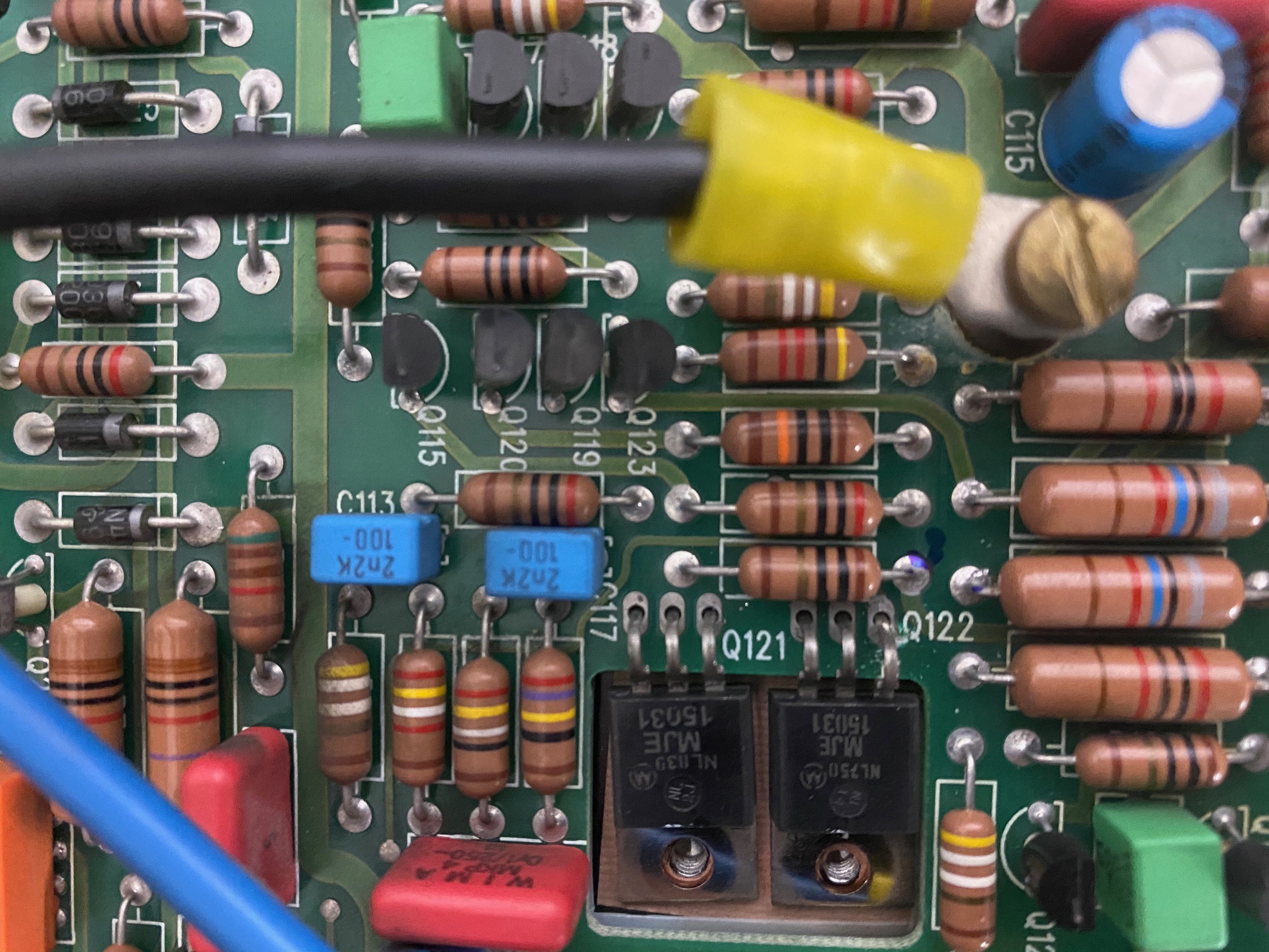

WTF, UNBELIEVABLE....
i just saw that these transistor are not soldered!!!!!
Just strapped underneath!😱
I had seen that hey are not soldered on the upper tabs (like all other components), but i thought they were soldered on the bottom tabs. Since the holes are plated through there should be no problem....!!!!!

O.K., From your measurements it's obviously a problem with Q122.
Success in soldering, hoping that they are still all right.
