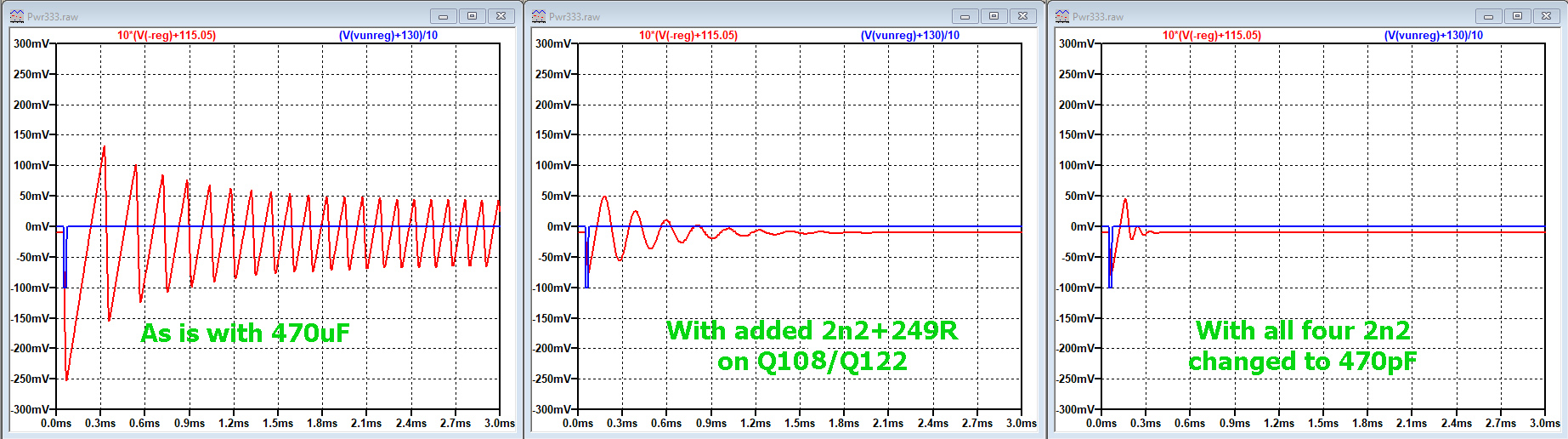

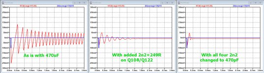

Hi Thebet,
I've put your supply in LTSpice, hoping that you can use this.
In the first image below, I have shown the power supply rejection ratio, assuming that on your Amp board there is still a 330uF connected to Vreg.
Looking at the graph, I'm not really impressed by this PSRR.
When removing C113, it becomes already a lot better, see second image.
Anyhow, you can use the Sim file and compare all the voltages in your Amp.
Hans

I have another problem with this circuit diagram.
When I attach the 330n at the output, the regulator starts oscillating with an amplitude of 7 volt pk-pk.
When adding the 470uF that you use, oscillation goes on but now with 20mV pk-pk.
This is something to look at when everything is O.K. again.
But for now, do you have a scope to check whether Vreg- is oscillating ?
Hans
Thebe,
A bit surprised by the oscillation problem, I found the perfect solution just in case you experience the same symptoms.
Q108 and Q121 have a 2n2+249R network from base to collector.
When adding this same 2n2+249R network to Q109 and Q122, also from base to collector, the system becomes unconditional stable, as well with the 330nF alone and also with the added 470uF.
Hans

Thebe,
Just to inform you what a simulation with LTSpice tells, here 3 images of the voltage on the Vreg holding your 470uF, when a 1 Volt spike is induced on Vprereg through the mains, an absolute every day's thing to happen.
Don't feel forced to change anything, it is just to give you some insight in things.
1) The first graph shows that a voltage spike excites the regulator into a permanent oscillation
The voltage is magnified in the image by a factor 10, so the oscillation signal has a real amplitude of 10mV pk-pk.
2) In the next graph a second network of 2n2+249R has been placed over Q108 and Q122.
The excited response now dies after ca 2msec and has a much friendlier frequency content without the earlier sharp edges.
The system is now unconditional stable.
3) Now in the third graph all four 2n2 caps have been replaced by 470pF caps, resulting in an even faster recovery from the generated voltage spike in Vprereg.
Hans
Hans
