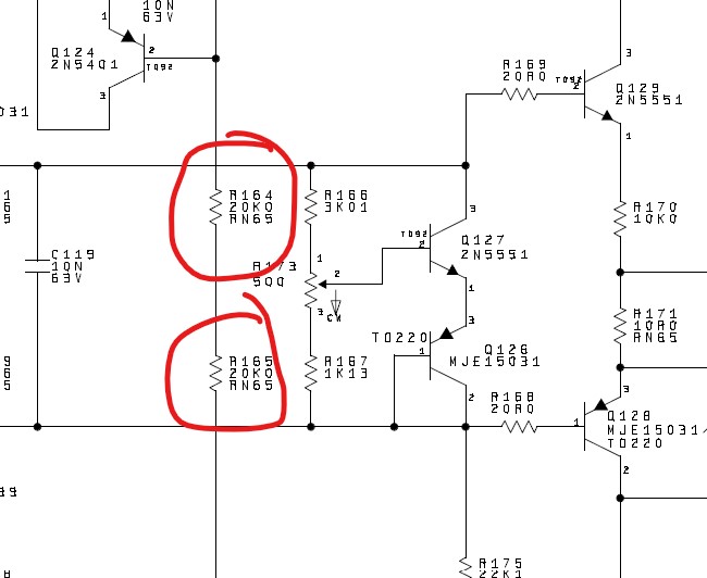

First step is to check out of circuit that R164 and R165 are good. You must do this first.
The reasoning is that if one of these is open then you will get exactly the fault you are experiencing.
The -53 and - 39 volts you see on R145 and R146 would also occur under this condition because the B-E junction of Q122 would be reverse biased and so act more like a Zener of around 6 to 8 volts at a guess.
It all fits your fault so lets check those resistors.
Hi Mooly,
i checked the resistors, they are OK.
R164=20K
R165=19,92K
I also checked the other two 'big' resistors:
R159=80K
R161=80,6K
But these two changing during the time. They are not stable. Could be a problem?

They had to be checked to be sure
No resistor should change at all as you measure it but the measurement must be out of circuit and you must have a good and stable connection to the resistor leads. Those two are an oddity and I can't see what they do tbh.
Lets look at this next...
Check that Q124 and Q125 are OK. There should be approx 1.1 to 1.2 volts across R163. These two transistors form a current source and if the current is low then you would get to little output volts.
Also check that C118, the 10n across the B-E of Q124 is OK and not leaky.

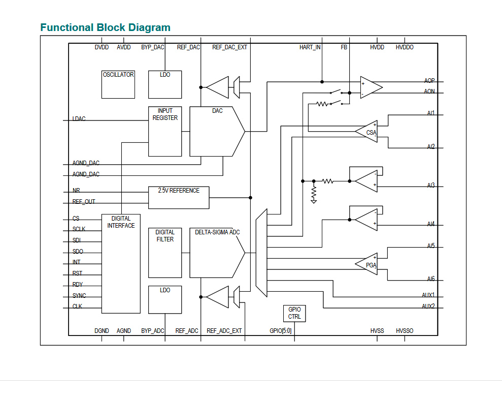

Theodore,
Your amplifier is software controlled, see image below.
All the (many) relays in your amp are driven by this device, controlling and sensing all vital functions.
First of all you should repair your power regulator, but if you are still having trouble with bias current, it is probably because this controller detects something that's out of range, or a relay that stopped working.
But chances are very great that everything is O.K. again after your power has been repaired.
Hans

Can you not measure to other parts that connect to the part of interest, at least to see if anything is greatly amiss?
A first check is just to see what the voltage across R163 is. It should around 1.1 volts as mentioned earlier. If that is OK then its a fair bet that the stage is OK (providing R163 is OK in value).
