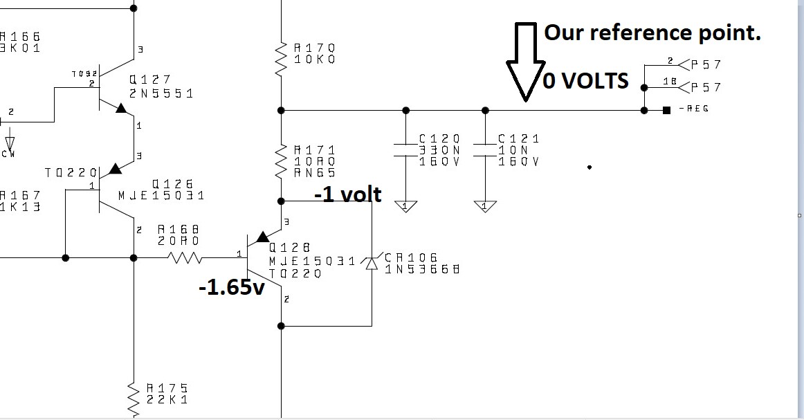

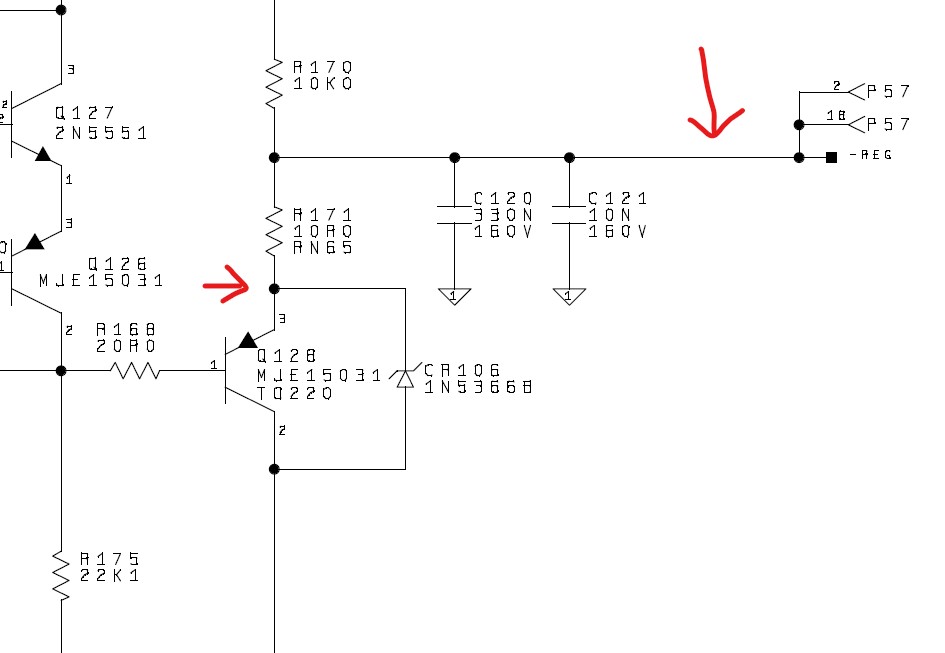

...so lets work back from the output this time.
Put your meter negative lead on the regulated output (the -104 volts) and measure the voltage on R171. Measure to the end that goes to the emitter of Q128.
What do you get?
Keeping the negative meter lead where it is now measure on to R168 to the end that goes to Q128 base.
What do you get?
Now measure to the other end of R168.
What do you get?

Negative lead on the output, then measure to the emitter.
Yes, this is it.
Actually you want the voltage on the R171's ends, right?
Yes, this is it.
Your meter negative goes on the output and stays there for now.
On one end of R171 you should see zero volts because it is the same point as the output.
On the other end you should see a low voltage that will depend on the current draw through the 10 ohm. It will be low.
The voltage on R168 (base of transistor) should be the same as R171 plus another 0.65 volts.

It looks correct to me - maybe a misunderstanding?
R171 (between ends): 1,06V
-Vreg to Q128 Base: 1,649V
R168 (between ends): 0,008V (in other words between Q128 Base and Q126 Collector.
Those three readings all look good at this point
so the Ve-b of Q128 is exactly 0,589V
(don't forget that i have changed the Q126,Q128 couple days ago)
let's continue tomorrow.... i 'm also tired.... thx anyway
Yes, tomorrow
(Vbe should be in a range of around 550 to 750 millivolts depending on the transistor and how hard it is being turned on. Polarity depends whether it is NPN or PNP, PNP has the emitter more positive)

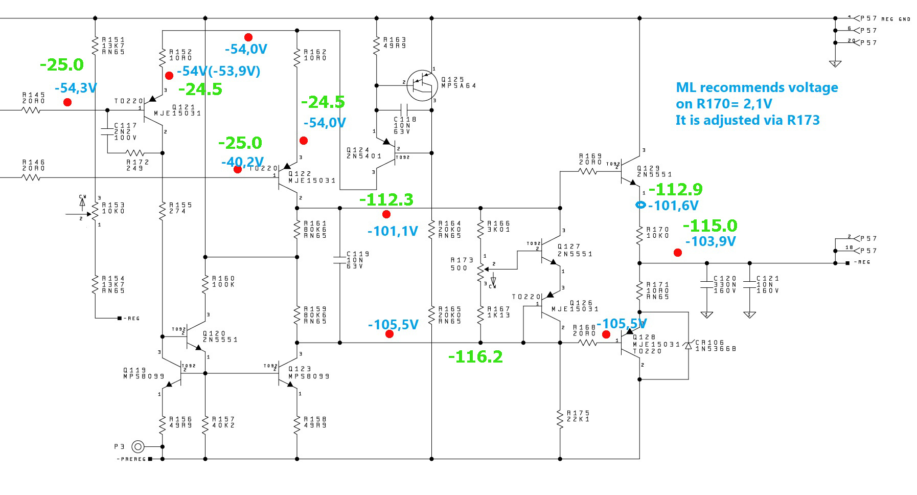

Hi Mooly,
Sorry to interfere and with all respect for your attempts to find the error, I have the following remark.
Current source Q124/Q125 should supply 21mA of current to be divided equally by the current mirror Q119/Q123 below the Q121/Q122.
But instead of the 10.5mA x 49R9 = 550mV that should be measured in resp R156 and R158, Thebe only measured 80mV, a clear indication that this current that can't go anywhere else is not the 21mA it should be, but only something like 3mA.
That could also explain why the two bases of Q121 and Q122 have a much lower measured voltage value as expected.
See image below measured in blue by Thebe vs expected in green by LTSpice.
