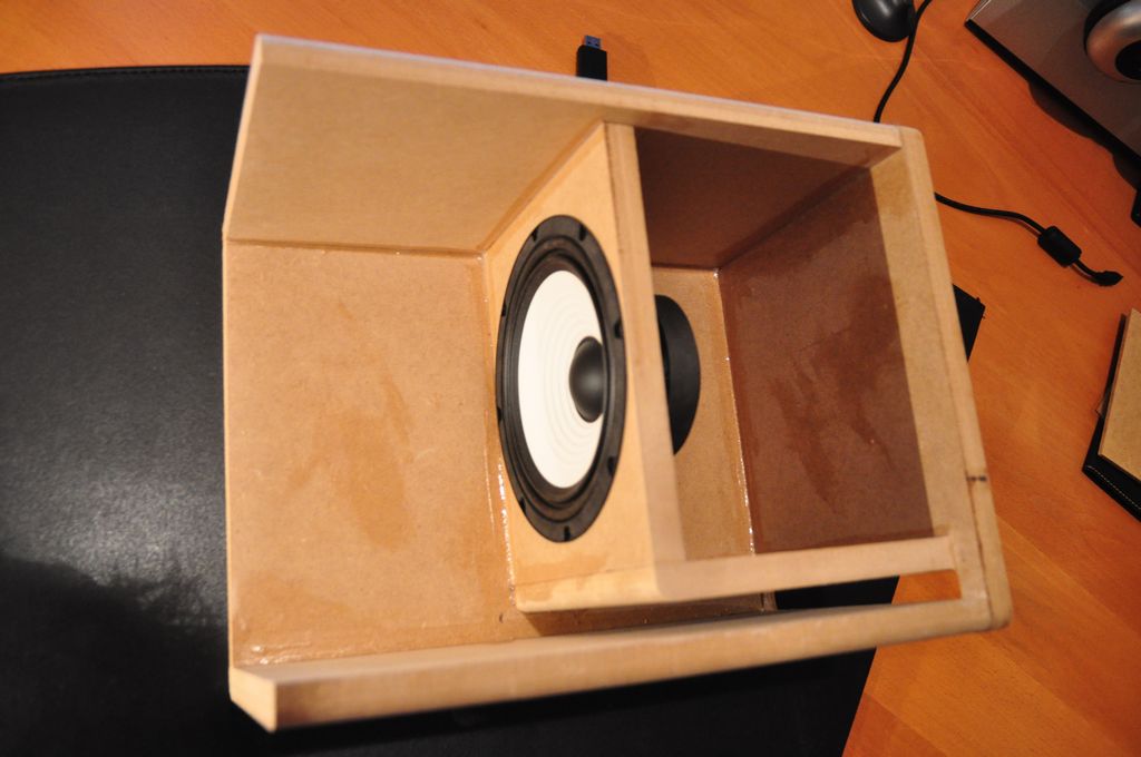

You can check out the mMarS at Planet10 website and the DBR by DIY forum member Hairbrained.
http://www.diyaudio.com/forums/plan...ictures-not-much-text.html?highlight=chr+pics
You will find Hairbrained plan's linked to Voldemar's DBR.
Lot of CHR-70 discussion under current thread - makes for interesting and educational reading.
BTW, I have 2 of my CHR-70s in Planet10 CHR-Ken boxes - maybe too large for desktop, but very good enclosures otherwise.
-Zia
p.s. Did you build a sub with EL166 / MA Woof #6?

Yes that was me. Not the best Sub but does his job well for a small bedroom.
I am thinking a couple of those for a medium sized rooms. What's the frequency response like? Why do you say not the best sub - can't go deep enough or play loud enough?

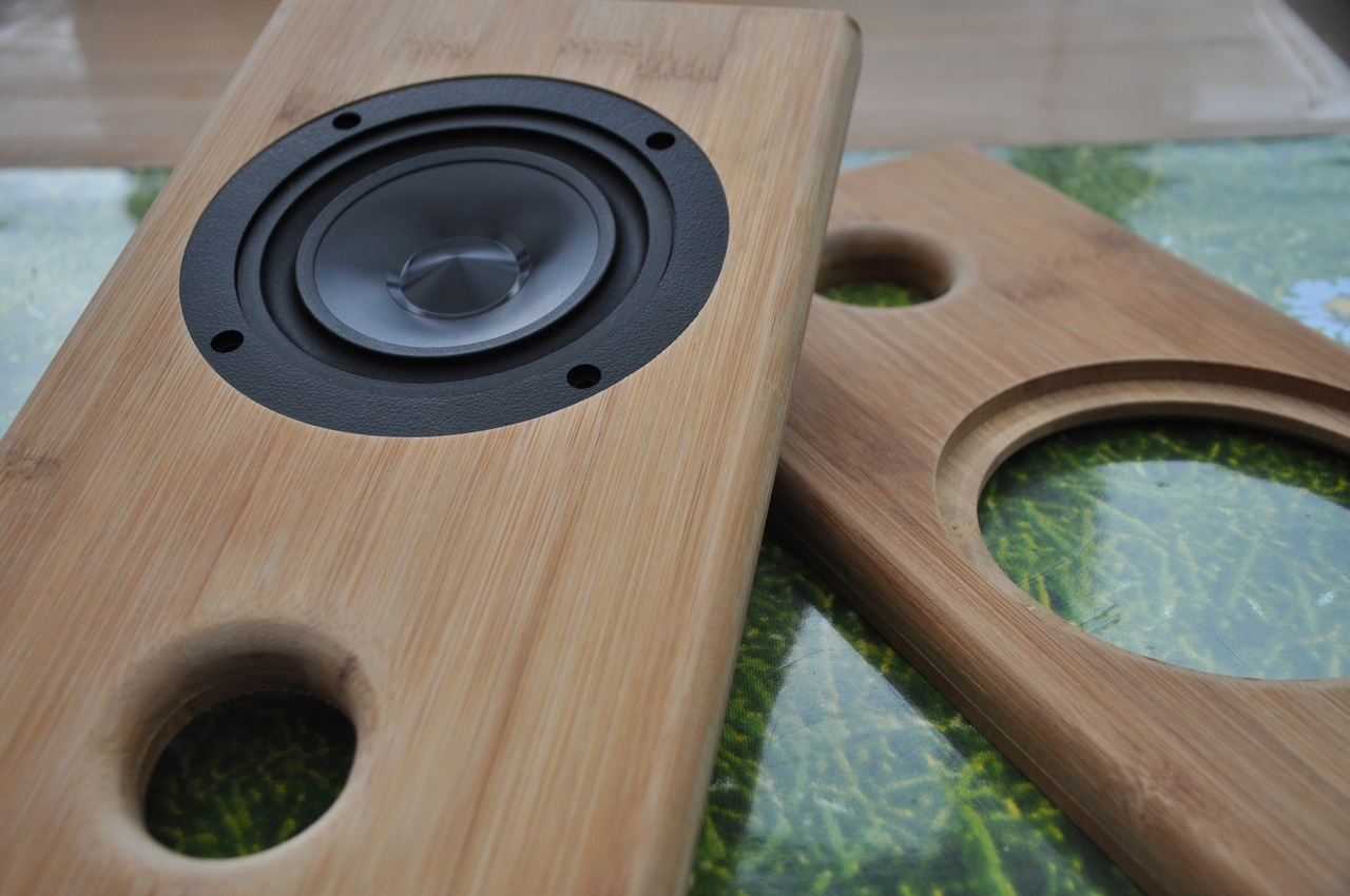

Wow, love the look of those bamboo baffles from here ... I'm pretty new to all of this but I don't think I've seen that used for cabinets before. Seems like they would be very rigid.
http://www.diyaudio.com/forums/plan...onken-fonken-picture-gallery.html#post2558496
http://www.diyaudio.com/forums/club...ver-island-diyfest-2011-a-23.html#post2680947 (2nd picture)
Normal bamboo ply (2nd picture) is very good, stranded bamboo ply (1st URL) is better. Solid bamboo is not as good.

there are various grades of the raw bamboo as well.
There are 3 variations of plywood, all 3-ply (if we stick to thickness common to speaker builds), all more suited than solid. You can get thicker material in 5 plys.
All have a block core, differention comes in the nature of the outer plys. long thin blocks glued together can be oriented horizontally or vertically (flat or edge grain) or long thin strands (strings) can be glued together in a matrix (stranded or fossilized). Stiffness increases from 1st to last, most bamboo speakers are the middle one, but the stranded is the "best"
Bamboo Plywood - Cali Bamboo plywood and veneer for kitchen countertops, cabinets, furniture, bars
This material is expensive (but prices have halved since our 1st build) because it is made by hand... imagine chinese workers, mostly women, hand placing each block & strip.
I think that, as wages rise, mechanization will be required to keep the prices sensible. I also think that the manufacture of the stranded structure could be automated, and that a plywood made with alternate orientations of the thin stranded layers could be even better. Also, there is no reason why the same tech couldn't be applied to other material that strands nicely (ie like hemp). Much of the tech needed was near fruition in the late 30s before the Nylon lobby orchestrated the illegalization of hemp.

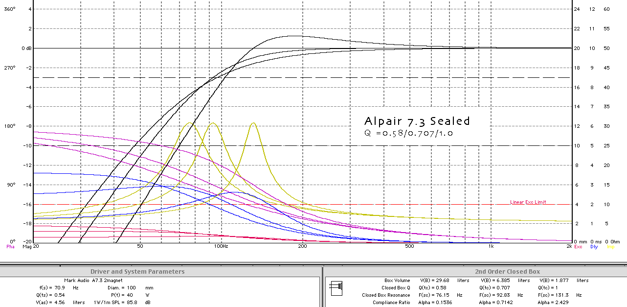

The curved cabinets are a whole lot better:
Dayton TWC-0.25MA 0.25 ft³ 2-Way Curved Cabinet Pair Maple 302-707
Here is a set of sealed sims -- looks like the cab sealed would give close to butterworg response, F3 in the low 90s, F10 in the low 50s.
If you feel a ventedbox might get you a bit more, i can suggest a vent.
dave
dave
Thanks Dave!
That was a pretty unequivocal push to the curved cab. OK, the curved cab it is.
In that same cab, how much lower can the F3 be with a vent? I might be tempted to stick with the sealed version as it's so hard to screw that up, but if a vented version goes way lower, then maybe that's what to do...

No reason (except budget) to chose CHR over A7.
Pretty much. A7.3 with thinner cone may not handle abuse as well -- but if you are goinf there EL70 is a better choice.
