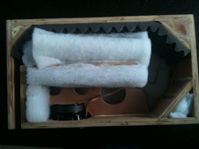

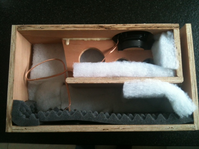

Folded halfTower ML-TL: 3 dB extra at 32-64 Hz
Hi all,
During Christmas, I made the Folded half Tower ML-TL (free design of planet10) for the CHR-70. I really like the sound.
As from drawing, see below (I made it unintended 3 cm less deep)
I was just curious, what would happen, if I added some extra deflectors inside. To my surprise, the bass get better, deeper and more solid. How it works, I do not know. Just to share.
Olaf
PS. is my first project, so I am still on the learning, any feedback, remarks is welcome

Well done! Perhaps Dave can comment on how those deflectors have had that effect. They definitely cut into the volume of the enclosure.
Kyle
Kyle
Built these prototypes, ~14 liters, tuned to ~47Hz with a 1"x1" port, F3 of 40 Hz.
Final versions will be out of bamboo plywood.
Would seem that the increased stuffing likely had the most effect, woudln't you say?
