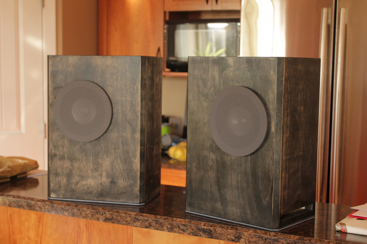

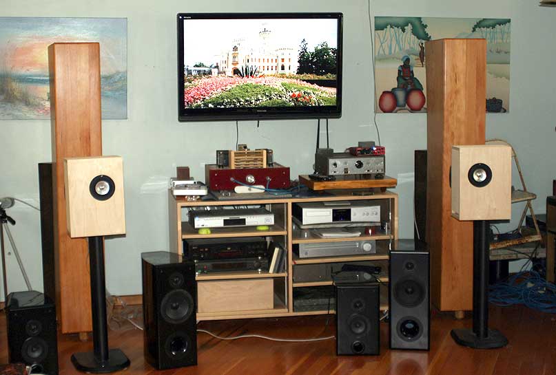

Here's before and after finishing photos of the CHR-Kens I built for my sister. The before pic is from DIYFest from this past year.
Kyle
It's speaker cloth stretched over some 1/4" bb plywood frames. I used spray glue for sticking them down and then brushed on silicone after trimming to keep the edges of the fabric from fraying. The back side of them looks far rougher than the front. They are held on with magnets sunk into the baffle.
Kyle
I cut them myself with my router and jasper jig. It was quite easy, and the fit was perfect. Getting the fabric stuck on the backside evenly is the hardest part. You just have to patiently work it into place. I'll see if I can find some construction pics later.
