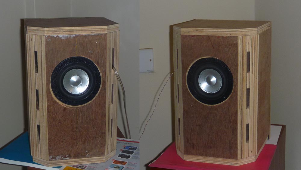

Well I thought I finally better get round to finishing my mMarS I built at the end of last year pictured below
I just got some nice Jarrah veneer to put on them.
I have a question about stuffing before I go and seal them all up. I bought some stuff called hobbyfill I'm pretty sure it is what you call polyfill and I tried them stuffed evenly with 0.75 lbs/ft^3. From listening between one stuffed and one not the stuffed one has better bass, is that how it is supposed to be? What density should I use and should I pack any part any denser.
James
James
looks fine as is 😀
i see a small dent on the left speaker. i actually experience this also to my alpair 5, although i didnt hear any difference between them.
jarrah have a very nice grain.
cheers
henry

If the midrange starts to close in, you have added too much. Adding damping increases the apparent box volume lowering the box Q. It will also flatten the resonance bump.
dave

There is actually two, some how I managed to slip while screwing the screws and stab the cone on two separate occasions, very annoying.
Yes I agree, I'll be sure to post pics here when I'm done
dave
Ok thanks Dave, I will do a some more experimenting with density. Should I stuff it evenly through the box?
That is usually sorta what happens most times.
i'd keep it a little lighter behind the driver, and maybe a bit denser in the centre of the box.
dave
