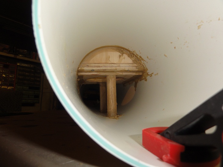

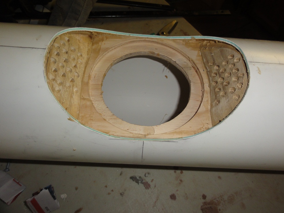

That was the only tricky bit since I didn't want the drivers protruding outside the pipe circumference.
As you can see from the photos, i used a ply mounting plate and HEAPS of liquid nails, the dowels hold the whole deal in place with more liquid nails.
I then shaped the outer surface with Plasti-Bond, a kind of fiberglass/bog stuff.
These are 1200mm long and have a random exit throat size, because I have no idea how to use MJK's worksheets yet and just like building things.
Speaking of which Dave + other!!!
http://www.diyaudio.com/forums/full-range/179311-atl.html#post2401567
Dean

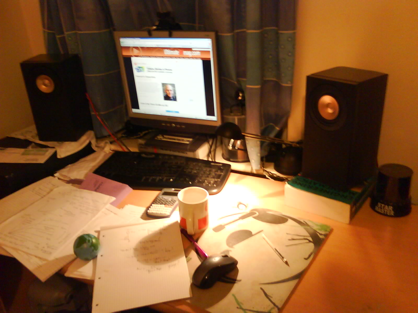

My clones of the black beauty design (page11) are finished apart from baffle step corection circuit which I am currently doing using EQ in software. I changed the external dimensions to 15x15x30cm with an 18mm baffle and 12mm sides. I also added an internal brace and plan on some changes to the baffle step circuit for my particularly close to wall situation.
I am very impresed by the frequancy range these speakers are capable of, bass exstension seems the same as my previous mission 760i's (about 80Hz). Imaging is superb especialy at close listening distances where two ways just wern't working corectly. They are also alot less 'boomy' than my previous speakers I presume due to the low group delay over the pass band compared with a ported design. Anyway I will do some actual mesurments at a latter date. Max volume is limited before distortion but more than loud enough for bedroom usage.
Burn in time for the CHR-70 I found to be about 10hrs, sound was very harsh and lacking in bass slightly to start with but I left them running for a day and came back and all was well.
apologies for the poor picture quality I only have a mobile phone (poor student). Many thanks to Henkjan for showing the capacitor equalised undersized boxes work well with this driver!
