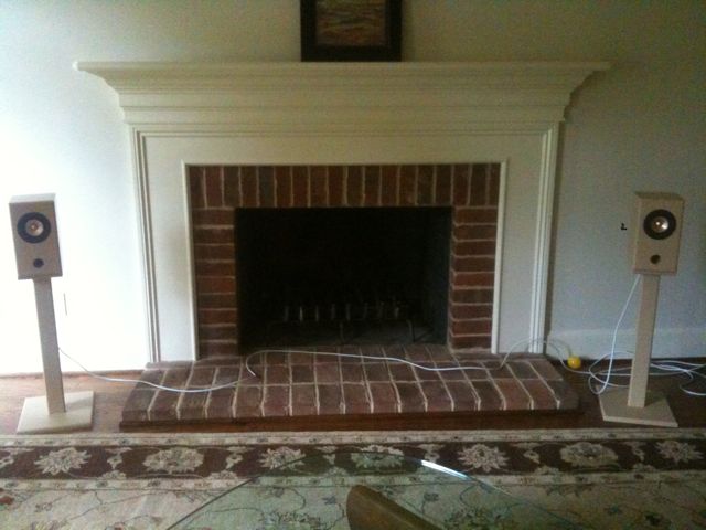

Location, location, location...
The CHR-Kens sound even better now... driver burn in? No, Plenty of hours on them already... rather a matter of placement.
Tried out 2 rooms, both larger than 260 sq ft. Speakers 6-8 feet apart, close to the back wall, toed in, listening position - 9-12 feet away from speakers. With tracks with good bass line, you can get easily fooled into thinking there are woofers or a sub somewhere. Bass is deep, has very good definition. Vocals are clear and as said before, plenty of details.
I found the amount and quality of bass from the CHR-Kens amazing. And they can play plenty loud even with 3.5 watts (same amp as Doorman)... with an amp with a heftier OPT I guess bass will have even greater authority.
All said and done these are monsters! 😀
If I want to be picky, I can only mention that at 8-9 feet distance they are still slightly bright for me with some of the female vocals... will it be possible to attenuate that with a circuit?

Did you try a zobel yet. The impedance rise plus the highish output impedance of your amp could be boosting the HF. A zobel would flatten the impedance and subsequently flatten the amps output.

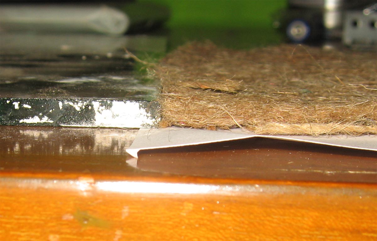

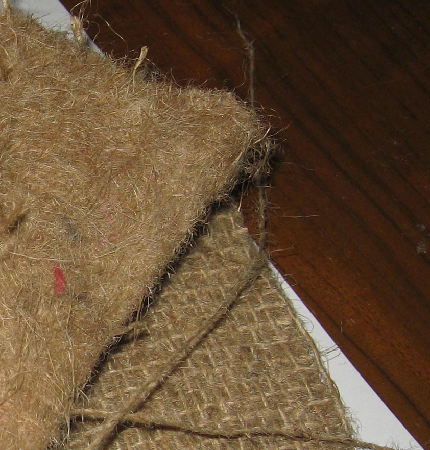

Going local, going green
After some good deal of looking around got hold of this locally made jute-felt carpet underlay. Looks like the thickness is ~5mm (placed it beside a 5mm thickness glass sheet and took the pic). It has some backing underneath pic 2).
Would 2-3 layers (with or without the backing) of this work for lining vs 1/2" of wool felt or fiberglass lining?
-Zia

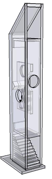

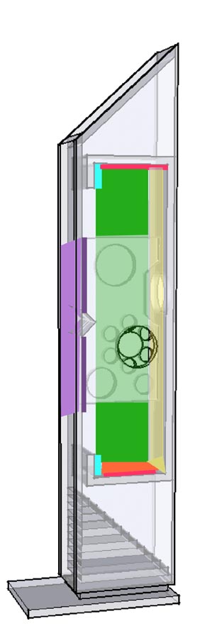

Lotus MBVR - single and dual driver designs
Dave,
Would I be able to get away with this design using one driver? 😉It's more stylish than the square top.
I am worried that the TV console might end up being too close to inward firing side drivers. Positioning the speakers for outward firing is an option though...
-Zia

Looks fine to me. You can do opposite walls with thickish damping or all the walls with something thinner
