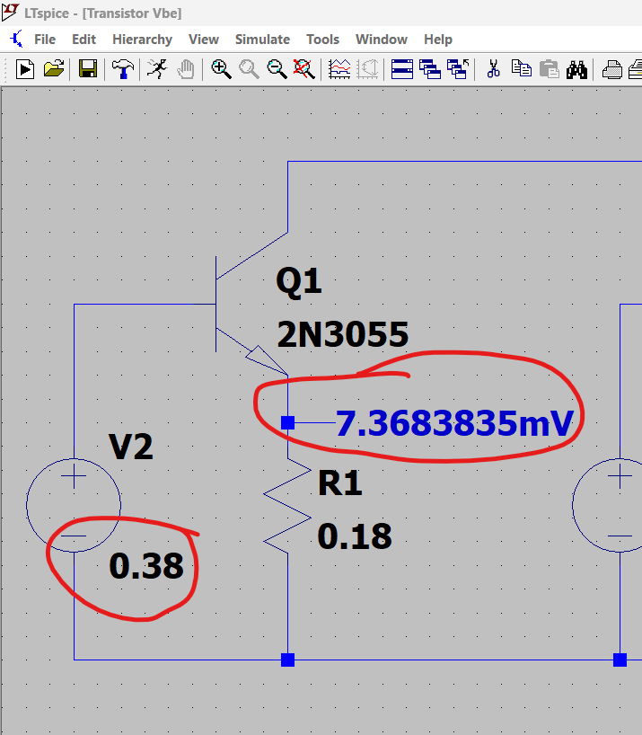

Wow 😯 just a slight increase by so little voltage and the result is 35% more current?Your welcome 🙂 I'll just add this to show you how the current can alter with a seemingly miniscule change in applied base voltage. So we can't use vbe as a means of adjusting anything and yet it remains one of the most useful measurements in fault finding.
If we increase the base voltage by just 0.01 volts we see an increase of 35% in the current in the 0.18 ohm resistor.

I assume that when the vbe value is close to "turning on" the transistor and after this is what i should expect right? Minor changes in voltages great current increases. Wow
Amazing information. Thank you very much!!
Yes, it is not linear at all. Also remember that ultimately transistors like these are all 'current driven' and not voltage driven. The base/emitter voltage is something that occurs as you pass current through the b/e junction. The voltage will also level out at around (I know that's imprecise) at somewhere around 0.7 to 0.8 volts as you push more and more current through the junction.I assume that when the vbe value is close to "turning on" the transistor and after this is what i should expect right? Minor changes in voltages great current increases. Wow

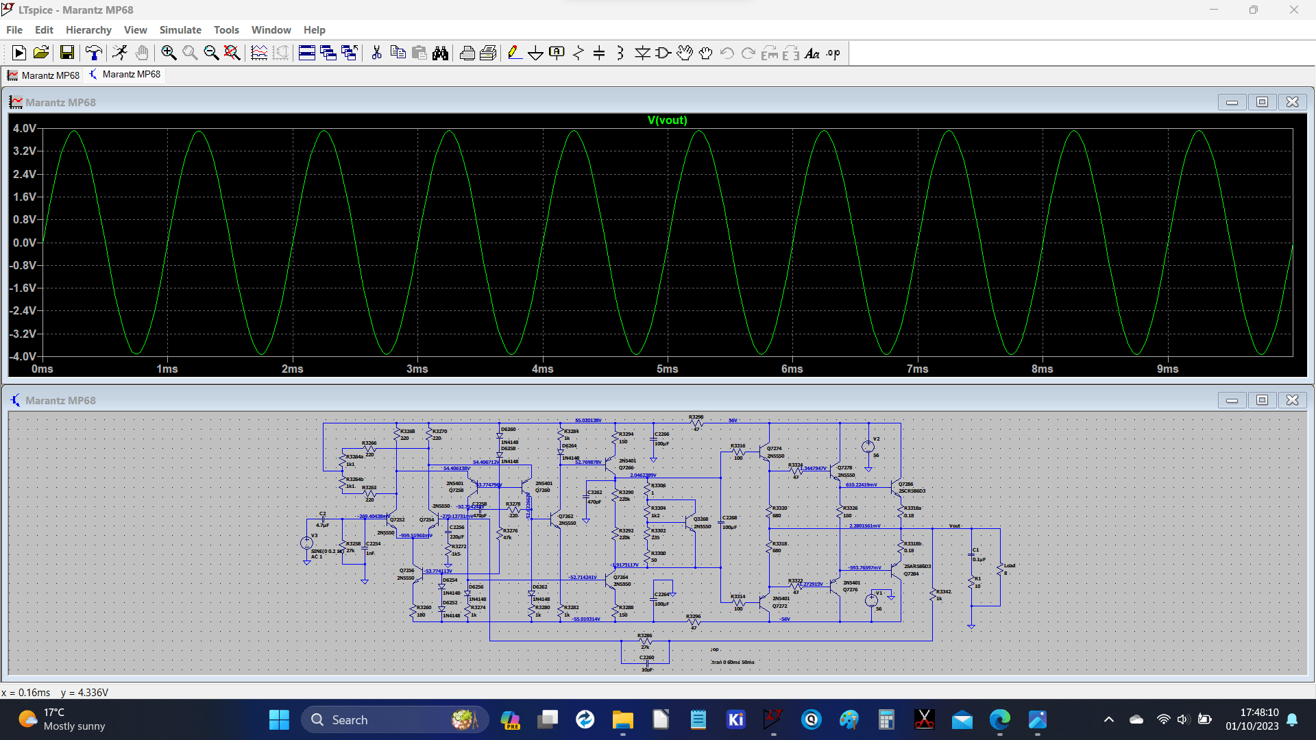

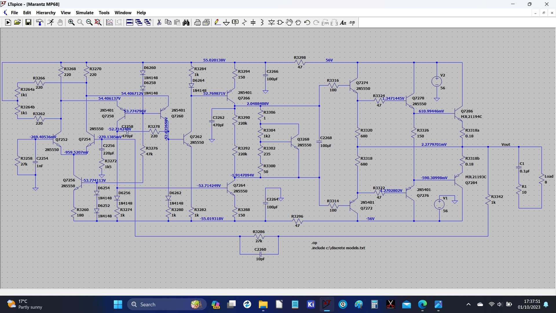

Here is your Marantz as a working simulation. DC conditions (for the sim) as shown with bias set to 40ma and offset close to zero. Haven't tried it yet with a signal....
I'll post the file later and if you are interested enough to install LTspice you can click and run it and play around altering things.
This thread will give you lots of info on LTspice but the file as it stands should click and run with nothing else needed.

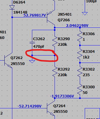

Just spotted a little error in the sim. Missed a link.I can't really see the purpose of the 220k's tbh, not when they are shunted by all those others..

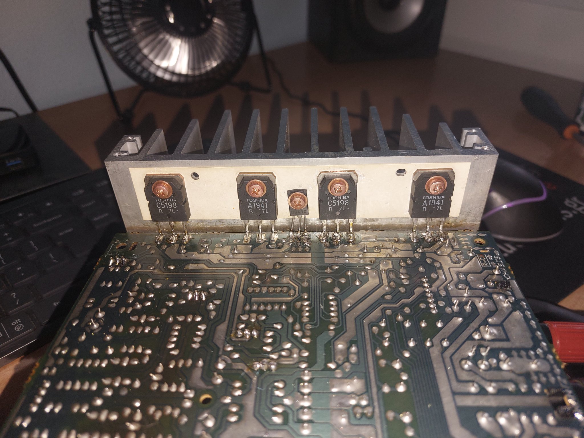

I have not seen a pic of the mounting for the output devices, might be room to fit the to-264 or toshiba to-3pbl, if they are available. Hifiengine login is broken for me too
I haven’t gone through the sim, lots of 2n5550/5400 even as drivers 🙂

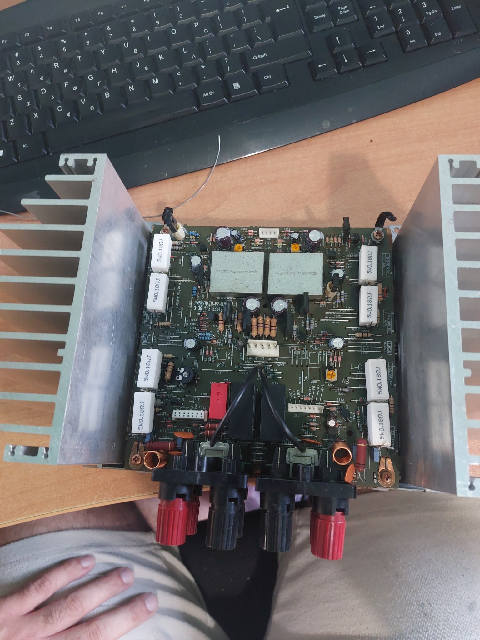

Here is the picture of the amplifier board and the mounting of the output transistors:I have not seen a pic of the mounting for the output devices, might be room to fit the to-264 or toshiba to-3pbl, if they are available. Hifiengine login is broken for me too
You need TO264 case style.

Looks like enough room for a to-264, you can measure and confirm. Distance between mounting screw and top of the pcb
How about a pic of the other side too 🙂

Pretty much anything will work in practice 😉 the 5550 and 5401 are great default and they never blow up (in a sim) even at several kW dissipation.I haven’t gone through the sim, lots of 2n5550/5400 even as drivers

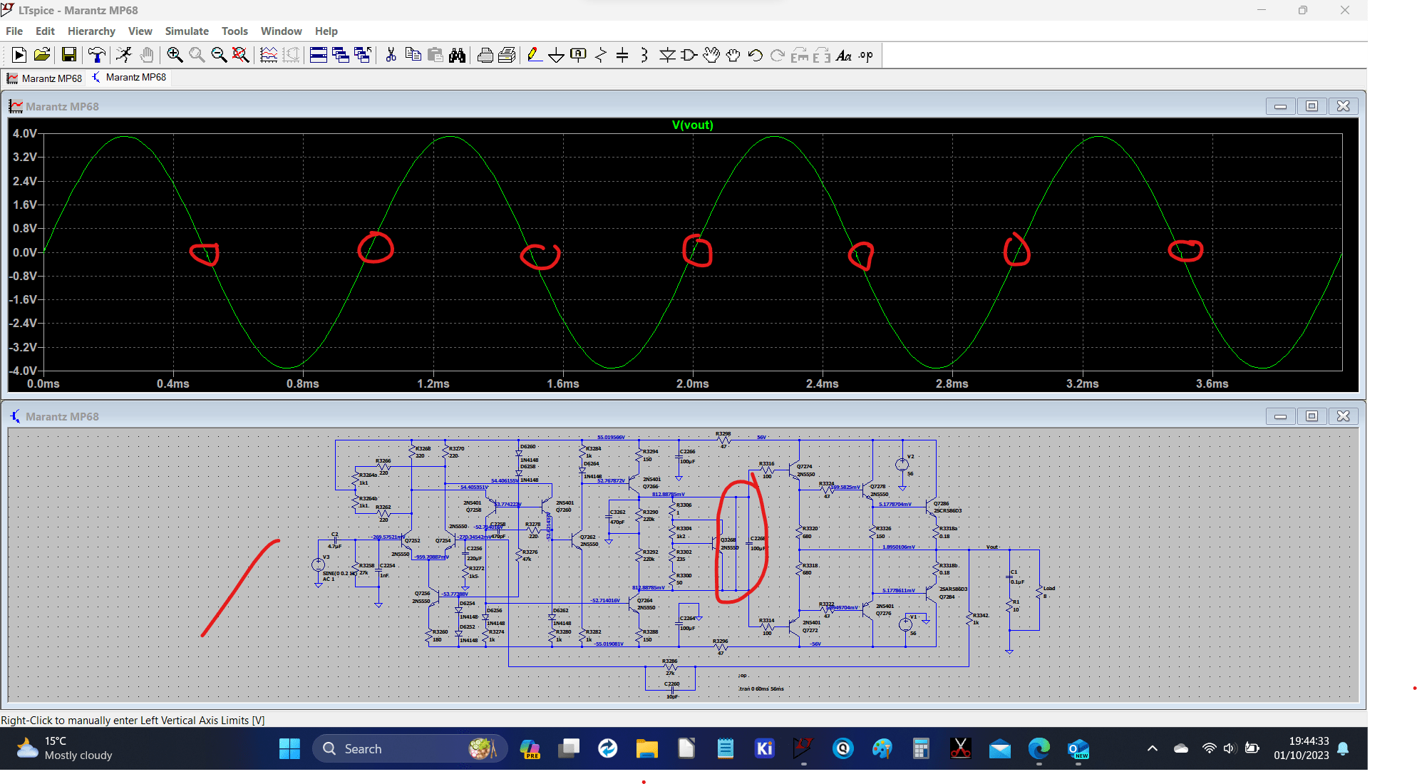

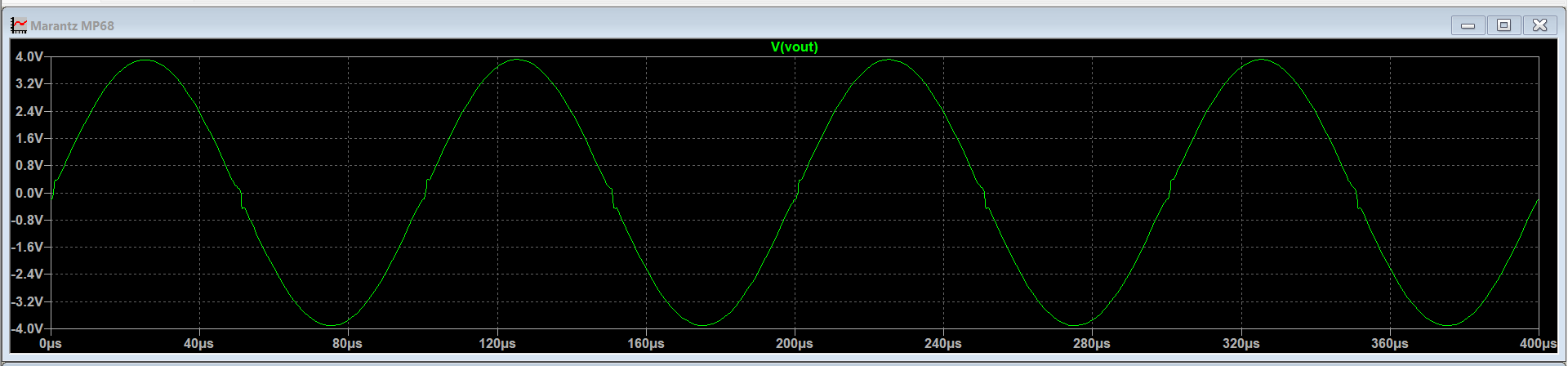

You mentioned crossover distortion earlier. Here is the amp with zero bias at 1kHz and then 10kHz. The distortion is just visible in the first image but obvious at the higher frequency.

Here it is at it's current state:Looks like enough room for a to-264, you can measure and confirm. Distance between mounting screw and top of the pcb
