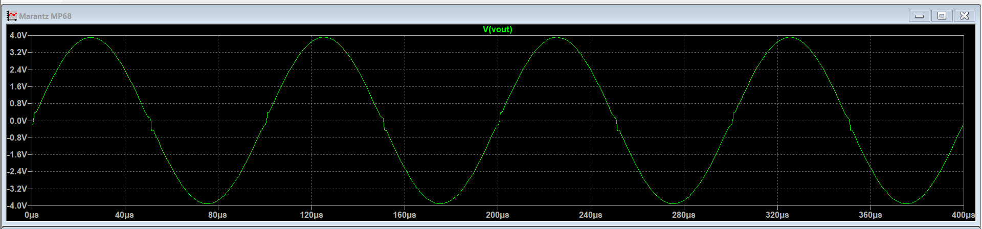

I saw something close to the first picture. But i will go up to 10khz ir even 18-20khz and see it in action. I think i will be able to reproduce this result you show here woth zero bias.Pretty much anything will work in practice the 5550 and 5401 are great default and they never blow up (in a sim) even at several kW dissipation.
@alexpriftis85

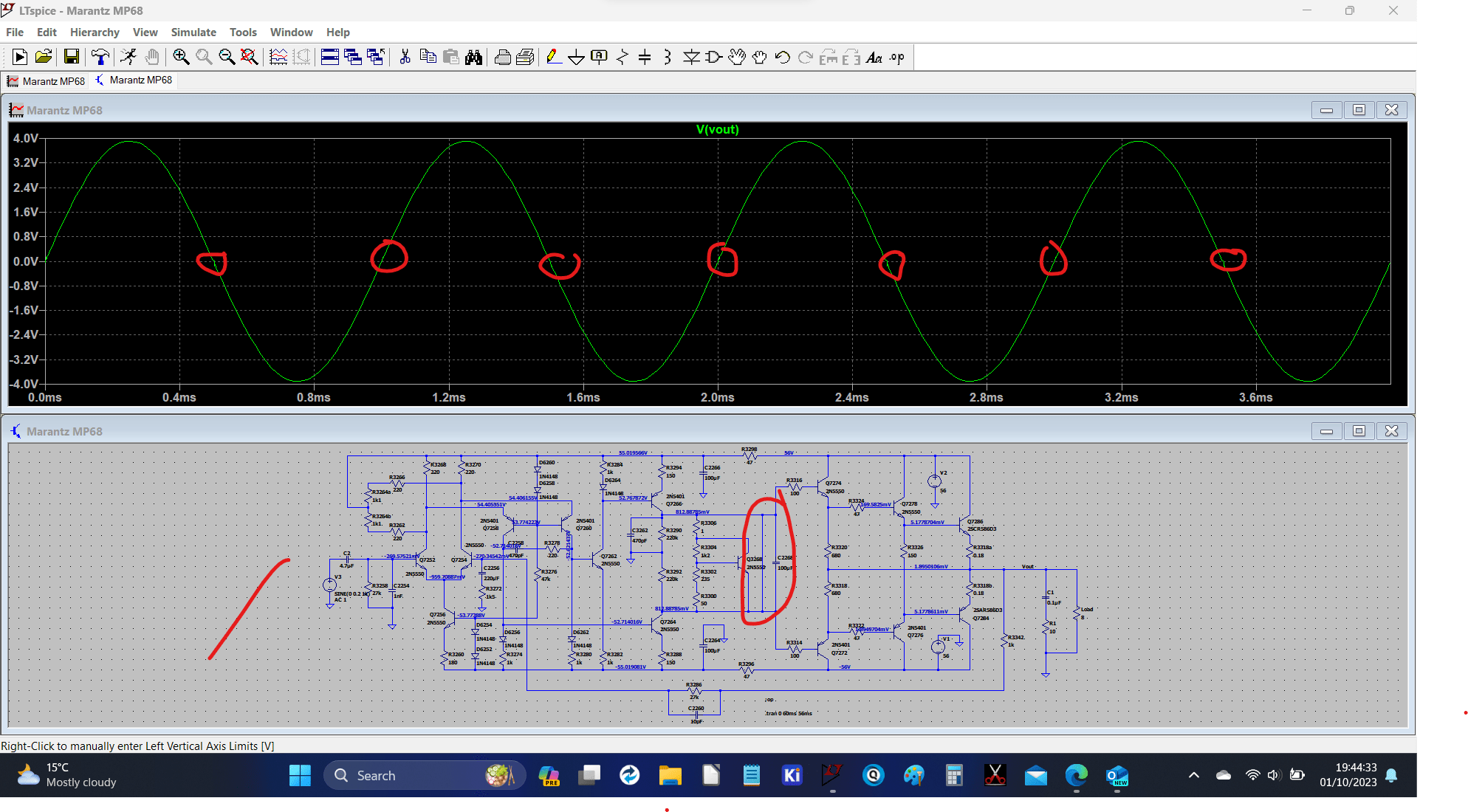

You mentioned crossover distortion earlier. Here is the amp with zero bias at 1kHz and then 10kHz. The distortion is just visible in the first image but obvious at the higher frequency.
I didn't even think about going above 1khz. I thought that if i had crossover distortion it would be on the full spectrum.
If you try it you will only see the distortion with a load attached.I saw something close to the first picture. But i will go up to 10khz ir even 18-20khz and see it in action. I think i will be able to reproduce this result you show here woth zero bias.
When testing at higher frequencies keep the level low because higher frequencies are where the Zobel network comes into play and it is common for the resistor to be under rated for continuous sine testing at high power. Those are the 0.1uF and 10 ohm at the output on my sim. I'm assuming your amp has those but your diagram didn't quite show that far to the right
In any case crossover distortion shows best at lower levels. 4 volts peak equates to 1 watt into 8 ohms and that is fine, just don't crank it up to full output.

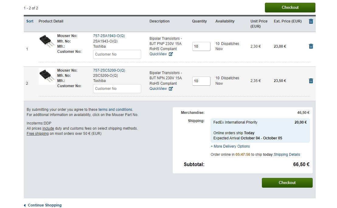

Also i found that the "o" type of 2sc5200-O and 2sa1943-O are available on mouser. Should i order them? Also since they are bigger i will need bigger insulation pads. The tape on the cooling block has started to degrade. The call them "Mikas. What size should i get for those transistors?

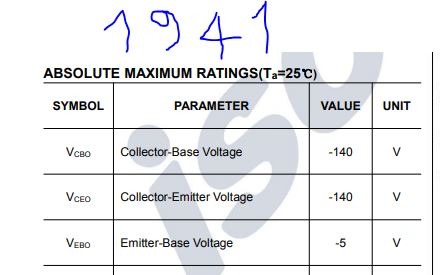

I've been doing some reading on the transistors, biasing, breakdown voltages etc. So that i can understand better what conditions that should be present in order for the output transistors to fail.
I was looking at breakdown voltages especially and the max current of the 2sa1941 and 2sc5198 both are the same with the expeption of positive and negative values. Lets take as an example the 2sa1941 datasheet here: https://datasheetspdf.com/pdf-file/701460/InchangeSemiconductor/2SA1941/1
So in theory in order for this to fail:
- Voltage between base and collector should be over -140v
On the marantz i have -56v on the collector and a few milivolts at the base (dc voltage present due to idle current biasing right?). And even if i had let's say +56v on the base for any reason i would still be lower than the 140v. But i would have excessive current and still fry the transistor right?
- I'm guessing the same principle applies for the rest of the readings in order to fry the transistor:
Voltage across collector - emitter > 140v OR voltage across base - emitter > 5v
-As far as current is concerned:
i need over 1A at the base to fry it and over 10A coming out of the emitter from collector in order to fry it. Right?
Mooly mentioned and showed that even a 0.1volt could increase how a transistor conducts up to 35%!
So i cannot understand in the specific amplifier design how could i possibly get over 1A at the base or over 140v / 5v.
Even if i shorted the positive and negative rails i would not reach that kind of number in voltages.
Even with biasing at maximum i don't think i could get it to reach over 1A of continuous current with the voltages i'm generaly seeing on the circuit from the emitters of the drivers and predrivers all the way up to the outputs. So.. These transistors are amplifying current and this translates to higher voltages am i correct so far?
Have i understood the theory correctly?

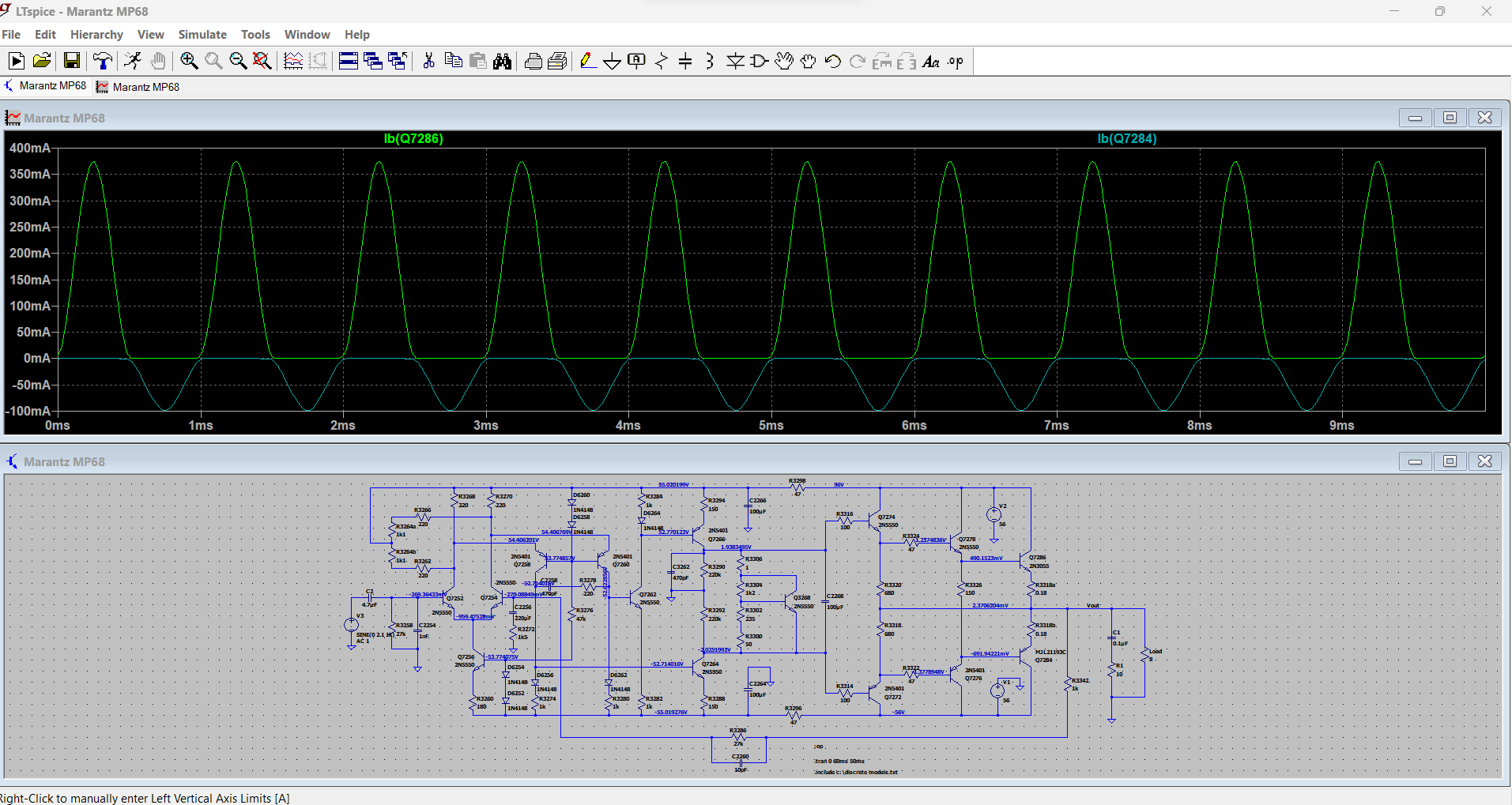

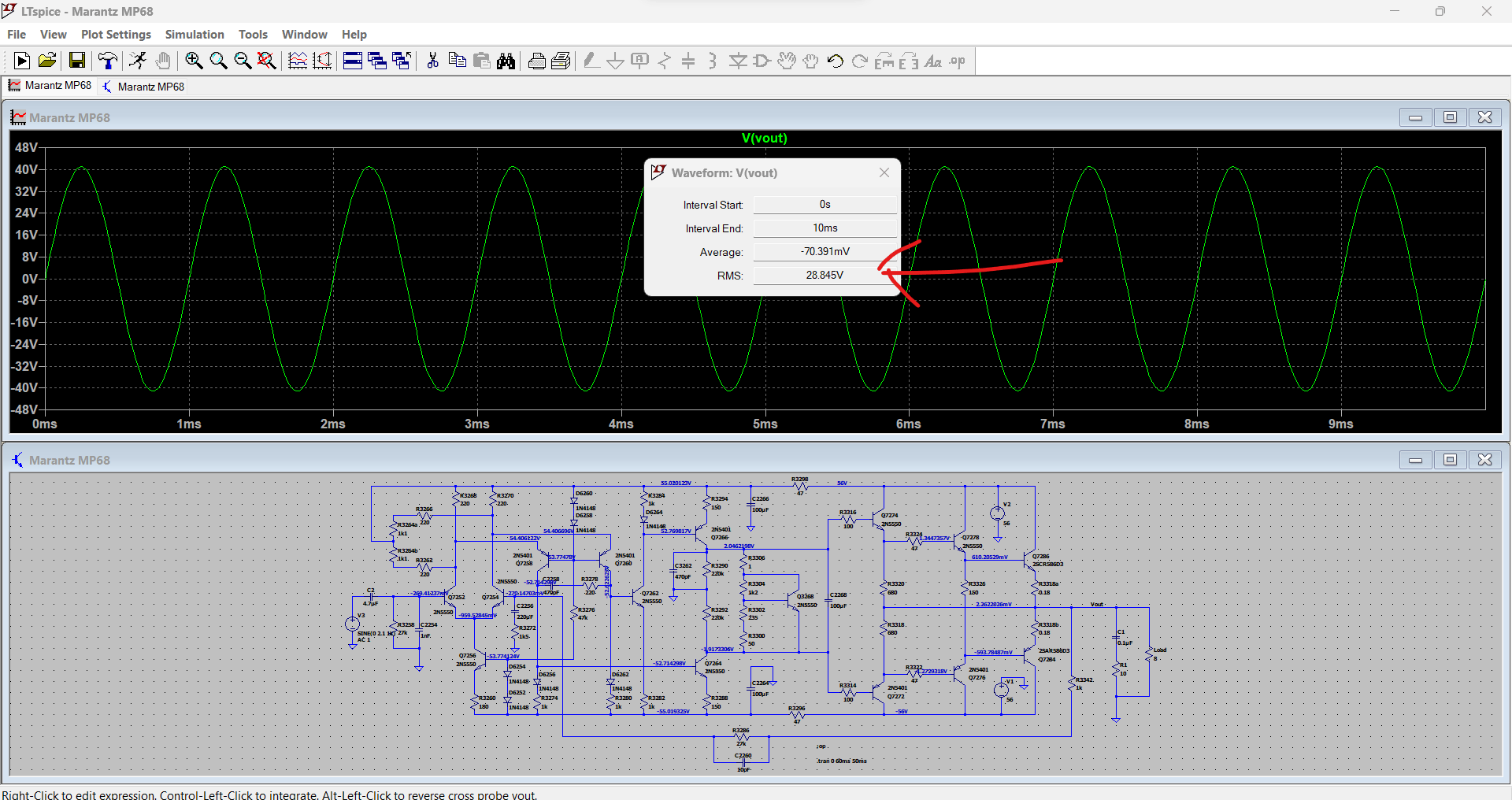

Here is your amp delivering 28 volts rms into 8 ohm (100 watts).

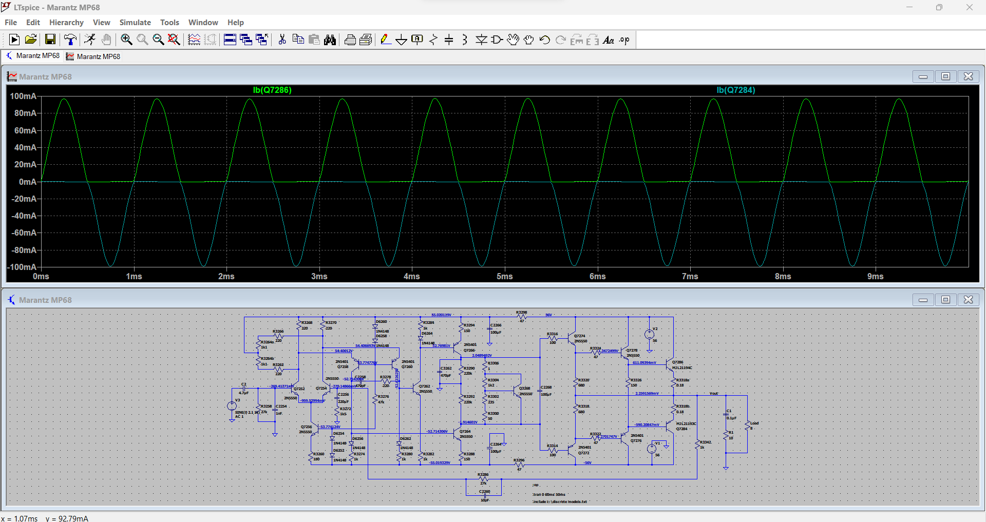

And I've just done a quick switch of the output transistors to something more representative, the MJL21194 and 21193. Nothing else changes.
This shows the base current of the output transistors at around 100ma peak. The peak load current is 5 amp and so very very approximately the gain of these simulated transistors is 5/0.1 which is 50.
Now I'll swap just the upper NPN to a 2N3055. The gain is much lower and base current much higher for the NPN. The output signal is unchanged though thanks to the action of the negative feedback loop.
So many details... In your example i can understand that the feedback loop brings the output to a balance even though the transistors are very inbalanced and the base current is totally different. In this phase i'm trying to learn failure modes on the transistors, common faults and use this amplifier design and my problem to put the theory to the test.

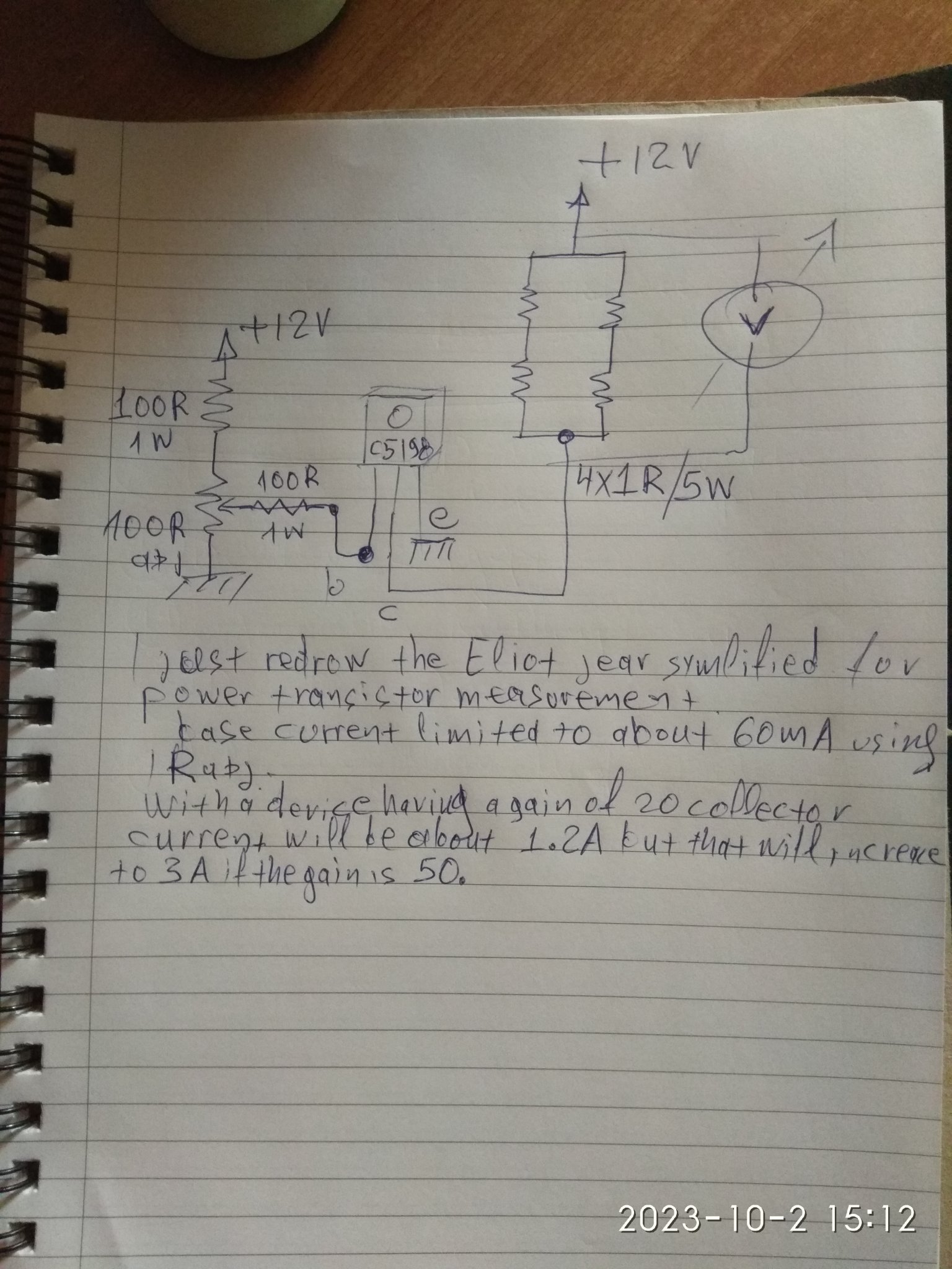

Here is a symlified test gear suitable for power transistor measurements.
Screw the power transistor in a big heatsink.
Reverce the supply polarity for PNP devices
Thank you! that is much simpler and do-able! So to make sure i understand this correctly:
- I measure voltage on those 4 resistors at the end ( upper right in the photo // they connect to the collector ). So this is my supply voltage to the transistor (56 volts on the actual amplifier circuit or -56v for the PNP)
- There is another supply voltage 12v and goes to the base of the transistor through a trimmer with 100 ohm range and a static resistor of 100ohms to set the bias. correct?
- Emitter goes to ground (for the NPN for the PNP i will be +12v )
Ok so now what? let's say i adjust the trimmer and what do i measure? You show a voltmeter on the collector on those resistors. What should i be seeing and testing?

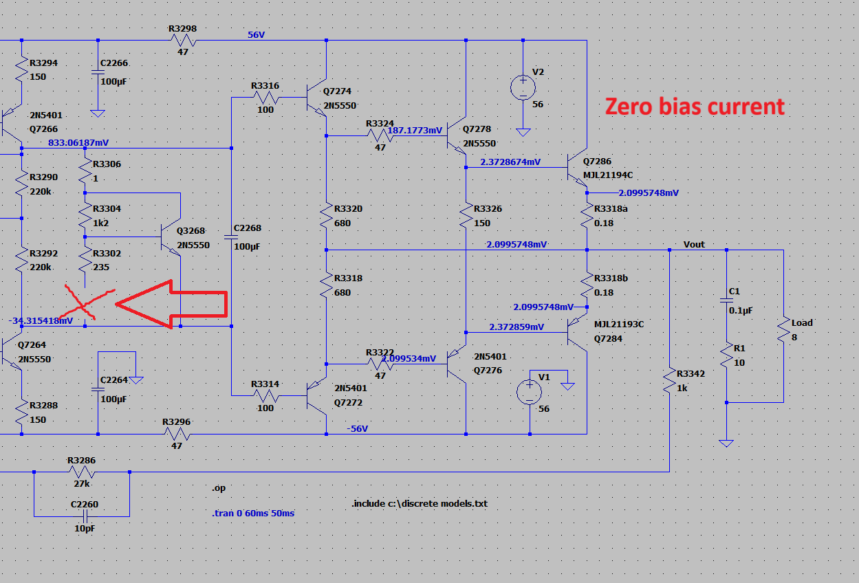

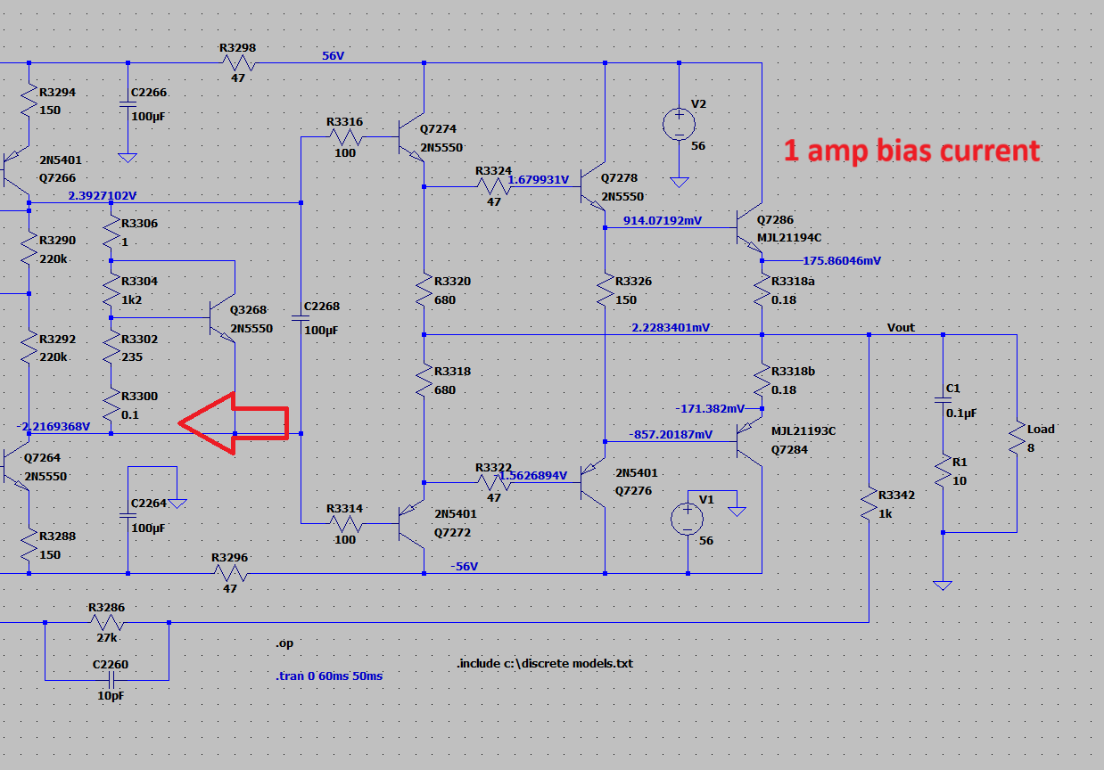

Try the simulationI'm curious what values am i going to see on each stage once i change that 270ohm resistor to a 220 ohm and max out the bias on the trimmer (while on the dimbulb). I want to see the actual behaviour on each stage as the current increases with this technique.

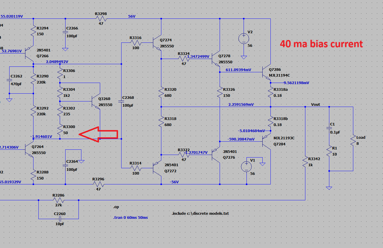

Here is the output stage at 40 milliamps bias, 1 amp bias and then zero bias.

No,you need only one 12v/5A power supply.
The same power supply for collector and base.
The volmeter across collector resistors is for voltage measurement .
Then you can calculate the collector current.
I=V/R.
In this simulation even with no bias current i see an almost perfect symmetry between the positive and negative values in all 3 cases. And i mention this because in my case the negative side is wayyy lower. BUT you showed me an example earlier today where you replaced one of the two transistors in the output and the feedback circuit balanced them.
So in essence with higher bias i will see higher voltage values all the way up to the final transistors and despite them being different the feedback loop will cause the output signal to be symmetrical.

Higher bias means all the transistors have to conduct a bit more and that is reflected in the slightly higher base/emitter voltages. Remember the transistors are really current driven and the base current is higher for increased bias current.So in essence with higher bias i will see higher voltage values all the way up to the final transistors and despite them being different the feedback loop will cause the output signal to be symmetrical.
At zero bias the output transistors are fully off (and there is no voltage across the b/e junction). When a signal is applied the negative feedback attempts to swing the output across this 'dead zone' extremely quickly and the result is that you still see an almost perfect output despite the fact the unbiased output transistors are 'blind' and non conducting in that -0.6 to +0.6 volts zone.

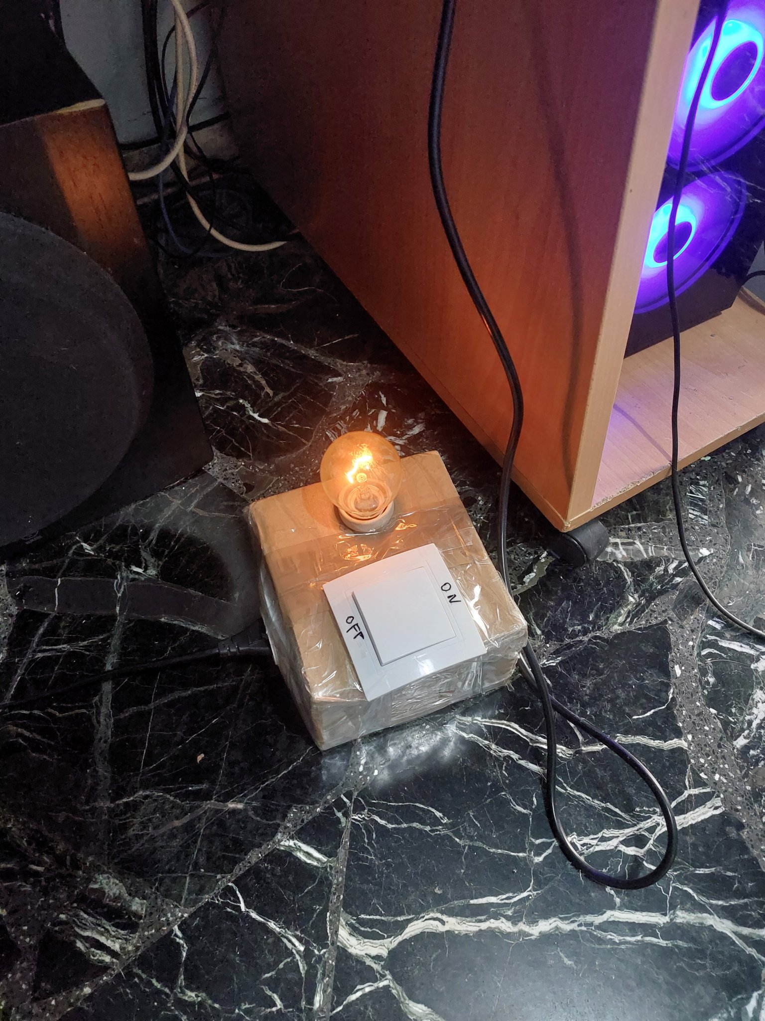

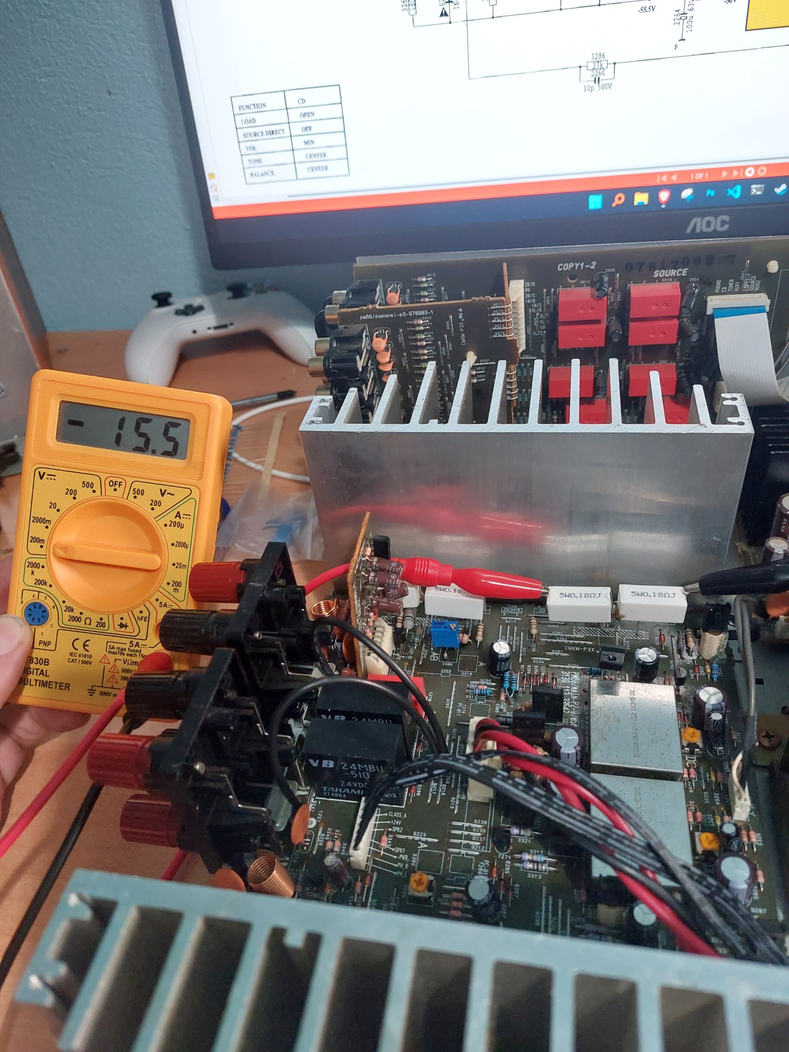

- i replaced the 270ohm resistor (R3302) with a 220 ohm resistor and installed the new multiturn 100 ohm pot.
- i can now adjust bias while on the dim bulb!!! Wow Professor Mooly was right again!
-i have it iddling for 20 minutes now while on the dim bulb with 14-15mv of idle current at first and now that it warms up it has dropped to 12.6
I would expect it to go up not down as it warms up but im on the dim bulb maybe that's affecting things.
No explosions yet BUT the dim bulb is brighter here are 2 pics :
