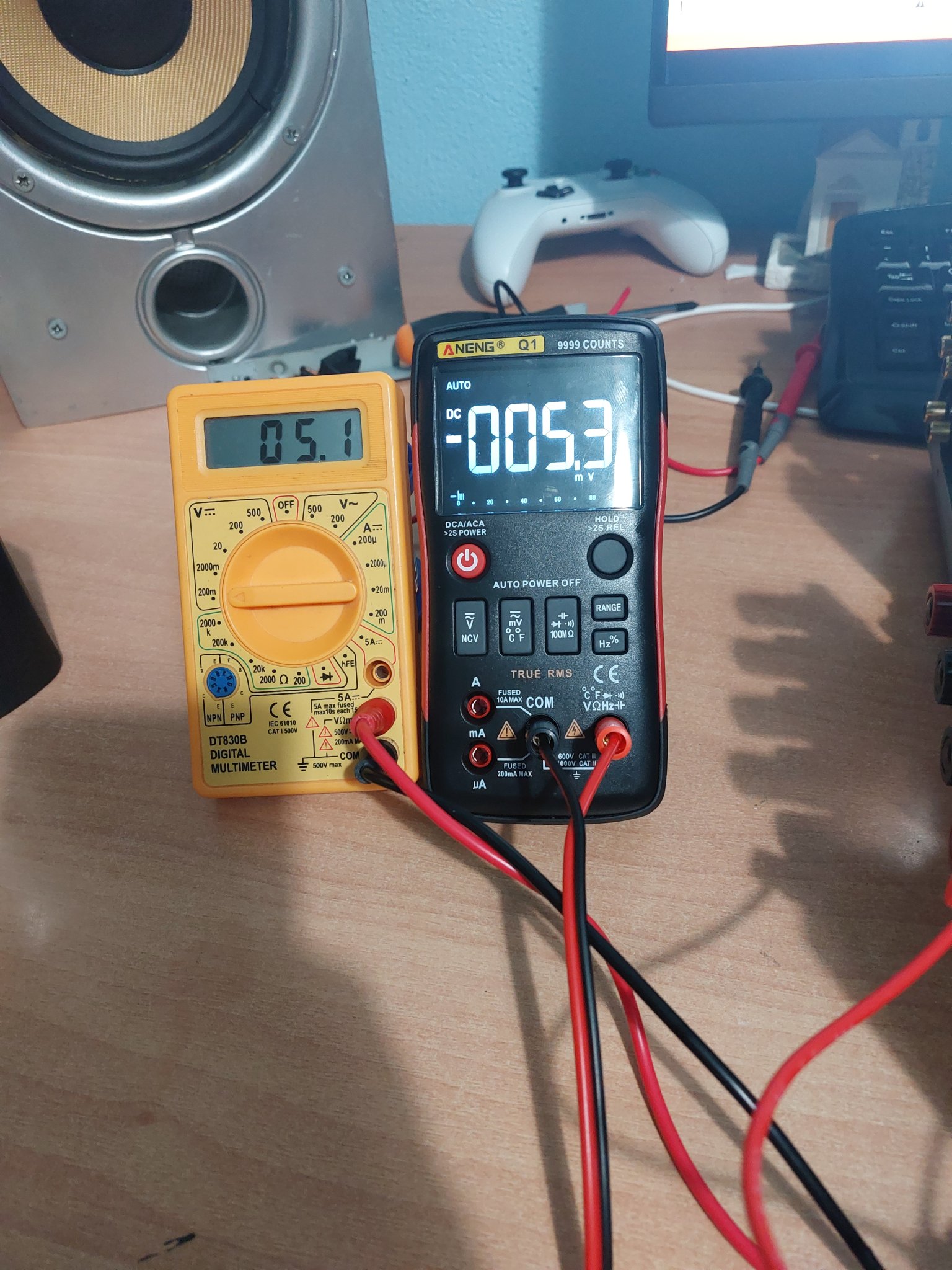

I've set the bias while on the dim bulb so i need to go wayyy lower im thinking 5mv on the dim bulb or even zero and then readjust while on regular mains.
Another good thing since i adjusted the bias is that i was able to get the dc offset down from 30mv to 1mv i could not do that before.
Another note is that the bias keeps dropping over time.. i started at 15mv and im down to 11.2mv (on the dimbulb)

DC offset is perfect, good sign.
It's just strange that the bias goes down instead of upping.

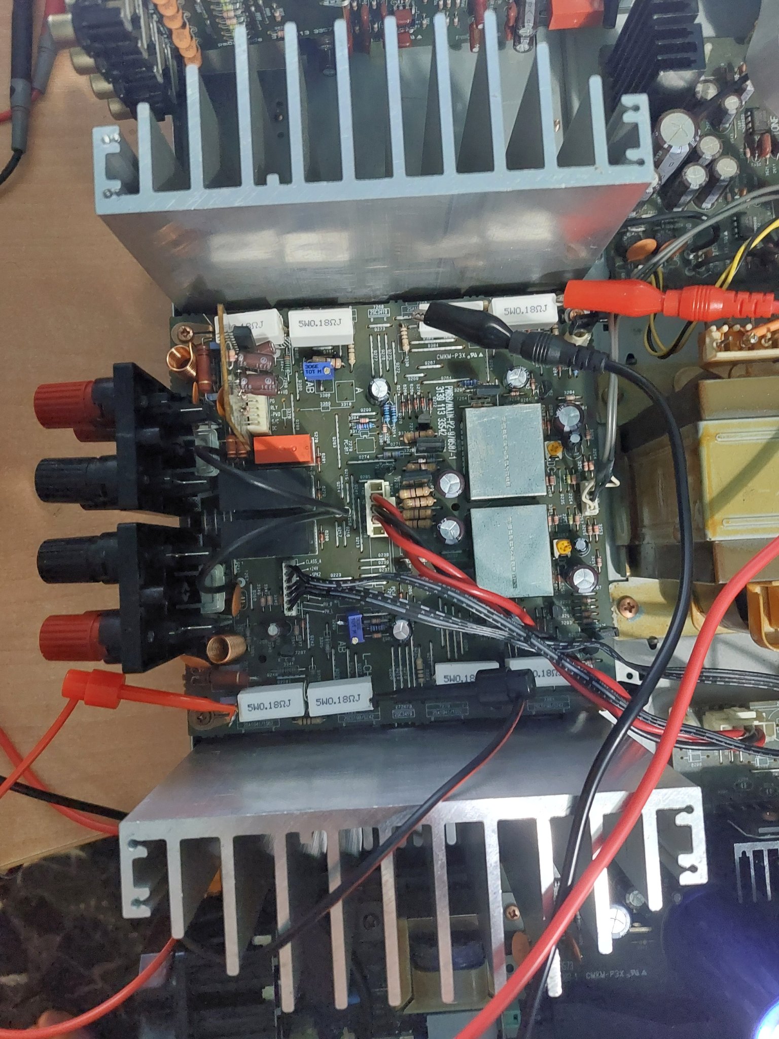

Sounds like you have it working now and behaving as expected. Do not like those alligator clips 🙂

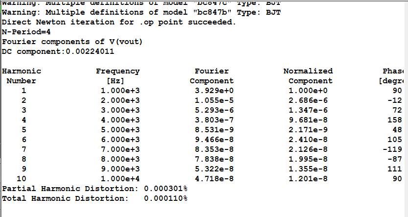

Got the sim running 🙂 missing R3330,3332 base stoppers 10 ohm for the outputs. got the service manual from hifiengine

The alligator clips are trash but they are the only ones i have. They cane with the multimeter and they are screw on additions to the regular probes. In time i will buy better ones.

I installed LTspice and ran many simulations which helped me a lot! Thank you so much Mooly!!

I am finding differences in Mooly sim schematic vs the service manual, minor stuff however but bulk of the work is done... stiil need to run more sims
what gets me is they rate it at 90W/ch/8 ohm using +/-56V and one pair of 100W BJTs, know wonder it blows up.

Thanks 🙂Got the sim running 🙂 missing R3330,3332 base stoppers 10 ohm for the outputs.
I had one of the images from earlier in the thread open to keep looking at while flicking back and forth between LT and the image (lol)I am finding differences in Mooly sim schematic vs the service manual, minor stuff however but bulk of the work is done... stiil need to run more sims
Two pairs in the earlier diagrams. I must add those...stiil need to run more sims

Right two pairs of outputs per channel, I’ll update my sim.

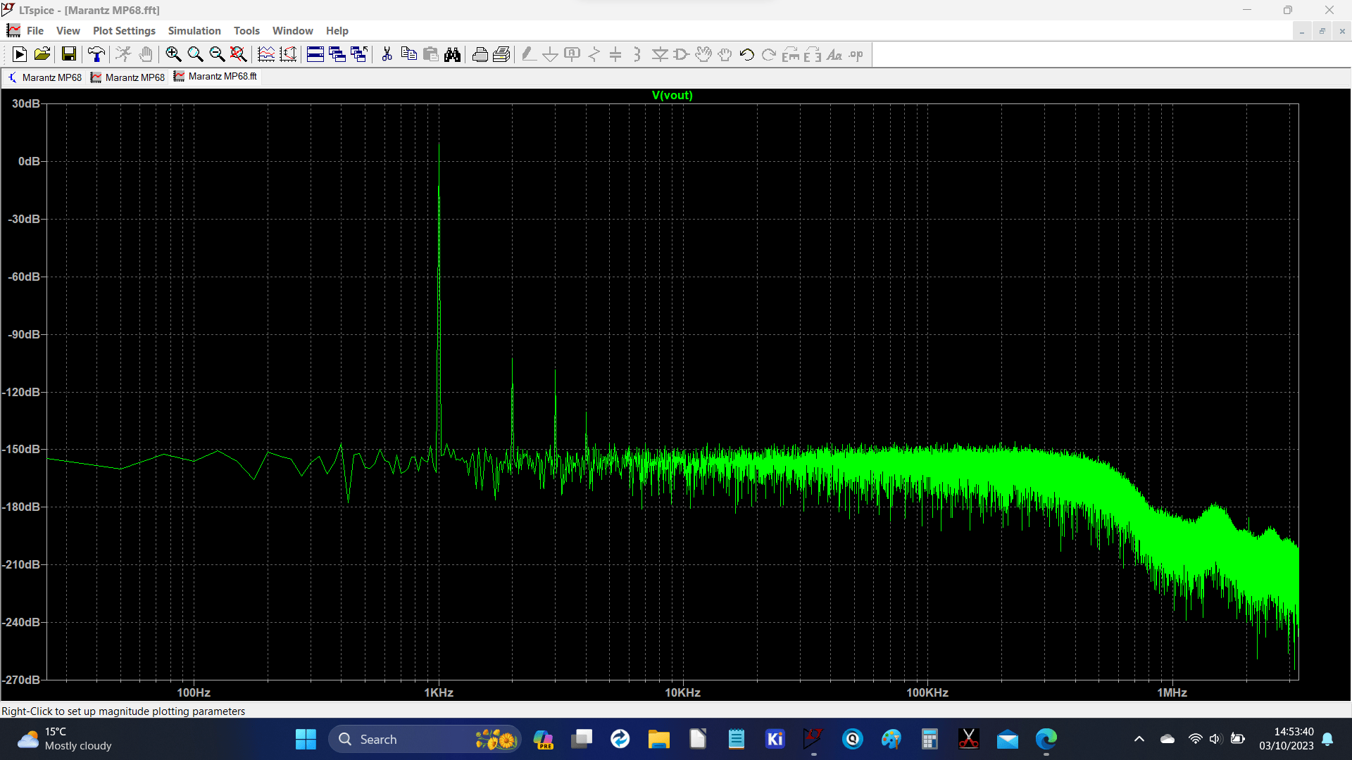

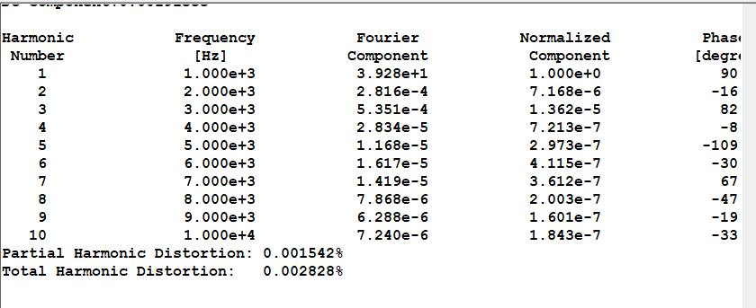

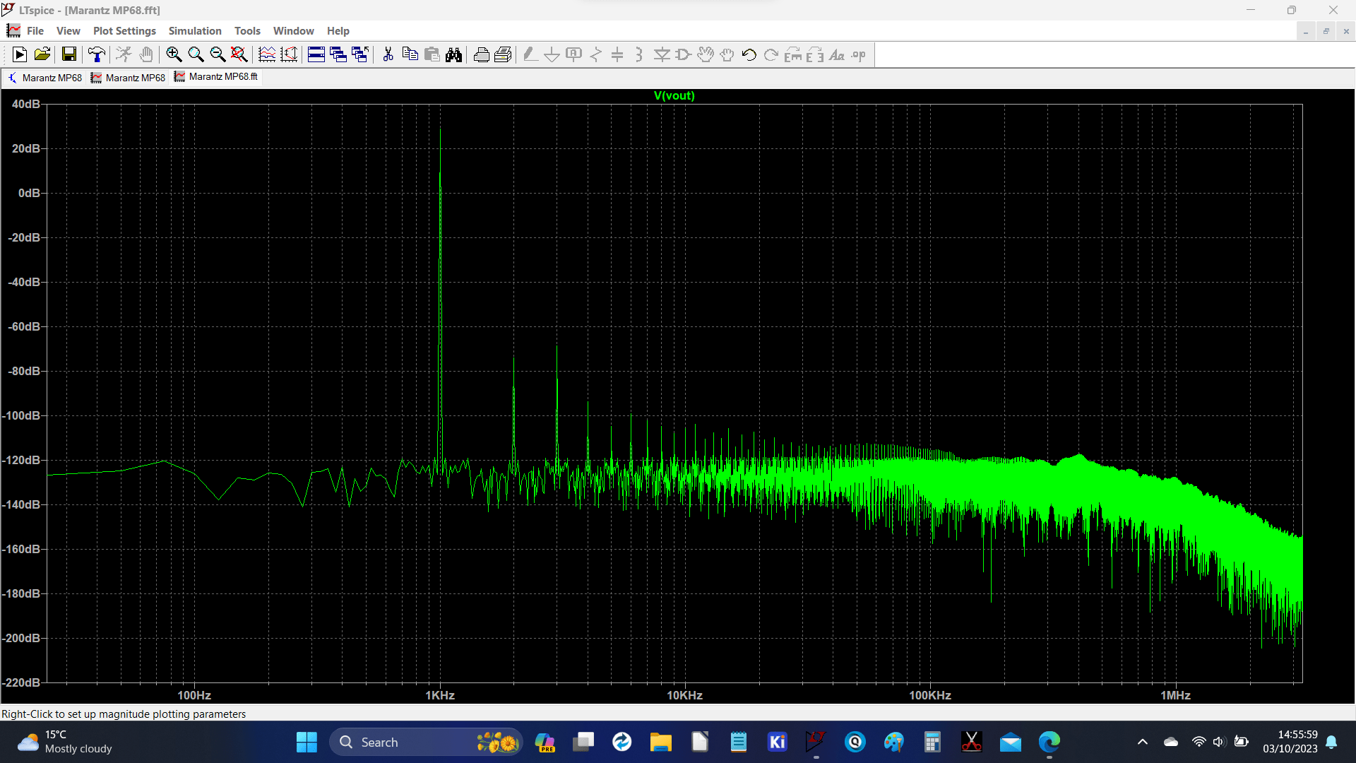

This is the distortion at 1 watt and 100 watt rms into 8 ohm. Just seen your post...... yes it does look good.
And 100 watt:
And 100 watt:
