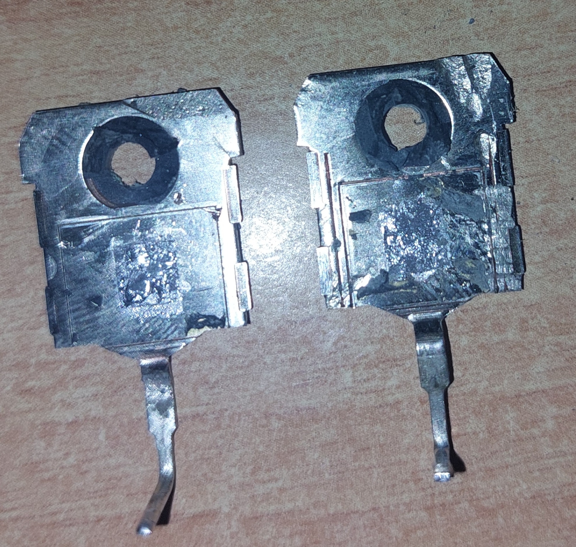

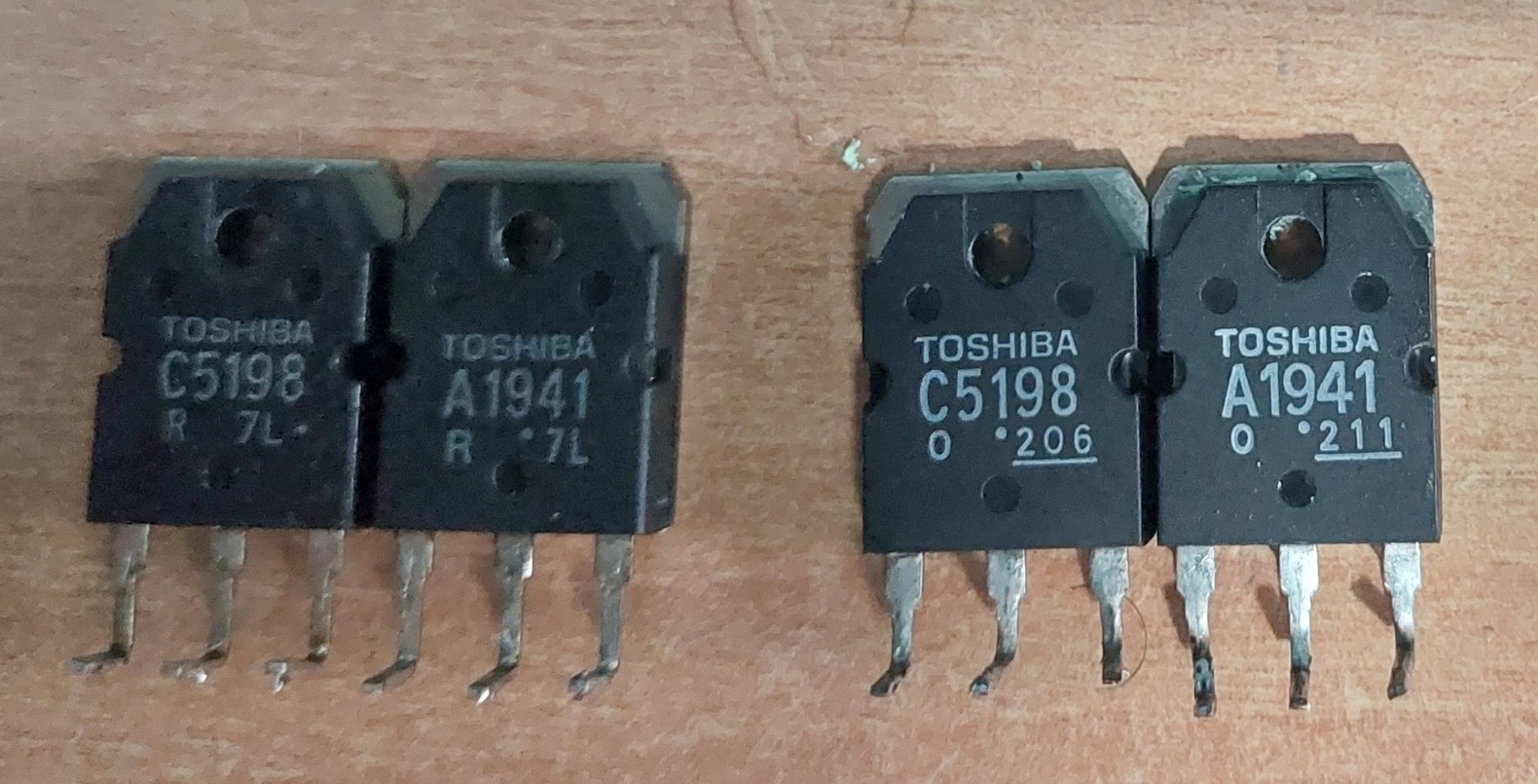

Before you order at Mouser, it would be worthwhile to check the other transistors you replaced.
They could be fake as well. Virtually no transistor in this amp is available anymore at the regular sources.
Did you buy them at soundservice as well?
No i could not find them there i found them from another greek retailer markidis.gr
Same situation though. He was the only one that had had those transistorsno one else had them.
Appearance-wise they looked the same BUT the legs of those transistors looked very cheap / soft compared to the originals.
At first i thought that since its been 20 years they changed the materials.
I didn't even think for a second that there are fake transistors out there. I thought the codes for the transistors would be different or a different brand.
I never thought that a transistor indicating the toshiba logo would be fake. I thought that it would mention some other brand that is a supposed replacement for the originals if it was fake.

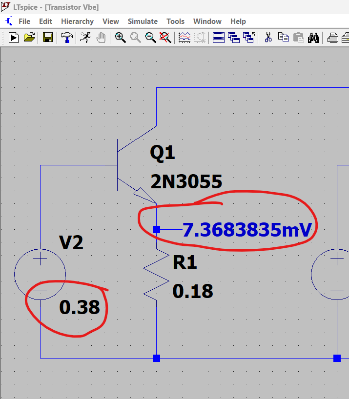

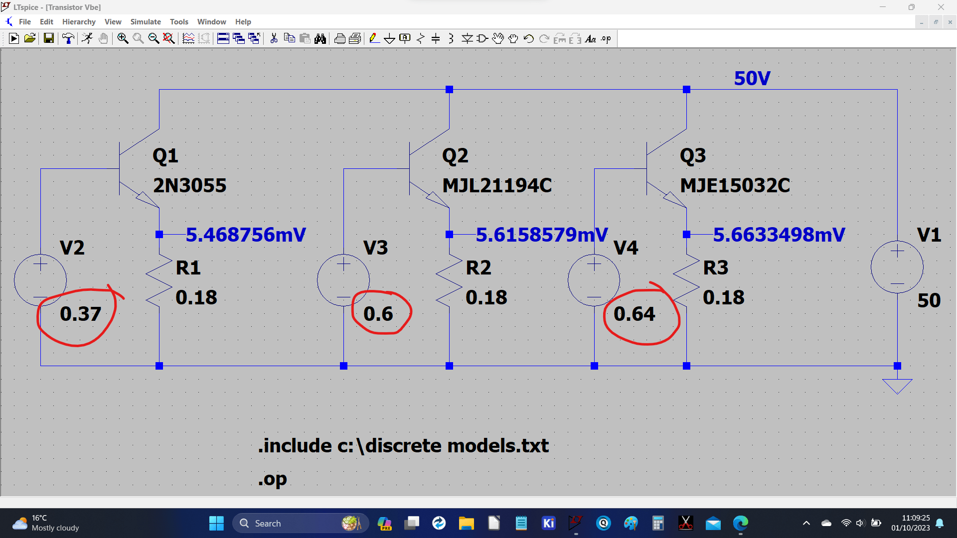

This is a quick working simulation to show you how base/emitter volts varies between devices. Each transistor has been biased to give around 30 milliamps in the 0.18 ohm resistor. Look at the different base voltage that needs to be applied for each.
Real world parts vary like this as well. The MJE15032C in this example and if all your replacements were like this would need around 0.64*6= 3.84v to be developed across the vbe multiplier in order to get any current flowing.

Thank you for being so thorough an going through the trouble of showing me this. I fully understand this now.
Your welcome 🙂 I'll just add this to show you how the current can alter with a seemingly miniscule change in applied base voltage. So we can't use vbe as a means of adjusting anything and yet it remains one of the most useful measurements in fault finding.
If we increase the base voltage by just 0.01 volts we see an increase of 35% in the current in the 0.18 ohm resistor.

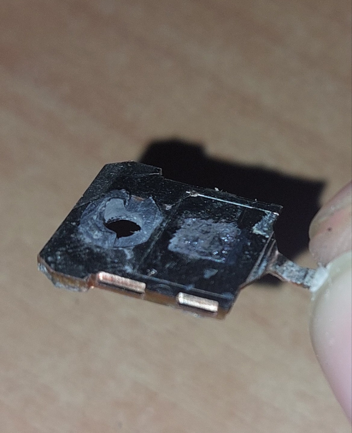

I will crack them open and post pictures of what's inside. I have a couple of 2sa1941 that still measure fine. And post pictures

In this post i have attached photos of the 2sc5198 from the previous batch tha burned up. I don't know how a fake would look like inside but here it is. Awaiting for your comments..
