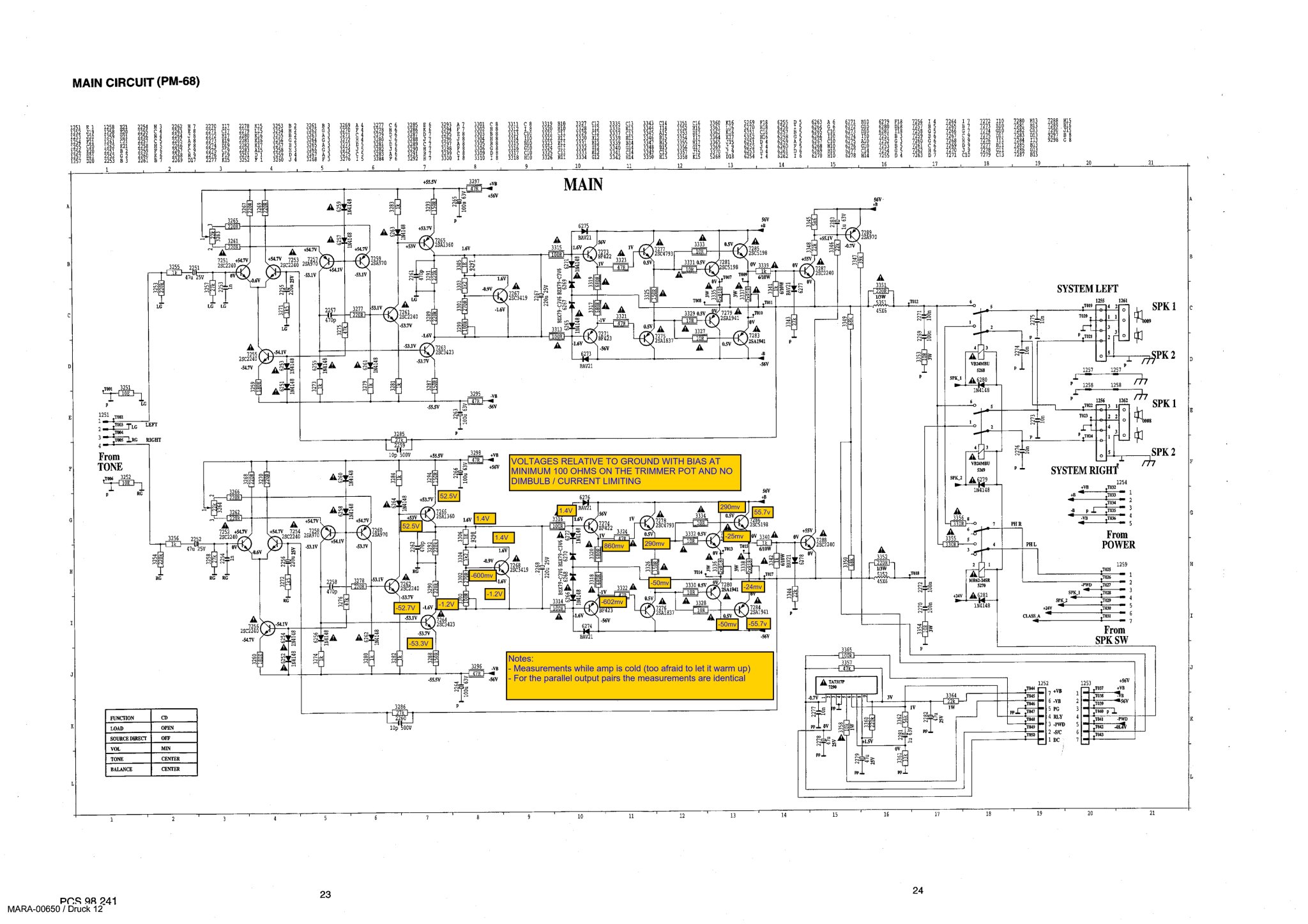

I have already measured all voltages relative to ground on all those transistors with bias at a minimum. Re attaching schematic on this post.
The negative side is wayyy low i can see that but that has to do with the bias trimmer. When i increase bias those voltages on the negative side increase but are still on the low side.
Too scared to measure all of them at full bias on the trim pot because last time it fried the outputs while measuring. And i did not touch / short anything.
I don't want to blow the outputs again. This is my 4th set of output transistors!! And since it is a 4 channel that's 8 transistors (4 per channel)!

I fully understand what you are describing but the schematic ideally states +1.6v on one side and -1.6v on the other. So i would expect 3.2v as per the schematic.
I'vw done that previously with the bias trimmer almost all the way up (~15ohms of the 100ohm range) and i got really close. I still could not measure bias on the output resistors and it blew the outputs again.
The only way i have managed to test extensively right now is to keep bias at a minimum. If i need to measure on maximum bias i turn it on for a few seconds take the measurements and then shut it off. So the measurements i'm taking are when the transistors are cold so the measurements are not 100% accurate. I should let it warm up first.
I would like to try what you are suggesting with the parallel resistor and it makes a lot of sense but i can't keep blowing output transistors this has become tedious now.
What happens if i leave the amplifier like this? I would work like a class B right? Could it cause any more damage if i leave bias as low as it is now?

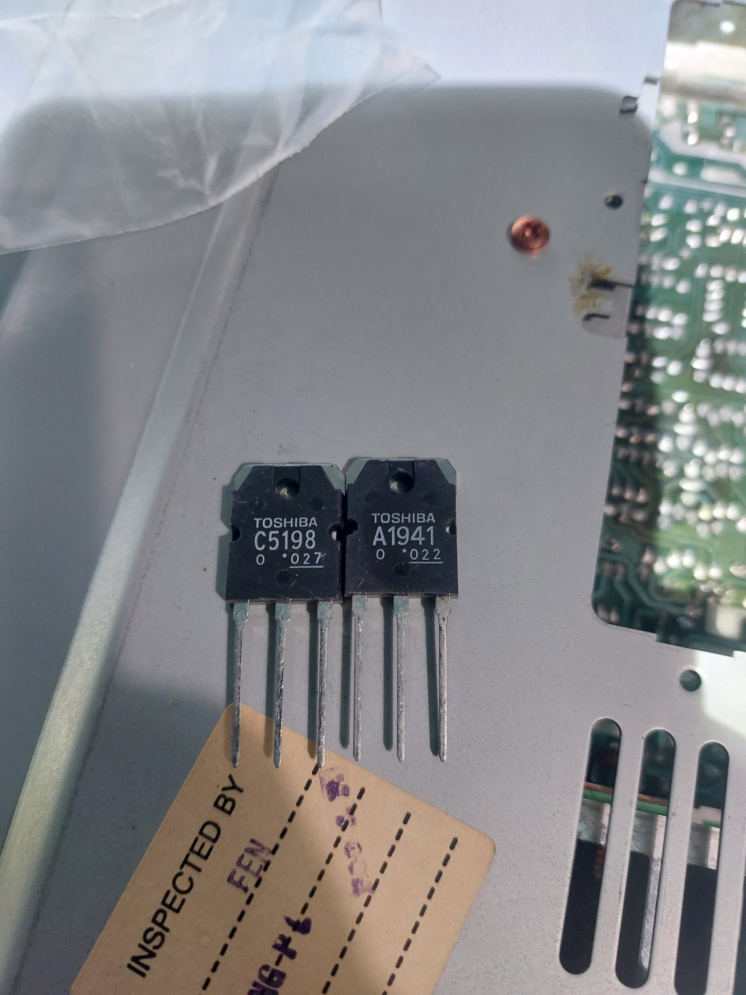

Fake parts are common problem in Greece and all over the world!
You can't trusted any other than the authorized supplier like Mouser or Digikey.
I would strongly suggest Mouser.
You haven't pay for import taxes.
Use 2SC5200,A1943.
Wow i did not know that! You know what? Just for the sake of argument i will order 4 pairs from mouser.
Why should i use 2sc5200 and a1943? Are those better?
Because the type you have isn't available anymore.
Now that you say that i was not able to find the original transistors and only sounddervice.gr had them in stock. Maybe i'm using fakes all this time.
I will buy 10 of each from mouser gain match them and test again:
2SA1943: https://eu.mouser.com/ProductDetail/Toshiba/2SA1943-OS1F?qs=B6kkDfuK7/Cm3tZSt%2BISCw==
2SA5200:
https://eu.mouser.com/ProductDetail/Toshiba/2SC5200-OQ?qs=EEns8I54Y6BCHV7Kwts0vw==
Please verify i'm looking at the correct transistors
Service manuals can be very inaccurate at times. The voltages they show may be little more than expected ball park figures. For example they clearly show 0V on the emitter of both output transistors and so by definition there is zero bias current flowing. 0 volts across 0.36 ohm is zero amps.
An experienced tech can pencil in all the expected voltages on all the nodes in any circuit like this in seconds without having to measure anything... and while they will be 'correct' the real world voltage will vary slightly.
Bias out of range after replacing original parts is something we see quite often.
WOuld the dim bulb save the outputs if something goes wrong here? I REALLY don't want to blow them again
It should do. That is the whole point of it. Provided the outputs are fitted to the heatsink correctly the bulb can't pass more current than the outputs can handle, more correctly the bulb limits the total power the amp can draw which can never be more than the bulb rating.
I don't have that kind of experience obviously. This is a hobby. I was lucky enough to do repairs on small amplifiers with tdm or STK chips so this is my first class ab. I learned a lot so far from this adventure.
Since i'm planning to buy original parts from mouser this time (i suspect those i have are fake)
i will test with the dim bulb (65w bulb) and a 200ohm resisotr instead of a 270ohm. And See what happens then. If they burn up again i will replace them with those:
2SA5200:
Keep in mind that you need original parts for other positions too,like Vbe multiplayer that already replaced.
Oh my god... the left channel which was constantly frying the the outputs has been completely rebuilt.. all transistors there have been replaced.. i need to reorder all of those and replace them again.. what a nightmare... i should have known better this is my fault..
And to top it all off i found this thread:
https://www.diyaudio.com/community/threads/chinese-fake-transistor-experiment.349875/
This guy explains the exact same thing!! So yeah.. i really start to believe that the parts i used are trash...
