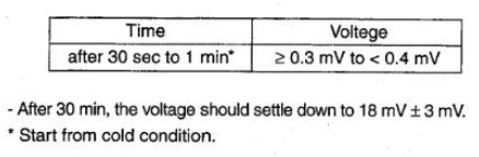

Have you taken this into account? The manual states that the bias should be set starting from cold condition to between 0.3 and 0.4mV.
It should slowly rise to +/- 18mV after about half an hour.
So, if you set the bias at +/- 18mV when cold it will rise to levels far too high for the amp to survive.

Another method, faster, would be to continually monitor and maintain the spec bias. at first cold power up, no AC limiting, turn bias up to spec, as it heats up continue to turn the bias pot down to maintain spec as the ops heats up to the point of thermal equilibrium.

Based on the method as described in the manual, probably not doable if using a limited AC supply, and probably what is being experienced.
Can’t say I remember such a bias setting method inferring this type of thermal bias stability.

Indeed, pretty unusual extremes.

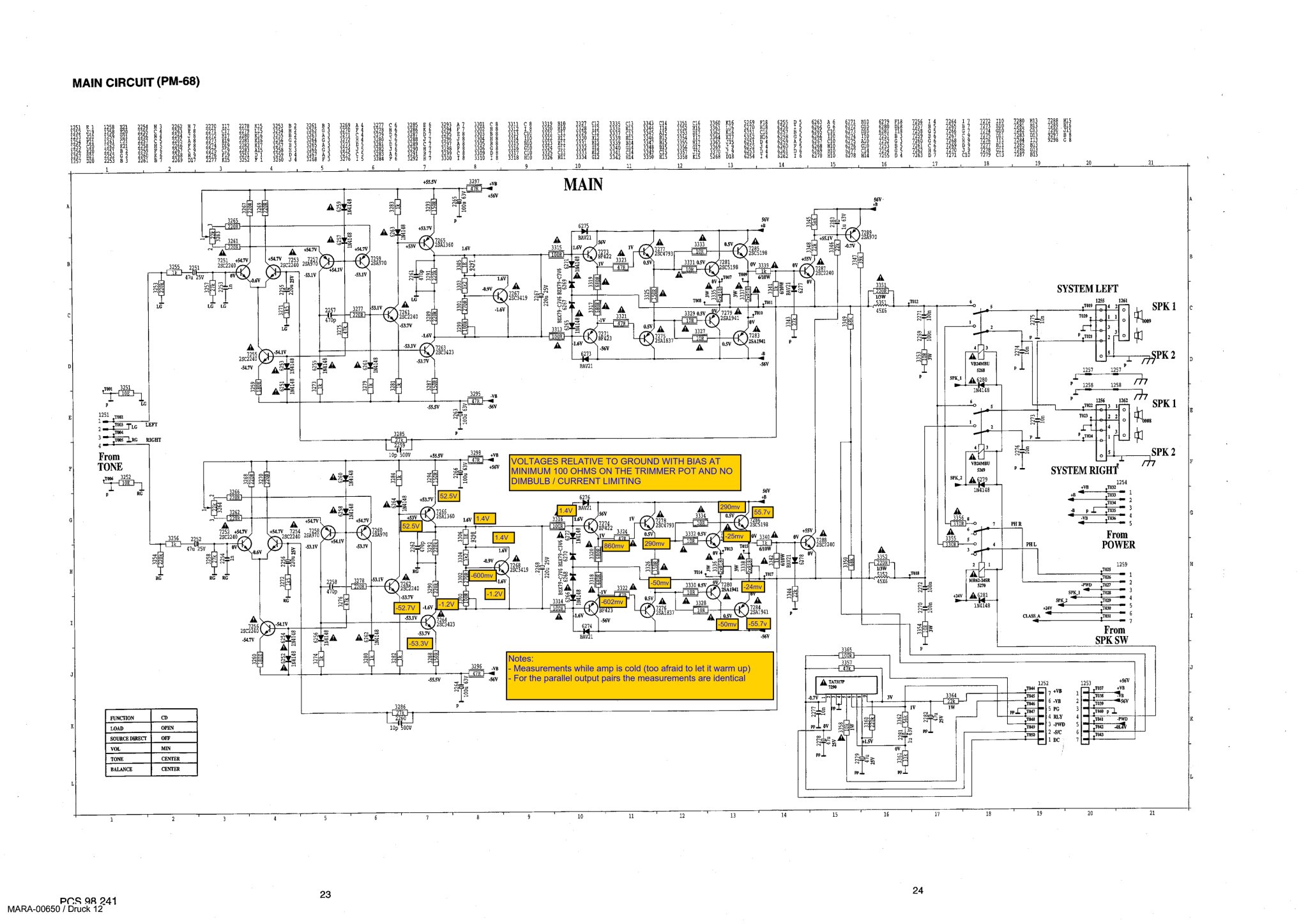

The easiest way for us to help you is for you to mark up the schematic with the voltages that you measure comparing against what they show, all of them!!
I did just that here is the schematic with the voltages measured from ground, without a dimbulb, Bias set to a minimum and the amp was cold (attached pdf of the image below).
You will see that with the bias trimmer all the way down the negative side is very low.
On the previous repair, when i tried to adjust bias based on the readings from the emitters to ground on each stage to reach the voltages the schematics states it fried the outputs in 5-10 minutes of playback at a low volume. i did that because i could not measure bias. So now i have left the bias to a minimum until i figure out what else is wrong here.

measurements look okay.
Looks like you have some DC offset, you could adjust R3264 to set it as close to 0V as you can get (with respect to ground), (what does it measure now?)
measure at T017 (with respect to ground) which is the o/p and feedback point. then the numbers ( across C2268 with respect to ground) will be more symetrical.
Just going to have to go for it, turn the bias pot up (R3300) a bit at a time while monitoring the OPS bias, DMM across TO13,TO14 or TO15,TO16 to see how much OPS bias you get, go slow. use lead clips, not probes that will slip off and short out stuff. Attach/detach lead clips when power is off only

To follow up, what are the voltages at base and emitter of Q 7266 with respect to C 2265? If there's still ~ 0v b-e and voltage present across R3294, then there's open along the R3294 path. Hence, no bias current possible in output transistors!

On the faulty channel what voltage do you see with the preset on both minimum and maximum? So two readings.
There is! Maybe i did not mark it down properly on the schematic i attached. Emiter voltage is approximately 1.4v .In the schematics, I don't see any b-e voltage at Q 7266, i.e. no constant current to power the bias spreader. I think that may be the problem.
Base and collector voltages are approximately 54v so it is close enough to what the schematic says.
Right now dc offset is at about 20mv on one channel and 30mv on the other. The one im showing on the schematic is the 30mv one and i cannot get it to go any lower.measurements look okay.

As far as measurements are concerned i find it very puzzling that the negative side is so much lower than the positive. Maybe because i haven't set the bias yet because when i do set it, i see changes in voltages there.
But no matter how much i turn the bias trimmer, even all the way, i get no reading on the output resistors on either channel.

I don't think I conveyed my point: There must be voltage drop across R3294 if there is any available supply power to the bias spreader and the output transistors. The supply current must flow through R3294. This issue may be why you can't produce any bias current.
Alex said:In the schematics, I don't see any b-e voltage at Q 7266, i.e. no constant current to power the bias spreader. I think that may be the problem.

Oh ok now i got it. R3294 does measure 150 ohms and across the two leads of this resistor i get 1.6v. i just measured it. So as far as i understand there is a voltage drop there.I don't think I conveyed my point: There must be voltage drop across R3294 if there is any available supply power to the bias spreader and the output transistors. This issue my be why you can't produce any bias current.

If Q7266 is functional, there should be about 0.6V base-emitter voltage.
If there isn't, the base junction might be shorted, and the collector open. No current to bias spreader.
Or, R3294 or its conducting traces might be open or too high resistance. Base-emitter voltage is then low because there's no current through R3294. No current to bias spreader.
Since you confirm 150 ohm resistance, open traces are a possibility. What is b-e voltage? If it's too low, why?
