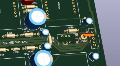

Hi. Could you check pictures there is red circles my friend signed? He wants to know Where are they connecting
Yes there is thin circles that my friend circled on the left and right. Difficult to seem ,needs enlarging picture
Those marked points (J504, J505) in the 3D photo are just the vias connecting the upper and lower layers.

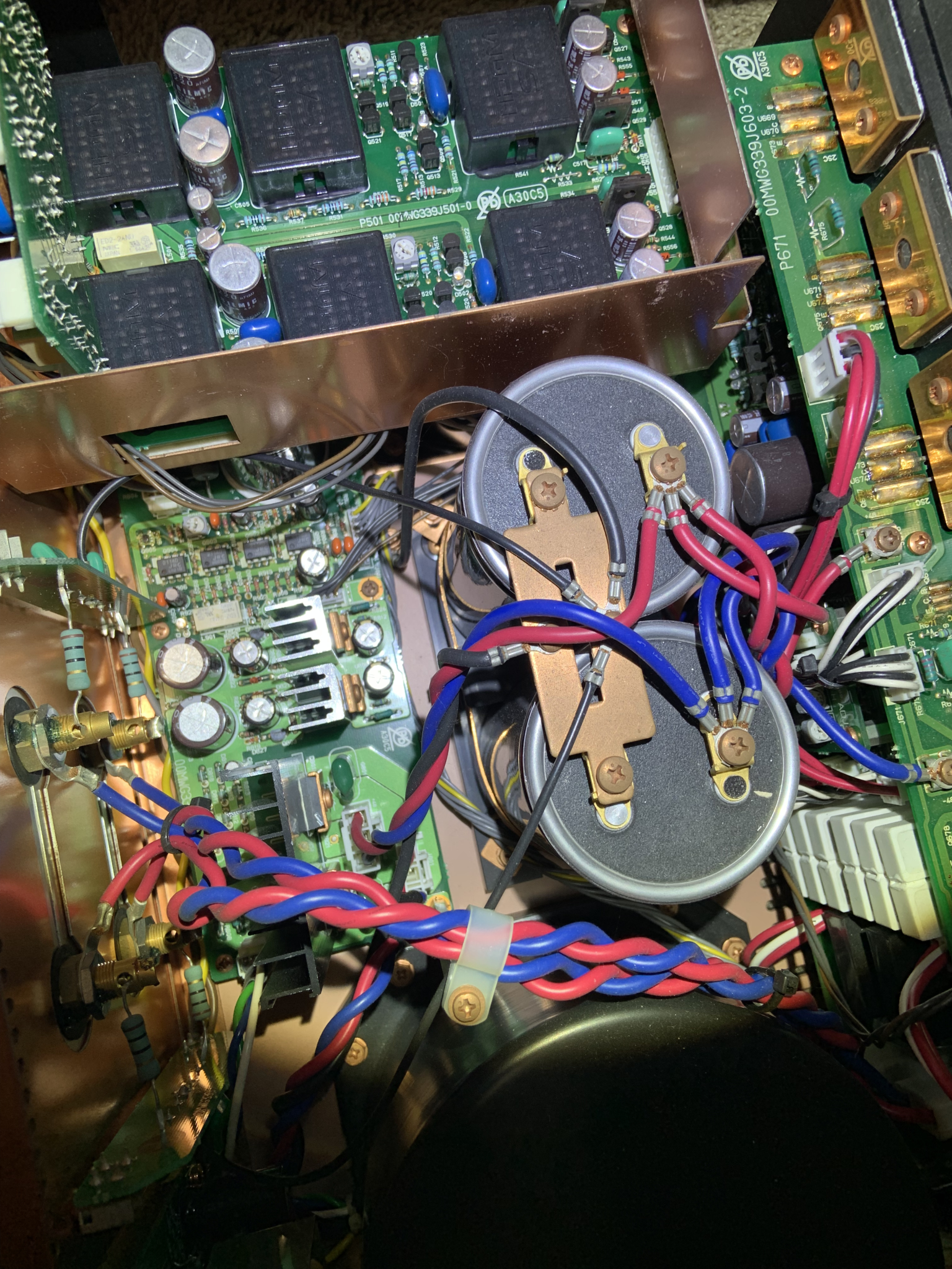

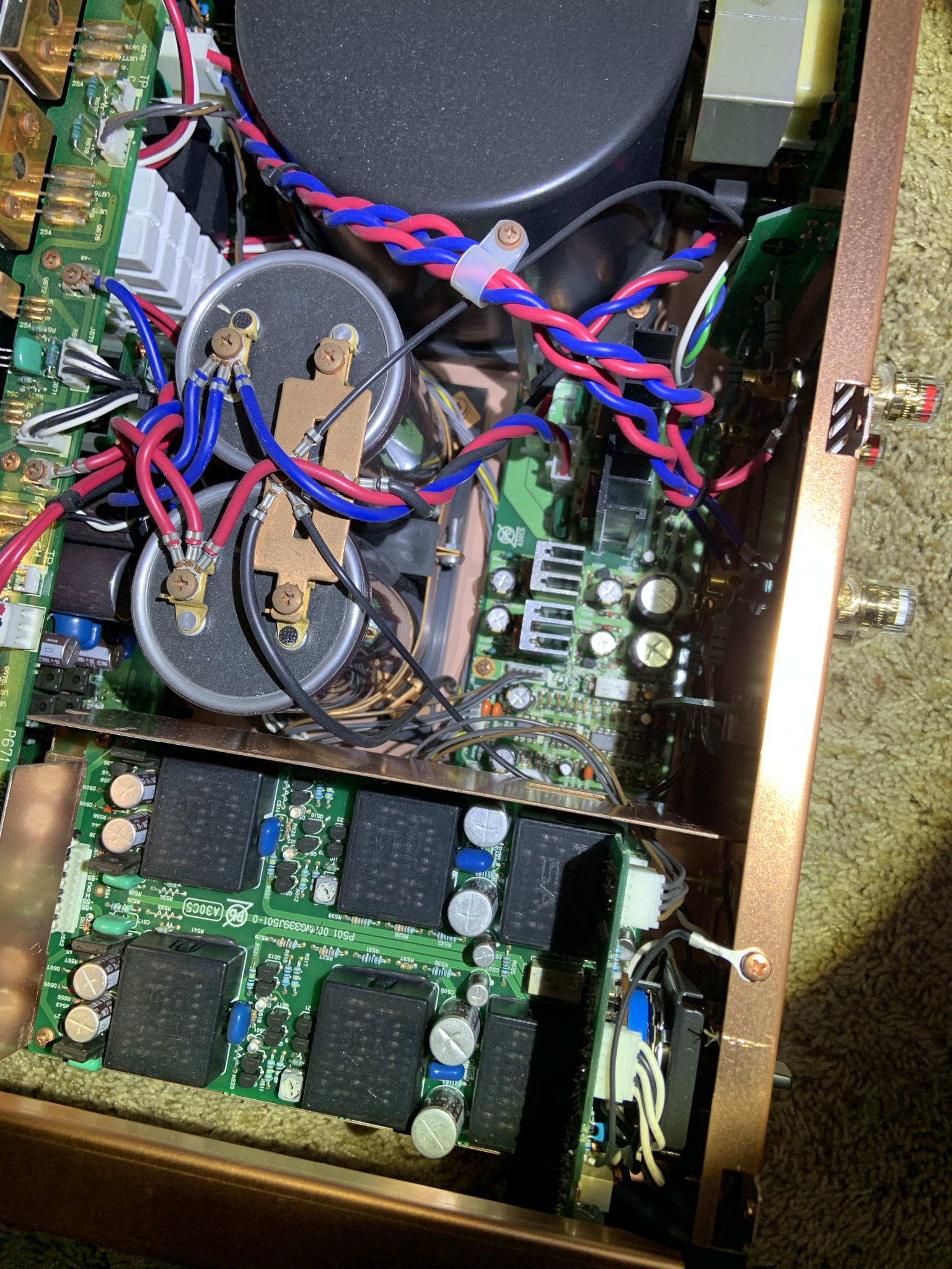

In the photo below you can see that there is a wire soldered to J504, this probably goes somewhere on the chassis.

This is where the path is missing, I marked with an orange line.

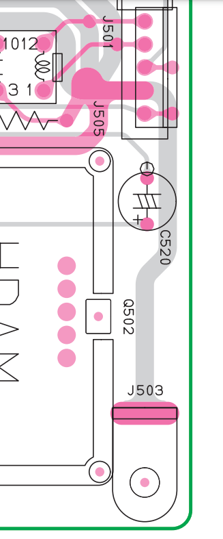

There is no J506 in that location. It is actually J505. J505 connects J501 and to J503. J503 is then grounded through the PCB mounting hole screw. J505 also has a wire soldered in it that goes down to the chassis bottom plate and connects to ground there.
It is like this on the PCB:

Your information is valuable because the pictures don't show all the ground wires.
